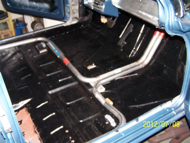

    After a very loooooong time I am finally back working on the 409 Corvair project, I have nearly completed the steel coolant pipes, I am using 1.5" aluminized pipe and "J "bends. I have to install the lifters in the 409 and intake /carbs and finish modifying the SBC block hugger headers to fit the 9r. I sure hope to have it running this summer or early fall.

    I think you are going to have to insulate those pipes REALLY well.
    Most V8 vairs have the pipes running UNDER the floor.
