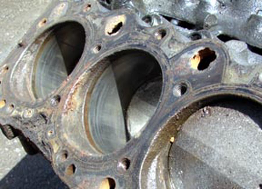

    If you want the 409 look and not just some random 409, you are stuck with finding a real 409. They have odd engineering just like the Ford FE series engines with their intake manifolds that go under the valve covers. Here are a couple pictures showing the 409 block and heads. The true wedge-shaped combustion chamber is 100% within the block, the heads are just flat covers that hold the valves.
