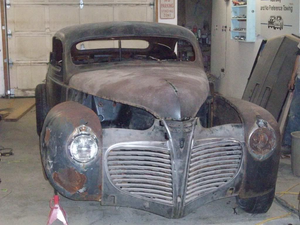

    i'm hoping there are some people here that know a lot about the 40's Plymouths and can help me out. I'm working on one (don't know if you've seen my build thread http://www.jalopyjournal.com/forum/showthread.php?t=399852 ) and there are a few things i've got questions about.
    when i bought the car it came with four front fenders. All of them fit, but one has a cooler shape (in my opinion) and is more flat on the top and slightly longer than the others. All four have the same lines on the sides which are unique to the '41 Plymouth. Maybe one type is for Coupe and the other for Sedan or something?
    the other thing i was wondering about is using a DeSoto grille. The one stylistic blemish on the car (again, just my opinion) is the grille, so I'm thinking about using one from a '40 DeSoto... they look like they use basically the same body as the Plymouth, but does anyone know if the grilles are close enough for the Desoto to fit?
    thanks in advance for any help

    i tried taking a picture earlier but i couldn't get them to come out so you could really see the difference, but
    you can kind of see the difference even though they're both kind of just hanging. The one on the drivers side is the longer one. It's also flatter on the top, taller in the front and is not quite as wide. Again, they're both definitely '41 Ply fenders because they have the three ribs on the bottom.

    I'll save you the trouble of registering on the p15 board. I'm an old geezer and will yell at you here. THE FOLKS ON THE P15 BOARD ARE PRETTY TOLERENT OF JUST ABOUT ANY OLD MOPARS, AND YOU JUST MIGHT BE ABLE TO GET SOME USEFULL INFORMATION THERE.
    Wow now I feel better. There are quite a few modified cars and trucks over there and quite a bit on knowledge to share. If you do show up over there, I WILL YELL AT YOU AGAIN, IF YOU FEEL IT NESSECARY!!!!!!
    OH AND BY THE WAY, the grille mounted on your car is a 41. The 40 model grille featured straight opening with squared off onthe ends. As shown below. And if you look carefully there is a very suble difference in teh headlamp trim ring at the bottom. One is rounded and the other is pointed.
    It would appear the drivers side fender is a 40 ad the pass side is a 41. To furthur complicate the issue there was a down market Road King line that was different. If you have the original engine, look for the engine number, its on the flat casting boss on the block at the drivers side front just above the gennerator and the head to block seam. It should start with p9, or P10. The 41 would be a P11.
    I HOPE THAT HELPS!!!!!

    now that plym 46 mentioned it, the driver side fender has the same head on profile as my 40 dodge has. I actually like that grill. If you are serious about changing it maybe you should get the whole grill surround also and try to adapt it that way. later shawn
