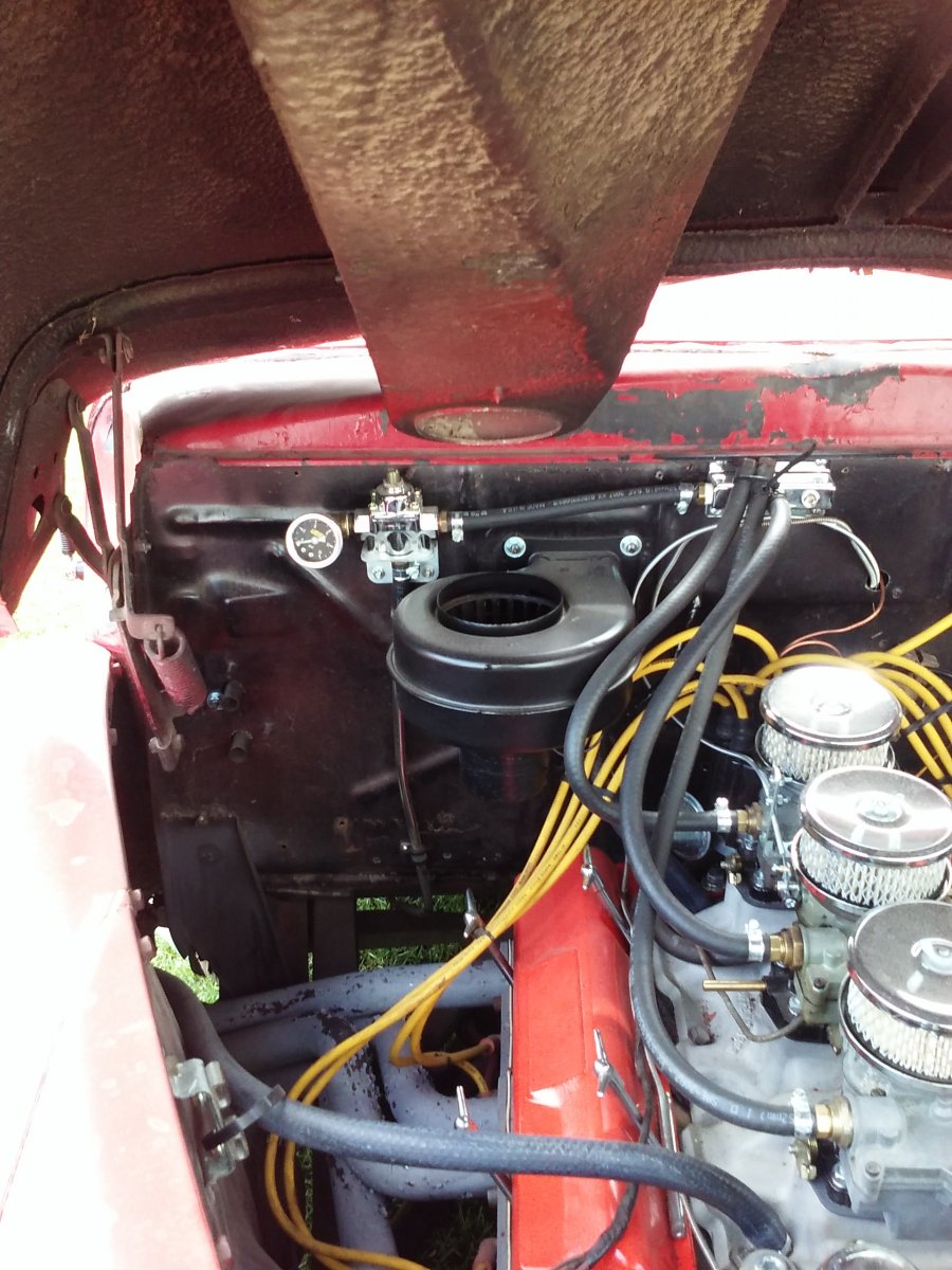

    Also turned the heater core upside down, because the hose connectors were located to close to the s.b.c. distributor
    for connection. ;)
    They end up next to the hood hinge ( pictured )
    The heater hose pictured running from the intake now is for header crankcase evac. system.

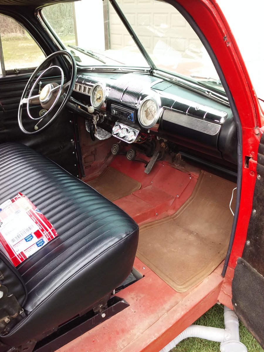

    Is that attached to C channel bolted to the floor.

    The heater bolts to the firewall with the heater core sandwiched between firewall and heater sheet metal.
    You can see part of the heater box under the dash in this p 20170414_134913 (2).jpg ic.

    Wrong guy...I was asking about the van seat

    :oops: Opps
    Yes, C channel bolted to the floor and the cross bolts receive the seat same as Van floor did.:rolleyes:

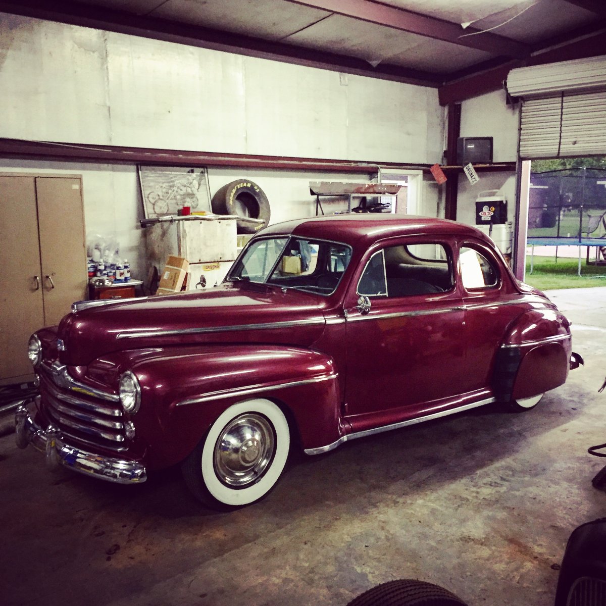

    Finally got mine about done

    Your interior Looks boss, from the above pics! What ya' got on that? You are running a 57 283 aren't you. I have one in my shop and a dead 46 ford. How did the 283 turn out, and what about the internals? hotrodyankee is completing about the same build. I am enthralled with what you two are doing. Keeping it sweet and simple and in true traditional rodding fashion, while maintaining the character and form of a cl***ic Ford! Keep it up fellows.

    Thanks! My interior just got done a couple weeks ago. but I still have a flathead in it. I am doing a 283 but probably not until this fall. Should be a pretty basic installation.

    Hello Chris,
    This is an interesting thread that hit home back in 1962-63 days. In Long Beach, our HS graduating cl*** had a bunch of cool cars. One that I have not mentioned is a 48 purple Ford coupe. The look of your coupe when the sun hits it, highlights the white tuck and roll upholstery.
    This is one view that I always admired in my friend's 48, since the slant of the coupe always showed people, the white interior patterns. His purple paint made the bright white upholstery really stand out. It had chrome rims, and a new white upholstery when I last saw it many years ago.
    I have lost track of the friend/car and wonder if it survived all of these years. If any of you guys have old photos from 1961-64 of 46-48 purple coupes out of Long Beach, CA, please add information of the build/owners. One of those might be my old friend from back in those cruising days.
    Jnaki
    The odd thing I remember is that most of my friends owned Chevy cars, from 53 to 62. (+ two Pontiacs) But, this one guy was doing his own thing in driving around in that cool 48 Ford purple coupe. That white tuck and roll also made the whole interior look super clean and nice, just like yours...

    Hey thanks, that is pretty much what I was going for...the 58-62 era look. So many guys now a days think these cars are only cool as customs (and they are), but looking in old magazines, they were chalked full of 41-48 Fords done non-chopped hot rod style. I just wanted a little slice of that pie
