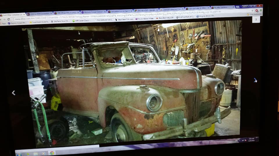

    I have a 48 Ford 4 door Sedan that I am growing tired of. It has the typical SBC, 350 Turbo Hydro, 9" conversion with Ch***is Engineering parts, and a dropped axle. I have found a 41 Convertible that is local, but is somewhat rough. Is it possible to install the 41 body on my 48 frame, using my 48 front fenders (front clip) and various parts off my Sedan? I'm pretty sure Sedan rear fenders are not the same as Coupe/Convertible. The envisioned result would be somewhat like a roadster, no windows, and no top, no missing expensive convertible parts to search for. Here's a picture of the hulk convertible. 77356844_2639203639507237_7003454933638840320_n.jpg

    Would be an interesting project. I will be watching to see who chimes in.
    But I have to say, rough in California is certainly not considered rough in a lot of the rest of the country, when you said somewhat rough, I pictured the lower half rotted away, falling over the frame. It looks restorable to me from the photo.

  3. Please don’t butcher that convertible.

  12. T&A Flathead
    Joined: Apr 28, 2007
    Posts: 1,986
    T&A Flathead
    Any more pics of the ‘41. I used a junk Tudor to save my convertible. All I used from the Tudor was the complete floor and rear inner fenders.
