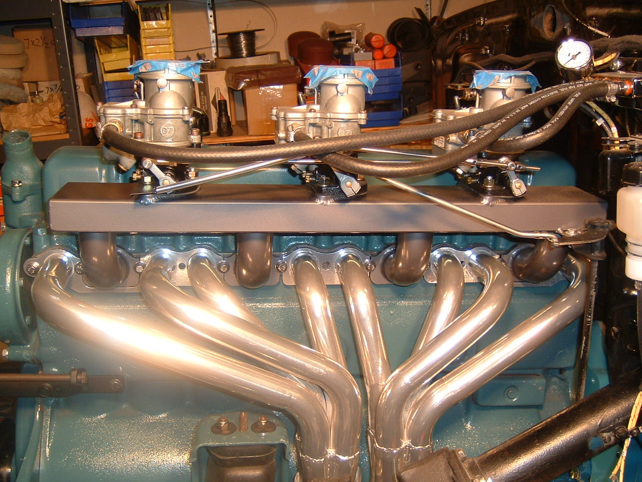

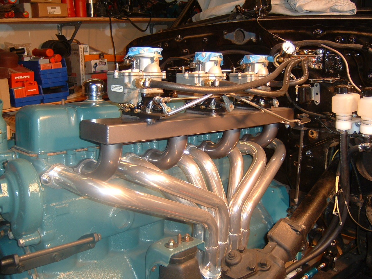

  13. [​IMG]
    Here's Bryan Blake's 1936 Century. May be a little inspiration for you.
    I'll be making a set for my Dad's 1952 Roadmaster with a 320 when I get back home. I'm going to go ahead and split it, I want to hear that 320 with duals out the back. :)

  16. What a cool post about these wonderful inline 8's. Appreciate the pix posted by others with the set up. That yello racer would be a blast to hear tear up the drag strip. ~sololobo~
  17. Nick Flores
    Joined: Aug 13, 2009
    Posts: 1,358
    Nick Flores
    Bryan's yellow 36 sounds pretty damn cool. I'll try to remember to take a pic of the headers going in his Dad's black 36 Century LSR car. That set is really neat.
    Have a listen. The Buick is pretty much all you can hear in this video, from the same day as the above pic.

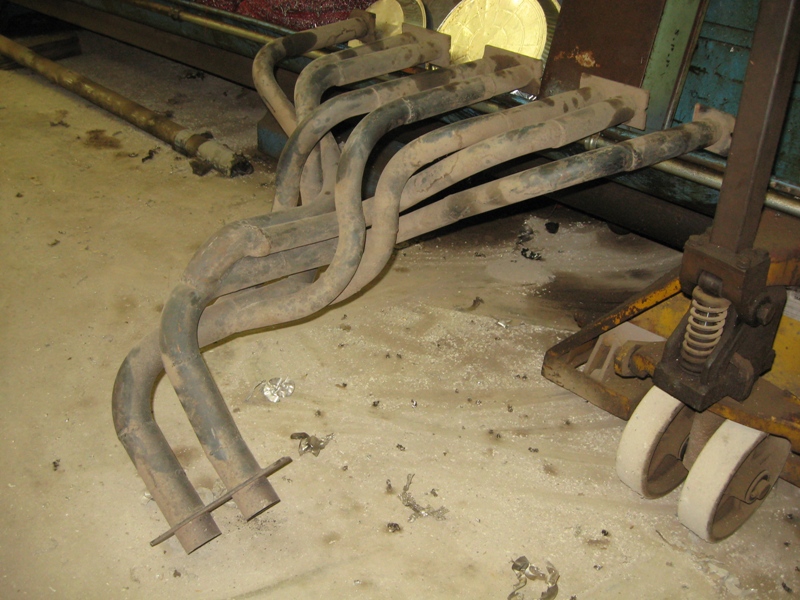

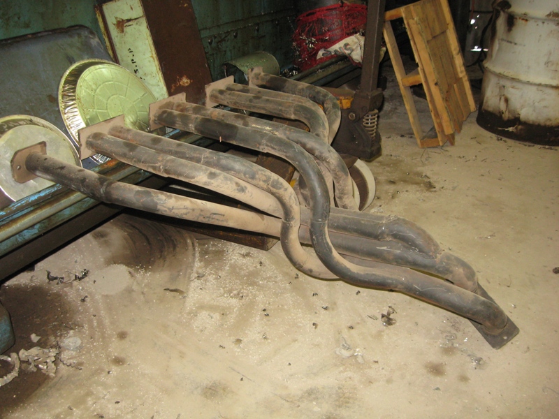

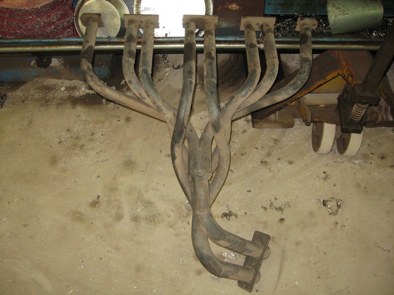

  21. Nick Flores
    Posts: 1,358
    Nick Flores
    I mentioned these earlier....
      240.8 KB

    Of all the examples pictured, those are the only ones that take the middle four ports into one pipe and the outer pairs into another. As I believe Buick used the more common 4-4 crank configuration (rather than the rarer 2-4-2 configuration favoured by Packard) the result of this header pattern should be identical to a V8 rumble.
