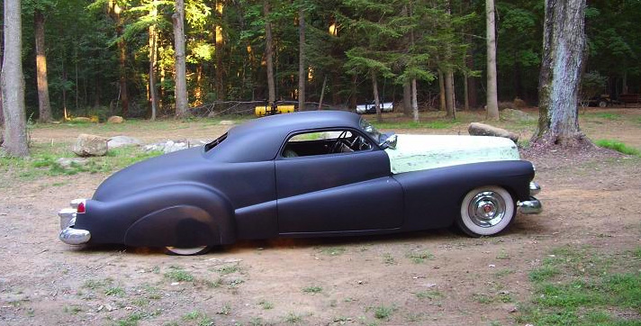

    Here is a pic of one of my favorite 41 buicks chopped 3.5 in the front and 4 in the rear. Perfect amount imo.

    I don't like the loss of the rear quarter windows and I think it shoulda come down more in the rear with the rear window tilted a bit more forward. I have seen a few pics of that car around the net. Nice one...of course it's real easy to criticize someones ride that actually took the blade to it when I'm asking for help on my stocker.

    S****ers CC Mighty Sam`s 41 is a wonderful example of a cl***y kustom!The chop is right on,you should find some pics from Riksters kustom car site.

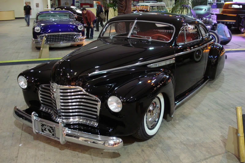

    As mentioned before, S****ers CC 41 Buick coupe is as nice as they can get in my opinion. Beautiful lines.

    Orn,thanks for adding the photos.According to Rolls&Pleats article(issue#26)it is chopped 3 inches.

    The three inches on the S****ers CC car looks to be perfect. It brings the roof down and gives the car great lines. I've always liked the lavender car too but cutting it anymore than that just would give it the "fat gal sat on it" look.

    Here’s another bad*** 41. My absolute favorite over all 1941 Buick’s is Herb Ogden’s custom Roadmaster.

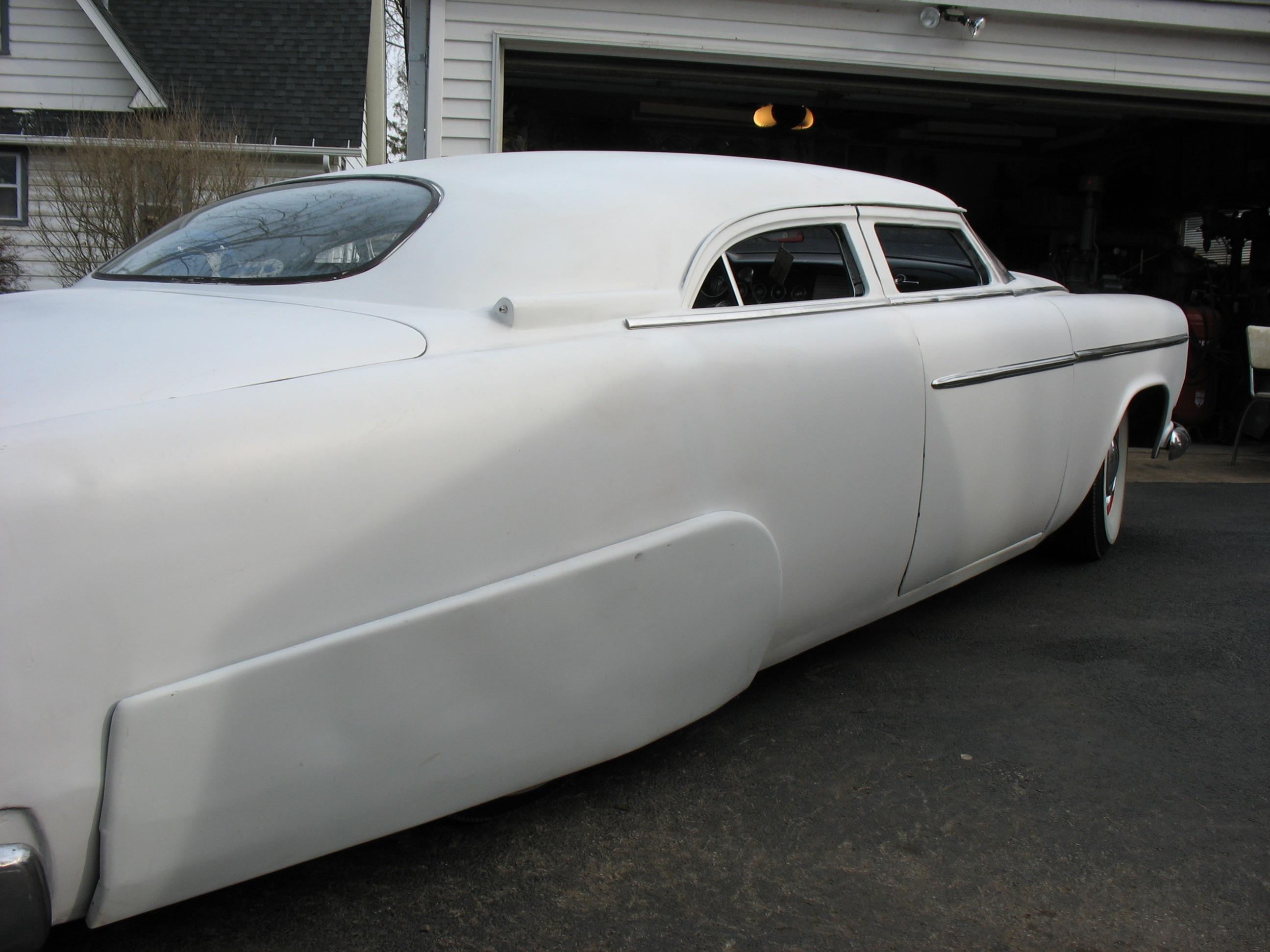

    Here are some shots that I swiped from Riksters website. The first one is one that Chad S sent me...it's a photoshopped '41 Cad, but obviously translates to your '41 as well. The profile on this one is pretty damn close. The second is another '41 Cad that kustom7777 on here was building. Rear quarters are filled, but I think it works on this one with the fadeaways. Anyway, just some more reference material.
    I've got a '41 Super as well, and I'm also going the custom route. To be honest, I love the lines of the car so much I wasn't convinced a chop was necessary. But when you look at Mighty Sam's car and the green one below, a nice MILD chop on those cars keeps the proportions in line and makes for a really cool, slippery profile. The Ogden car was a pretty severe chop, but the Carson top visually adds some weight back on top and balances the body.

    Here are two more shots of Mighty Sam's car from another post here on the HAMB (look for the SINS photos after you do a search for Mighty Sam). This car ALMOST looks like it isn't chopped. Much like the mid-60's Rivieras, mild seems like the way to go in my opinion (and we all know what they say about opinions).
