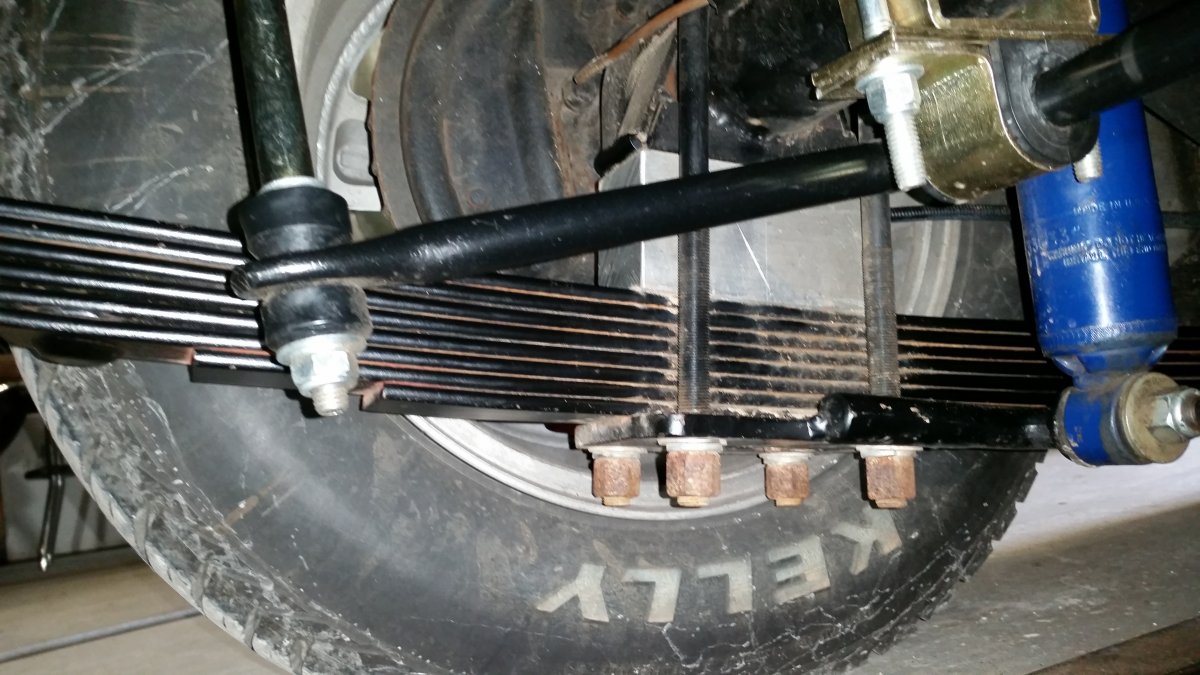

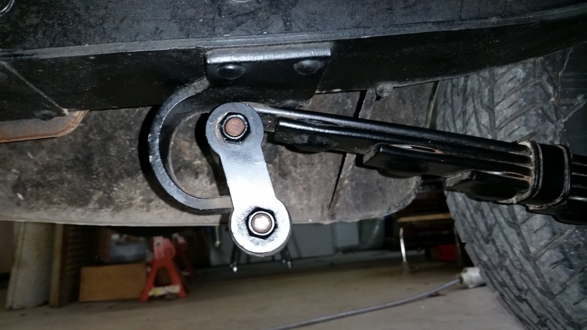

    Out of curiosity can you post a pic of the shackles of the rear spring? The size of those 'lowering blocks' makes me think the shackles have been installed incorrectly, as were mine by a previous owner along with everything else to compensate.

    Those " lowering block perch" Is sold by 4 x4 parts companies for beefing up springs in jackem up trucks. It's over 8 inches long. Ideal for flatten out and firming up leaf springs but not for lowering.
    I've cut them off flush with the bottom of the axle and welded 1/4 inch flatbar in it's place (With a 9/16 hole centered to accept the spring bolt.) A normal lowering block is much shorter and will let the springs do their thing.

    Well the latest on this dumb ass rear end.
    The perches were removed and 2 inch lowering blocks put in. Rear end re installed and it' still sitting high.
    I took out 2 more leaves and sat it down. Still rock hard and sitting high, that's when the light came on.
    The last owner put 9 leaf truck springs in it. WTF!!!!
    Tomorrow I'm pulling 1 more leaf and checking scrub lines to see if I can pull off 3 inch blocks. If not, it', time to order up some springs! Getting tired of this bull fuddle!

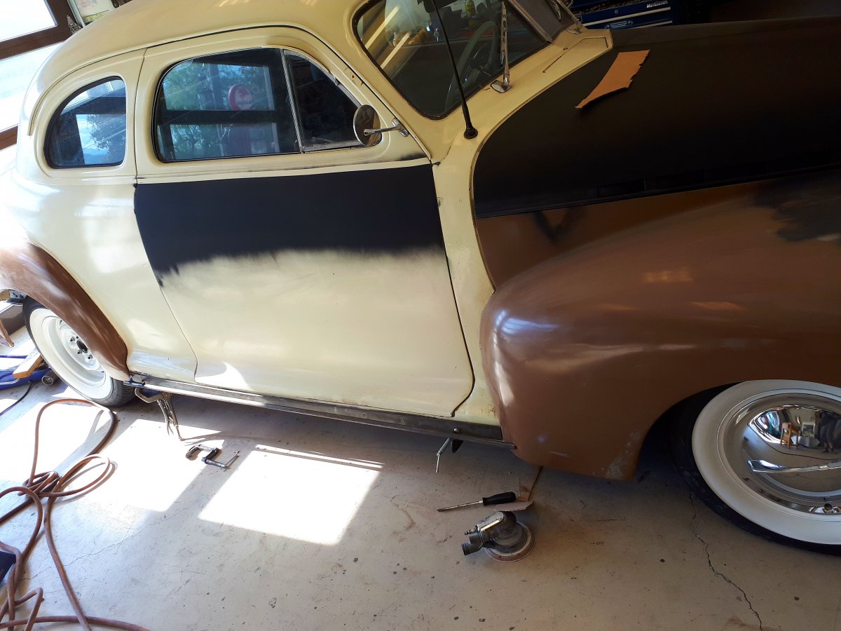

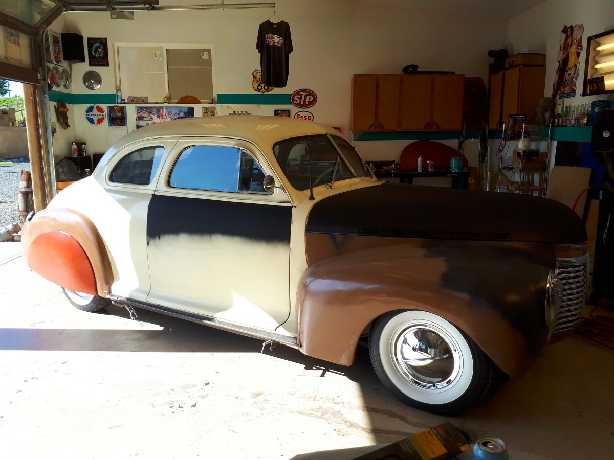

    Measuring out running boards.
    Visualizing then running half way up the front fender, extending about an inch out and back to the rear, again apprx half way down the front of the rear fender.
    They'l have a dynamic stream line look.

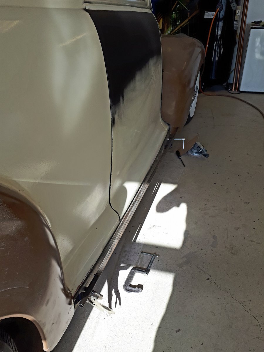

    20180511_170216.jpg 20180511_170151.jpg 20180511_170100.jpg 20180511_170216.jpg
    Thanks Mo for the vote of confidence.
    I mocked some of it up for a better look.
    Finding the right length and the angle of the waterfall of an original 39 style took a while.
    I know traditionally the idea was to eliminate running boards on customs but they were only available as an opton on super deluxe and looked nothing like this. So, it' aeroynamic running boards (with working lakes pipes).
    Tomorrow it' install the lowering blocks and then onto filling the rear fenders and making these.

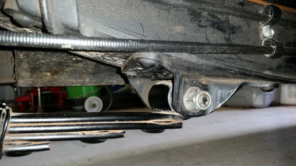

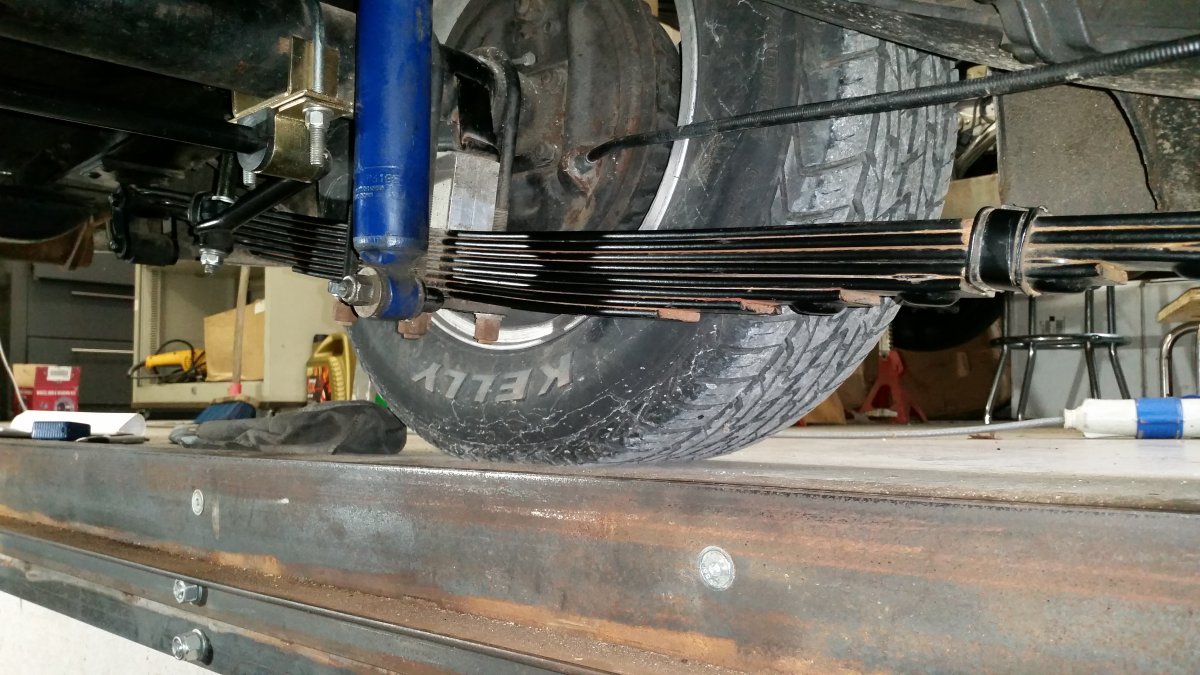

    Here's those dimensions etc. Will try and load some pics too, but that's not usually successful!
    Springs are Posies 201 A. The rear fender arch sits 24 1/4" from the ground. Tires are 25 1/2" diameter (15" wheels). Eye to eye the spring sits at 48 3/4" and spring top to centreline of the eyes is 1 1/4". The spring pack is 2" thick in the centre. I'm using 2 1/2" lowering blocks and the spring saddles are 1/2", so the spring top to the bottom of the axle tube is 3". Axle tubes are the usual 3" (10 bolt) and I have a hair over 3" above the axle to the framerail bottom (there is no frame notch).
    20180512_163458.jpg 20180512_163516.jpg 20180512_163516.jpg 20180512_163537.jpg 20180512_163448.jpg
    I've got some 'before' pics somewhere but I can't find them.
    Hope this helps you sort your spring choice / ride height!

    A happy day. 3 inch blocks in the back and it' now got a 1.5 inch rake. Time to move on and revisit later. A set of those Posey springs may be on the way.

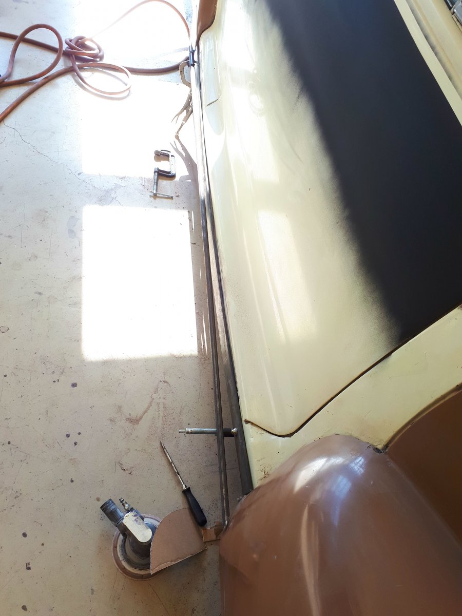

    Tubes welded in
