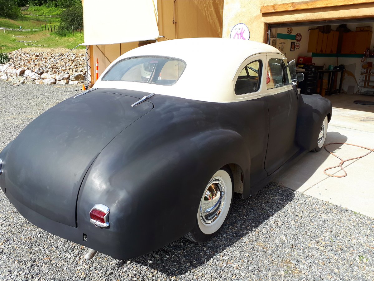

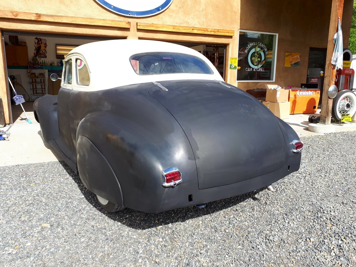

    Onto the passenger side and Beek today. Then it' long block the high build primer.
    Contemplating the rear panel, if I should weld in a new segment ( no rear pan available) or tighten up the space between body and bumper. Might even get rid of that chrome pimple on the rear fender.

    Found a temporary colour (sorry, I'm really tired of flat black) I'll shoot for this summer then after the chop, it' forever colour.

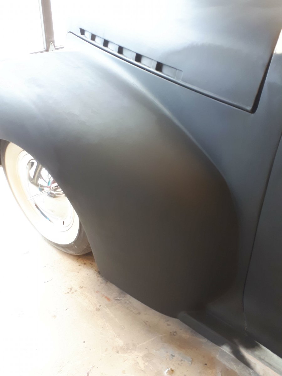

    The welded fenders look great. will you be rounding the rear hood corner?
    I'm glad you're not in a hurry to chop. It's plenty nice in the meantime.

    Thanks, I'm loving the smooth lines too. The chop will happen over winter and will be a sloper style when done. I have something else planned for the roof I'll show off when it gets underway.
    I'm going to start the rear pan extension tomorrow. I'll bring up the bumper snug and the licence plate will hang below and behind the bumper in the center.

    No English wheel in my shop so to make a roll pan that follows the body rather than being ugly flat.. lots of slices and tack welding. 20180613_113633.jpg 20180613_122829.jpg 20180613_133707.jpg 20180613_133830.jpg

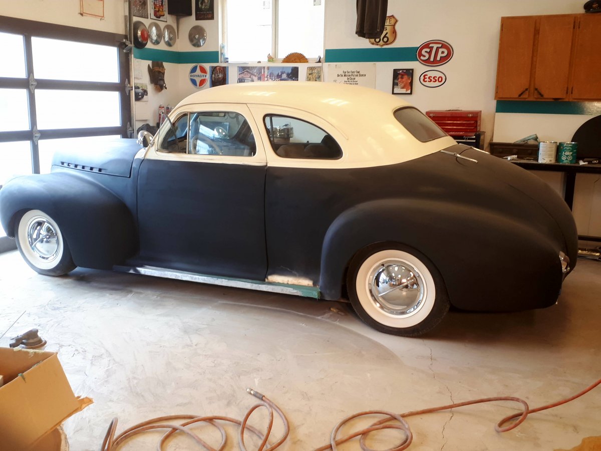

    Skim coat of butter and sitting overnight.
    Tomorrow the gas filler gets moved and welded up. After that, the roof gets sanded and she'll get shot in lacquer to keep till next summer.
    I'll miss the fathers day show I wanted to get to but a big one on July 21 is a go.
