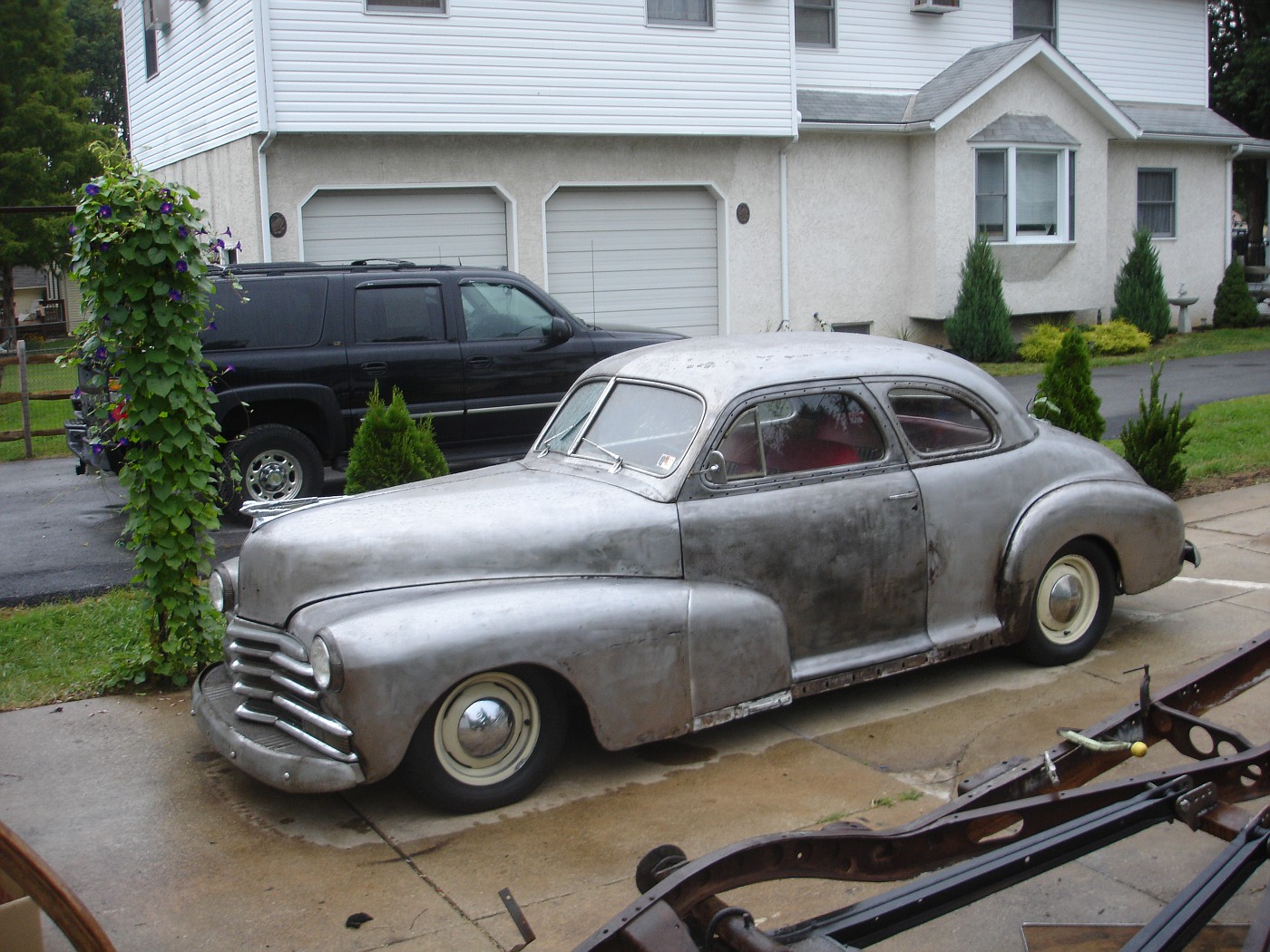

    my BNL chevy (47 chevy coupe) runs posie springs and a 79 nova rear..
    stock 50 chevy 5 lug wheels and a driveshaft from a 55 chev (shortened 1.5 inches)
    and it sits like this..

    not to hijack, but what did you use to get you car to bare metal and shine so nice? im trying to do this on my 39 olds and im not having very much success
