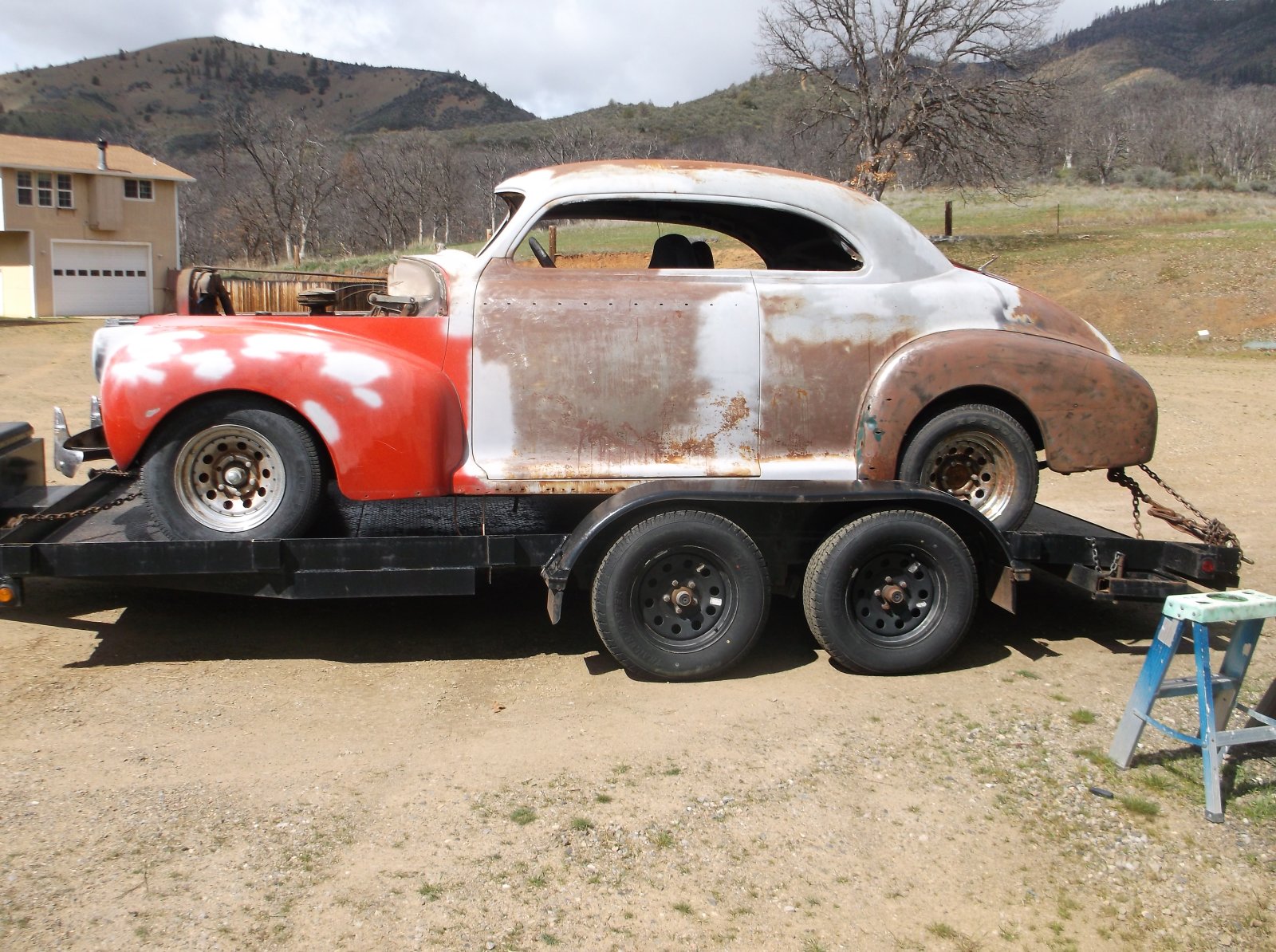

    so i just drug a new project home .all stock 216... no key . anyone know how to remove the ign. cylinder with -out butchering it DSCF6383.JPG id hate to use the dent puller . my normal m/o .has the original theft proof .wire shield . and i at least want to keep it in tact . thnx , bill
