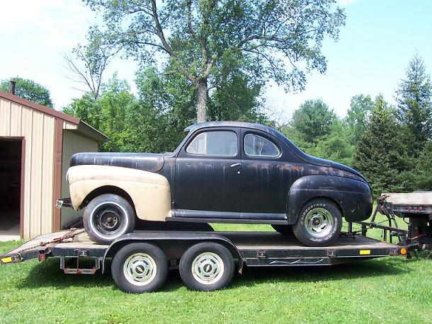

Customs 41 Ford Business coupe Chop or no Chop
Discussion in 'The Hokey Ass Message Board' started by Mr.Musico, Jan 19, 2010.
Chop or Not?
Poll closed Jan 26, 2010.
  1. Chop it
    64.8%
  2. Dont chop it
    30.5%
  3. Chop suey
    4.7%

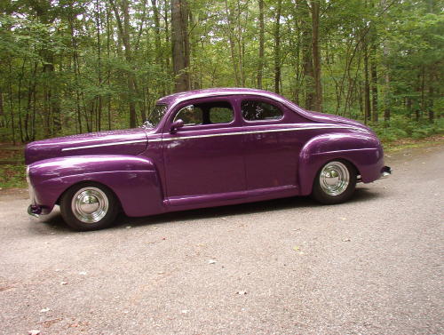

    Side shot of mine. It's chooped 3 1/2 at the B post more frt and back. Be carefull not to chop it too much and end up with a cartoon car.
