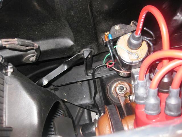

    This shows one of those brackets fastened to where the V bracket would be bolted to the inner fender panel.
    In this case, the V bracket has been replaced by angle iron brackets.
