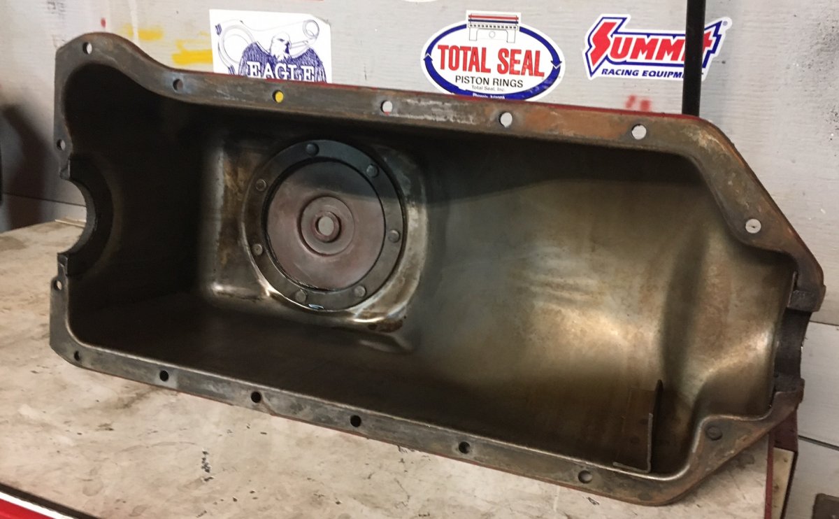

    While waiting on the rebuild kit for the trans, I took a look at the engine. I knew it was dirty inside, but I wanted to get an idea of how worn out it might be. There is only about .004" ridge at the top of the cylinders, but 1/2 to 3/4 of an inch of sludge in the pan and plenty in the valley and maybe a burnt exhaust valve. So far I cleaned the oil pan.

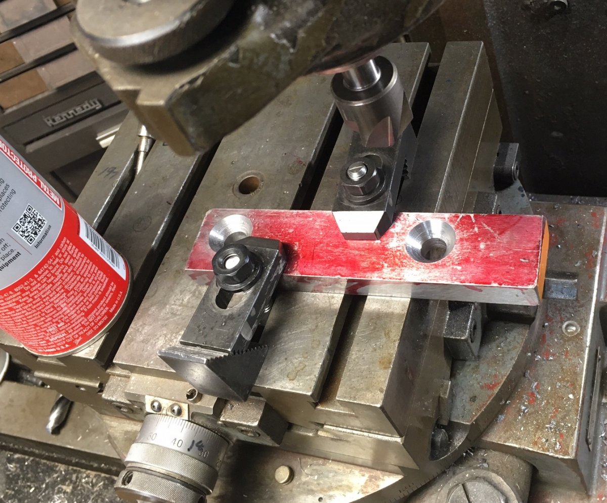

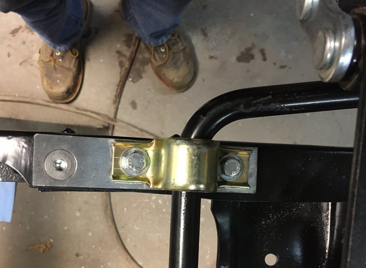

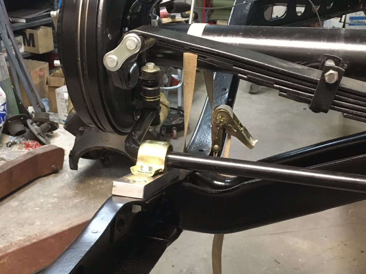

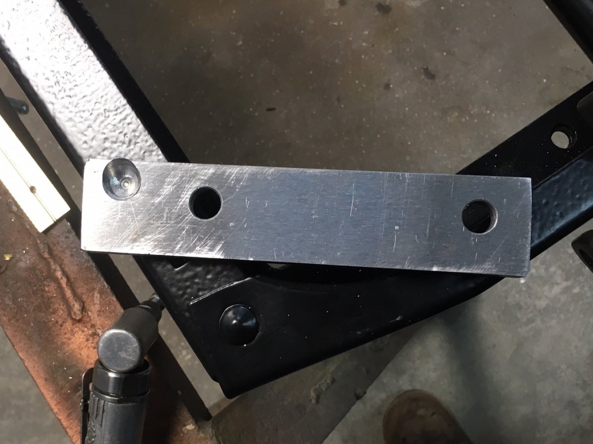

    I finished installing the rear sway bar. I made some spacers that bolt to the frame through the original shock mount holes. I drilled and tapped holes to bolt the sway bar clamps to.
    IMG_1843.JPG IMG_1844.JPG IMG_1845.JPG IMG_1846.JPG IMG_1848.JPG IMG_1849.JPG IMG_1850.JPG IMG_1851.JPG

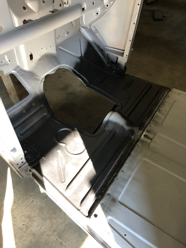

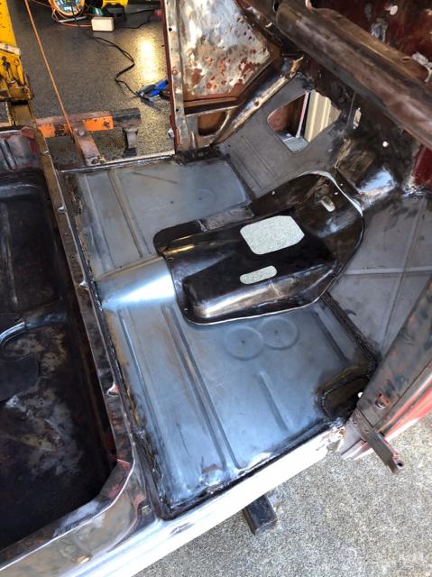

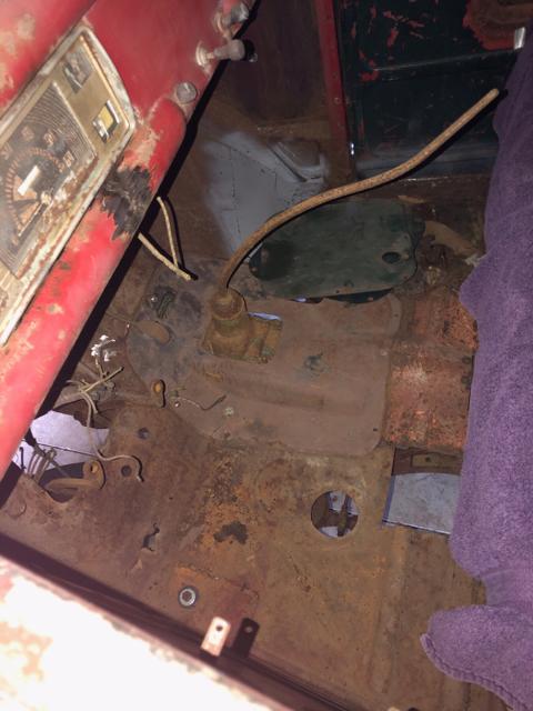

    I put the new floor pan on the chassis to make sure I have clearance where I think I do. I had to move one brake line a little. I wanted to see where the brake pedal sits at the top. I know I have to shorten the push rod a little and I get full travel in the master cylinder.
    IMG_1880.JPG IMG_1879.JPG Top is the toe board insert panel that came with the truck, however I don't think its correct for 40-47 cab. The patch panel isn't that accurate either. It would be great if someone had a picture of what it's supposed to look like.

  12. Here's mine.
    loudbang, warhorseracing and Thor1 like this.

    Thanks for the quick reply. Do you happen to have the plate that goes into that recess and has the cutouts for the clutch , brake, and steering column ?

    I feel that I should explain why I'm fussing about this. I have replaced the original M/C with a dual chamber one with a 1" dia. bore and it's going to take more pedal travel to push the same amount of brake fluid. It's not an issue when everything is new, but as things wear, I might run out of pedal travel ;even though the shoes are adjusted properly.
    IMG_1884.JPG Nasty but matches yours.:)

  16. I’ll look and let you know, since I didn’t use stock pedals or steering column location.
    Is that not it in your previous pic?

    That is what was in the truck, however, I suspect it was made for a later cab 48 and up.The cutouts for the pedals are recessed and with the rubber pedal bumpers It may limit pedal travel. I can fab something, but I'd like to know there is no simple fix before I do. Thanks .

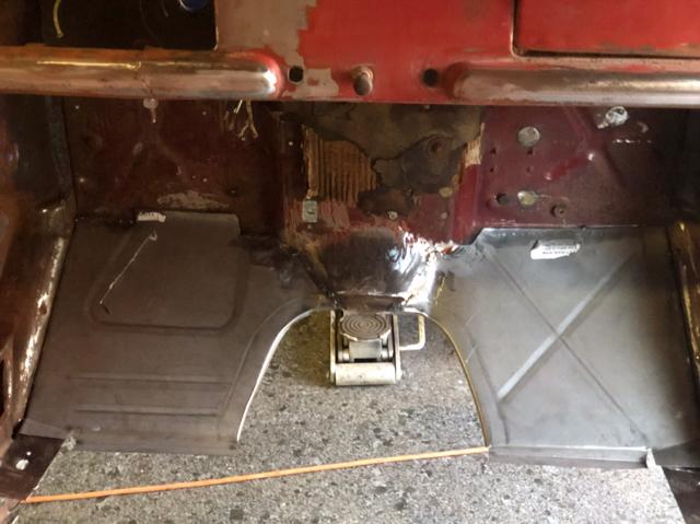

    I purchased those same panels and agree, not the greatest fit but in my case, my original Floor was paper thin and the wire wheel was showing all the real damage. The floor even had a crack in the shape of a boot where the gas pedal was. Here are some pictures of mine in case it helps you.
    [​IMG][​IMG]
    loudbang, The 39 guy, hotrodA and 2 others like this.
  19. Here's mine. Looks like yours, only repro, and the tag says 40-41. Had a used gennie one but can't find it right now.

    Yes ,64pony, it does help. Thanks for taking the time to post the pix.

    That's funny because I found a listing for the same piece as 42-48 p/u. It will work in 40-41, because mine did. Thanks for digging that up and posting. Actually, it changes how much of the repair panel I will use because there is no point in saving that original opening. Thanks again.
