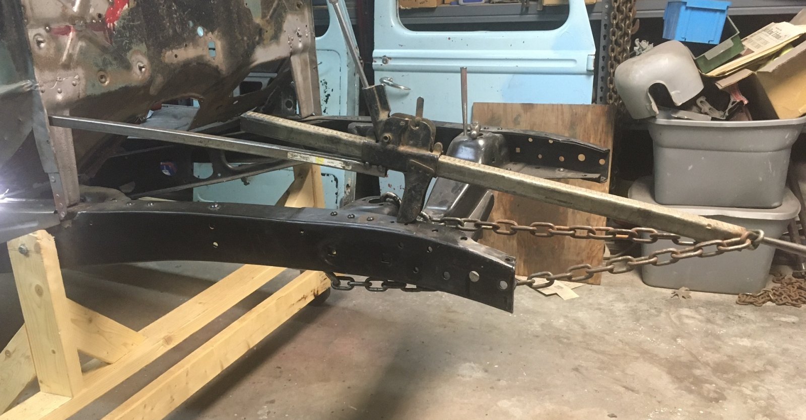

    I'm back; there is more story than progress. To make it short, I went to the passenger side to repeat the attachment I did on the drivers side A pillar. After some trial fitting and head scratching, I cut the hinge support loose from the floor; I couldn't " get there from here ". I finally determined the A piller was twisted and the hinge bracket needed to move 1/8 in. maybe more.
    IMG_2144.JPG I cut the tubing loose, so, I had to put the 'ol bumper jack back in service.
    IMG_2145.JPG I just transferred one hinge screw hole ( only one to fix if it's off).
    This piece was a weld up copy of the piece from the other side. It is a little off, but I think fixable. More later.
    Thor1, Hamtown Al, 40FORDPU and 5 others like this.

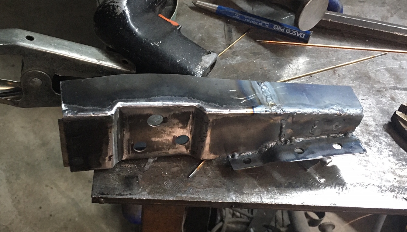

    I've been cleaning up the yard ( leaves) and re-organizing in the garage also. I have had to study possible fixes on a hit and miss basis.... what about this and could that be off or how do I straighten / realign those two pieces?
    I have been using the doors to check the lower hinge position is correct, however, I have been considering removing the door skins so that the inner structure for the door can be repaired where the lower hinge mounts. Opportunities. :)
  26. joel
    Joined: Oct 10, 2009
    Posts: 2,644
    joel
    I have nearly finished "adjusting" the weld up piece .
    IMG_2147.JPG Adding a lip to help locate to the original A pillar.
    IMG_2149.JPG lip welded and some relief cuts to correct the outside curve. The cowl skin is spot welded to the curved side of the A pillar.
    IMG_2152.JPG test fit.
    IMG_2153.JPG The 90 deg flange is back on and mostly welded.
    IMG_2154.JPG IMG_2155.JPG 2 thumbnails of the edge and back side of the piece. I'll try to get it attached to the pillar and the floorpan next. Maybe tomorrow. I need to hang the door one more time before I can tack to the floor.
    Thor1, Hamtown Al, V8 Bob and 6 others like this.
