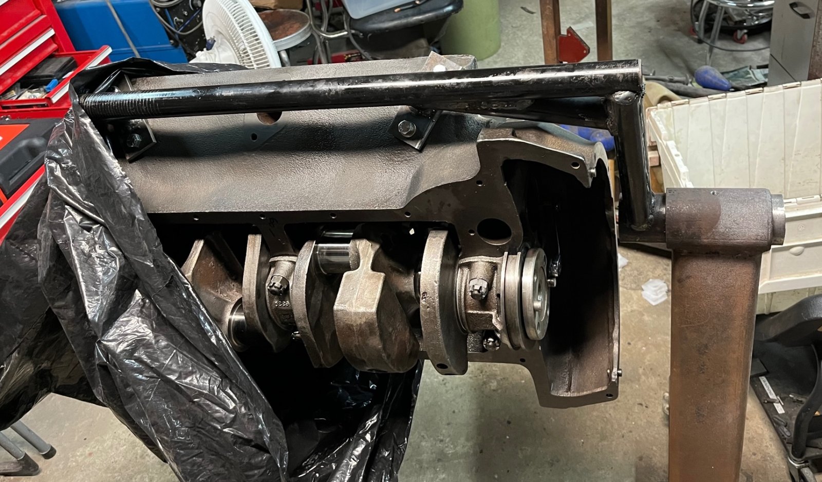

    IMG_2438.jpg Except the #8 intake. They are all installed now.
    I re-installed the crank and Checked the rod bearing for fit and side clearance. I made a spool to hold the bearings and cut .008-.010" off each set.
    IMG_2442.jpg I'm re-cleaning the piston ring lands and the rings and hope to install the pistons in the next few days.
