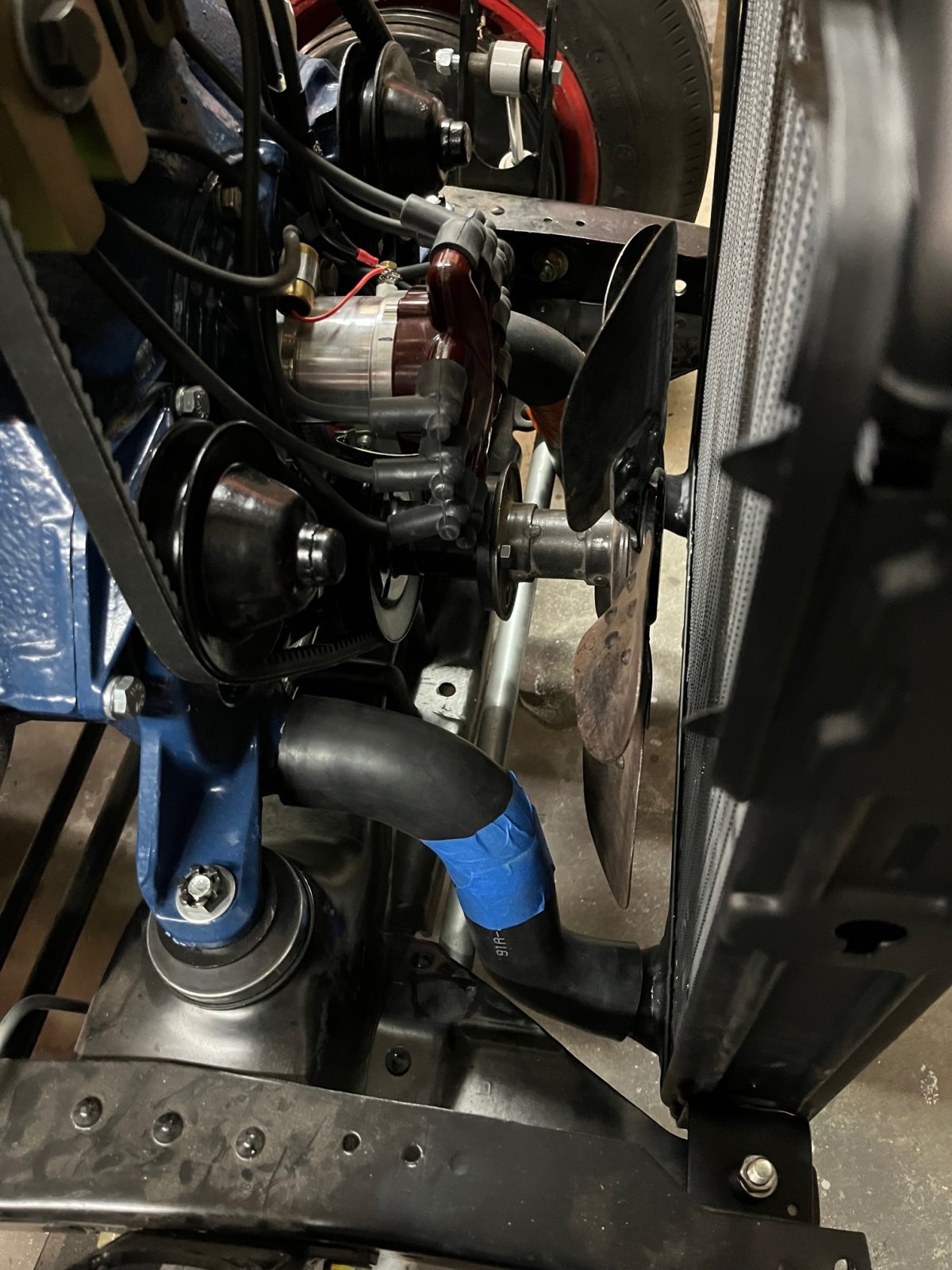

    The big news is that I started the FH, however there are a couple of setbacks. There was a wiring problem to fix and V8Bob found the the problem for me. I fixed the wiring and it started, but with only a floor fan blowing through the radiator, it warmed up pretty fast and I had to shut down. The temperature on both banks came up together and oil pressure was 50 psig then dropped back to 40-45.
    The temp. got to 190 and I shut it down. Total run time < 10 min.
    IMG_2624.jpg Note the orange tape on the radiator hose.
    IMG_2625.jpg Temporary run stand.
    IMG_2626.jpg Throttle rod with vise grips to hold RPM around 2000.

    The orange tape on the radiator hose is where the fan blades "skinned" the hose . The fan blades were not all rotating in the same plane. I tweaked the offenders into line and checked hose clearance while cranking with the starter . Clearance is 1/4-5/16 in. The new hoses should be here tomorrow.
    I'll post a video of it running. IMG_2622.jpg IMG_2623.jpg [ Pictures after straightening the fan.

    You could always build a 1/4" spacer and move that fan a bit tighter to the radiator. More hose clearance, better cooling

    Great that you have fired it. look carefully at the hoses. They might clear better if fitted the other way up. One bend is tighter than the other (from my experience).

    I got the hoses on and clear; I used the long end on the pump and trimmed the radiator end about 3/8 inch because of the non- stock sway bar. I ran it a total of about 25 minutes and set the timing at 4 deg. advance. Here is the video . I have a video , but I can't post it.
