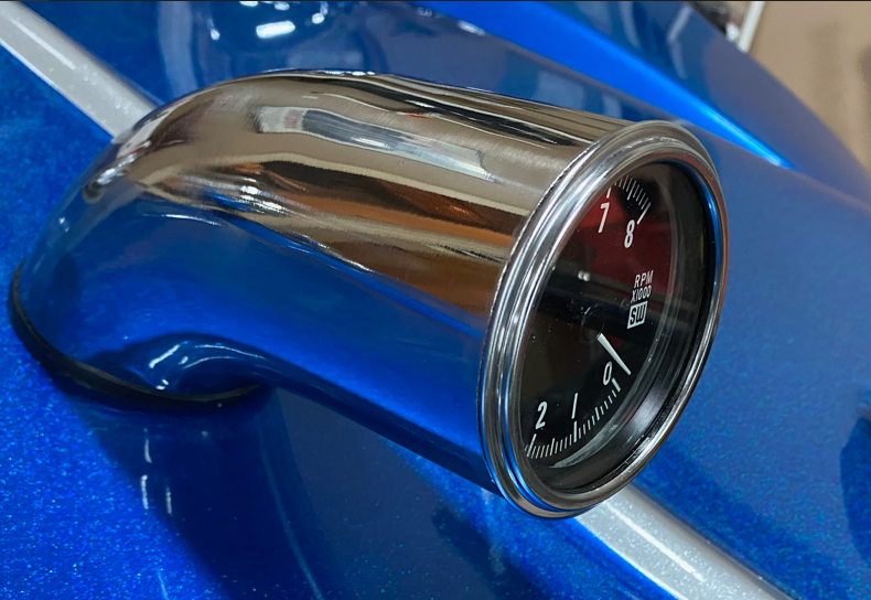

    That's a cool tach mount for sure. I stumbled into some luck when I flipped the insert over and started sorting through the parts that came with the gauges. The u bracket for the speedometer cleared the bottom row and the top row u clamp is modified so it rests on back side of the dash and helps hold the panel tight. Now I am thinking I could silicone the panel to the dash instead of more clamps.
    Thanks BB

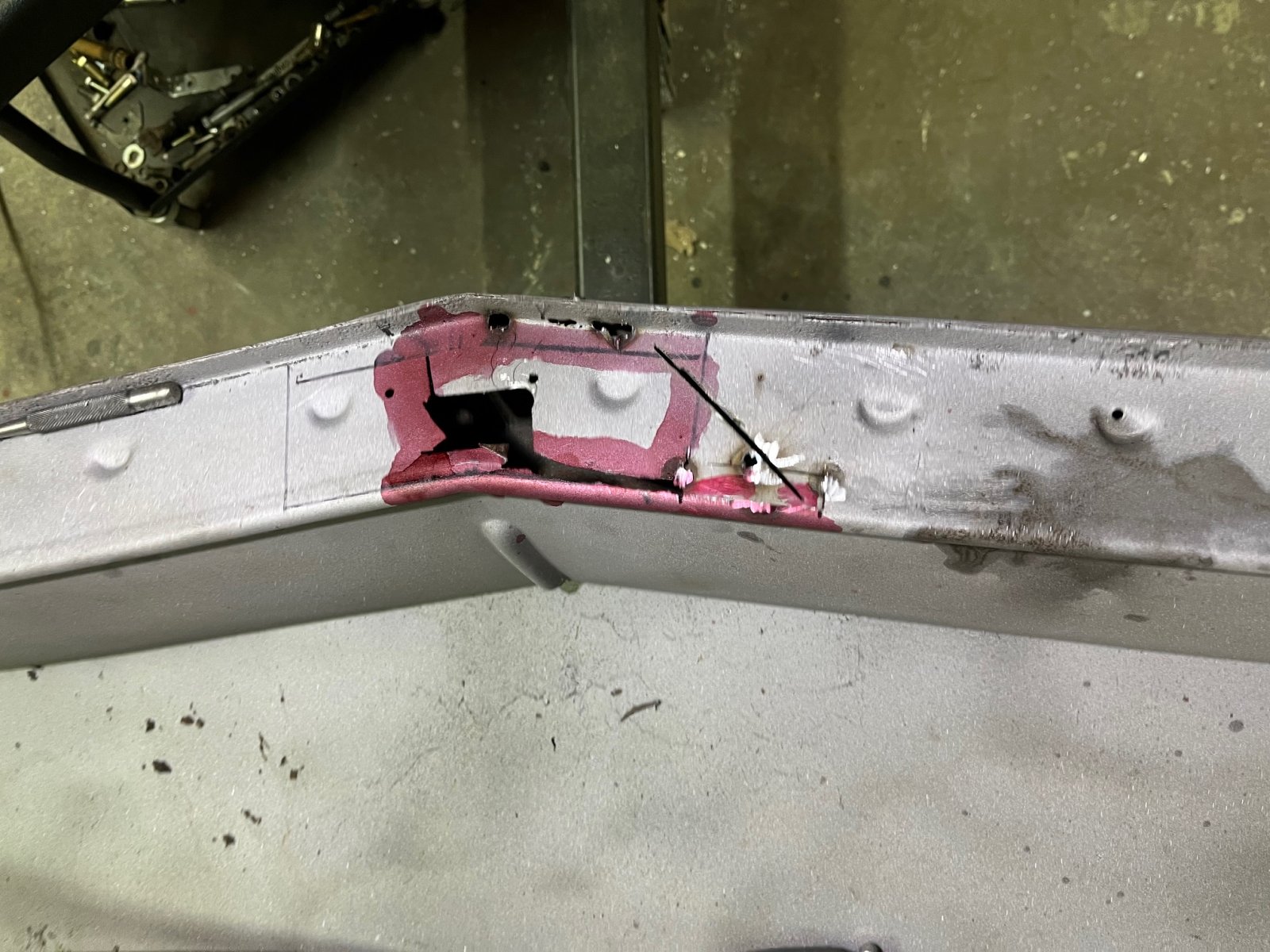

    3 months since my last post. The damage to the windshield area on the cab set me back and pissed me off. I can't solve problems without a clear mind. Here is a picture of the start of the repair.
    The damage from mouse piss is growing.
    Some trimming to do and spot welds to cut on the pinch weld. I think I will have to make the patch in 2 pieces.

    I finally got a patch for the hole above the windshield. A neighbor from about 40 years ago said he could make it in one piece by shrinking it. He did it. He was in grade school when his parents moved out of the neighborhood and I hadn't seen him since. Turns out , he is a real car guy and meatal finisher.
    All I had to do was a some trimming.
    The hole before trimming.
    first tacks; I wanted the fit tight front to rear so the weld wouldn't pull the pinch weld IMG_2773.jpg
    All the edges lined up and finish weld started. I'm going to tig the little notches on the pinch weld flange. The big vice grips are holding the roof side of the pinch weld in place against a piece of angle iron .

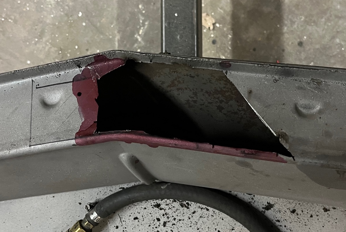

    Finally removed a rusty piece of cab skin.
    With the cab upside down, I can see better and not use a step stool. I added a piece of steel ,tacked between the rotisserie mount arms, to hold the door gaps that exist when the cab is right side up. This happens due to the clearance in the rotisserie parts that allow for their adjustment.
    First cut away and lots of trimming and fitting to come.
    I don't know how this is going to come out and fortunately, the front fender will hide a lot of the patch seam. Fingers crossed.

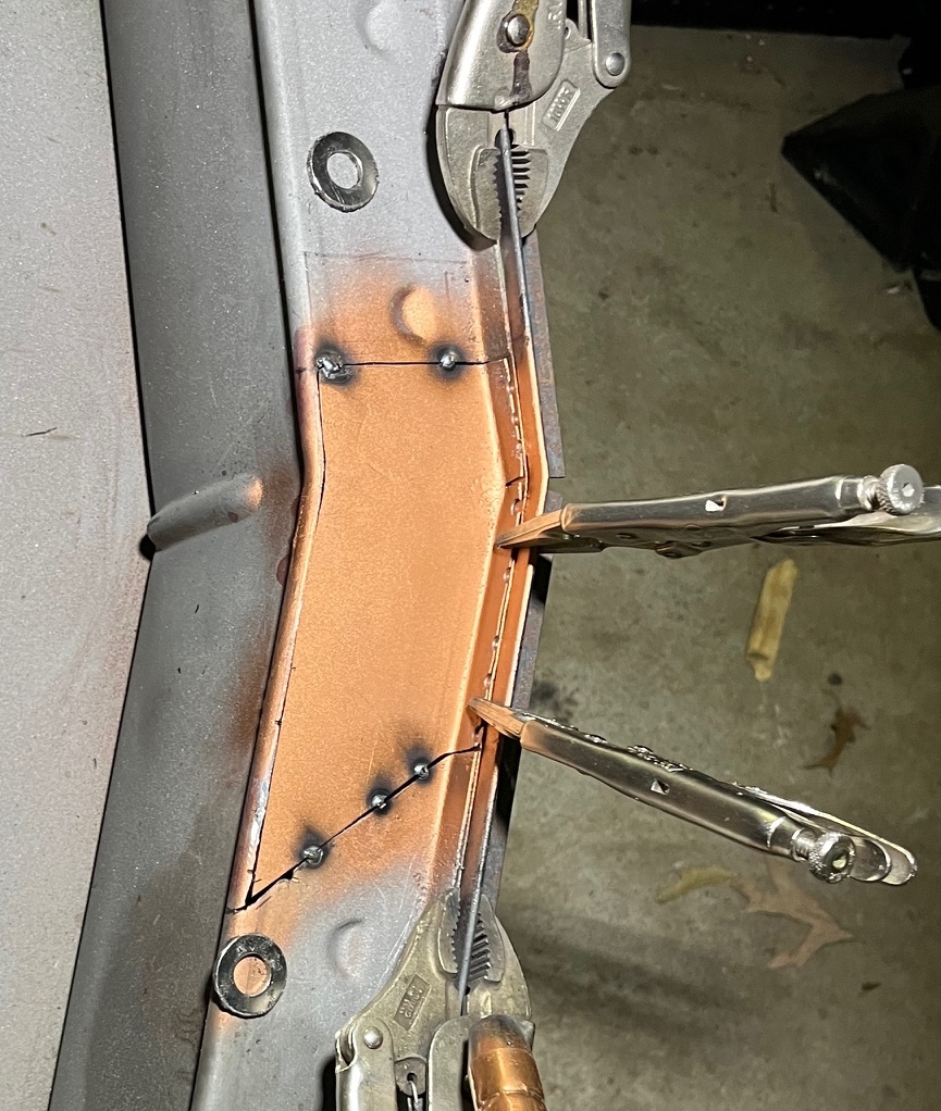

    Lots of welding and grinding, but some progress.
    I decided to add this piece from the patch panel. The re-inforcement that was here is for mounting the front fenders if the cab is used on the big trucks. Otherwise it's useless and leaves 2 open holes under the pickup fenders.
    The nasty hole in the pic (left-center) is a mounting hole for the front fender on the pickup. At least it was on mine. I think I'm about ready to tack the rest of the patch in place. Thus the copper weld through primer. On the other side, I'll do the panel all in a one piece patch.

    Yes, BB, that's the plan. I've run into a possible snag after tacking the last panel in place. I may have to back up on this side. I'm considering going to the other side to see if I can see what I missed. Opportunities.
    Here is the gap. Although badly rusted, the original had no gap; which makes me think the patch is too far out. It does line up with the door skin pretty well.
    The filler piece is because I ran out of metal.
