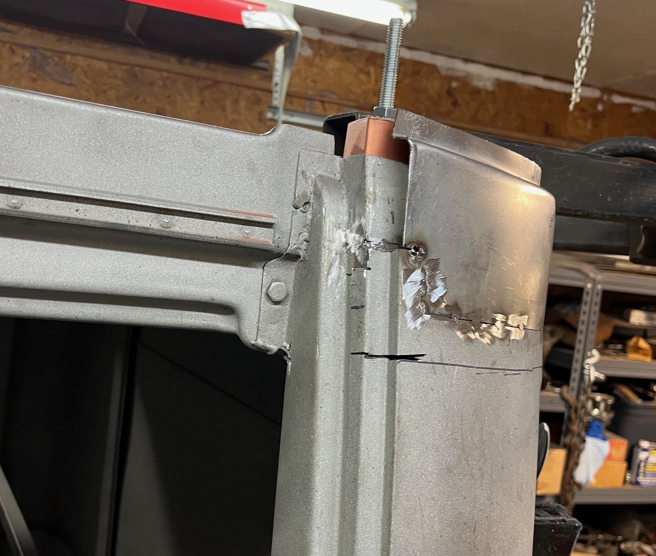

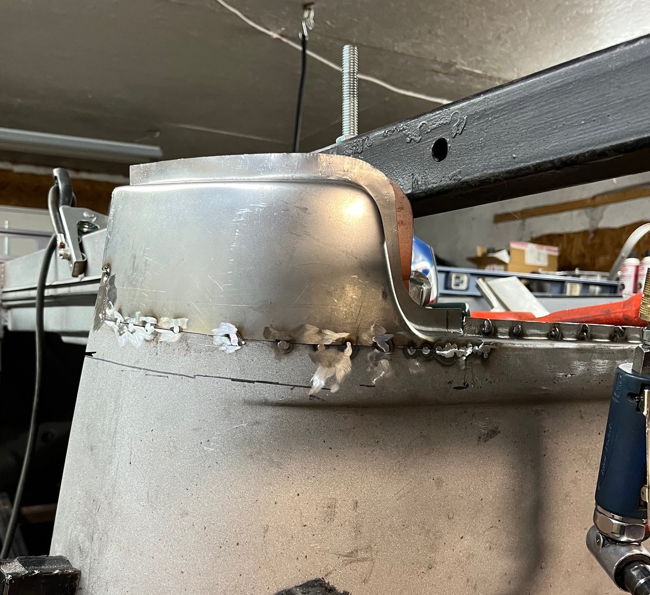

    One of the cab corners tacked in. I think I'll have to use some lead to blend where the seam is. IMG_2872.jpg
    pic is not upside down; the door is
    I have to drill holes for plug welds.
    The tacks are ground down so it will be easier to go over with the tig. JMO these panels aren't worth a crap.

    I have to agree, better than nothing but not by a large margin. I cut mine up, slit it a time or two to make it fit better and then welded it on. I could have done better with flat steel but I had already purchased them so...
    I picked up an air crimper that has a hole punch on the back, knocks excellent little holes in flanges in seconds, perfect for plug welding. Harbor Fright item, I have used it a ton over the years.

    I have a Roper Whitney hand punch that I usually use for plug welds but I wanted to use the spring in the top of the patch to correct some of the mismatch. It didn't come out as well as I hoped so there will be filler or lead. I may be able to hammer and dolly the seam and stretch the seam a little.

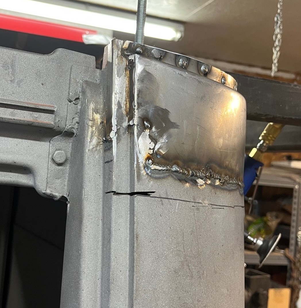

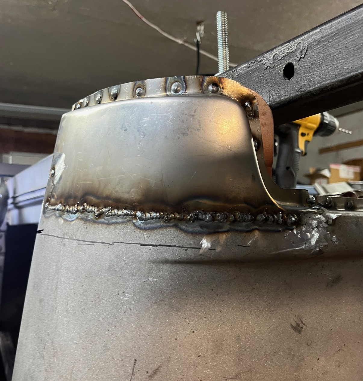

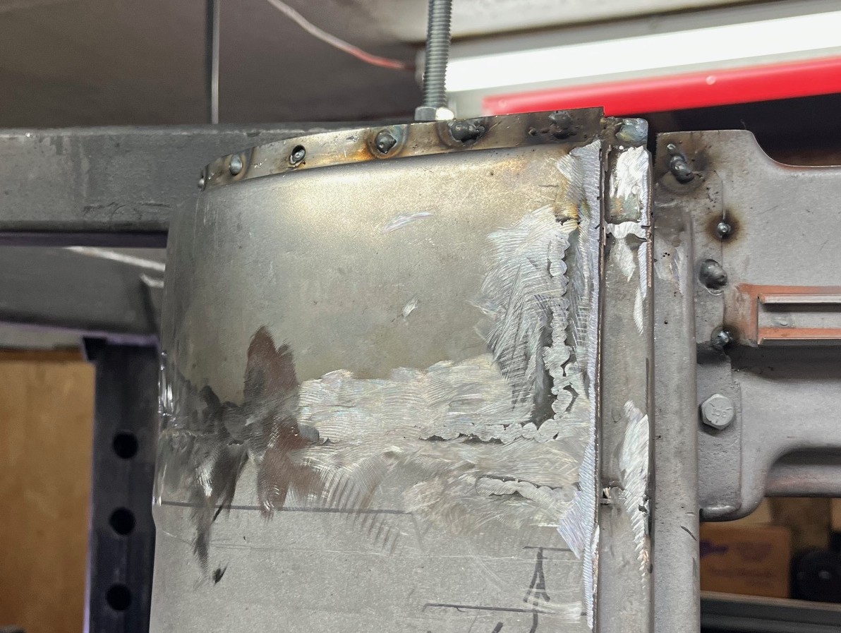

    The welding is done ok the pass. side cab corner. I definitely have some grinding to do, but I'm going to the other corner before I forget how I did the first one. IMG_2874.jpg IMG_2875.jpg IMG_2877.jpg IMG_2878.jpg

    The patch for the pass. side fit the cab better. I think when they rolled the corner they did them the same for both sides and then just put the step for the door opening on opposite sides of the roll instead of making true right and left corners. It doesn't matter now. IMG_2886.jpg IMG_2887.jpg
    I have to add the missing corner in. The corner radius was way too big, so I'll weld the corner and grind/file it to match the factory radius.

    The cab corners are welded. This side fit a whole lot better. IMG_2891.jpg IMG_2892.jpg
    some grinding to do yet. I'm going to try to do the lead before I take the cab off the rotisserie.
