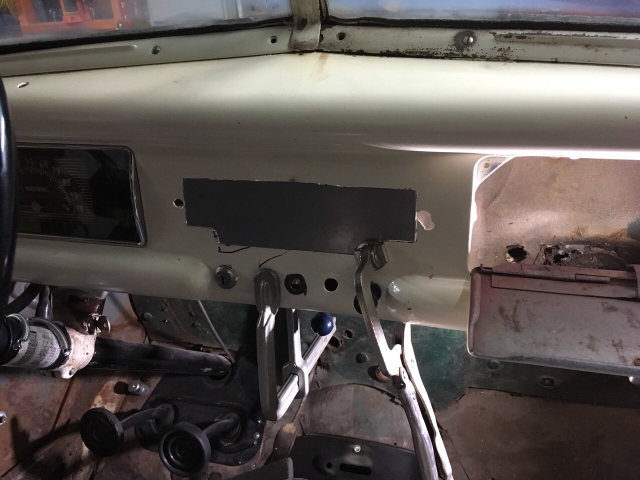

    I finished up the cowl vent with a screen and an adjustment. I’m getting my parts for the supplied air pump Wednesday so I tacked in a patch for the hole in the dash.
