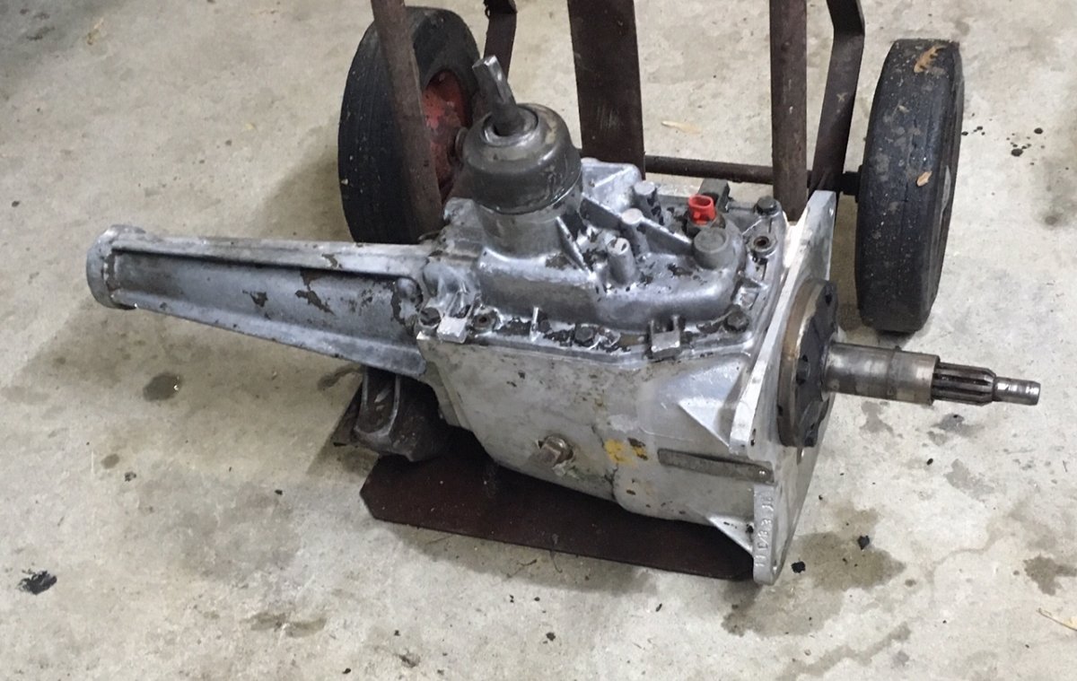

    One more little tease. This is the new trans for the truck. It took 3 Gunk applications followed by the power washer, but it's clean enough to open for inspection. It goes into all gears smoothly. IMG_1236.jpg

    What trans is this??

    The trans is a Ford Borg Warner 3sp plus O/D and is synchro in all forward gears. It was used in Ford F150s from 84 to 87. http://www.fordgarage.com/pages/TremecT170FT.htm.
    I have seen info that says they were used behind v8s also. There are a couple of other configurations used in cars with side side shift Top loader cases.
