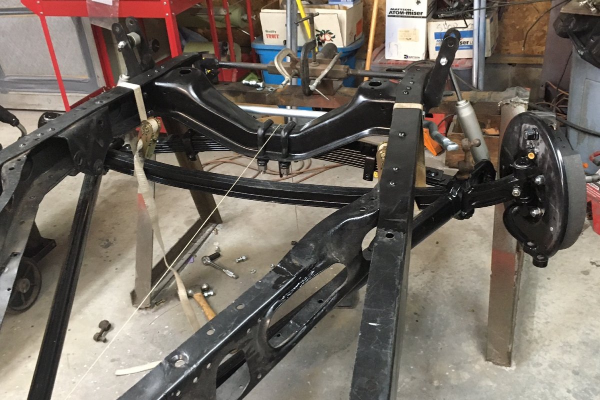

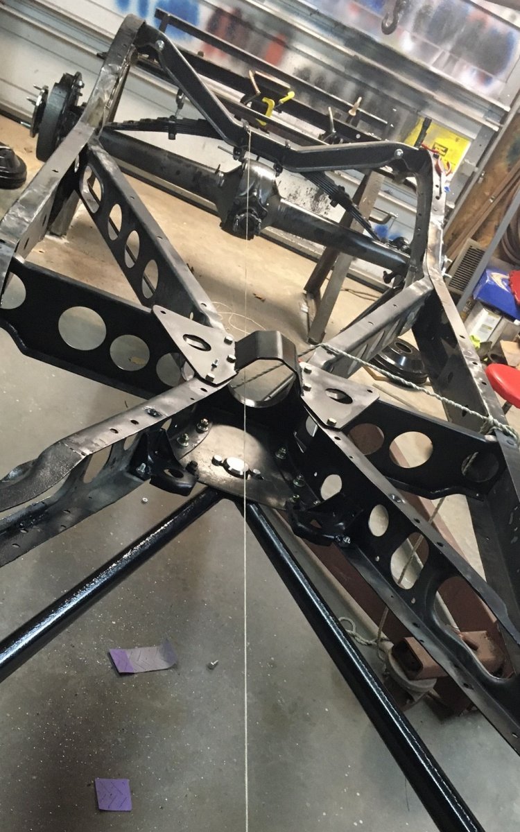

    It's 17 days since I had much to report. I have a couple of small repairs back where the gas tank mounts and I am replacing the side braces from the center of the X to the outer frame next. I bought replacements because I'm tired of bent , twisted 12 ga. I'll rivet them in also. Here are some status pics that are up to today.
    Everything so far is within about 1/16 in including the 2 rails being level with each other. I added a short section of 11 ga. boxing where the weld joints are. I figure this old girl deserved some support.
    The wood blocks were curved on the bottom to match the frame as manufactured. The patch pieces I bought were flat. I'm not complaining; without them I would not been able to fix the frame. With the welding and grinding done in that area, I set the wood up and scribed the mismatch to be sanded off. It took about an hour with the belt sander.... sand and check.
    The cab sits on the "posts' that stick up; the rest is clearance. The level is on the rear most cab mount location.
    You can see the A piller bolt hole in the foreground left and the hole for the bolt in front of the seat riser on the right. There is no block at the firewall hole. That's how you fit a flat floor to a curved frame.
    I bought a new rear spring (Posies) and installed it to see if it sits square with the frame. The cross member was welded on the back side where the U bolts go. I didn't notice this until I was well into frame repairs; anyway, it appears it may have been cracked in use and repaired. I've never heard of this, but apparently there is a rear cross member on FB Marketplace that shows this kind of damage. Has anyone ever seen or heard of this?
