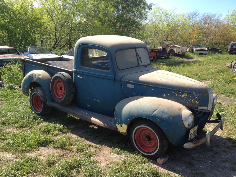

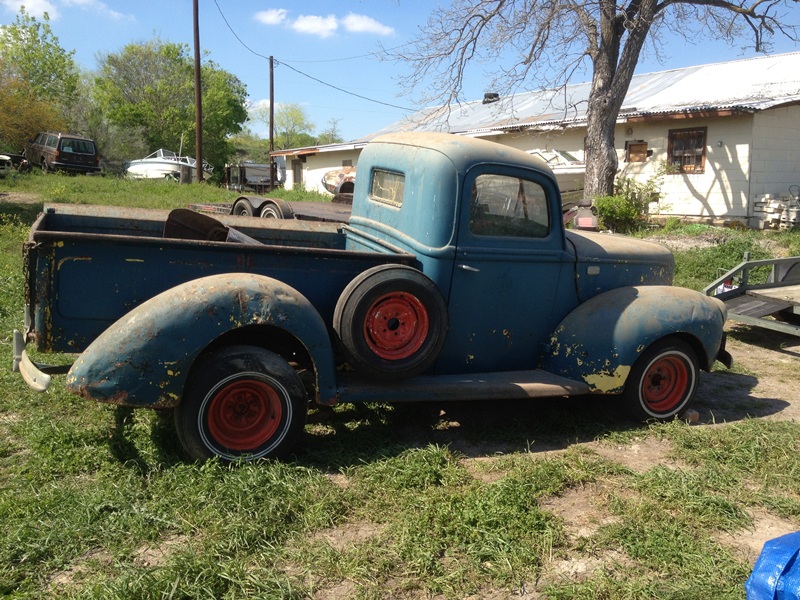

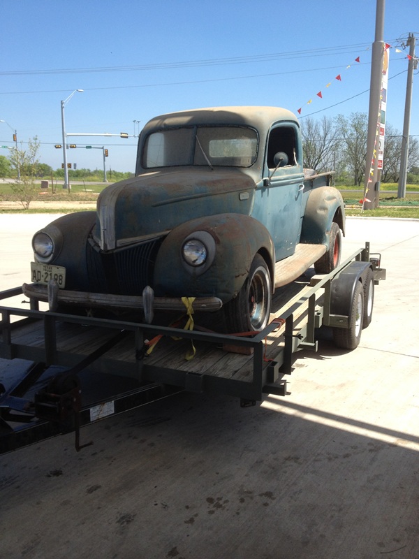

    Howdy folks,
    Started the restoration of my grandpa's '41 Ford Pickup hot rod this last Monday with Cl***ic Street out in Taylor, TX. Tear down was completed on Wed of last week and a few welds on the frame and bed bracing have been completed prior to blasting, which is scheduled for this week.
    I need to order my ch***is components tomorrow and make a decision on a rear end. I sure could use the HAMB's help. I've researched back and forth about this and I'm completely torn on I-beam split wishbone vs MII. I know the traditionalists like the split wishbone, but the MII sounds like a nice ride and is super simple. It really comes down to price at this point since I'm on a budget. Thing is, they both seem to be about the same since I'd want a new leaf up front. Planning to run 6" tires up here, likely on the stock axle if I stick with the I-beam. Thoughts?
    On the rear end, I'm thinking of using an Explorer 8.8 with 3.73 gears behind a Muncie M20 4sp since I'm likely going to keep and rebuild the current 283 Super Turbo Fire V8. Would have to do the driver side narrowing job and swap in a p***enger axle, but it seems to be the least expensive path to a solid posi rear end. I do have a correct width 8" Ford available for $200, but non-posi and the low gear ratio is not going to be very good for a high winding 283. Parts to convert the 8" seem to be way more expensive than the whole 8.8, plus I'd get free disc brakes on the back end with 95+ year models. Should be about 57" wide all said and done. Planning to run 8" meat back here.
    Any and all thoughts and ideas are welcome, and thanks in advance for your opinions and advice!
