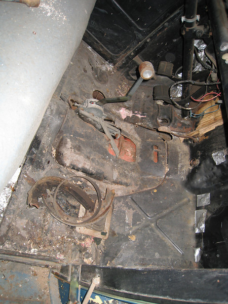

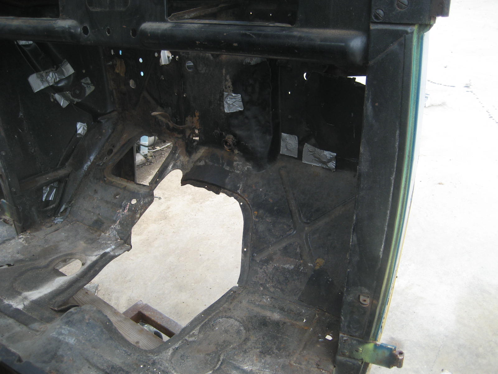

    Firewall and floor board: Well, the stock firewall is swiss cheese with a large chunk cut out on the p***enger side and then patched with another chunk of sheet steel. Not pretty. Unfortunately the forward floor pan is rusted through in several places along the edges of the raised stamps and the trans tunnel cover was ungraciously molested to accomodate the 3spd floor shifter. The whole purpose of sticking with the SBC was to maintain a stock firewall, so I'd sure like to find a good one that's been discarded.

    Here's some pics of the hacked up firewall, hacked up trans cover, and rusty floor board.

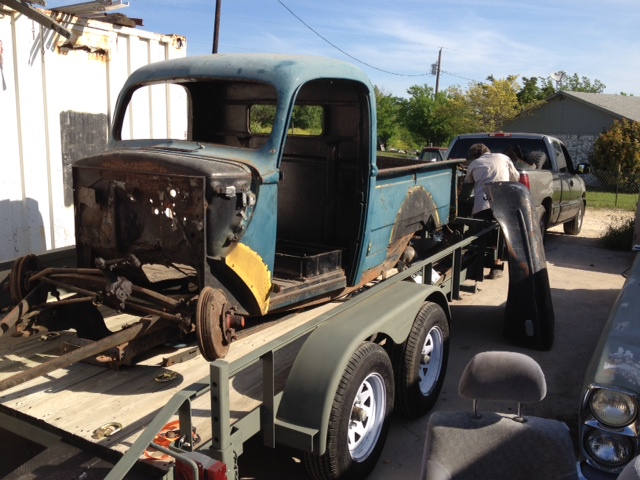

    Some pics to share; Cl***ic Street found some cancelled checks from Union State Bank in Florence circa 1948 under the seat (a fold of them being used to raise the seat actually), and here's a pic of it loaded on the trailer last Friday when I took it to the sand blaster. Should be done there by end of the week, then it goes in for paint on the ch***is and work on the body.

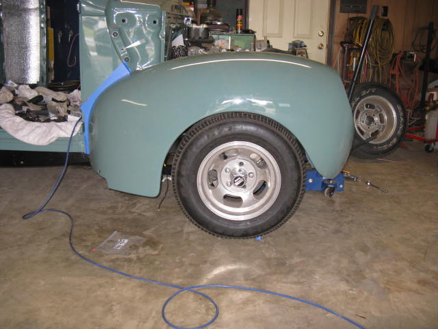

    Here are some pictures of my '41 project for comparison. It has a Sid's dropped axle that is stretched back to the original width. The axle is tied to a Posies reversed eye spring. If I had to do it over again, I think I'd use the narrower dropped axle from Sid. I think I will put a spacer above the spring to gain a little tire clearance.
    I used Ch***is Engineering shackles and their tube shock kit. The shocks hit the tire so I'm going to have to change shackles. I want to note that the instructions provided with the shock kit warned that there might be a clearance problem. Depending on the combination of parts used there could be a issue.....I used a combination that created the problem! I have absolutely NO Problem with Ch***is Engineering components. The truck has a Ch***is Engineering rear leaf kit which was avery simple install.
