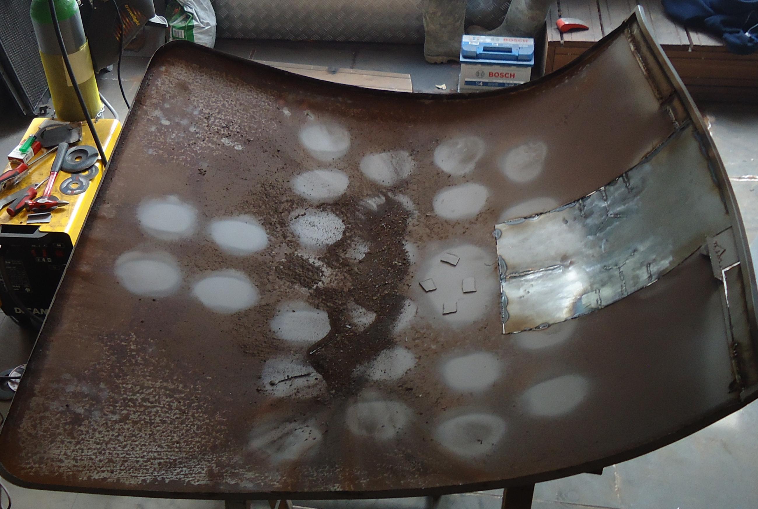

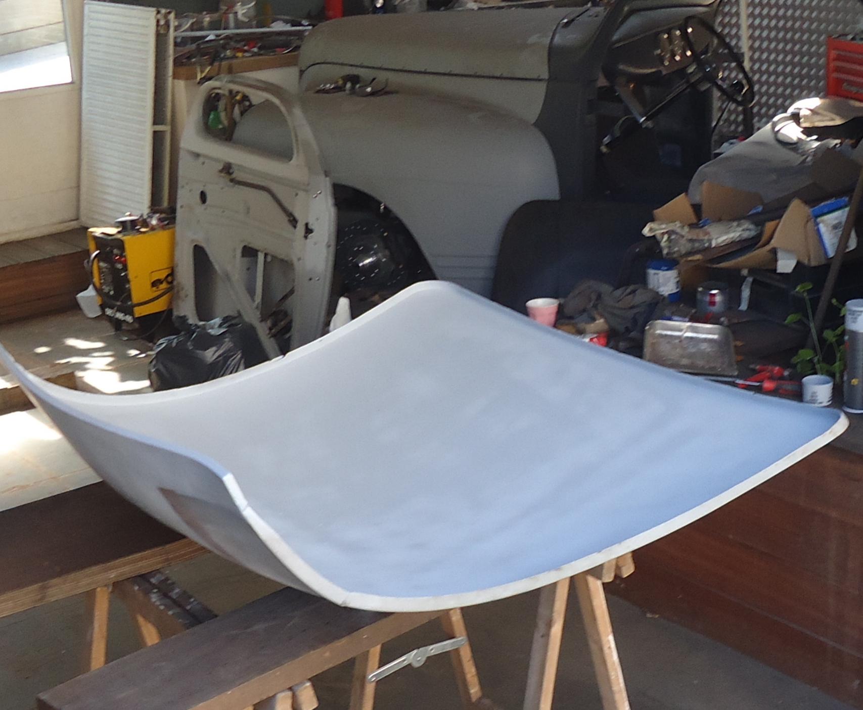

    Back to work on the rear deck lid today. I figured that the inside of the top lid needed to be cleaned as the inner has a few round openings from where you can see it. So I spent close to 7 hours grinding, cleaning and painting it........a lot of work for something you won't see much of. Anyway, in my excitement I didn't take any pics until I finished it. Pic #1 shows how it was before the welding/grinding was done and pic #2 is the final result. Yes!:D:D:D

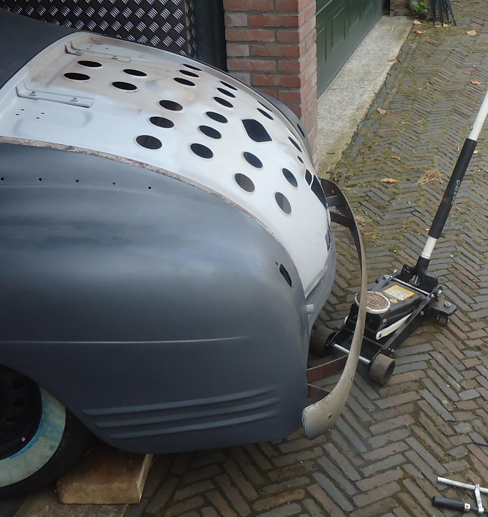

    Thank you zombie77. Speaking of patience.....I've been hammering away at the rear deck lid this morning, but after a few hours, my arms were aching so bad that I moved on to the rear bumper. After drilling a few new mounting holes in the ch***is, I mounted the brackets, attached the bumper, mounted the wheels and lowered the car.
    I want to move the bumper forward by about two inches, so when looking side on at the car, the bumper starts where the body ends. It's getting a little late now (past 23:00), so I'm going to cut the brackets tomorrow and figure out the final position. Here's a pic I just took, before it got dark. (deck lid is just laying there, waiting for some more beating.:D)

    The new stance is going to be very similar to the first pics. That's one of the things I liked about it when I bought it.
    I moved the car out of the garage slightly this morning in order to get a good side view of where to cut the bumper brackets. (I'm probably the only person in the world that needs 4 hours of thinking, measuring, cutting, re-measuring, etc in order to get the job done.....) But now it's in the correct position. I'm going to get some steel this week and weld on the new brackets. More tomorrow.

    I will be using an apron there for sure. I was going to modify the old one, but you know me, I'll probably make a new one this week. I like some of the features of the old one, but I'm going for a cleaner look. There are three brackets underneath it that I will use again in combination with new sheetmetal.
    I've moved the bumper forward 54mm so that when you look at the car side-on, the bumper starts where the body ends. I've always thought that the pan was tooooo big, looking like an afterthought from the designers.
    The bumper will be chromed after I've welded the 7 bolts in, giving it a clean look.

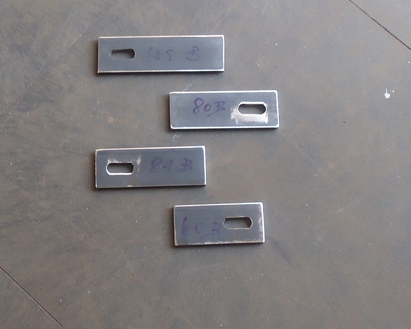

    Today was bumper bracket time! I got some 5mm steel and drilled the necessary holes, then cut to size. I spot welded them on the bracket with the bumper in place. My mig welder isn't strong enough to properly penetrate, so I took them to my buddy Jaap (prof welder) to finish it off. Came out looking perfect. Next: mounting and adjusting.
