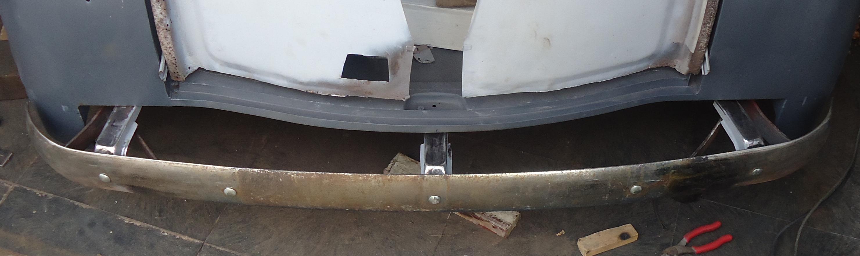

    I think you guys are right. The best look will be where the radius is decreased at the ends, "pulling" the bumper towards the fender. I'll make a template of wood to get the correct shape and then see if I can find a blacksmith who call perform his work on the bumper. Unfortunately this will all have to wait until the end of this week. Thanks again gentlemen for the input!

    Thank you for the photoshop OahuEli! That was exactly what I was looking for! Instead of shortening the bumper, I'm going to try, by changing the radius of the ends, to bring it closer to the car. Thank you again for the magic.:D

    Thank you very much for the photoshop Eli! I'm going to change the radius of the bumper ends and bring them in closer, but no shortening, as otherwise the pan would become too small in my opinion. After the bumper has the correct shape, I'll need to shorten 2 of the brackets and modify the pan. I hope to have it all done by the end of this week.

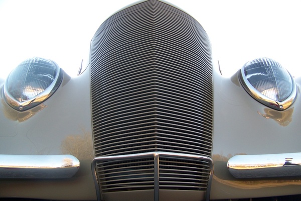

    After looking that pic,i think it looks good without the bumper.Just some kind of "floating" style plate bracket and thats it.Keep up the good work!

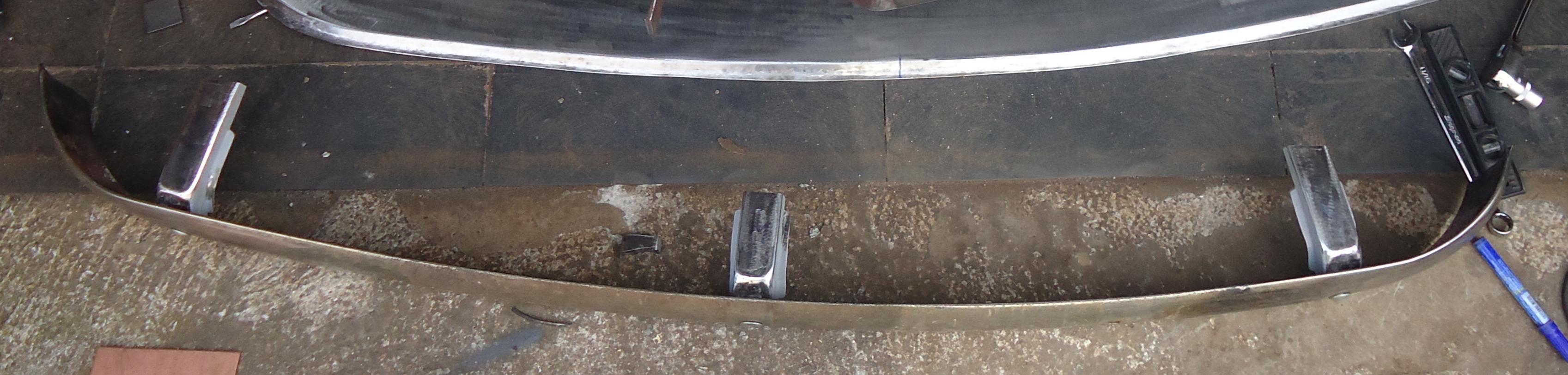

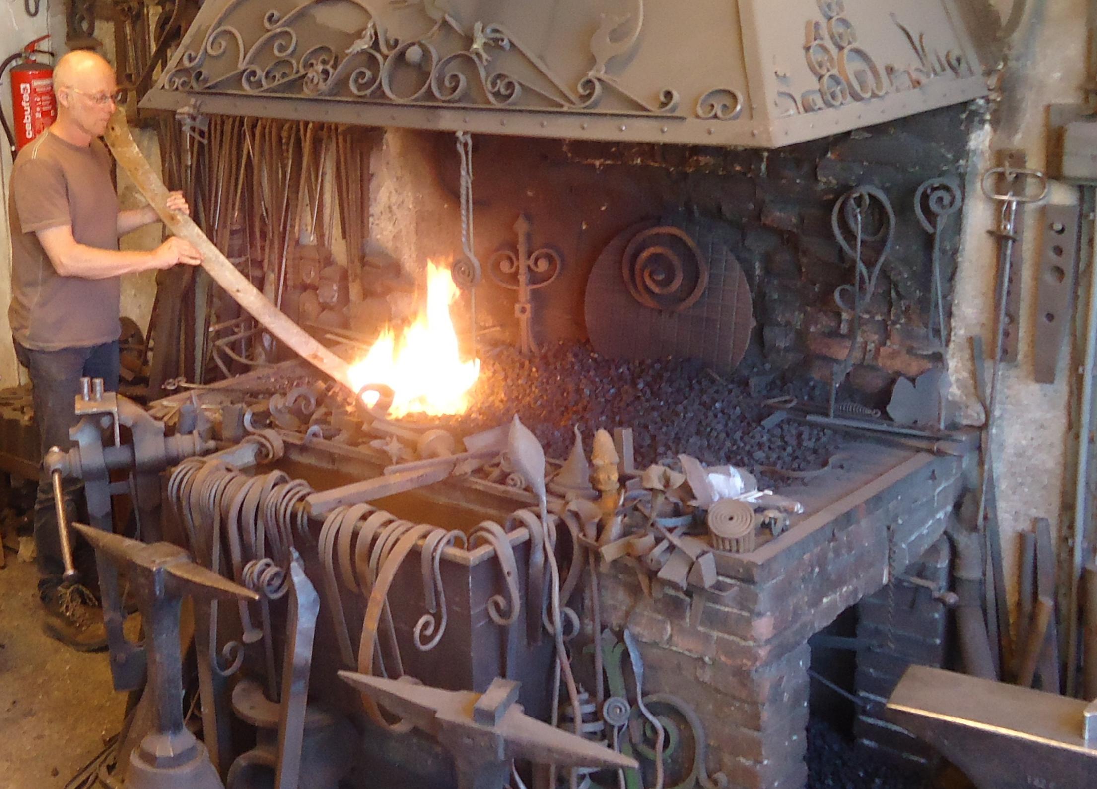

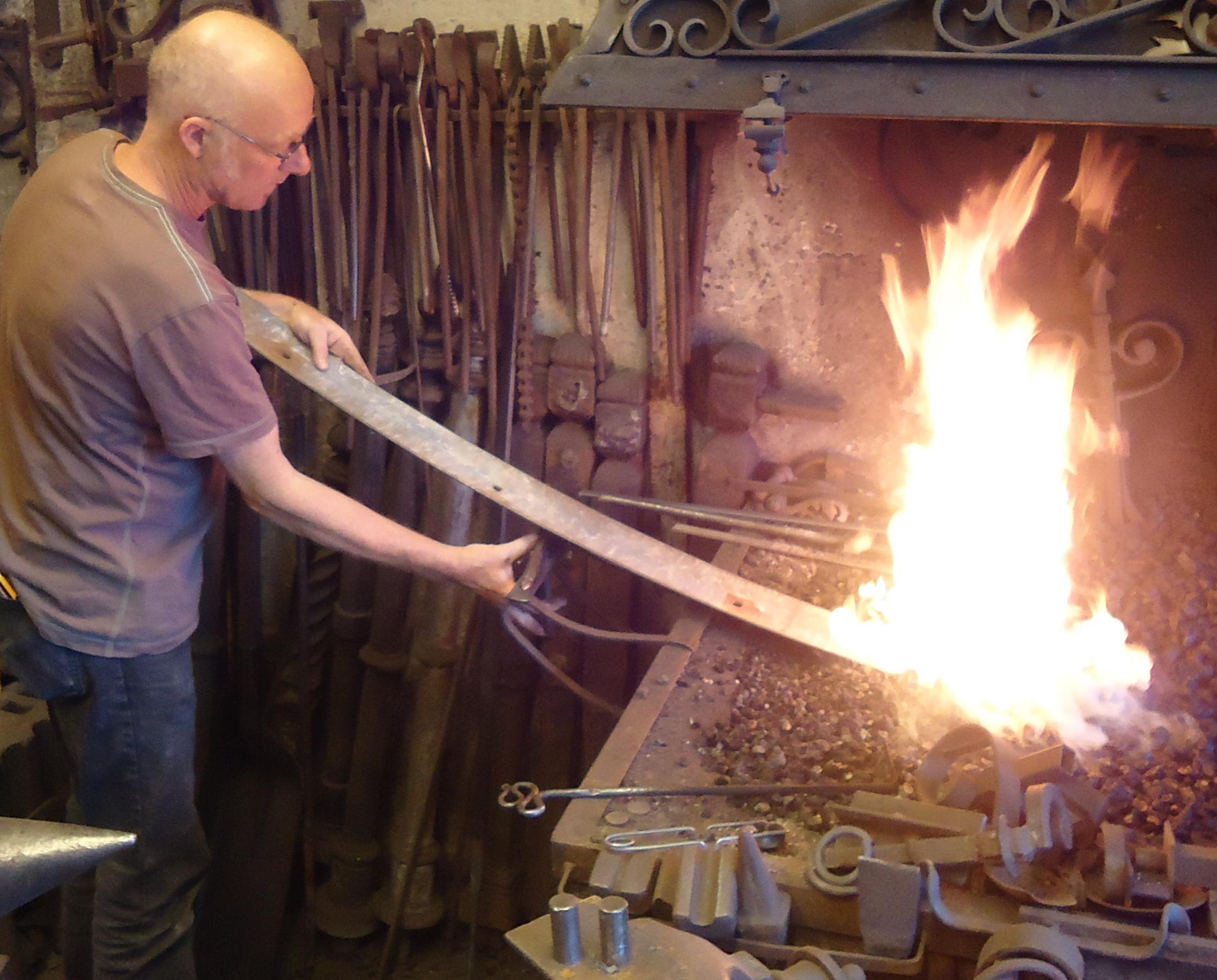

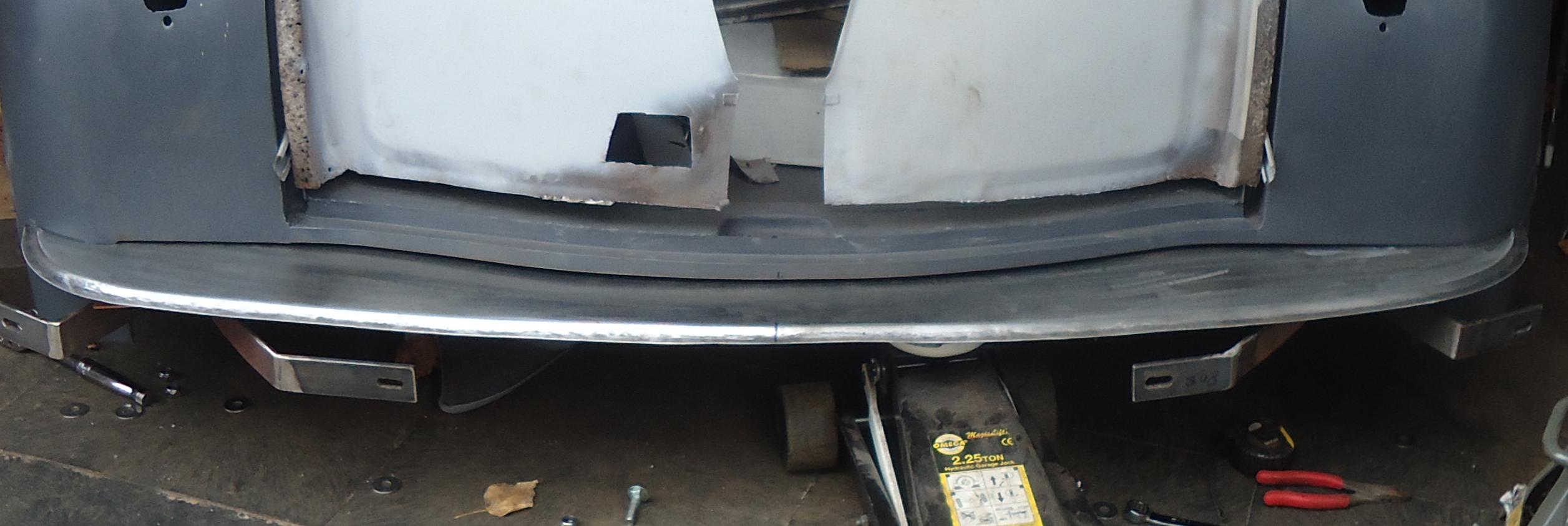

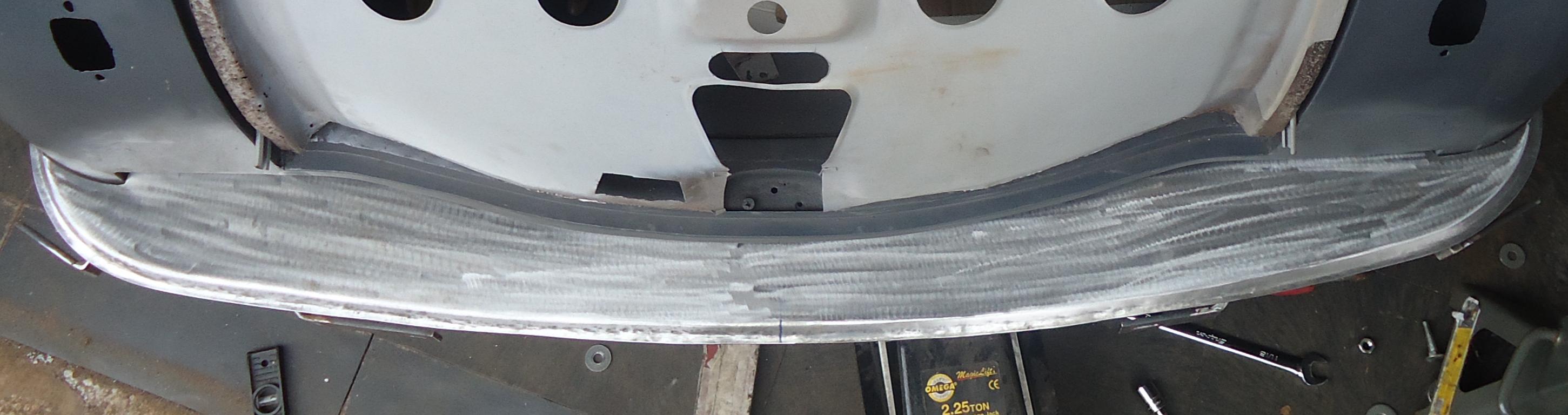

    Spent most of the morning re-shaping the ends of the splash pan in order to bring them further inwards. Next it was off to Ron, the local blacksmith, to re-shape the bumper. (decreasing the radius on each side.) He and his brother are continuing the 200 year old family business. Bumper came out looking great!

    Thank you David. The blacksmith is less than a mile away from my place, so I went to talk to him yesterday. He said "no problems, take your splash pan with you as a mold, and I'll re-shape the bumper to it."
    So I went over today, helped him for about an hour and it was done. (and 50 bucks.:D)

    I was a bit surprised to see blacksmith working with the bumper.I've seen blacksmiths in here,but the ones i've seen fabricate knifes etc(including one friend of mine),not mess with an old bumpers.

    He was very cool about it. Loved the fact that it was a 71 year old bumper and was willing to give it a shot. What did occur was that when the radius was reduced, he had to hit the top and bottom edges in order to prevent it from becoming wide. He is a true craftsman for sure.

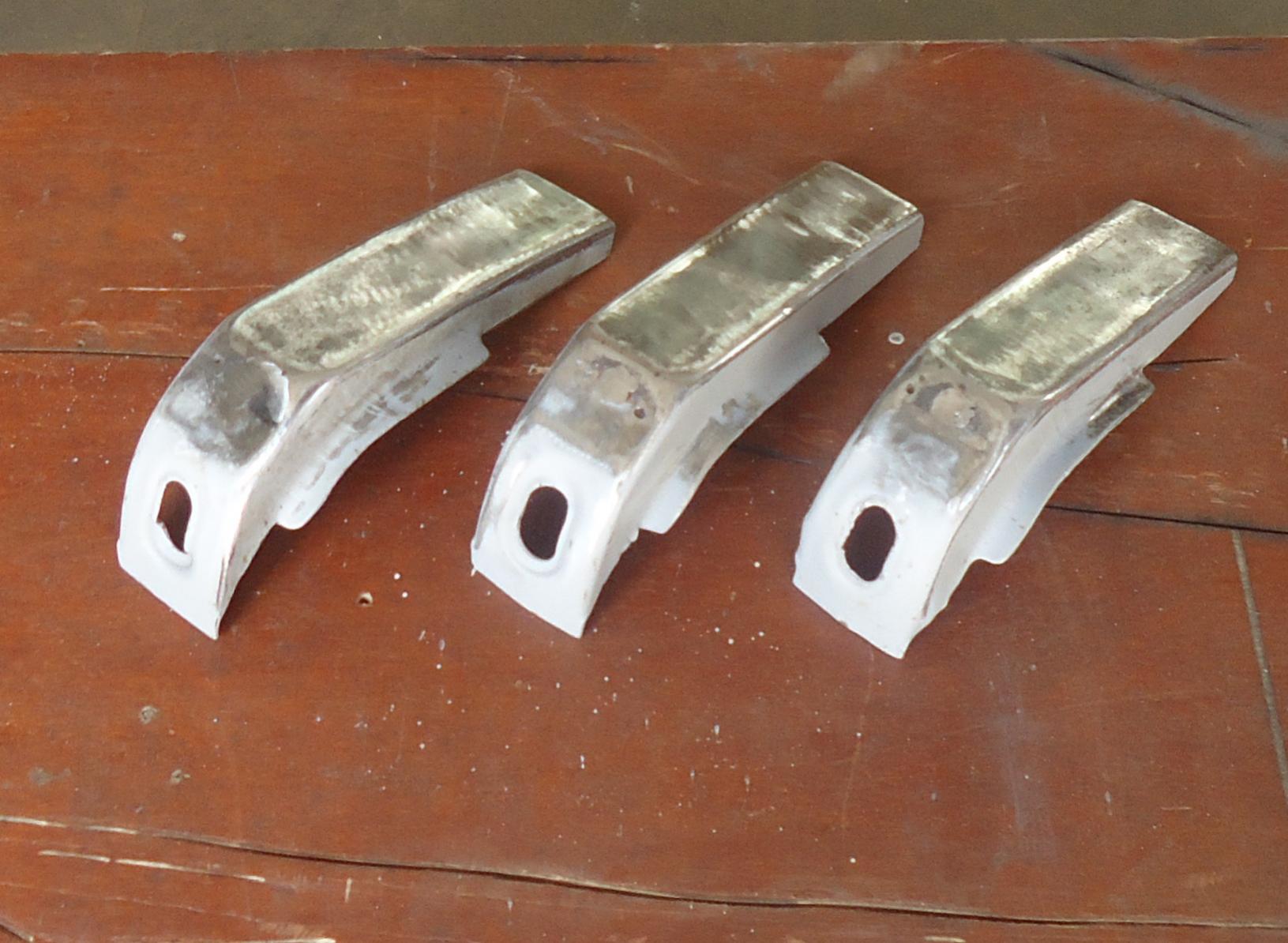

    Had a few more spare hours this afternoon. I cut the brackets off the old splash pan, cleaned them up and cut them to size for the new pan. Also had to cut the outer bumper brackets off due to the new bumper radius. (re-welding tomorrow).Mounted the pan brackets and test fitted the pan. Looking good so far, with still a little tweeking required here and there. Will finish it off tomorrow. :D
