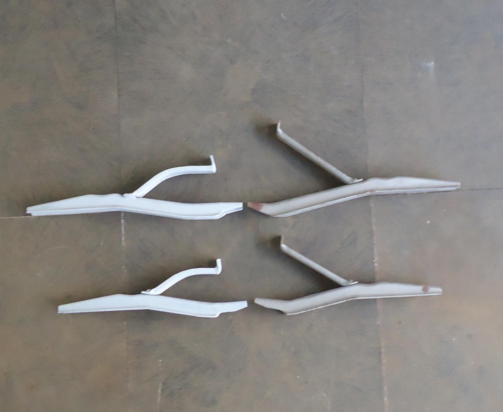

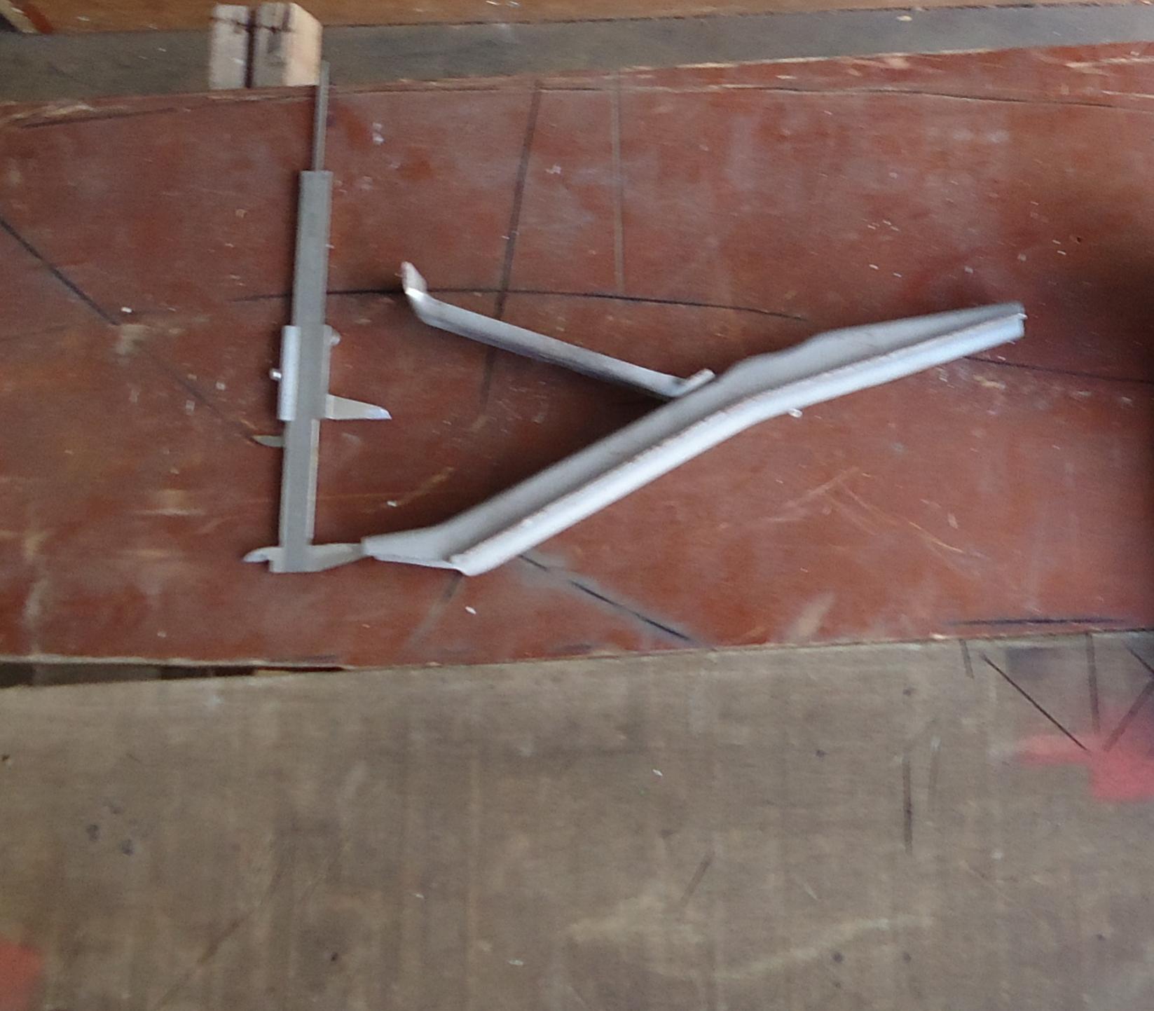

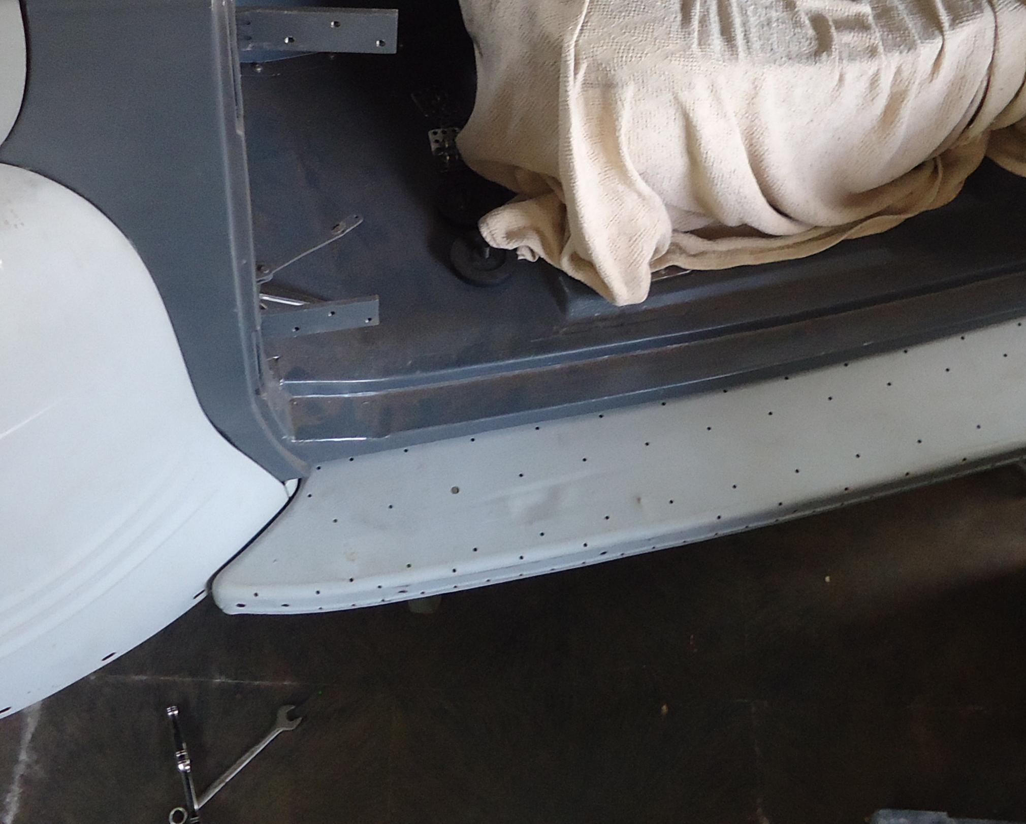

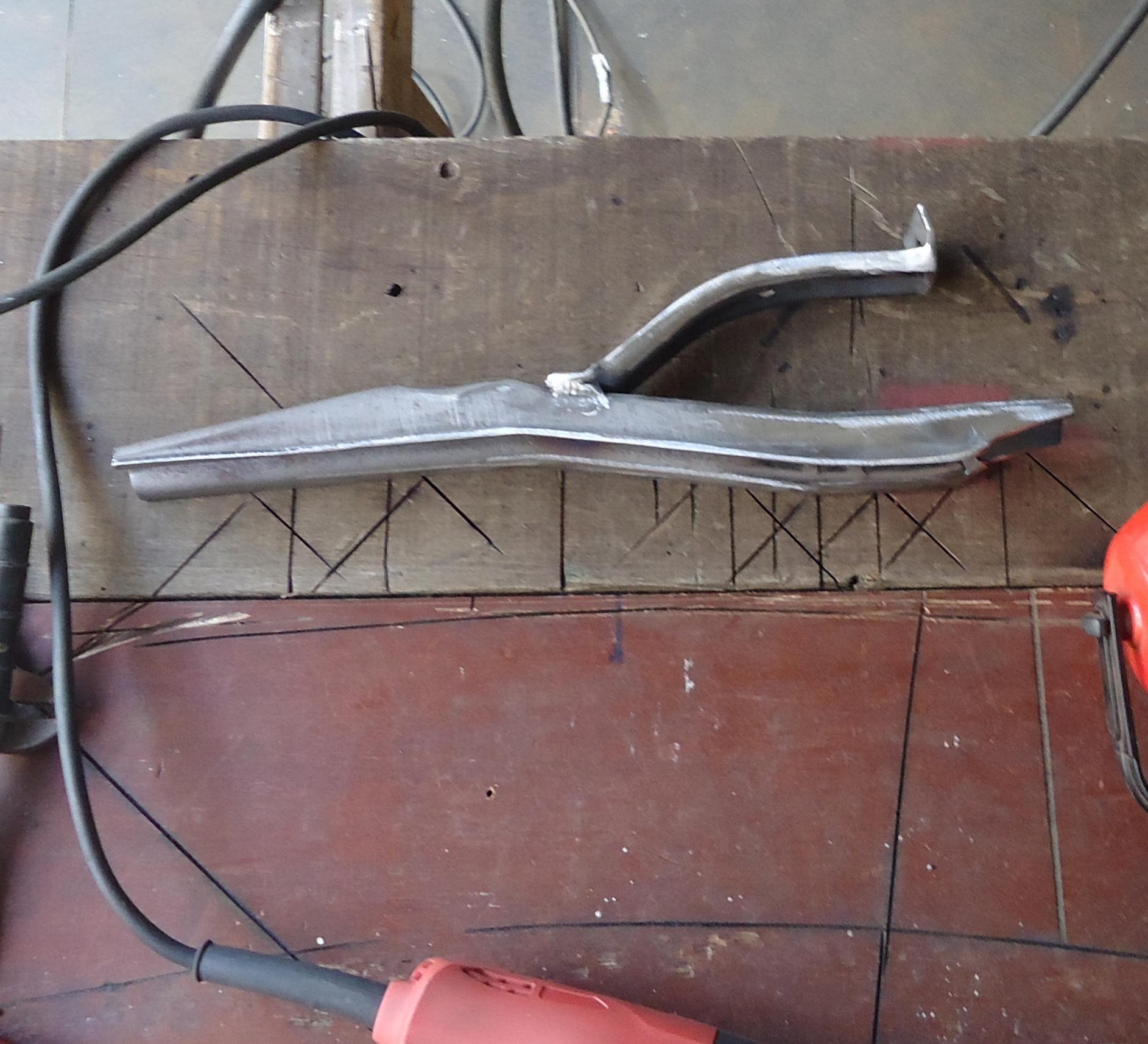

    Here are the running boards! Well, at least the brackets....and the modification required.
    I started yesterday continuing straightening the drivers side running board. Before I know by how much I need to extend it rearwards towards the fender, I had to mount it in place. The brackets did not fit at all! I know I've brought the body closer to the ch***is, but it wasn't 3 inches. Instead of wasting time and energy on finding out from which car they came from, I started modifying the 2 of them. After a lot of cuts, welds, test fitting and grinding, I managed to get them to fit perfectly. The last pic shows the new compared to the original from the right hand side.
    Maybe I'm the only idiot that will spend 8-10 hours modifying a couple of brackets, but it was worth it. :D:D:D
    At the end of next week I'll extend the running board at the rear, so that no spacer will be required any more.
