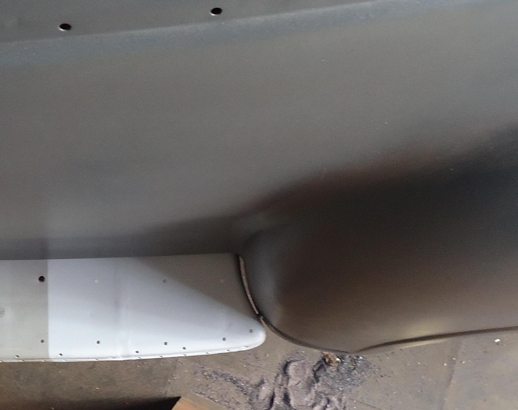

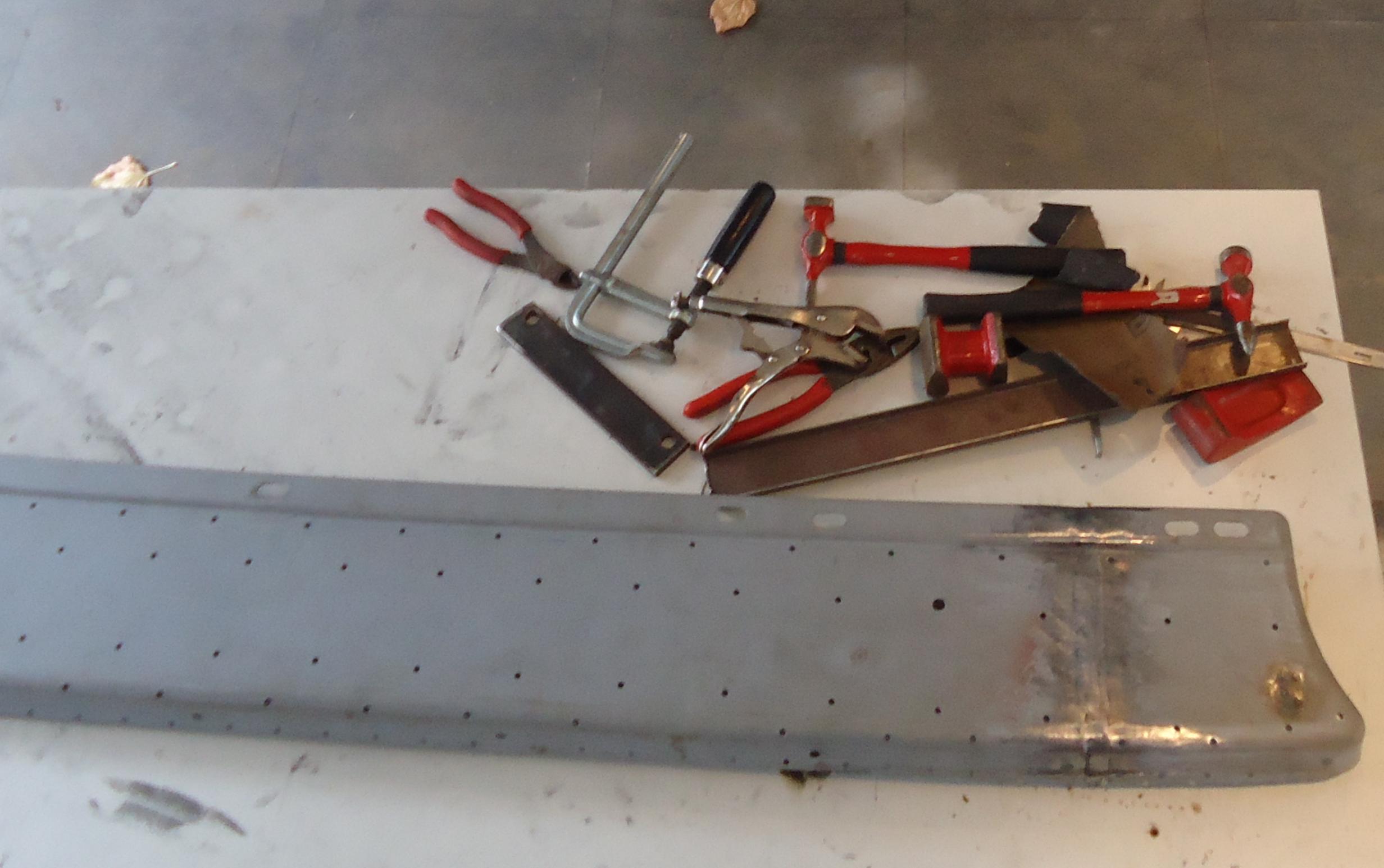

    Yes, I have been busy the last couple of days. Mounted the running board mounts to the ch***is and got them lined up. Next was the running board itself. For some reason Plymouth made them too short at the rear (probably for ease of installation on the production line), leaving a gap of approximately 1 inch. This has always bothered me somehow. So it was time to extend it.
    I first attacked the lower corners. These were badly formed (see pic 1), probably due to the big old factory press creating a lot of shrinking and stretching in a tight corner. Added a little material, welded and smoothed them.(pic 2) After cutting a rear piece of the running board, I test fitted it and came to the conclusion that 17 mm of stretch was required. After a few hours of bending, cutting, welding, etc, I got it looking good. Gave it a quick spray and mounted it on the car. The gap at the front and rear fender is now 5mm, giving me adequate room for the rubber "mat". I may require just a little bit of filler here and there to make it completely smooth. (I think lead would be a bit too extreme for something to be covered by rubber eventually.) A little hammer and dolly work is still to be done in one or two places, but you get the general idea.:D
