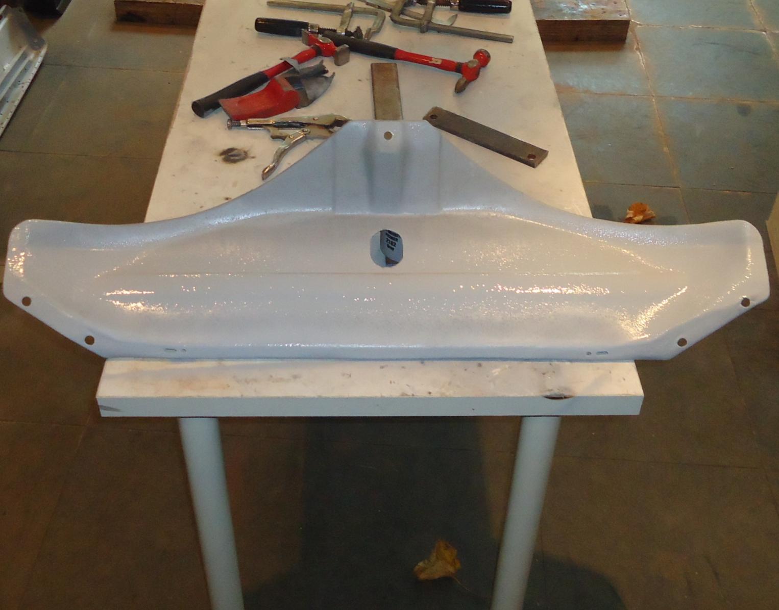

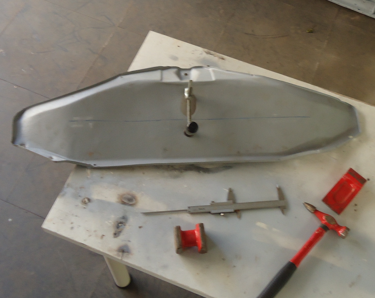

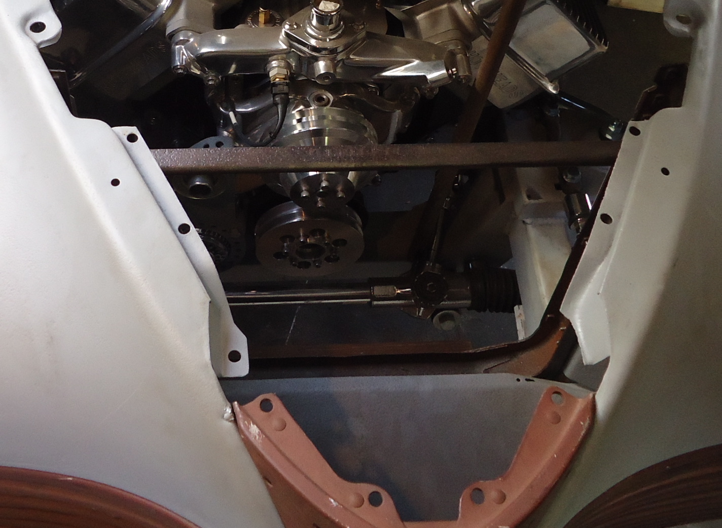

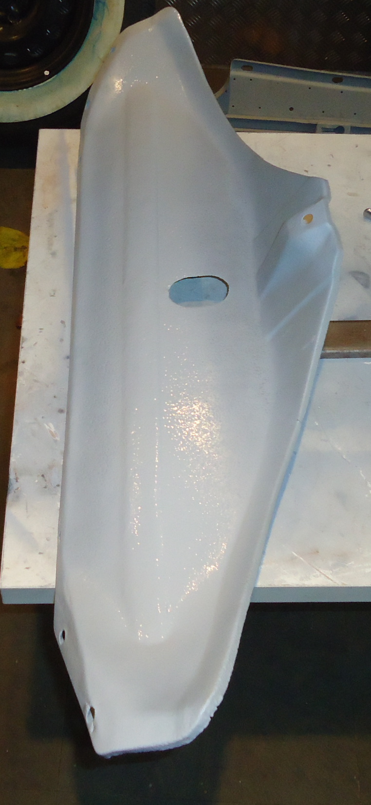

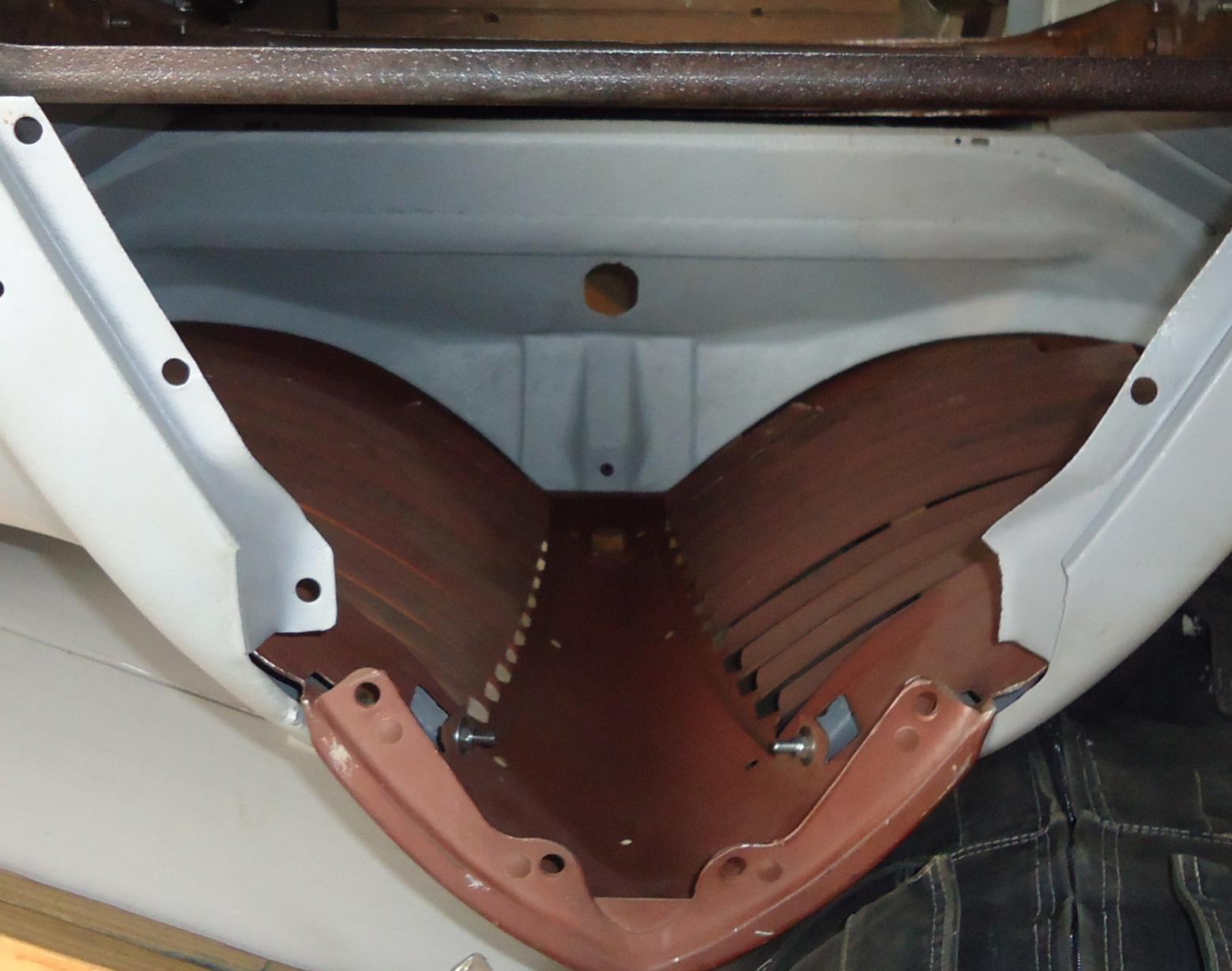

    Spent the whole day straightening out the splash or air deflector, however you want to call it. First removed the radiator with my son and then proceeded with the hammer and dolly. The pan was touching the front of the ch***is slightly and I needed to shorten it little in order to fit behind the grill, so I hammered a small bulge all the way across. Then re-worked all the edges and flattened the mounting areas. Test fitted it and painted the re-worked metal.
    I think at one point in it's life the pan got damaged, explaining why the original grill was out of shape. Another job done. The list is getting shorter.:D:D:D

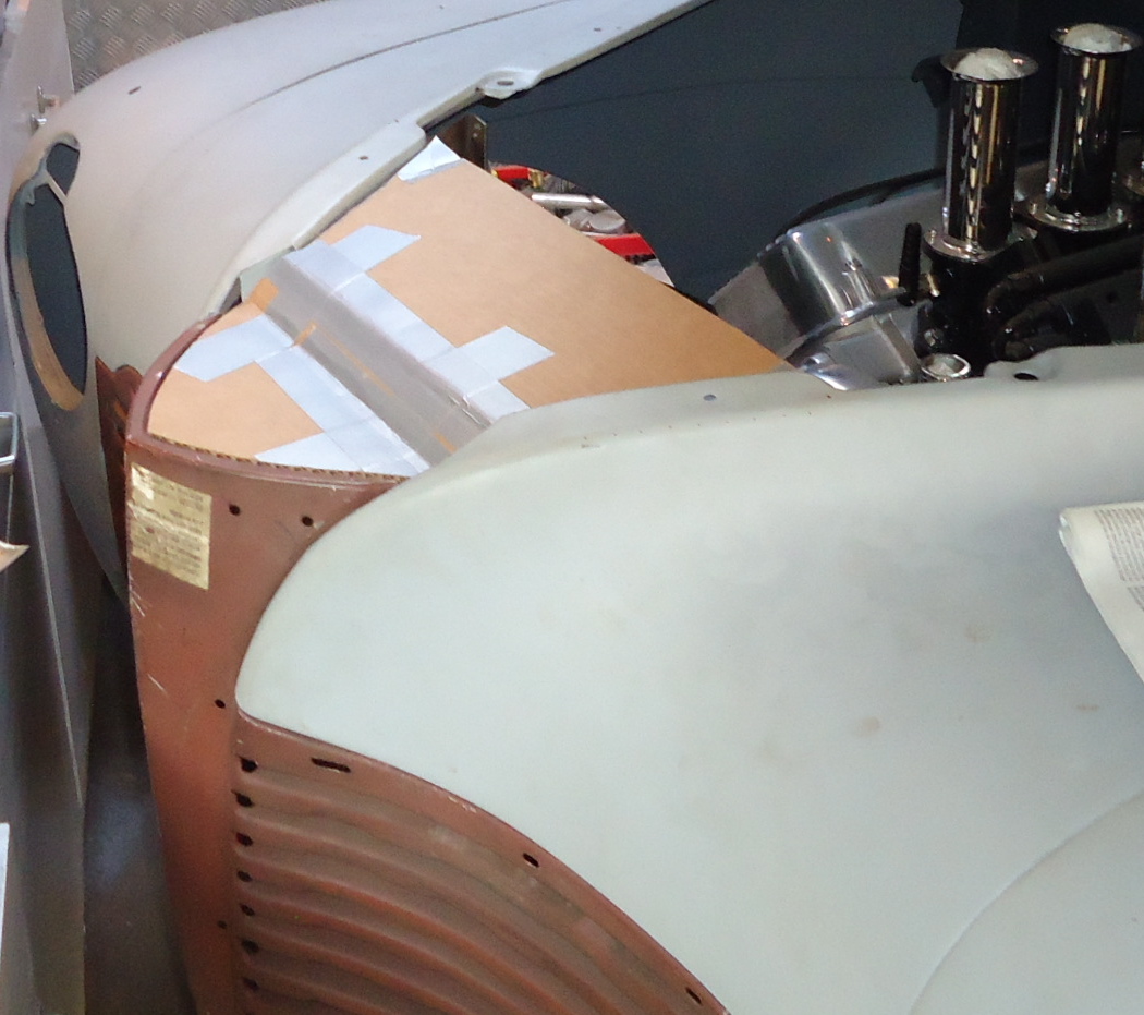

    I ordered some latches last night for the hood and trunk. It will be a week or two before I receive the hood latch, but you can't start early enough with the preparation side of things.

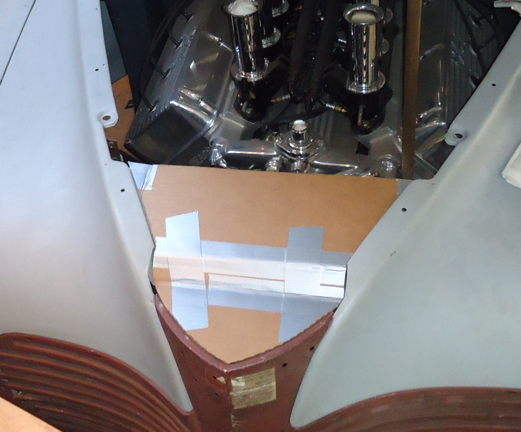

    The empty area above the grill needed some attention. First made a template out of cardboard, including the angles I felt looked right. Then got some sheet metal and started hammering away. After a lot of tiny changes and test fitting, I got it more or less correct. I'll be fine tuning it next week, including the mounting holes. Then all I have to do is wait for my latch to arrive and install that.
    Now its time to give my arms some rest.:D

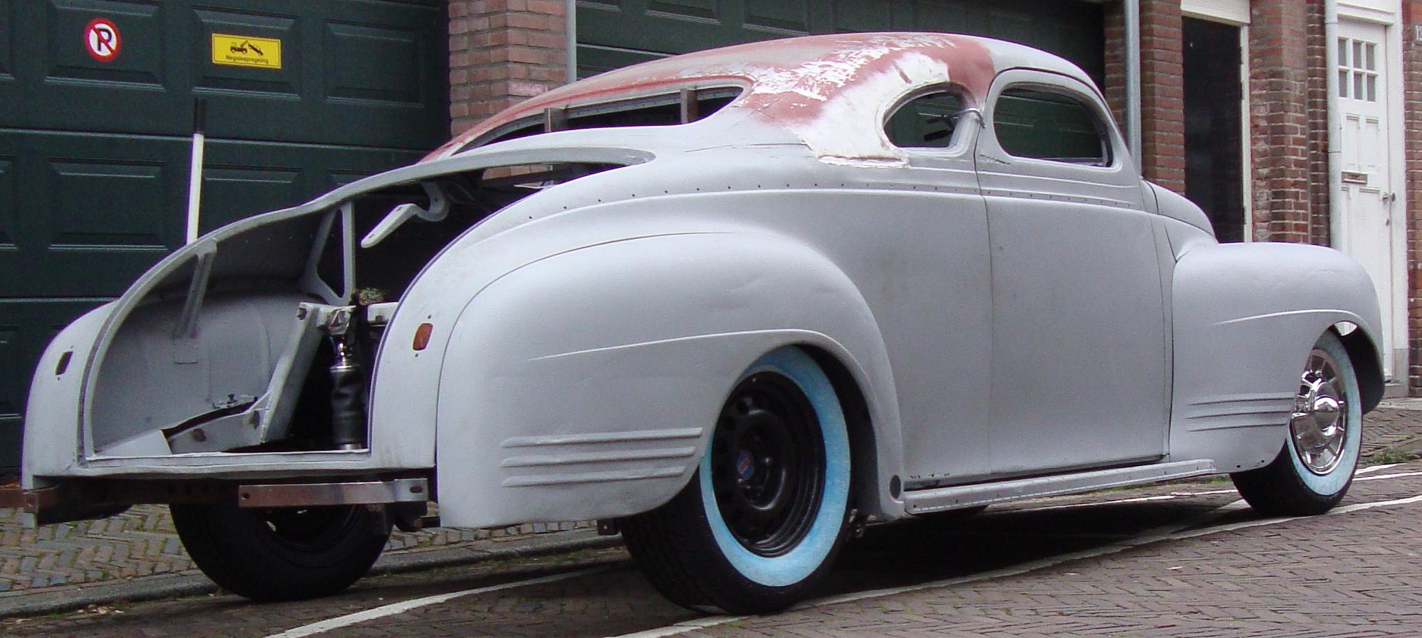

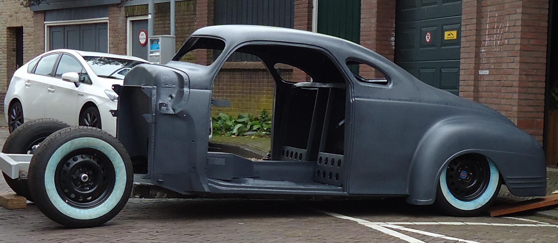

    Haha, I agree, it appears a lot that I'm just working on parts instead of a car at times! In order to rectify that for those who haven't read the 160+ pages so far, here are a few pics of how it was, the build so far and the photoshop of how it will look. (with one or two additions and changes to the photoshop.) For those wondering.....it is the same car and they are in the correct order.:D
