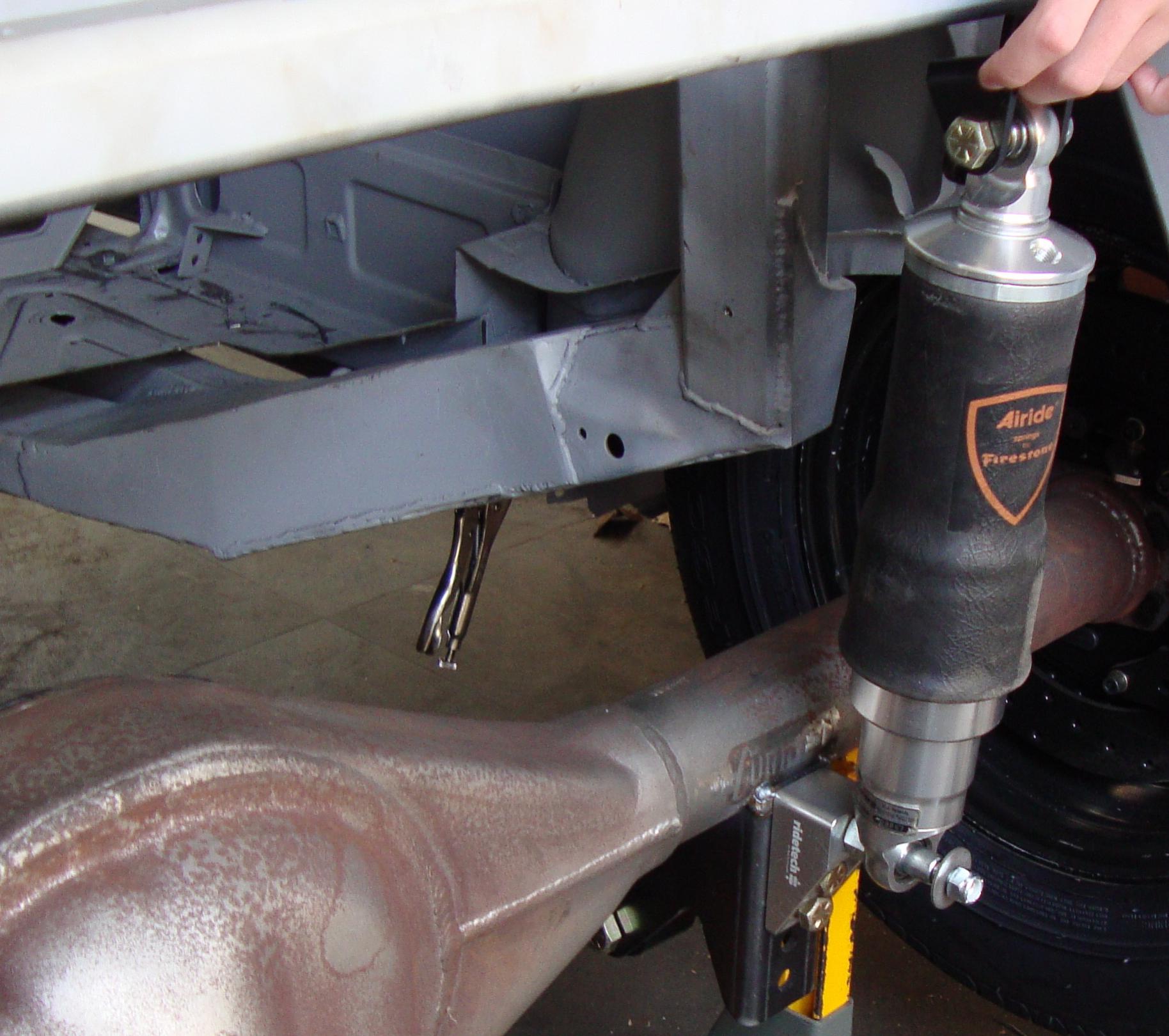

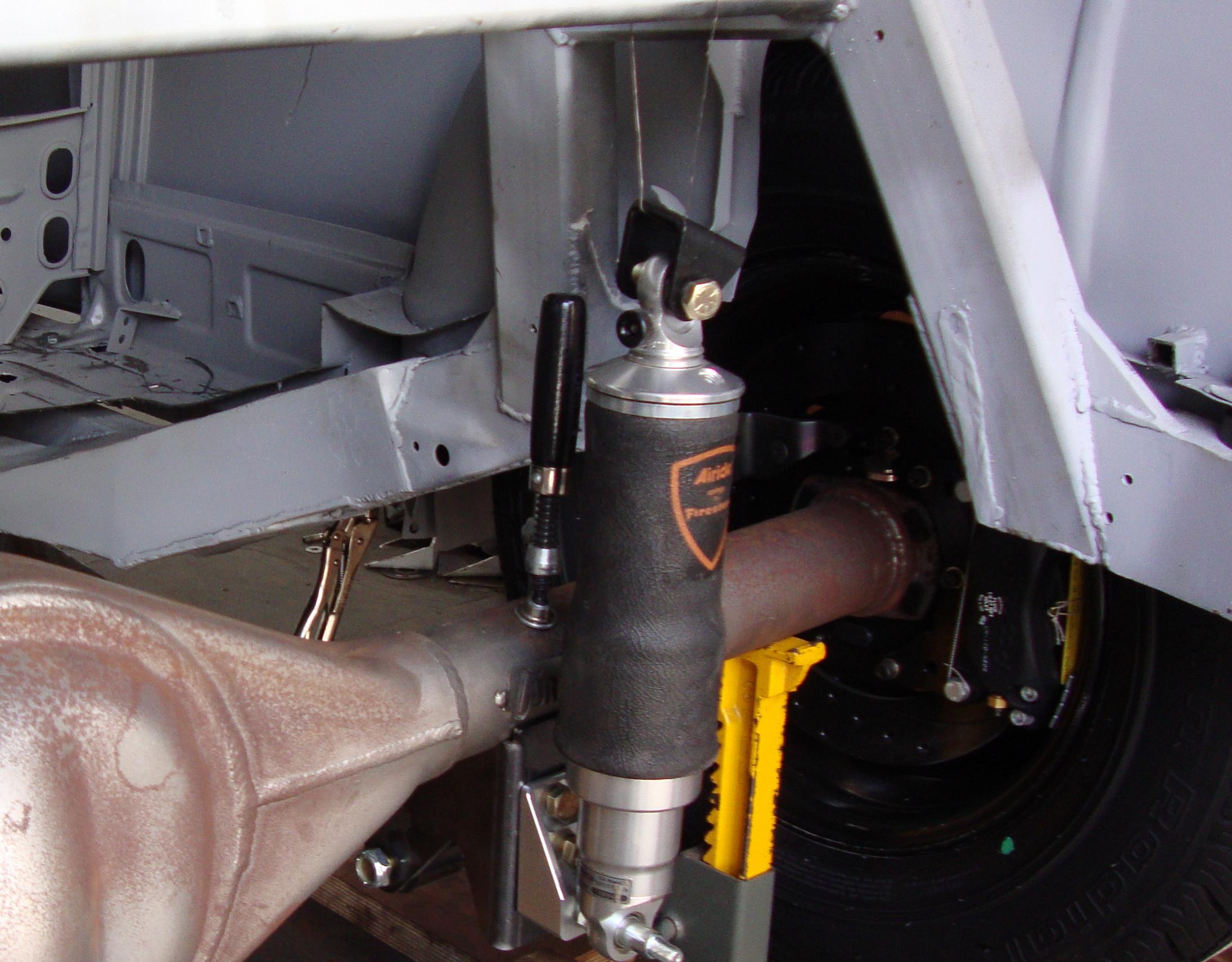

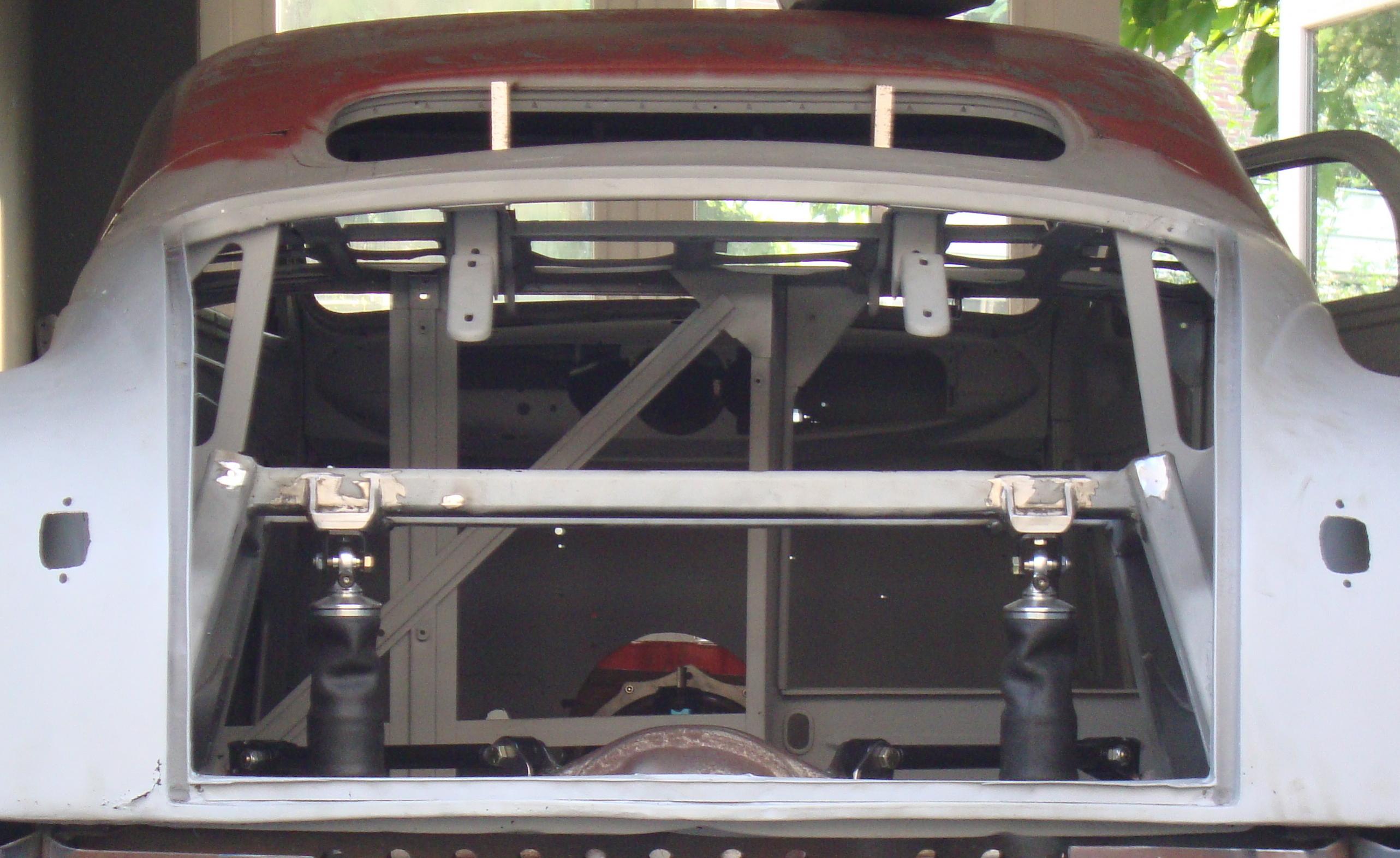

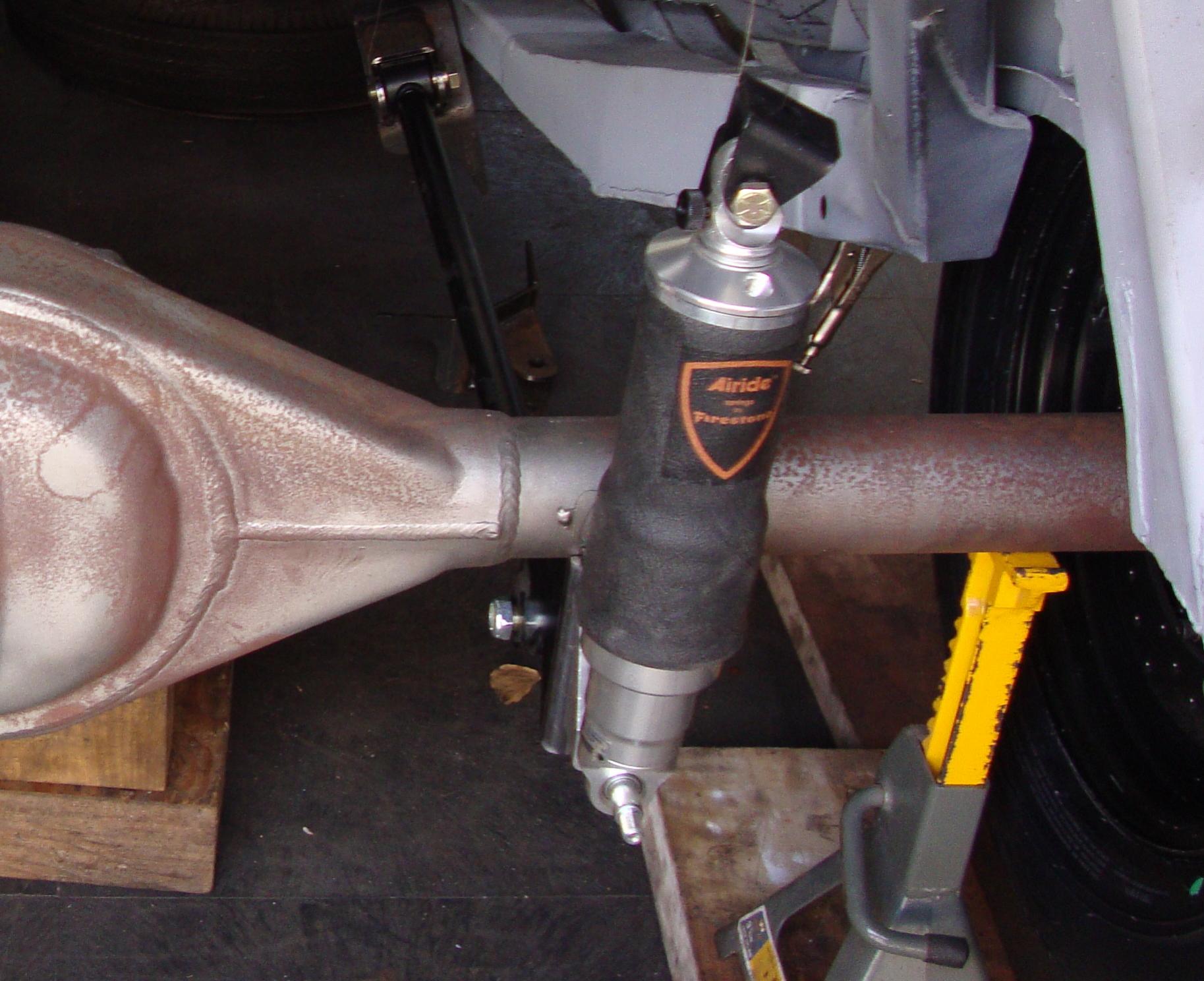

    Spent the last few days sorting out the triangulated 4 link and lining up the rear axle at ride height. I had planned to run it on the outside of the frame but after talking to the guys at ridetech, I've moved it inwards. Running the lower arms further apart would create more stability, it also means I would have to angle the bags at 45 degrees so as to clear the c notch. Ridetech said they like to run the shock/bag combo at 18-20 degrees. So now the lower arms and bags are set up inwards and the bags will be angled towards each wheel. Getting an angle finder soon and will start tacking it all into place. Note in the photo's the bags are still vertical in the mock up stage.
  12. I've never mounted combo air-bag/shocks, but are you sure they want the angle the direction you're thinking? It is definitely opposite from how shocks are setup. I'm not experienced in these types of suspension setups, would like to know more?
  13. farmer12
    Joined: Aug 28, 2006
    Posts: 7,724
    farmer12
    I have sent an email to ridetech yesterday with a photo. I'm still waiting on an answer from them. When I get it, I'll post it.

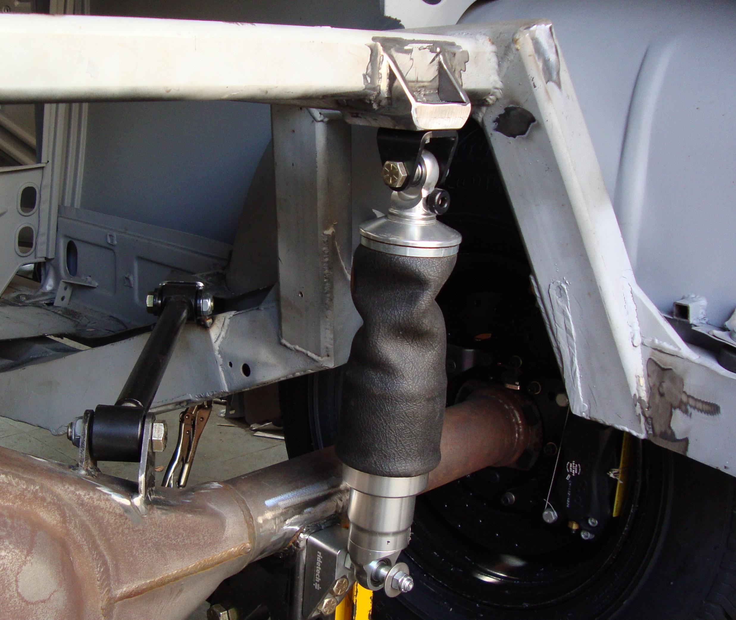

    I talked to Jon at Ridetech. He's advising to slant the bags at 18-20 degrees towards the wheel. According to him this will be the best angle for the bag/shock combination. Ride height of the car will with the bags compressed by approximately 2 inches. Will start on it today and do some welding tomorrow. Will post some more pics soon.
  22. farmer12
    Posts: 7,724
    farmer12

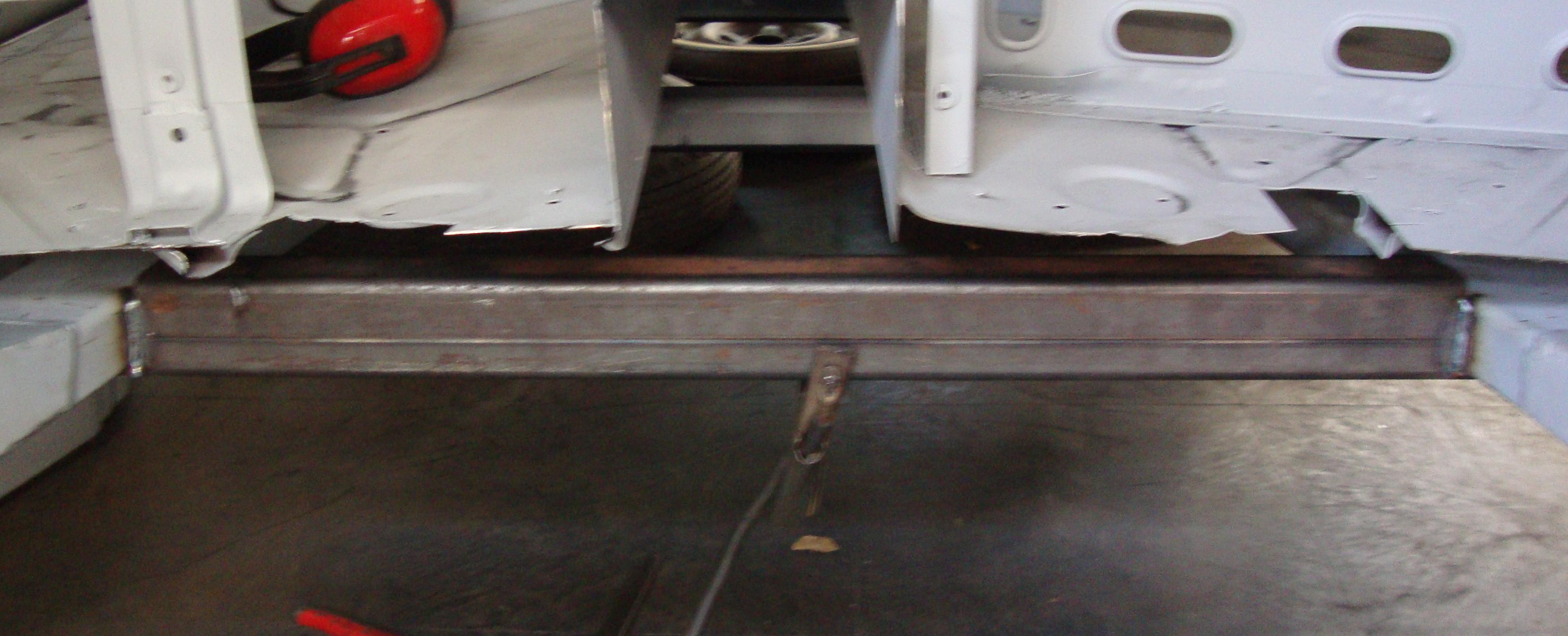

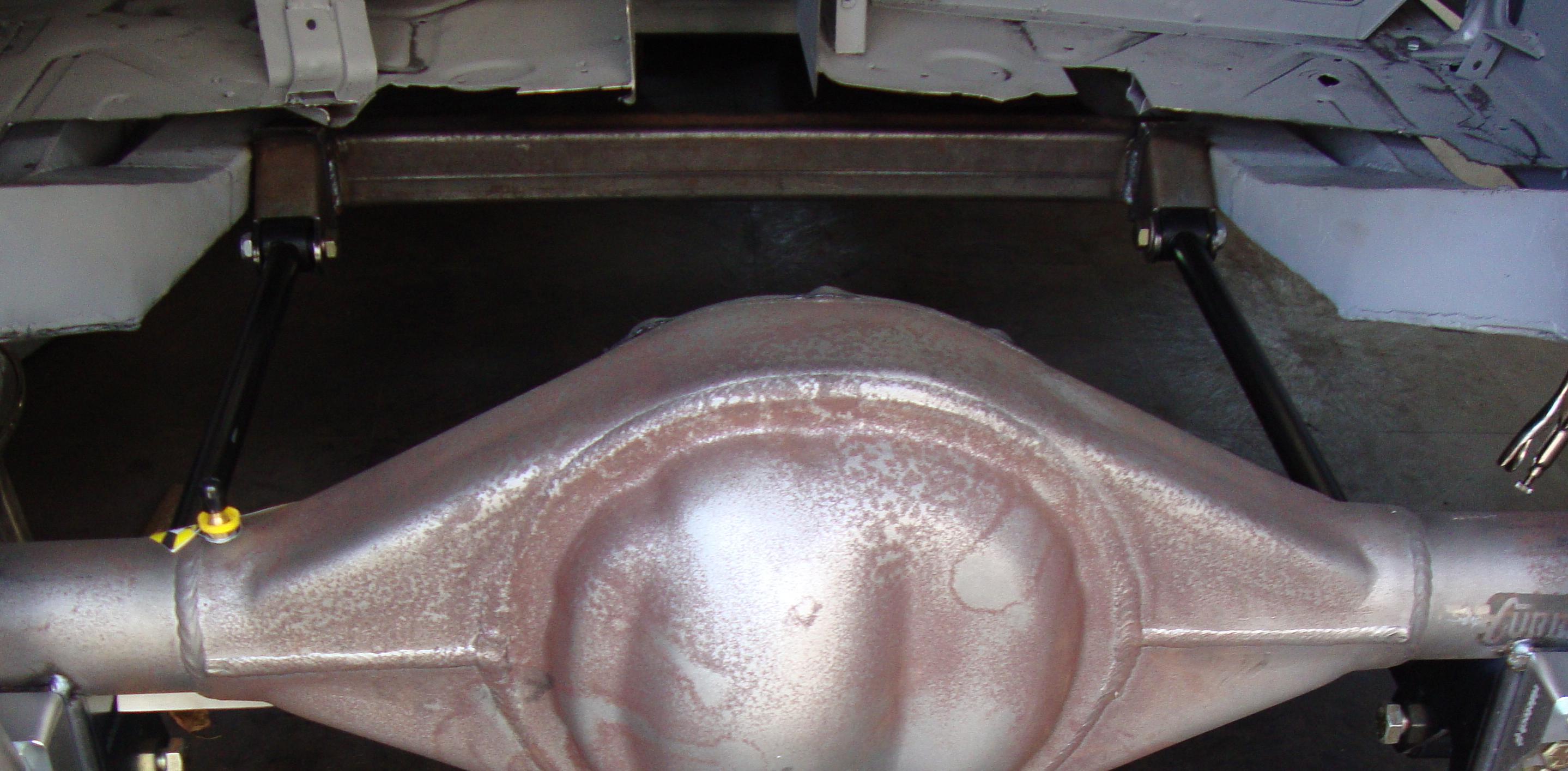

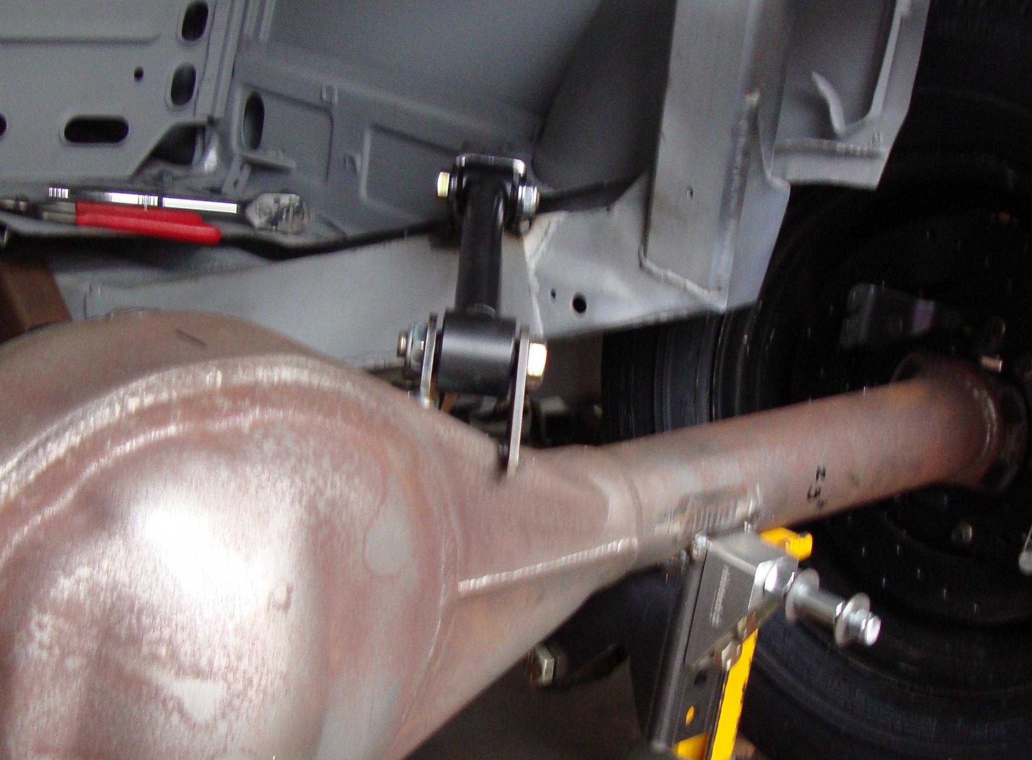

    Started on the 4 link again this morning. First measured the exact distance of the brackets from each wheel. Got my buddy Jaap over with his welder to do some work and also act as an extra pair of eyes. Spot welded these into place. Then we moved forward to determine the position of the steel bar to which the front pivot point of the lower arms will be welded. Cut the steel to size which took a bit of time considering the frame is tapered towards the front. Welded it all up and will start cutting the front pivot plates to size this afternoon. More pics soon.
  23. farmer12
    Posts: 7,724
    farmer12
    Cut the pivot plates to size and determined the correct position. Also ensuring the ladders bars run parallel and horizontal took a bit a time. Welded part of the plates and spot welded the hard to reach places. Final welding will be done when the body is removed from the ch***is. Will start on the top part of the 4 link next week. I'm happy with how it all went , even though you spent 90 percent of the time measuring and test fitting. Thats part of the fun I suppose!:)
  24. farmer12
    Posts: 7,724
    farmer12
    It's good to see that more and more people are getting into these cars. (and loving it!:D)
  25. farmer12
    Posts: 7,724
    farmer12

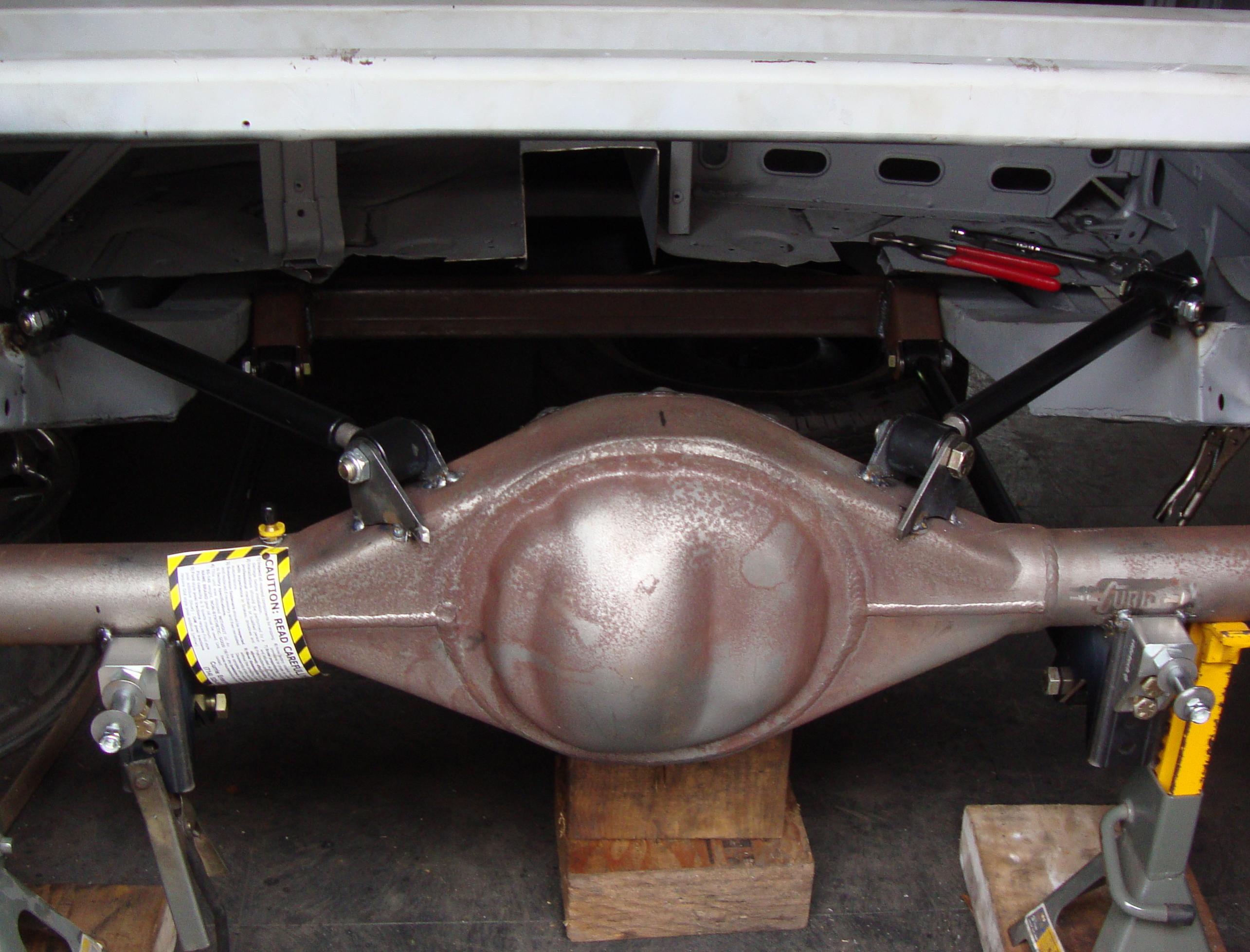

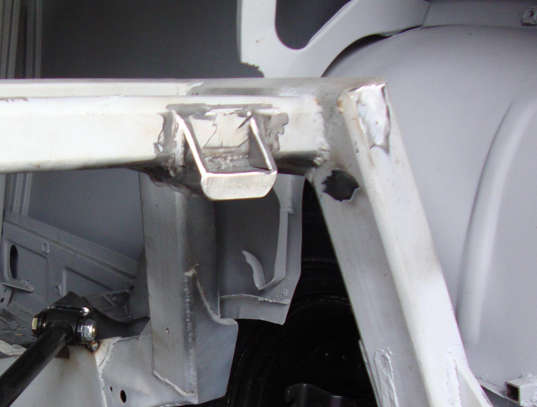

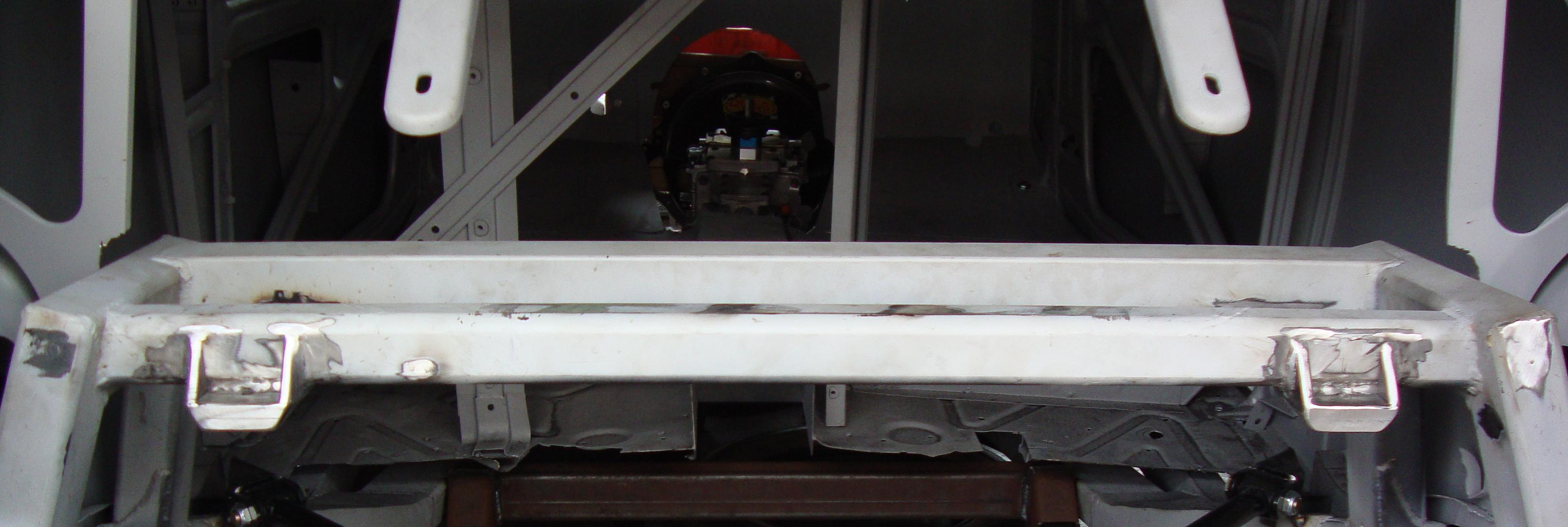

    Started early this morning with my buddy Jaap to do some measuring and welding. We went ahead with the top arms of the 4 link. Unfortunately the frame is too low at the outer ends so some extra work will need to be done when the body is off the frame. We made some brackets to support the top of the bags. Welded it all up and then lowered the whole rear axle to check the up and down movement. Perfect! Going to ***emble it all now, more pics soon.
  26. farmer12
    Posts: 7,724
    farmer12

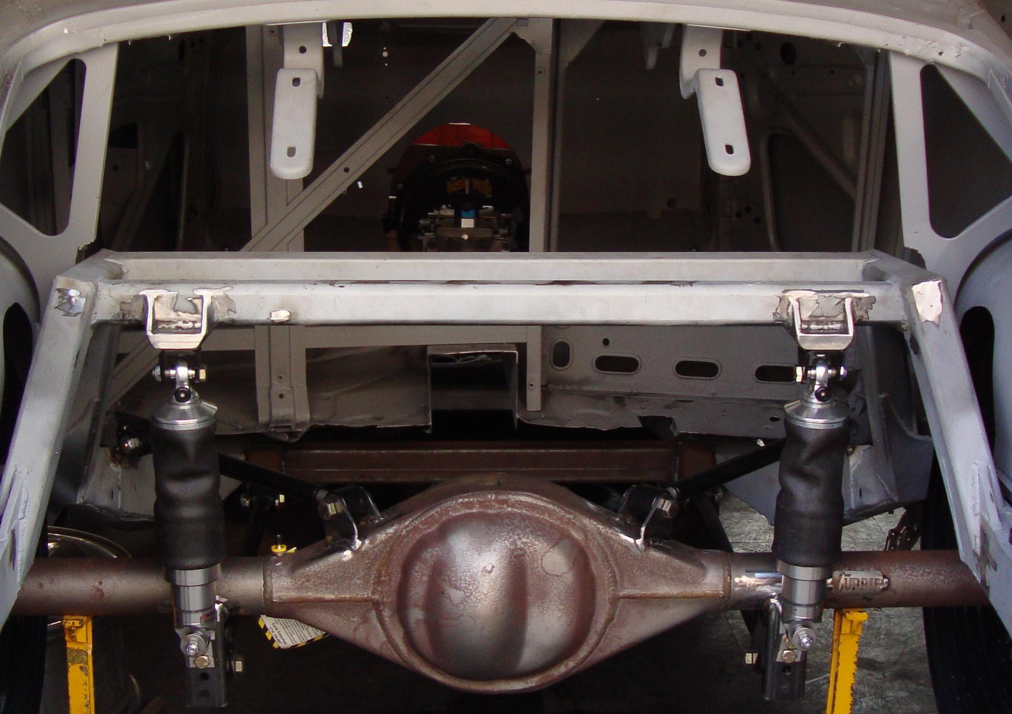

    ***embled it all, looking good from where I stand. Never realised how much time is involved to "build" a 4 link, however it was worth all the hours. Learning every day!:D
