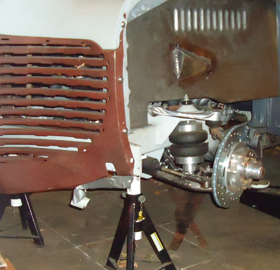

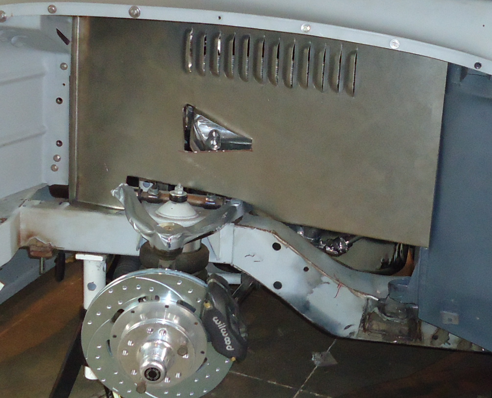

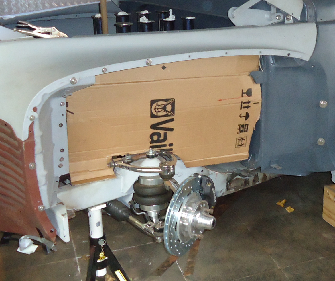

    It was time to start re-shaping and fit the new inner panel. I first removed the outer fender in order to get better access, then got my cardboard model into position. After modifying the metal, especially around the suspension area, I managed to get it into position. I left some extra room on the bottom between the wheel and firewall, so some of the heat of the headers can escape.
    On the list for the next time is to create room for the tire when turning, working out a way to attach it to the firewall and the top of the fender, and ensure that there'll be sufficient clearance next to the valve cover. Plenty left to do!
    Good thing is, once this side is completed, the other one will be more or less a copy/paste procedure. (famous last words:D)

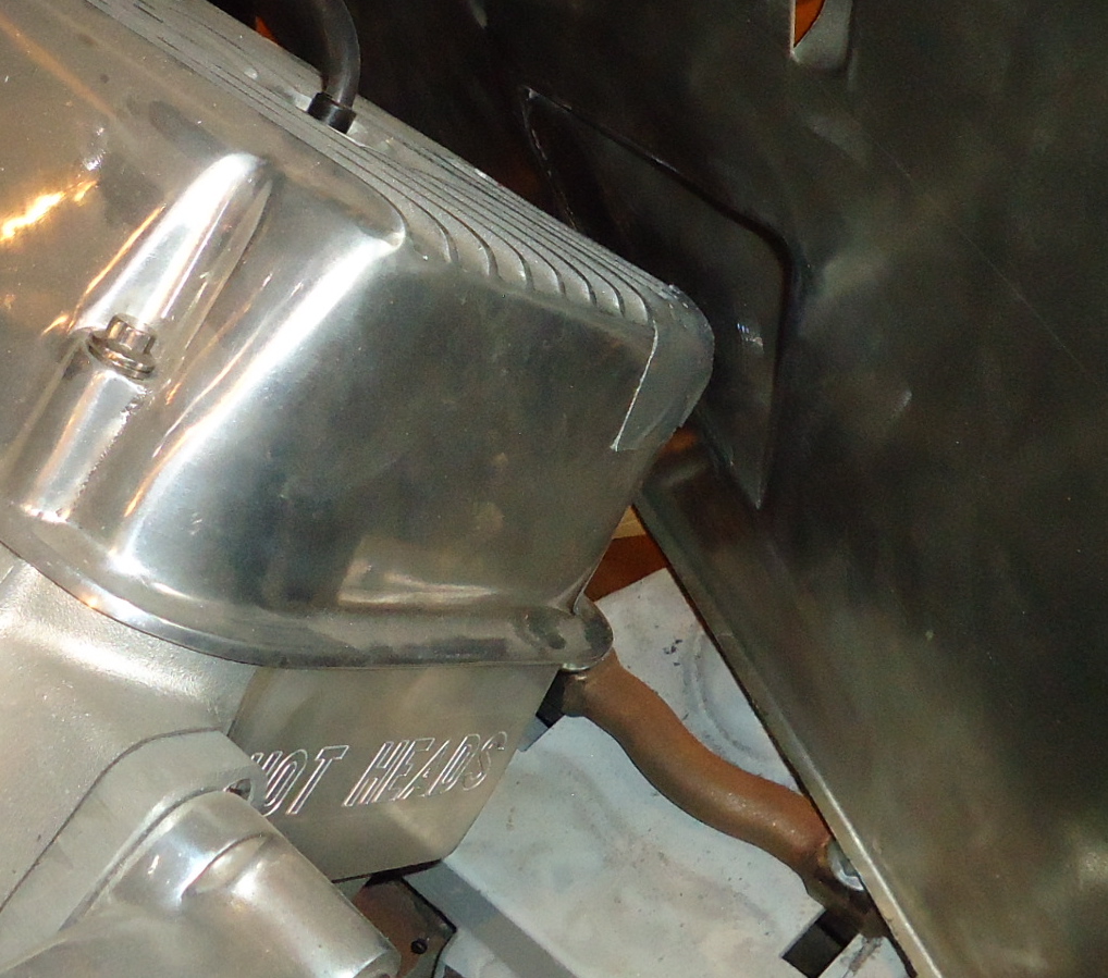

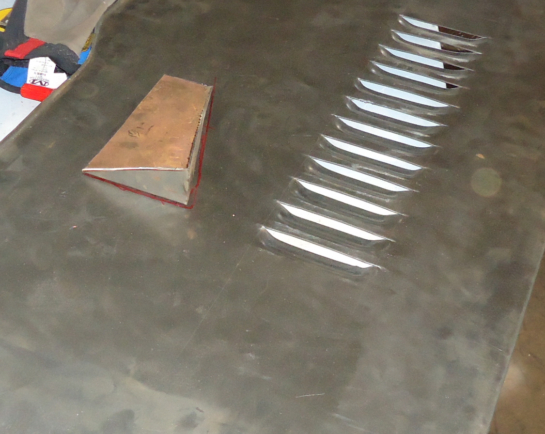

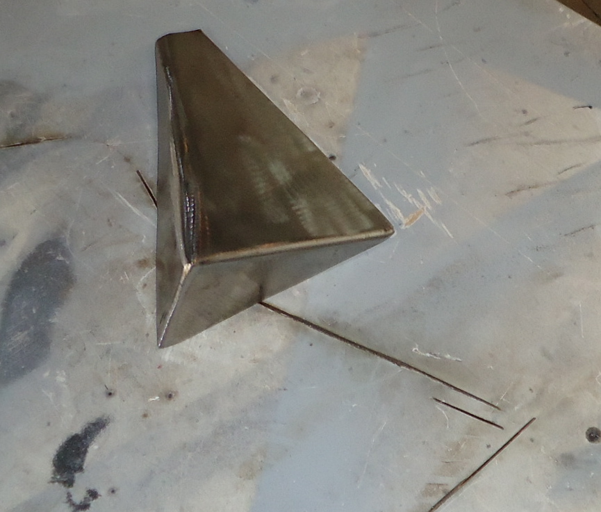

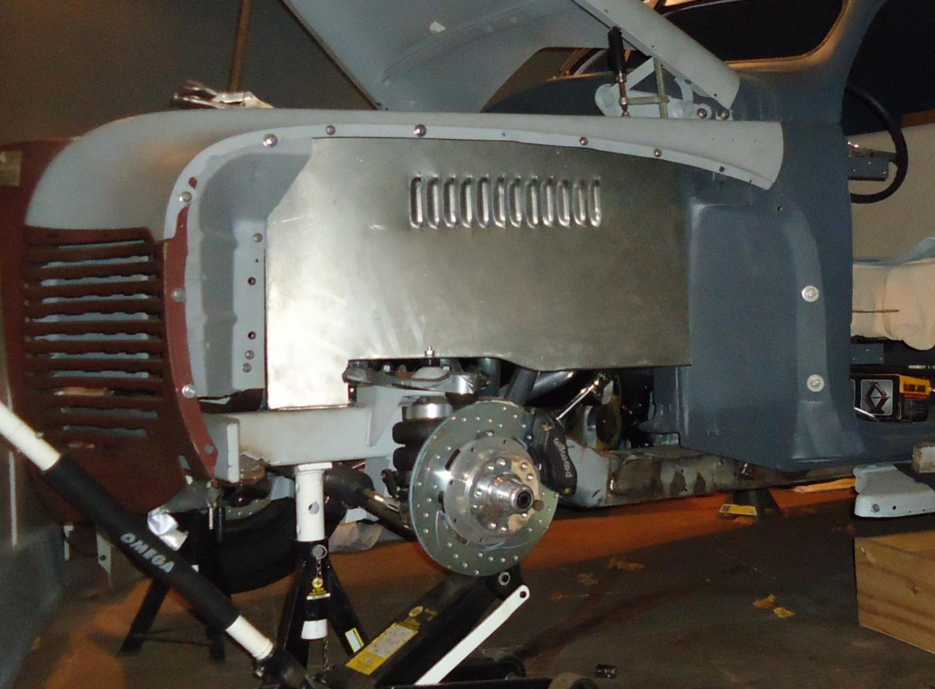

    Continued with the driver side inner fender today. First thing I did was bend/hammer the metal nearest the radiator support outwards. This will give a cleaner look inside the engine bay, but at the same time making it harder to remove and install the radiator.
    Next was a test fit and mark the area where the engine head was hitting. Cut out the required area and yes, another test fit. Then fabricated the required piece and welded it. After a bit of grinding, I got it to fit perfectly. Then welded it to the inner fender and cleaned up the welds (until I ran out of discs and Dremel bits).
    Tomorrow more inner fender work.:D

    Can you get the valve cover off with the inner fenderwell in place?

    Getting the valve will be a little struggle, but by loosening some of the bolts of the inner fender, it should come off. Hopefully I'll never have to.....
