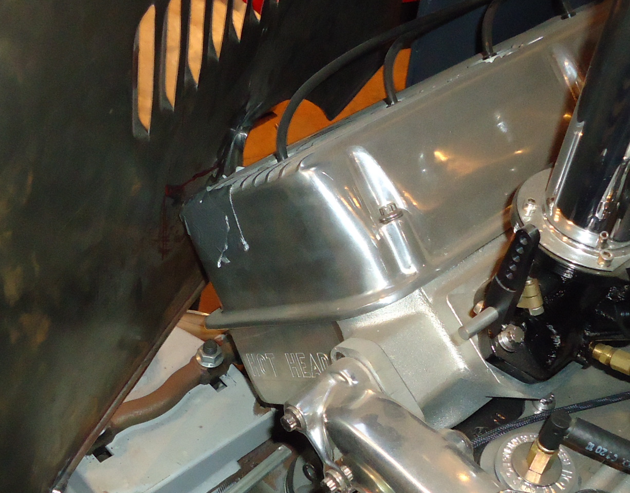

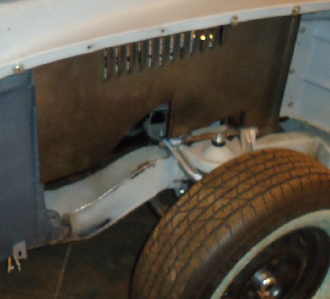

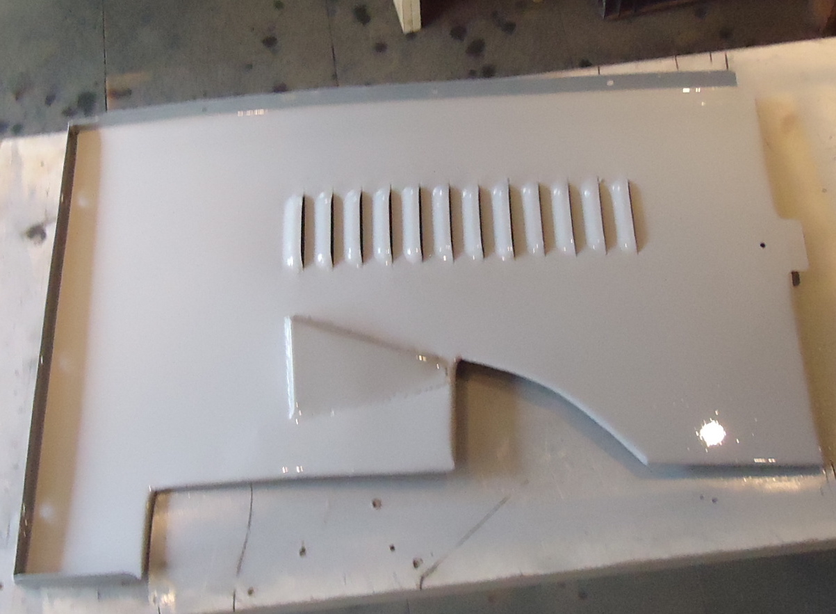

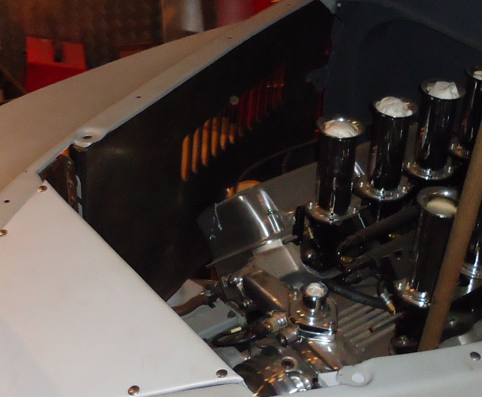

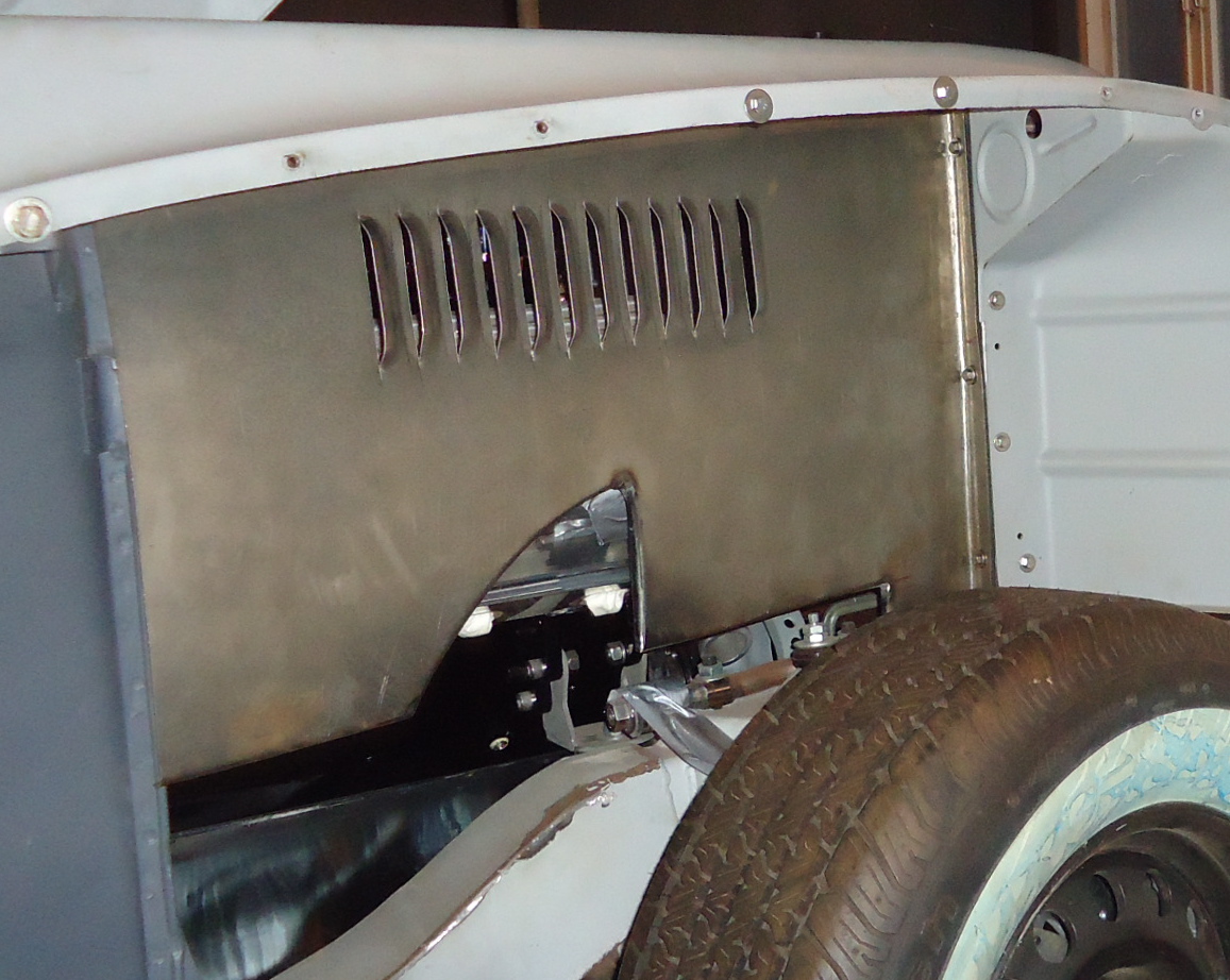

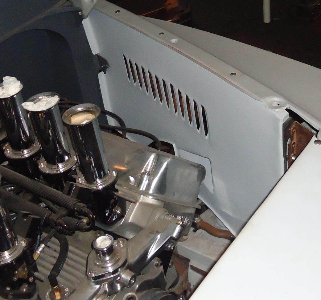

    Painted the other side of the inner fender and mounted it in place.
    Also started with the p***enger side and did a test fit after I'd done most of the modifications this afternoon. An extra "box" will also need to be created for the head on this side. I'll continue tomorrow with more test fittings and modifications:D

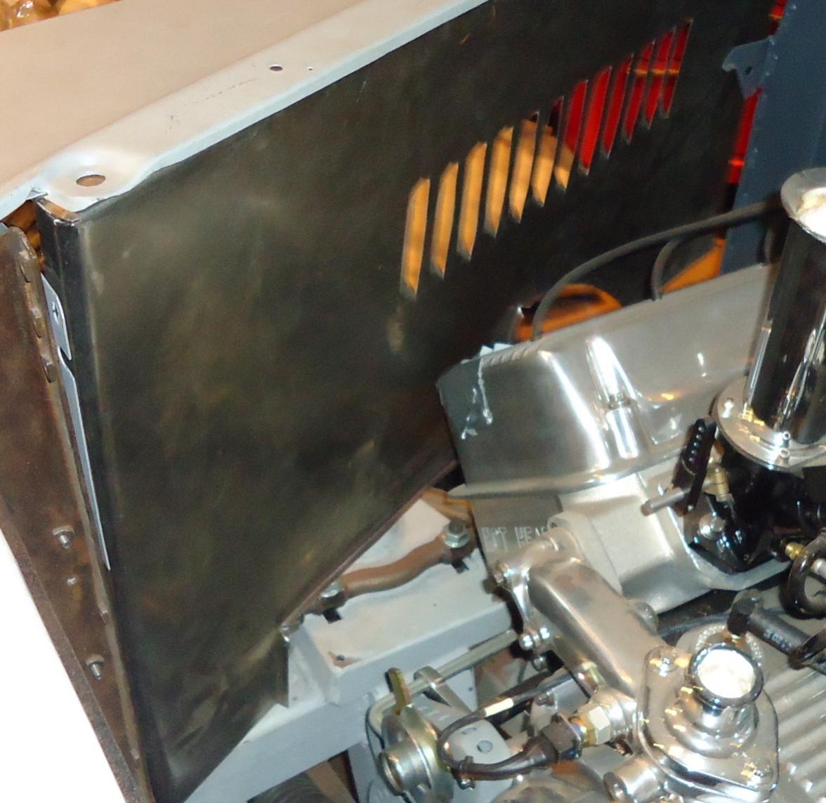

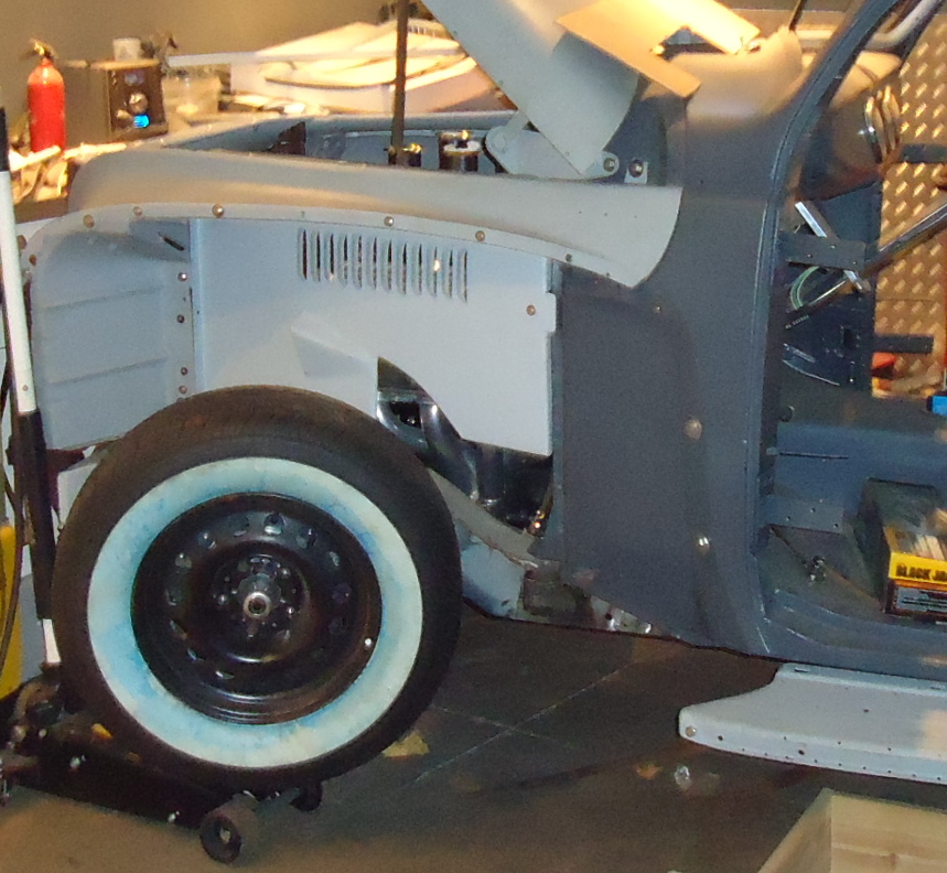

    Had a few spare hours today. Welded the corners of the lips, drilled the mounting holes on top and on the radiator support and did another test fit once again. Next on the list: Creating room for the cylinder head and do the area near the firewall. The saga continues...:D:D:D

    Looks good again!
    Got any pic from the engine bay with the both panels bolted on?

    Thanks Finn! I'll see if I can shoot a pic next week.

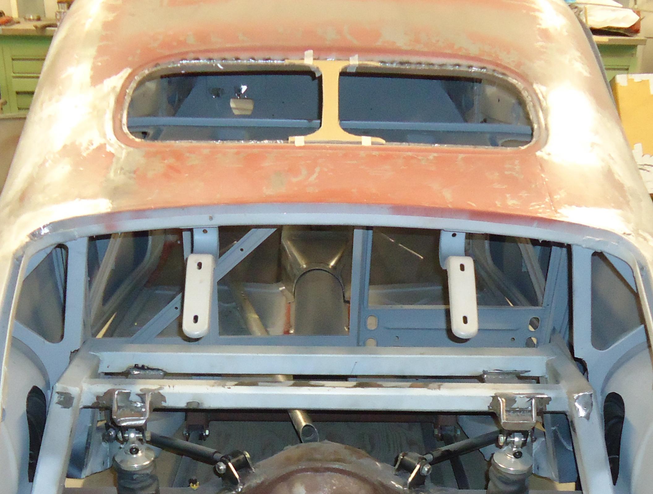

    Lookin great Eric. The inners are really coming along. Check out the 48 I have updated a few more pics. Ditching the stock rear window for a 40 ford split. Should carry a cooler view from behind.
    Matt

    Thanks Matt. I'll go and check out your updates. I did it mock up of the rear split window (cardboard) but decided against it. My view to the rear is already limited due to the chop. Below is a pic from 18 months ago.

    The nice thing is with laying down the rear window in my 48, I didn't lose much size. Even with the 40 Ford split rear window I still retain a pretty decent size with it laid down. Besides thats what mirrors are for buddy lol. ;)
