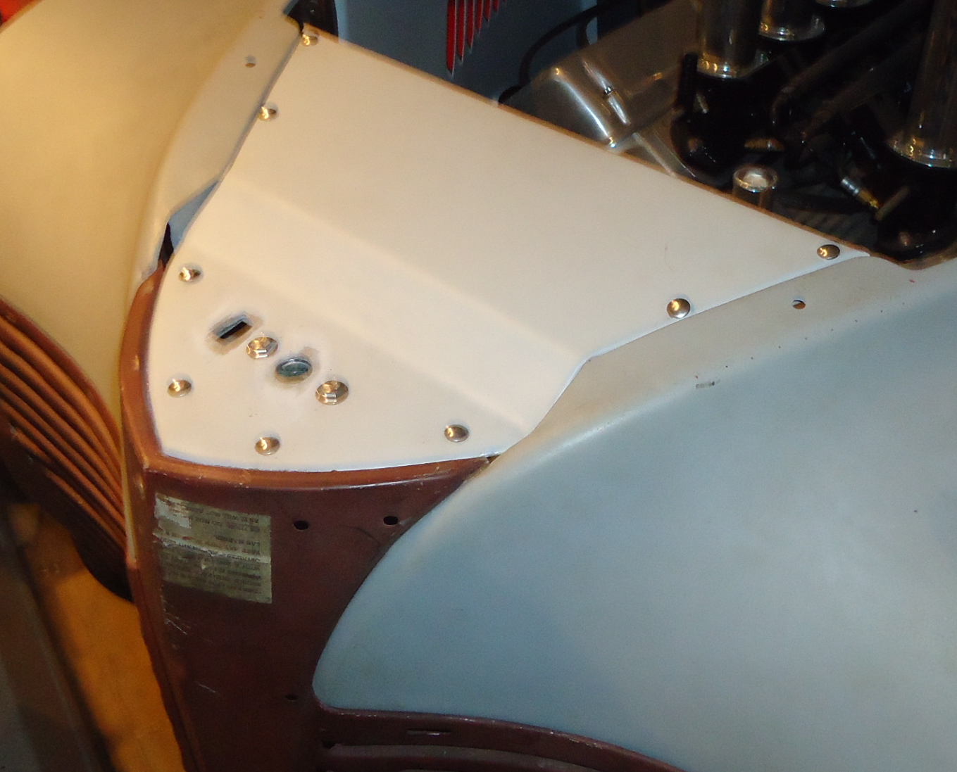

    Nice fabrication on the inner fenders. looks awesome.

    Yes David, it's dust indeed...but the engine will be cleaned before I mount it for the last time after the ch***is is painted. I need to think of a way how I'm going to keep the hood open, without a broomstick.... Still got some time.:D
    Thanks Scott. The inner fender it held in place by 7 bolts and can be taken off in about 5-10 minutes....not that I expect to take them off often once the car is finished.

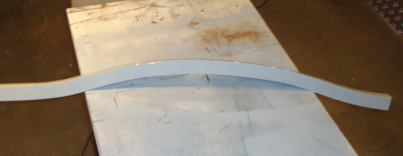

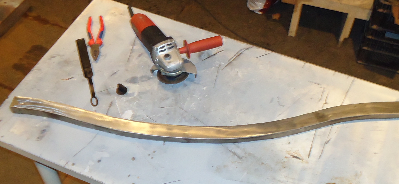

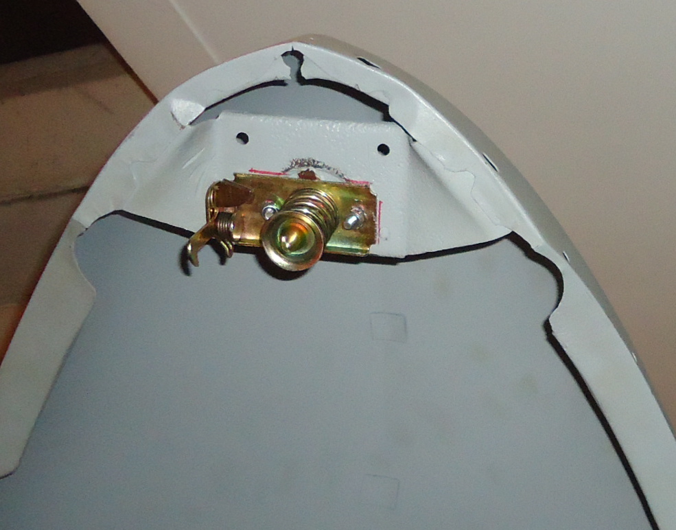

    I can tell you one thing, it was cold in the garage today, with the little electric heater being of some help. Aligned the hood and bolted up the top part of the hood latch.(this will be finished next week.). Next I installed the bottom half, requiring a fair bit of measuring and Dremel work. Also finished off the U-shaped profile which is part of the inner structure of the rear deck lid. Getting closer!!:D
  17. Is that the factory hood latch or an aftermarket piece? Either way, it looks good.
  18. farmer12
    Joined: Aug 28, 2006
    Posts: 7,723
    farmer12
    Thanks David. It's an aftermarket piece and seems to work fine so far. The factory part I had wasn't in the best shape anymore.......just want to make sure the hood doesn't accidentally open when I'm doing 200 mph.:D:D

    looking great eric. I like the panel for the hood latch. Question for you. With your hood are you gonna reinforce the plate that the latch bolts to? I know with my 48 I my found out that this area was easy to twist and bend out of shape. Coincidentally the guy I got it from said the hood came up trailering it home. I just figured better safe than sorry. I added a plate from the latch plate to the point of the hood basically making the front of the hood one solid piece.

    Hey Eric, do i spy a Volkswagen hood catch ***embly buddy, they are a very popular part to use on 40-41 Willys hoods and other hot rods too, very neat and compact in size and the best thing is they are readily available as a new part, and that is World Wide. Will you be painting the firewall a different color to the body and or the inner side of the inner hood sides too ?

    farmer12
    Thanks 48plysled. I plan to fabricate and weld a piece to the point of the hood to make it one solid part. At the moment I have the latch bolted in there, so I could work on the grill latch. But before I do that, I'll need to re-shape the point of the hood as it's not lining up nice enough with the top of the grill. The hood seems to have a bigger radius and I don't just want to use bondo on the grill to make it work. Just as I thought I was getting close to body and paint....

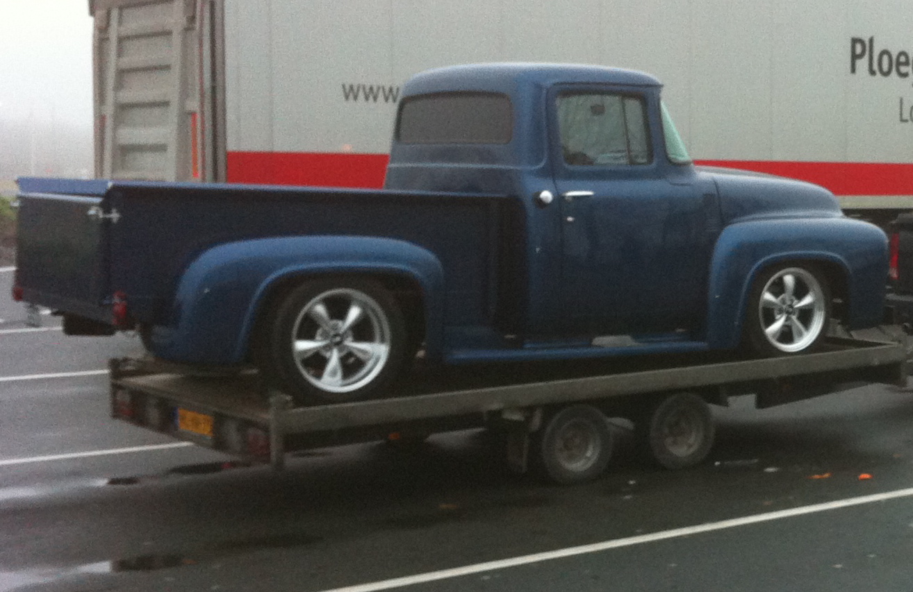

    Got some work done today, but first here are a few pics of the little roadtrip my friend Bart and I made yesterday. We took his 56 f100 to the muffler shop and did some work on his brake booster while we were there. It was another great day.:D

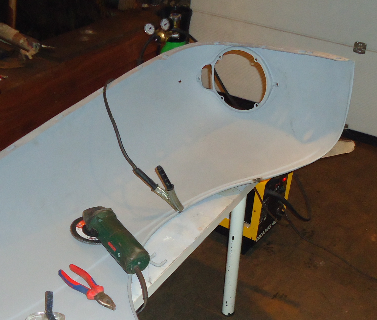

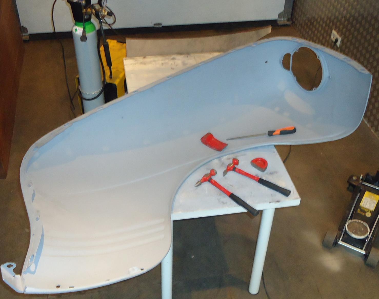

    Today was a cl***ic lesson in taking it one step at a time and in the right order! I started aligning the hood, but didn't fit the way I wanted it to. Then saw that the outer edges of the grill was hitting the frame, so it was time to cut two pieces out of the frame. Then realised that in order to get the front end body parts to line up properly, I need to re-install the fenders. Picked up the fenders from the corner of my garage and saw that I hadn't done any work on the lips....a crucial part of course to give the fender the right shape........so there you have it. I started with the hood and ended up reworking/welding the lips.:D
    I managed to finish the drivers side and will move on to the p***enger side soon.

    Hi Eric, cool truck your buddy Bart has. Ad isn't it always the way when you are doing custom work, in order to get ahead, you have to take the long way around doing other jobs before you can tackle the job you set out to do. It is so confusing, i just confused myself. :confused: :D

    Hi Eric,
    great attention to detail with the fenders, but what else could be expected from you.
