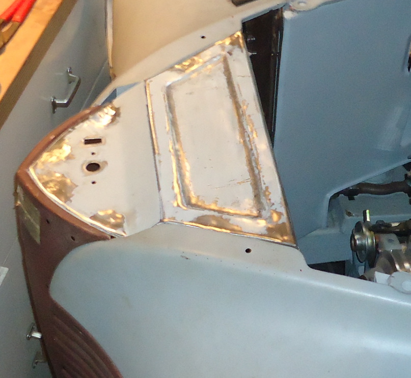

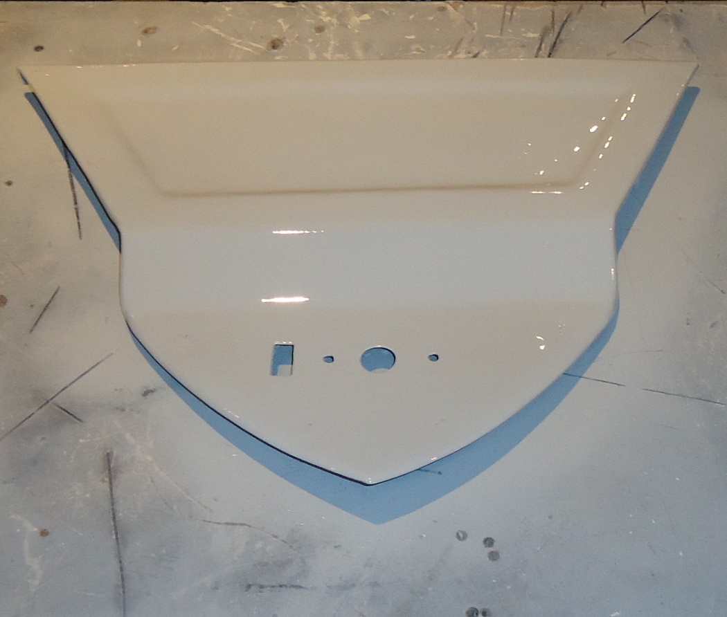

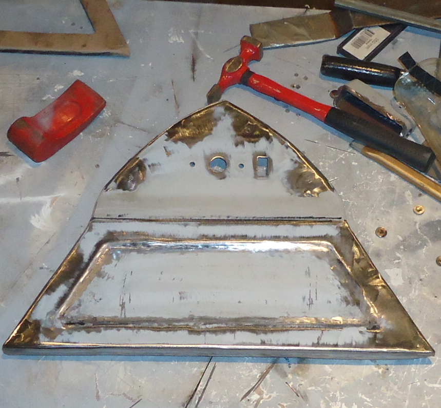

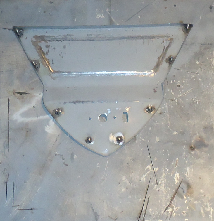

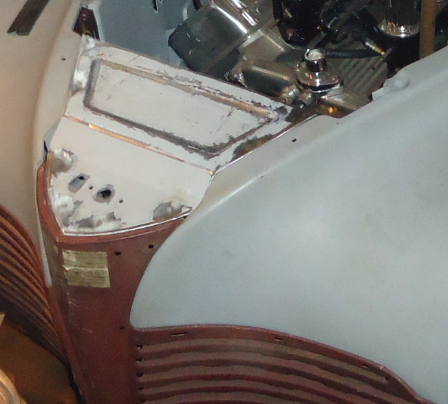

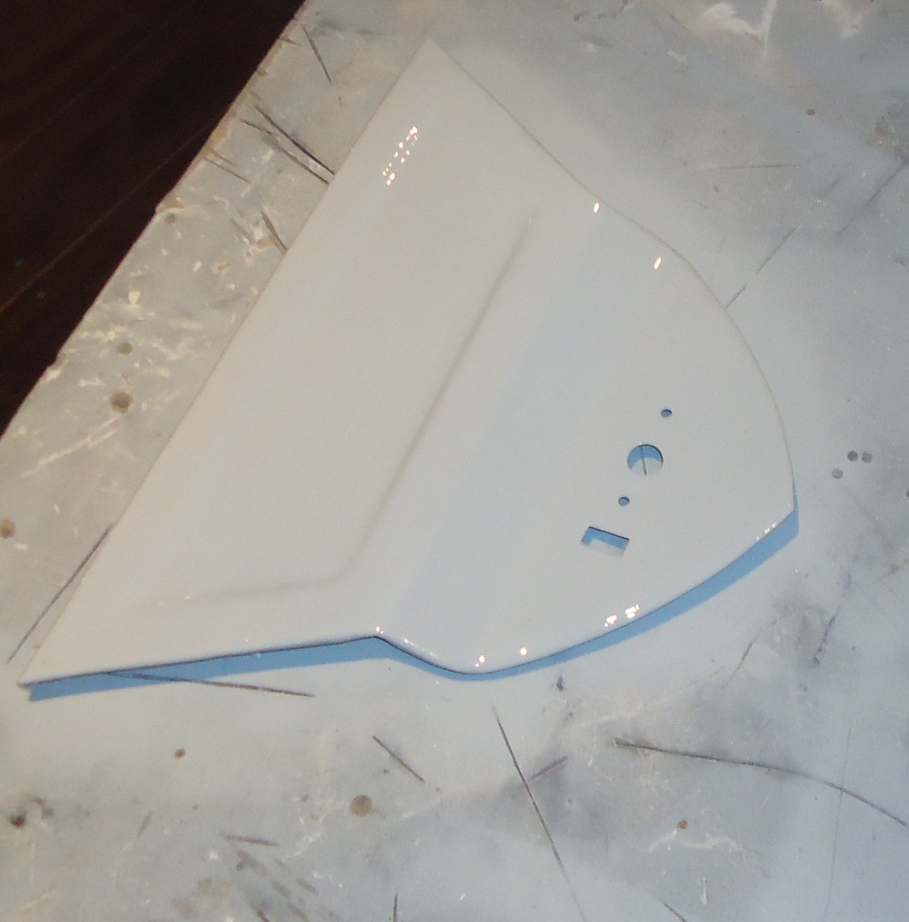

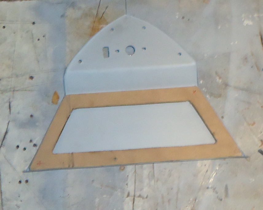

    It was great to be back in the garage again! One thing I wasn't happy about was the filler piece in the grill where part of the latch mechanism is. So it was time to take it off and customize it some more. The 8 bolts holding it in position looked a bit cheap a$$ and I came to the conclusion that I didn't like the big flat area either....
    First made a template out of wood and then proceeded to hammer away. Ended up with a recessed area in the middle. Much better! Then cut the heads of the bolts and welded them in place. After a few test fits and some more minor modifications, it's now looking the way it should have in the first place. Gave a few coats of primer and should be dry in the morning. It may seem like a waste of 8 hours of labor, but I'm happy now.:D

    looks good man. I think that the indentation really adds a little more flavor to this area.

    Looks even better than before. Nice job as usual.

    PLUS !!...it keeps round things like sockets/extensions/screwdrivers/beer from rolling off an otherwise flat surface
    great work Eric... looks like it came that way from factory

    There's a good thought gatz! :) I do think it came from the factory slightly different, but no one would know unless they're an expert on the 40's Plymouth. So why modify, you ask? Because I think customizing is also in the small details. Thank you for the positive comments.

    Far from a waste, looks great. Nice touch.

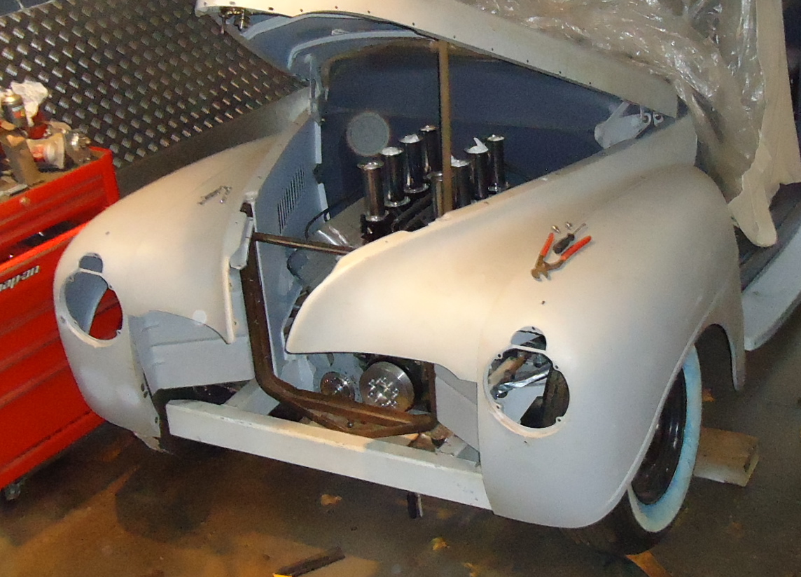

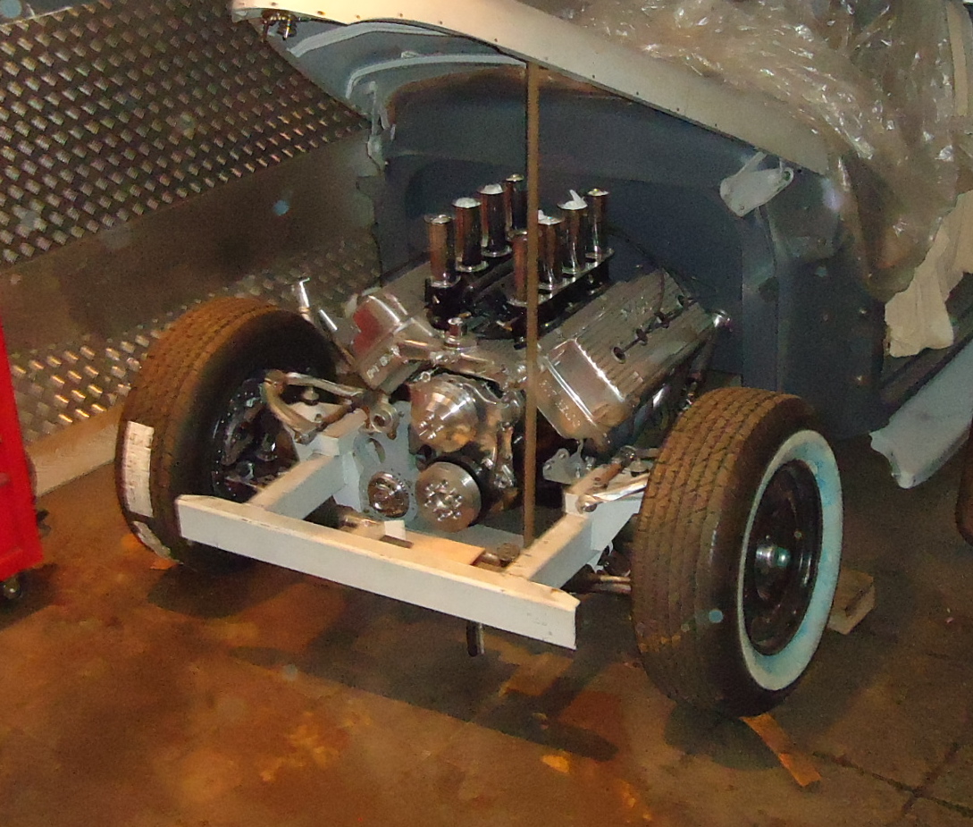

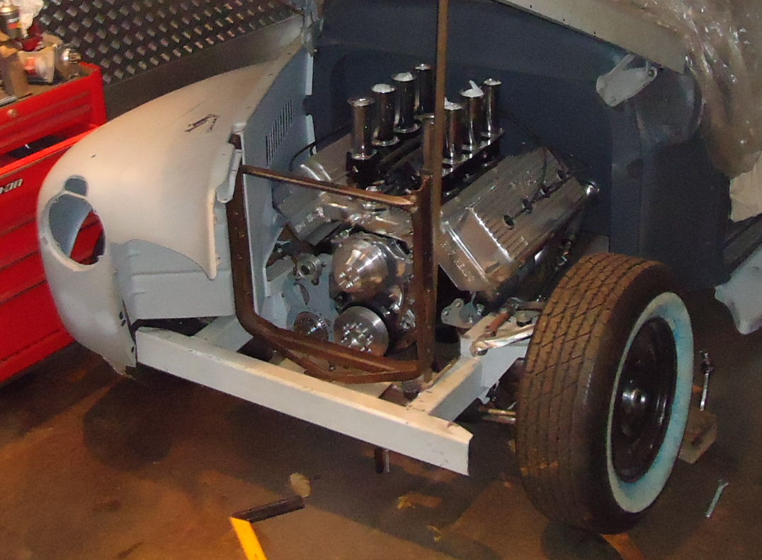

    Started dismantling the front of the car today. It was time to clean up the garage, re-position the car and get to work. There are still quite a lot of (small) things to do, but organising and prioritising was high on the list too.
    On a side note, the front fenders still need to be welded together and get leaded and this can't be done while on the car.:D
    This afternoon I took the aluminium grill to a buddy of mine who will weld all the holes for me. That is one job I can't do myself!
