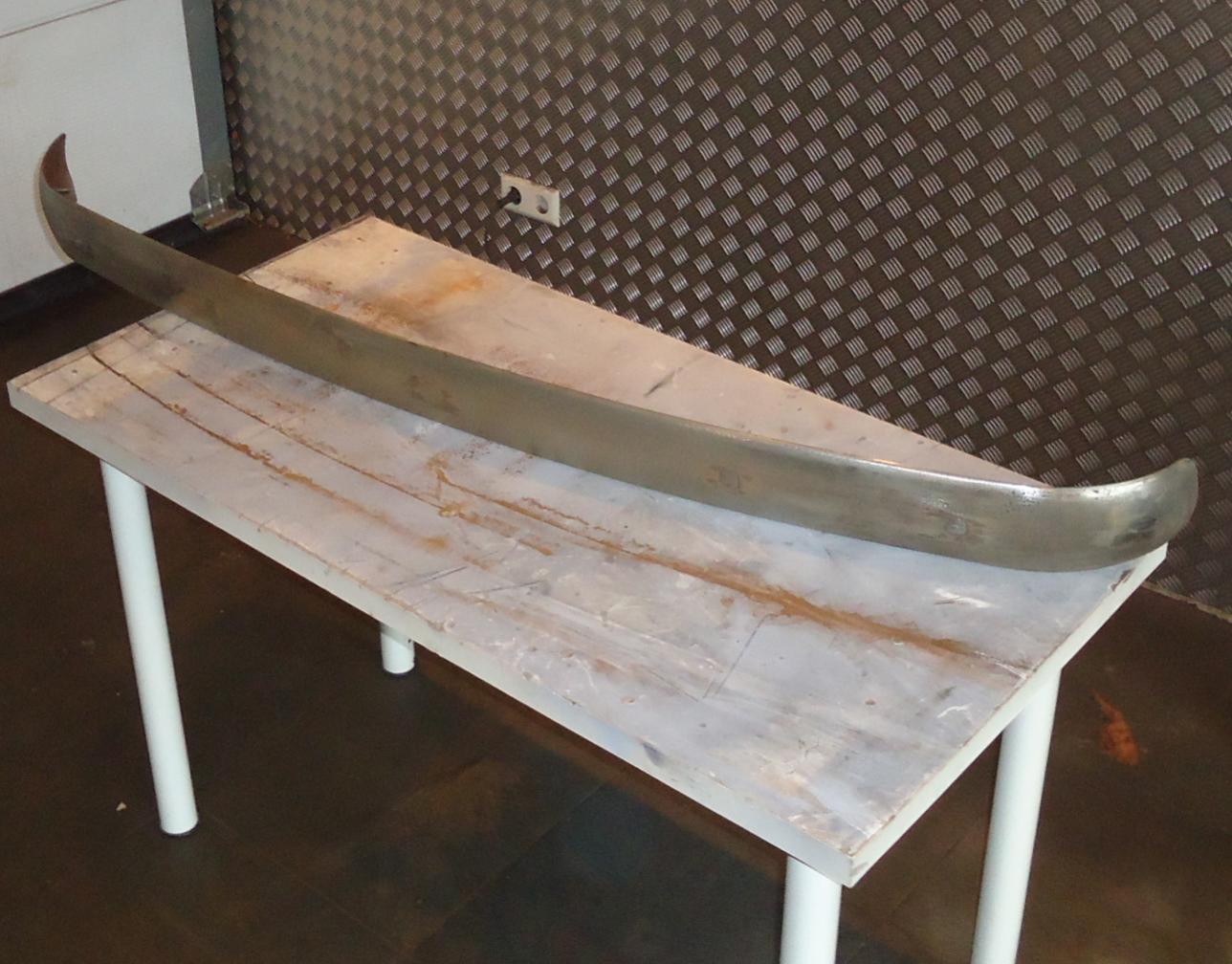

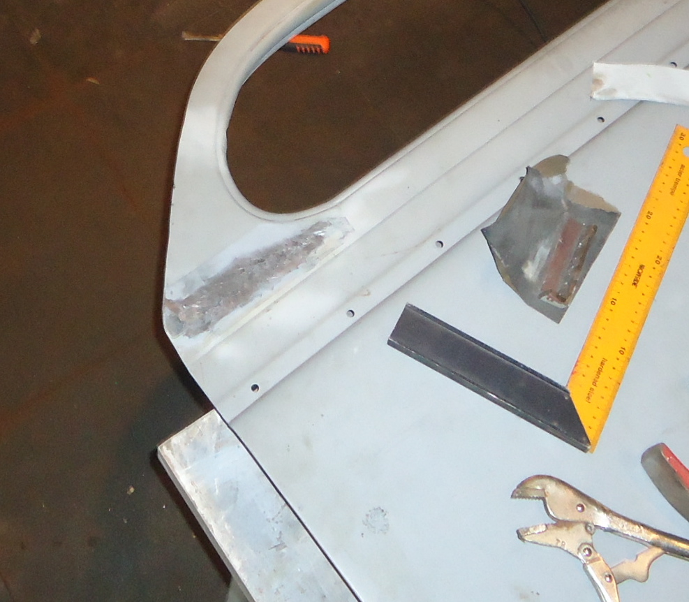

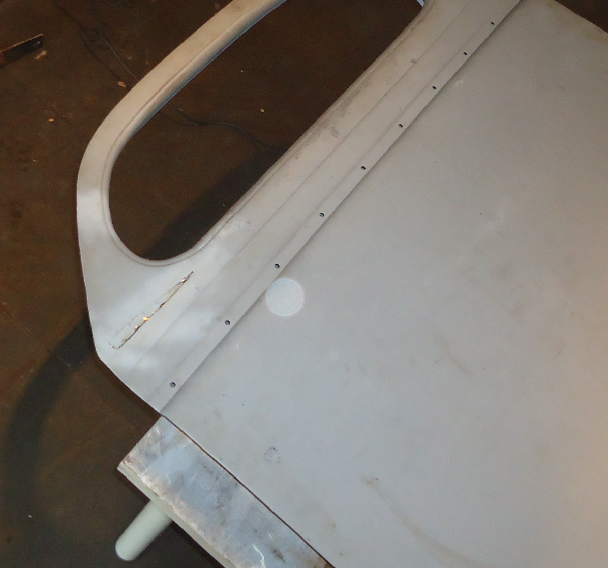

    It was finally back to the garage, now the temperature in the garage is bearable again. Started by shaping and grinding the rear bumper and getting it ready for chrome next month.

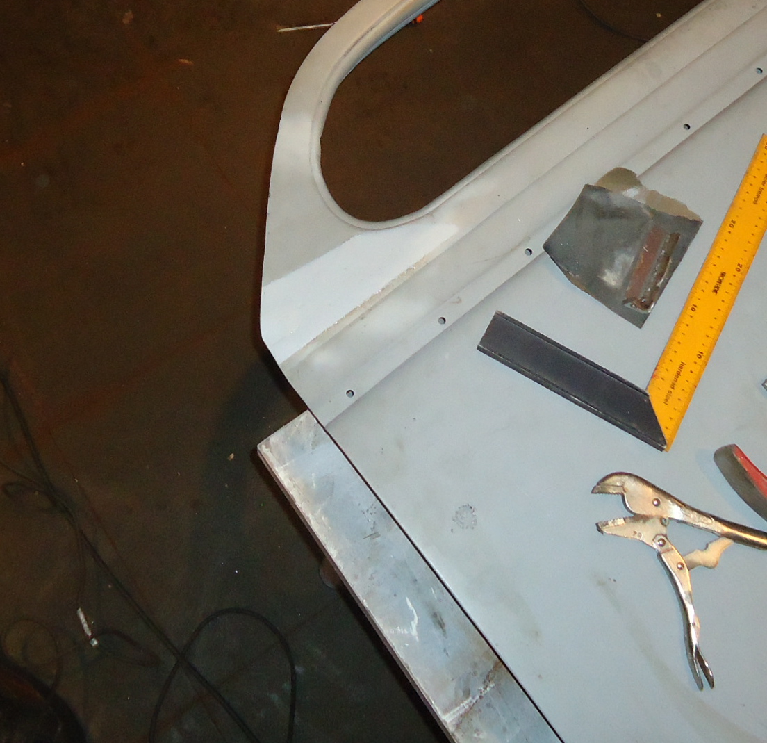

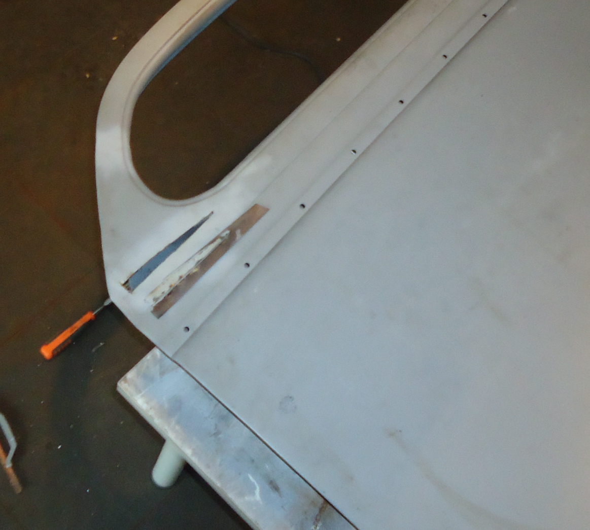

    Then started on the driver side door which had a horrible fill piece welded in. I thought it was a triangle piece which was welded in low by the PO, but it turned out to be a very much larger rectangular piece placed under the outer skin of the door. That must have been the easiest way out.....
    Anyway, cut a new piece to fit in the hole, welded it up and gave it some paint. More work on the door tomorrow.:D

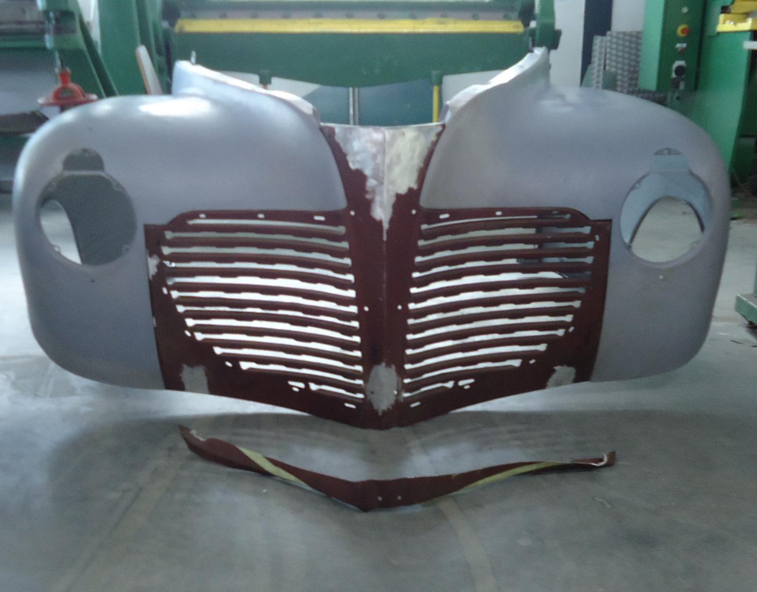

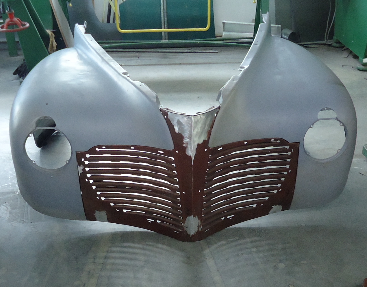

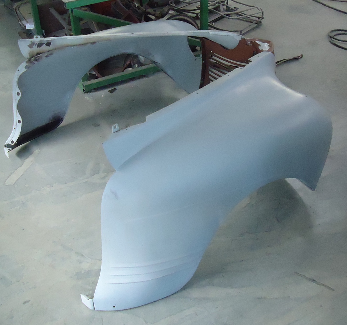

    Apart from doing a little welding today, I went over to a buddy's place to sort out a thing or two regarding the front grill. The bottom part is just too low and doesn't join the fenders nicely. So the decision was made to not only change the side of the grill, but also take 2 inches out of the lowest part at bottom. This way, the bottom will follow the stainless "heart" trim as well. Bolted it all together and it appears to be a more balanced piece now. Got my buddy to weld a few holes in the aluminium grill and all is done now.
    The fenders are also now welded together and leaded. Another job done! Yes, I'll work on the door again tomorrow. I promise.:D

    Nice job on the leading and the grill. I suppose you'll need to shorten the vertical trim now? Looks awesome man.

    Thank you Hogman. The trim will need to be shortened indeed. At the same time, I now have a little more room for my license plate bracket now. Here's a pic of how much was actually taken off the bottom.

    Will you be happy with the 90 degree angle edge part of the upper part of the grill that is next to the headlights? If that corner could be rounded you may be happier? I'm not sure what it might look like when finished, it might be fine, but in these colors it looks a little out of place

    I know what you're saying. The aluminium grill still has a protective coating and with "heart" trim on it, it will hardly be noticeable when finished all in black. If I had used my original steel grill, I would have welded and leaded it. That's the price you pay for using lightweight parts.:D

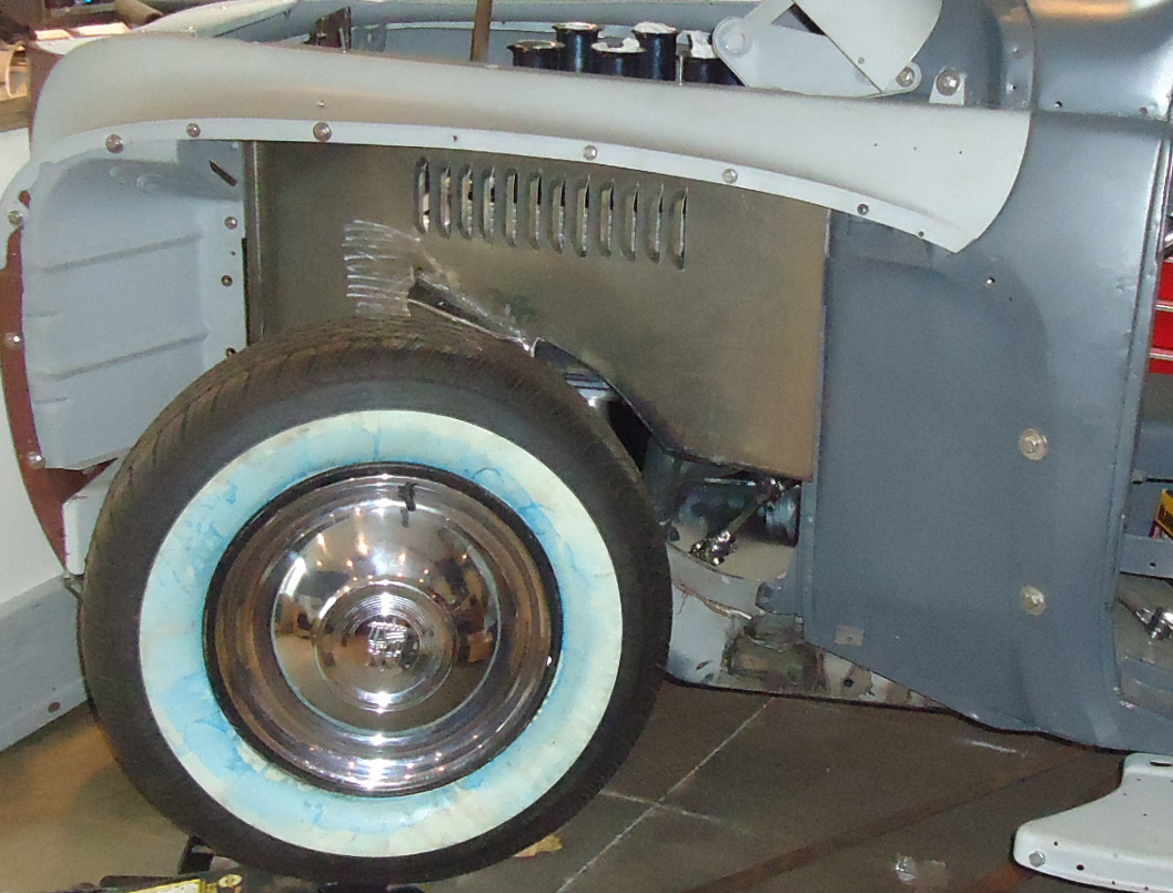

    farmer12 I am just diggin the inner fenders brother! They look good in there

    Thank you Rob! I've actually just widened to mounting holes in order to ensure I don't force it into position like I did originally.
