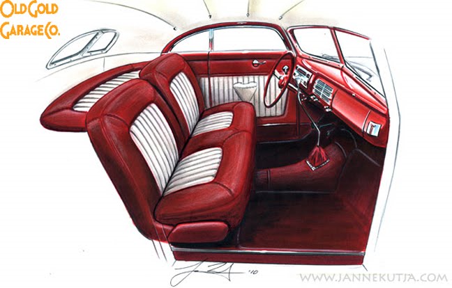

    Thanks Rock! How's yours coming along? I'm on holidays soon, but can't wait to get back into the garage. Lots of new ideas have popped into my head lately, including interior thoughts. I love the look of this interior, not so much the colour scheme, but just the overall look/feel.
  15. rockable
    Joined: Dec 21, 2009
    Posts: 5,060
    rockable
    That is a cool looking interior, for sure!

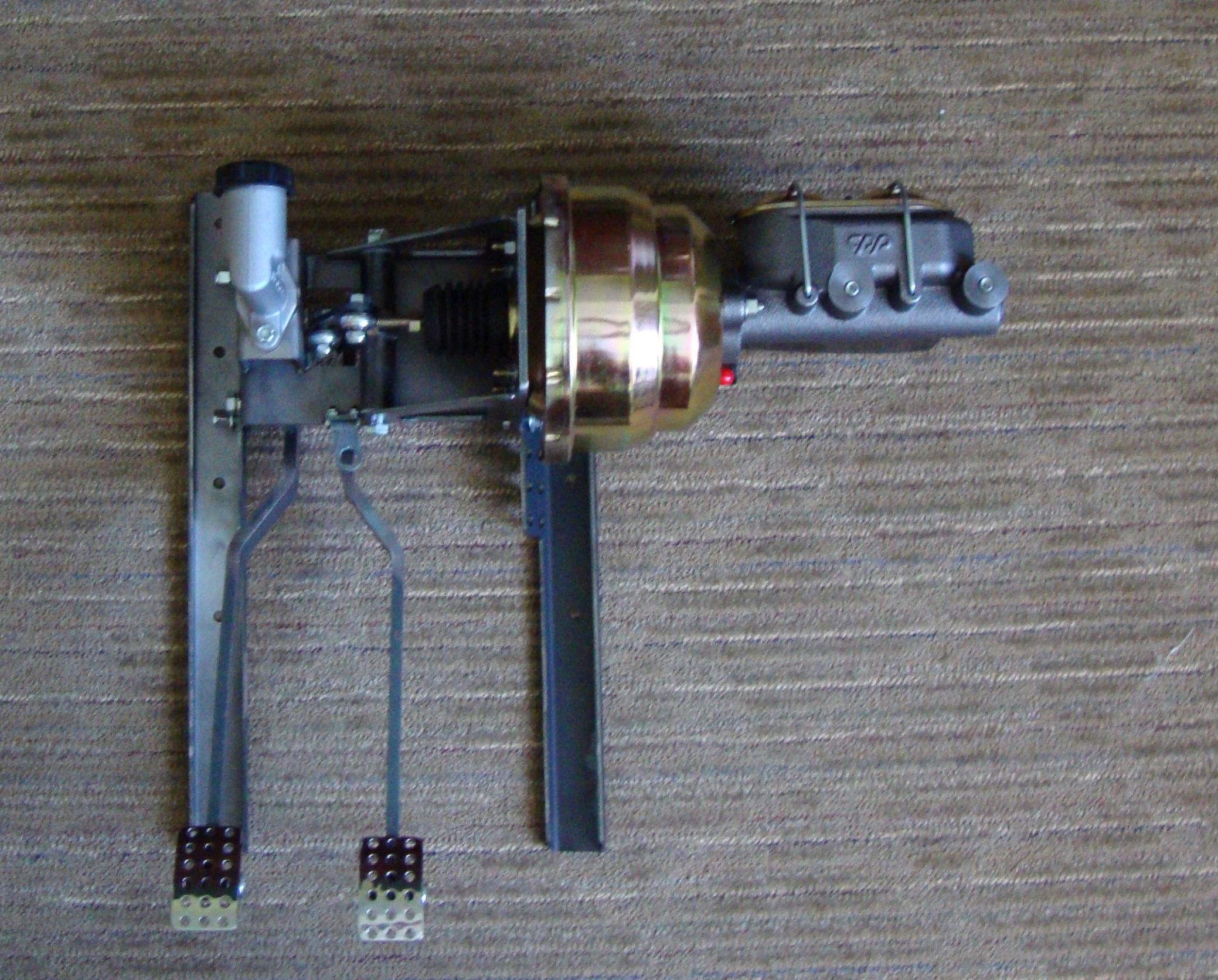

    Just received my 90 degrees brake and clutch pedal ***embly with mounting brackets from Kugel Komponents. Wow, is this thing well engineered or what. Considering I don't have any room in the frame for the brake booster and want to keep the engine bay clean, I opted for this 90 degrees set up. It will be bolted against the firewall, hidden partly behind the dash.Will eventually paint the ***embly to either match the exterior or interior colour, haven't decided yet. Also got these great ss pedals with matching accelerator pedal. Things are coming together!

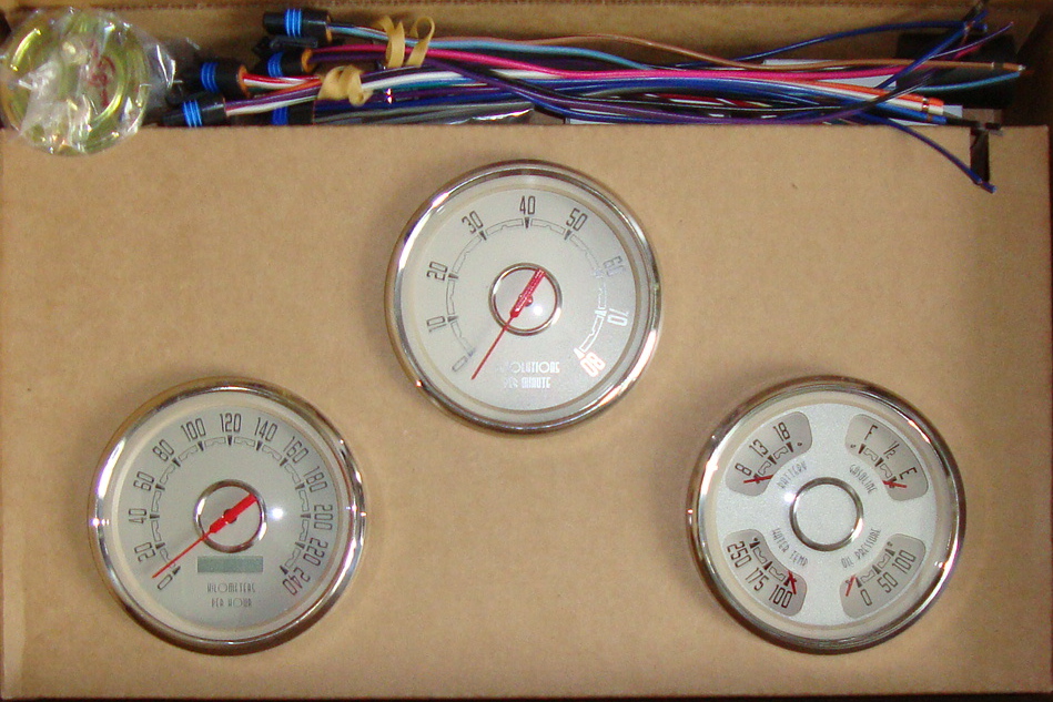

    Just received my gauges from New Vintage USA, do they look good or what! They even made a speedometer for me in km/h. Can't wait to install it in the dashboard, but first I'll need to do some more metal fabrication.

    Those look really nice, Eric but they won't mount in the original instrument panel area. What is your plan for mounting them? I've been studying mine and was thinking of mounting the 4 small gauges in the original panel area and then putting a speedo/tach combo unit in a pod mount on the steering column like the old Sun tachs.

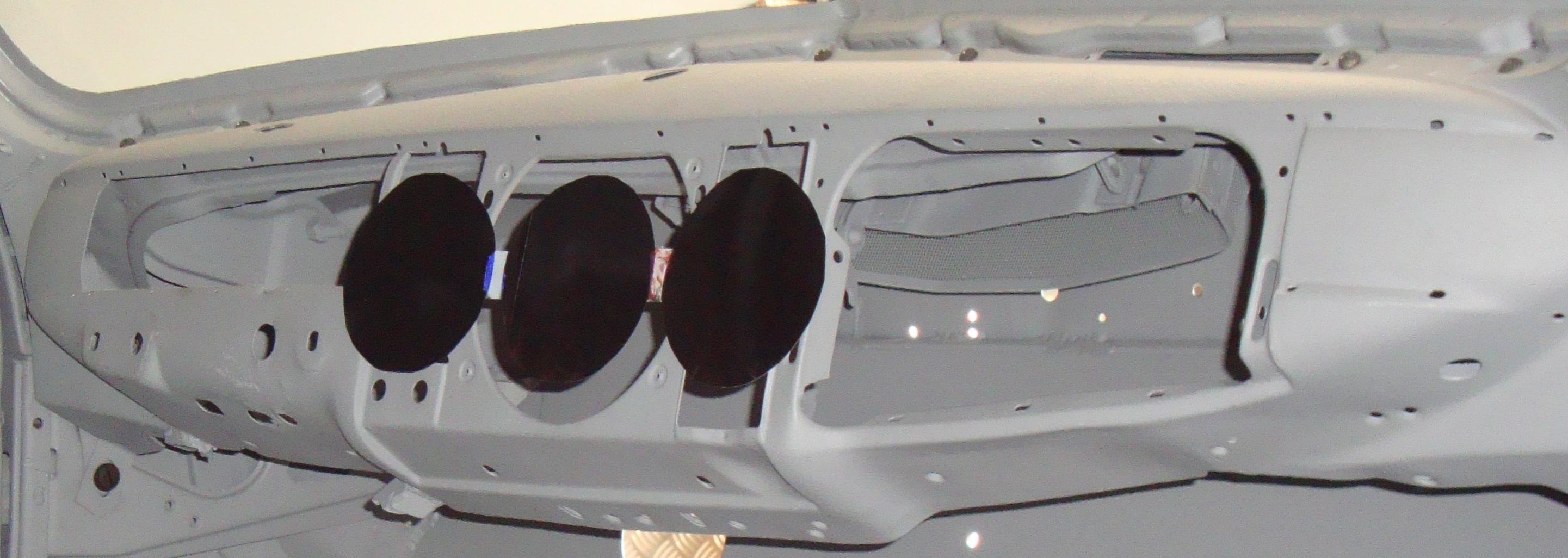

    Rock, I played with the idea of trying to fit everything in the original cluster area but wasn't able to fit it all in the relative tight area.(even when using smaller gauges). So the plans now are to mount three big gauges in the center of the dash and weld up the rest to get a clean look. I cut out some cardboard gauges for a simple mock up. Should look good!

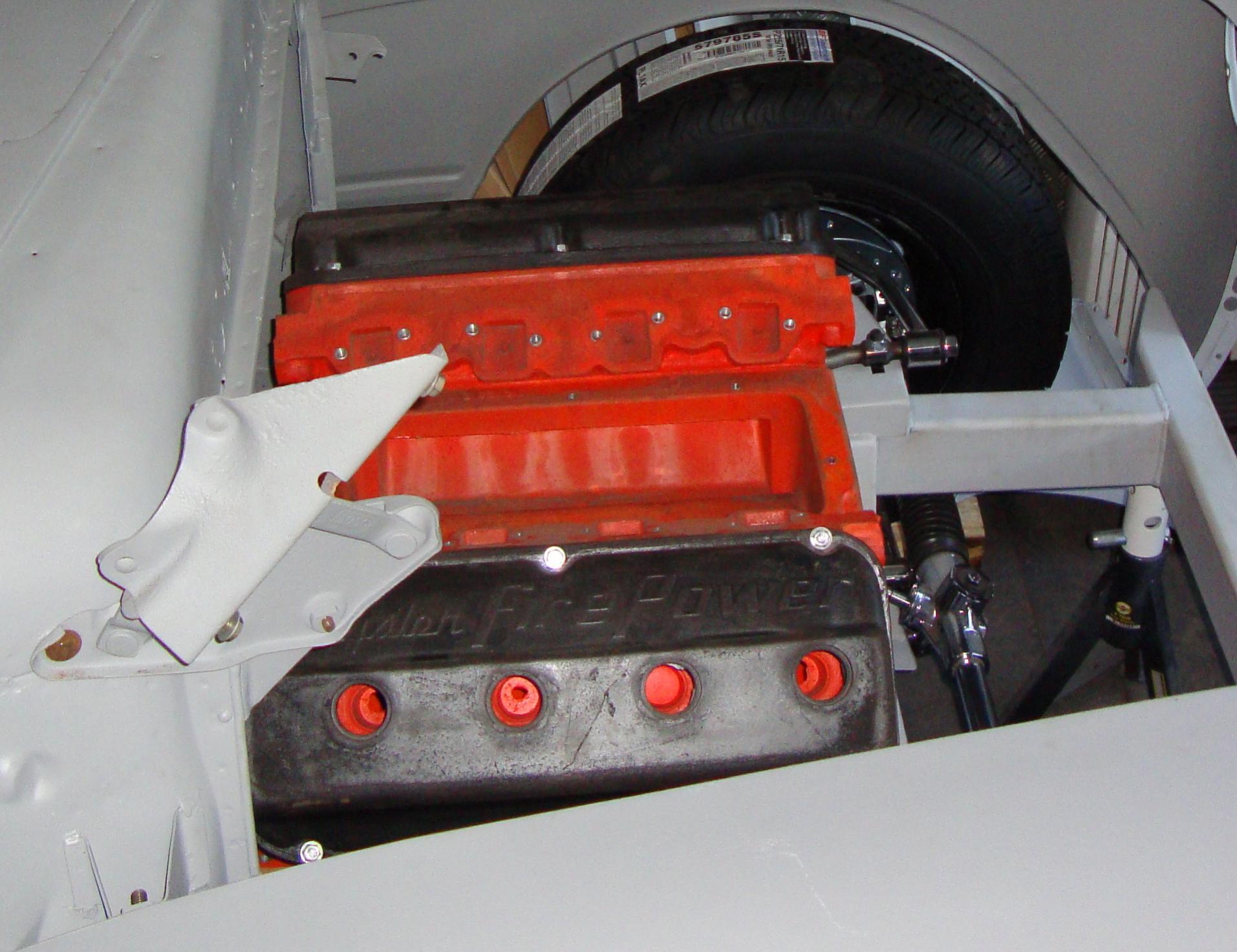

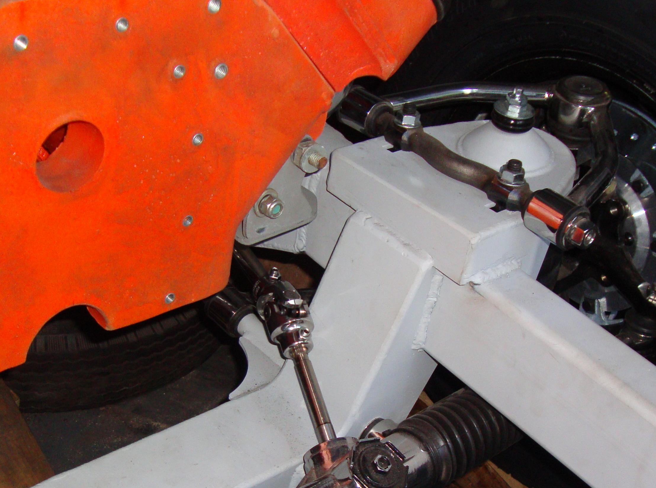

    It was good to get back in the garage again after 2 weeks of holidays. Spent most of the day working out the correct position of the engine and box. Also with regards to pinion angle, driveshaft angle relative to the gearbox, etc took quite an amount of time. Finally after a lot thought, slanted the engine 2 degrees down, giving me an angle with the drive shaft of 3.5 degrees. This angle will be reproduced at the pinion later, but this won't be too hard as I can adjust the triangulated 4 link. Ran into two things though. 1) I'll need an extra coupling in the steering shaft, as it otherwise will hit the header on the driver side. 2) never realised that the engine mount on the driver side is about half an inch forward compared to the p***enger side. This engine mount will need to be cut, so that part of it will be welded on the vertical of the suspension cross member.(thought of welding the mount at an angle to the frame, but this would look strange in my opinion.) Both issues will be sorted out. This is all part of building a car I suppose.

    Just one other pic. Forgot to mention in my previous post, that the right rear intake stack will probably slightly interfere with the firewall. I'll probably make a notch or may just rework the whole firewall. Haven't decided yet.
