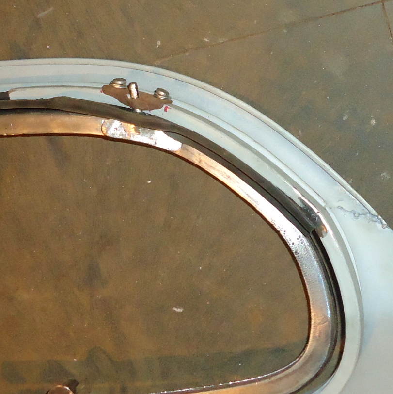

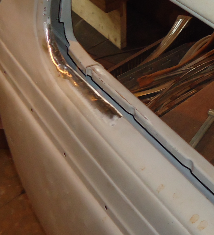

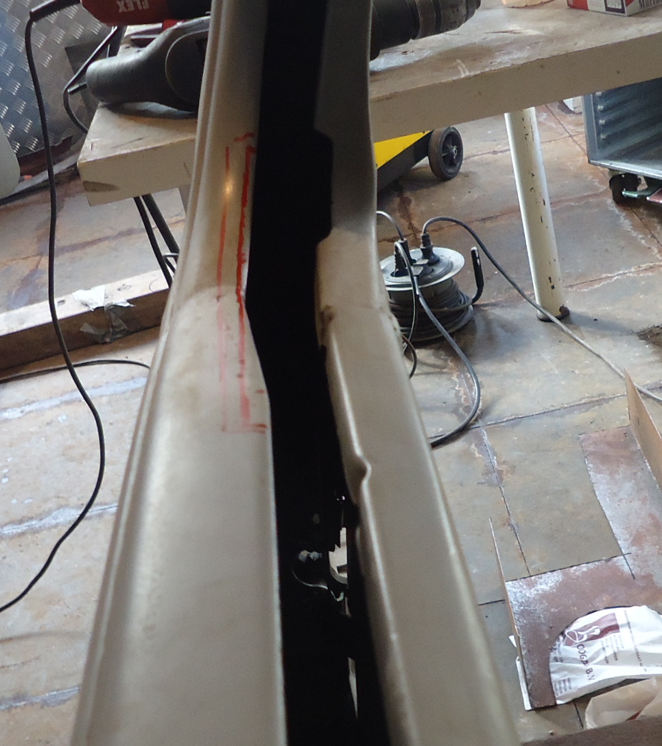

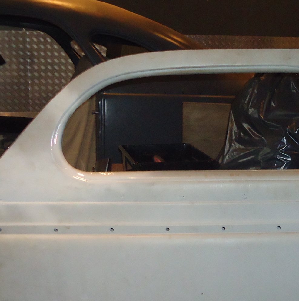

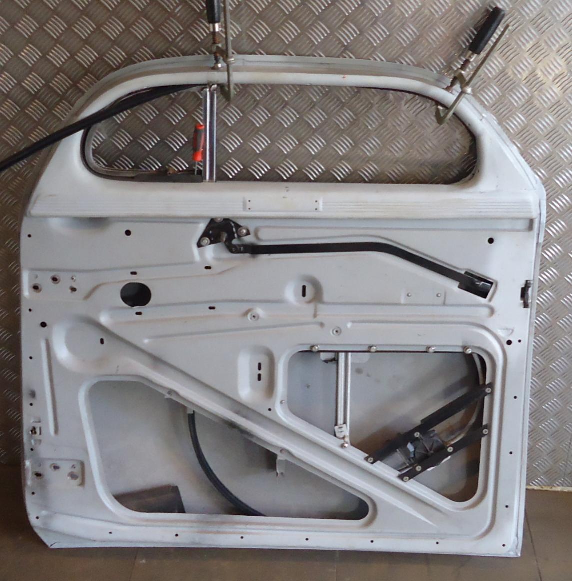

    After a break of a week and a half due to work, it was back in the garage yesterday. Both doors still require a fair bit of work, including rectifying
    some work done by the PO.
    The gap between the inner and outer panel wasn't parallel, so I marked it, fabricated a new piece and welded it in. It took quite a bit longer than anticipated, but it's done. And it's parallel once again.:D

    Nice job. The curvature in the last pic looks perfect.

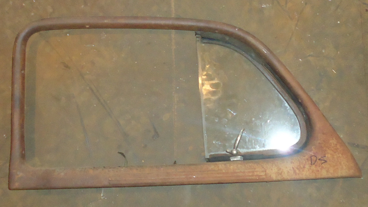

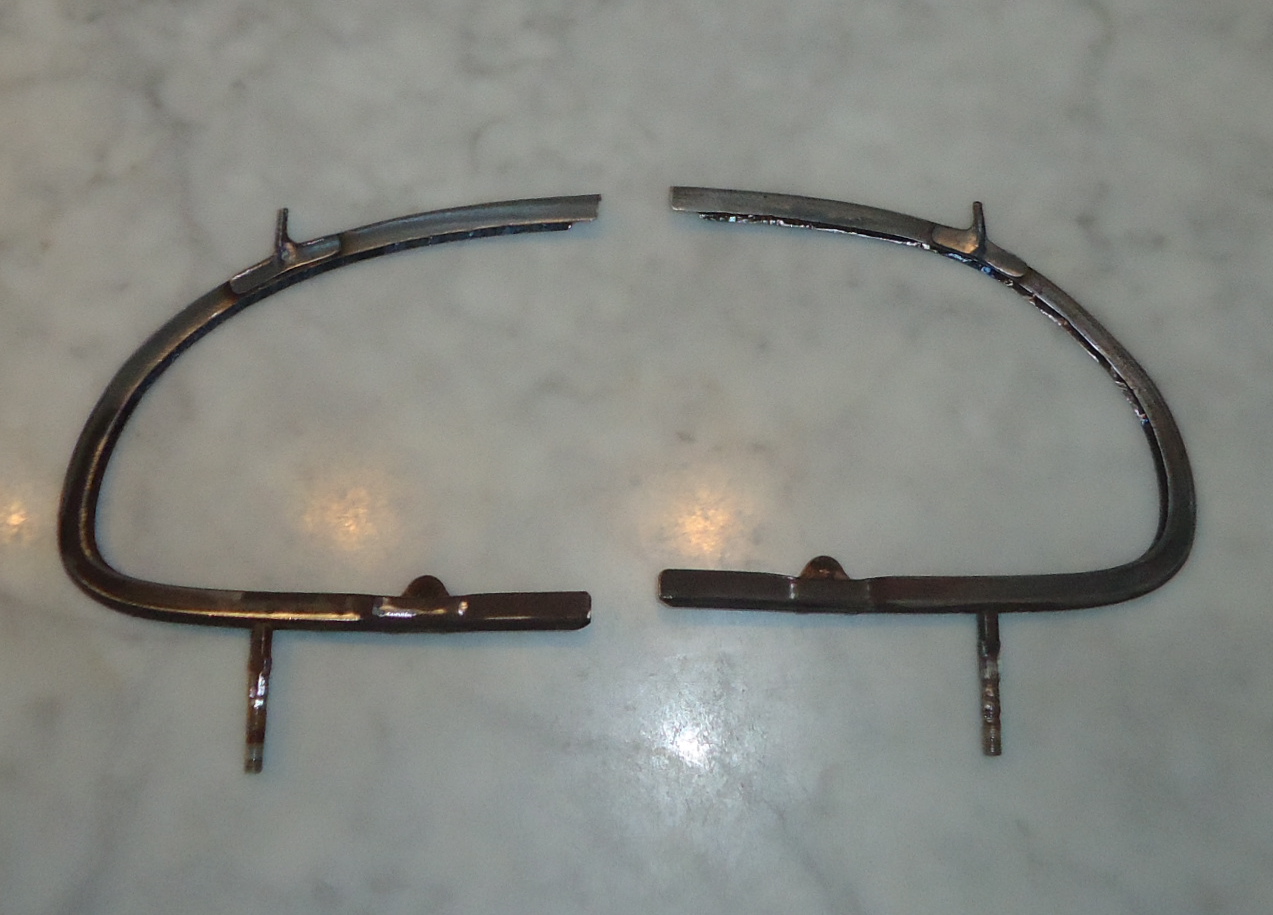

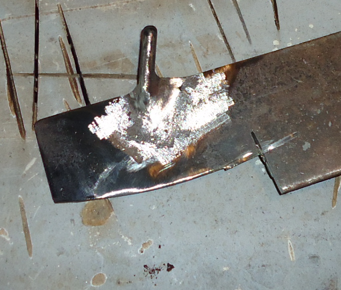

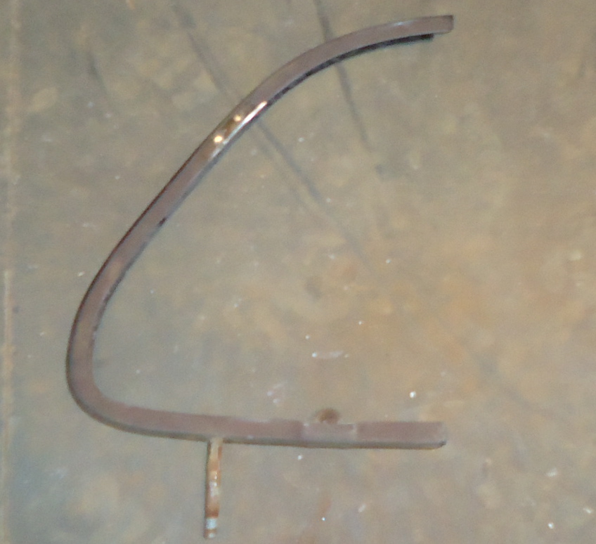

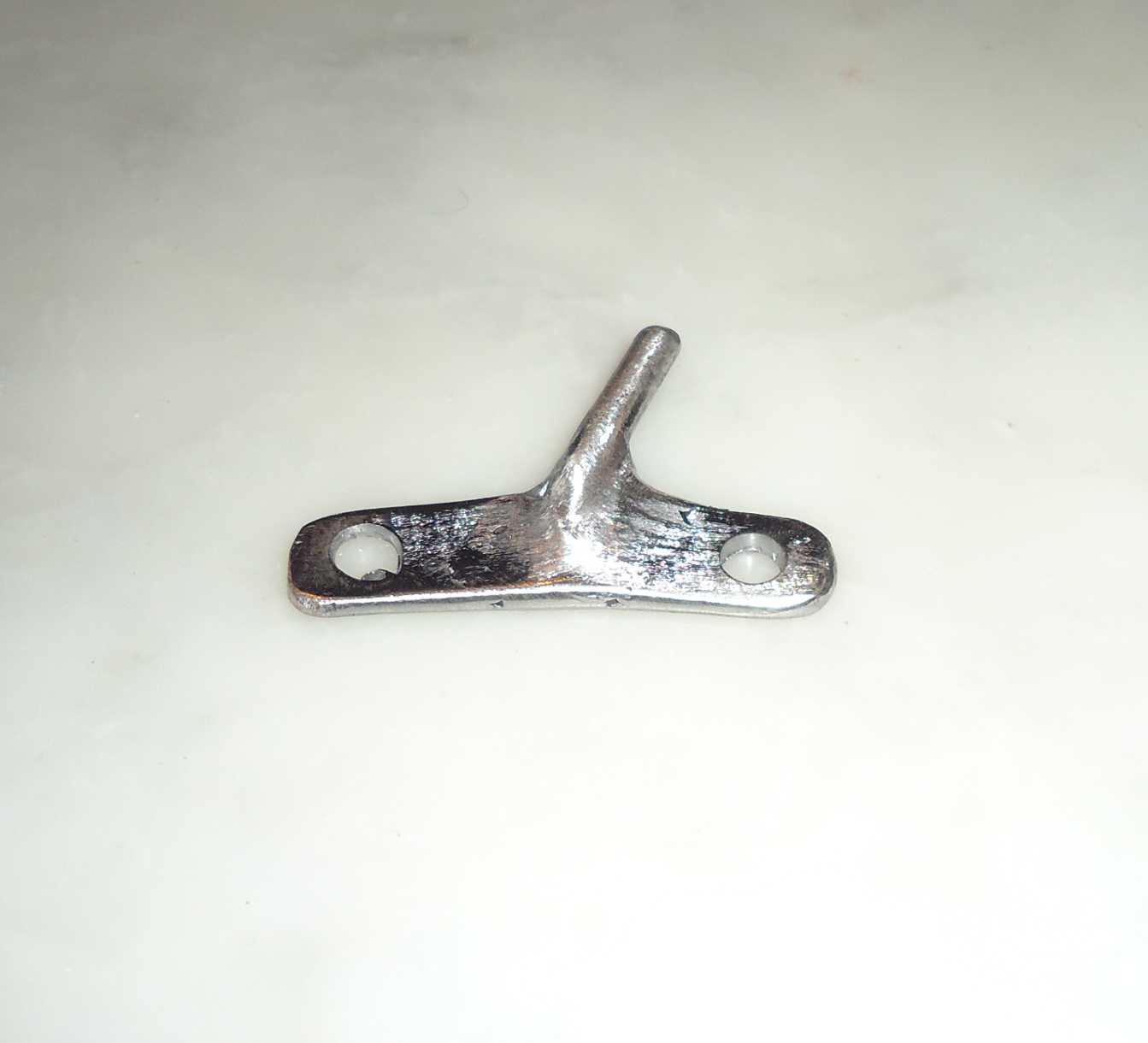

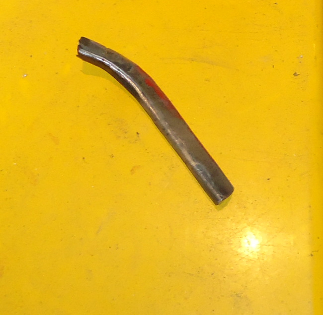

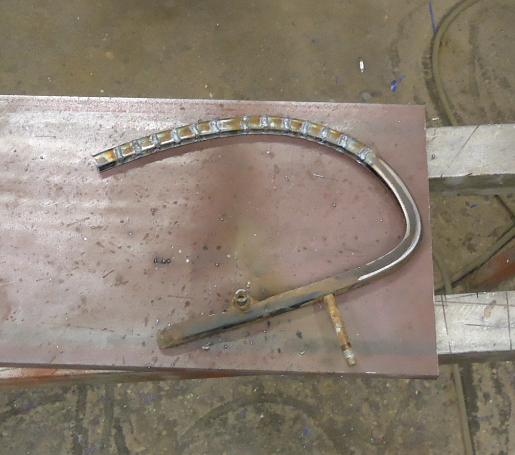

    Started on the last vent window. Removed the original one from the garnish moulding and stripped it. To get the right shape wasn't the problem, but I soon realized that the pivot point needed to be re-located for it to work properly. One small thing, I had to grind down the sides in order to remove it from the original position, so there wasn't much material left.
    So I still had my old ******* that was 3mm thick, so I welded the pivot point into it and shaped it into shape. Easy!:D
    Last pic shows the other pivot point I also made today, welded in place.

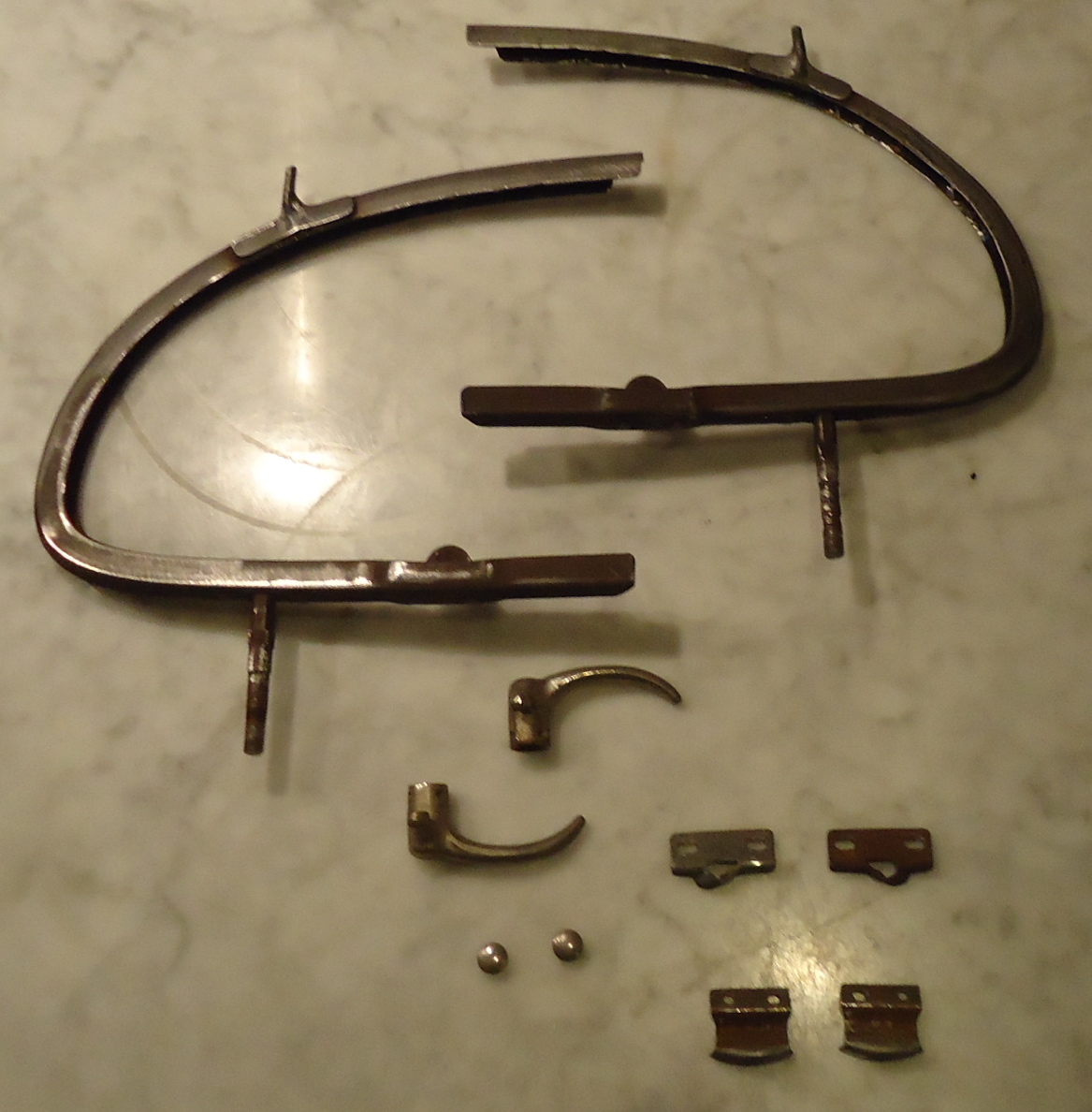

    Got the drivers side vent welded, including the new pivot points, and test fitted both in order to square it up to the door and then proceeded to cut them to size. Another job done. These are nearly ready to get chromed, just requiring a little clean up. More tomorrow.

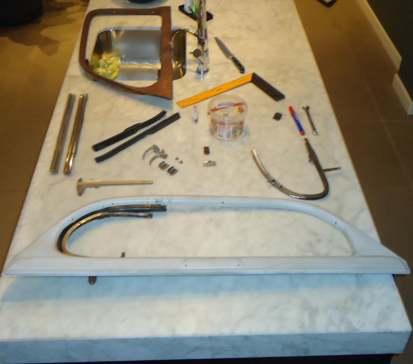

    farmer12
    The plan is to bring some parts to the chroming guy tomorrow, including the rear bumper, but soon I realized I hadn't cut the rubber stripping to size yet. Doh! Instead of trying to figure it all out when everything is chromed and painted, I thought I may as well do it now. So I re-installed all the necessary parts, then cut the rubber to size. Getting quite good at this by now.....
    Another bonus is that the wife and kids are on a short vacation, so I was able to use the kitchen to accomplish the task:D.
