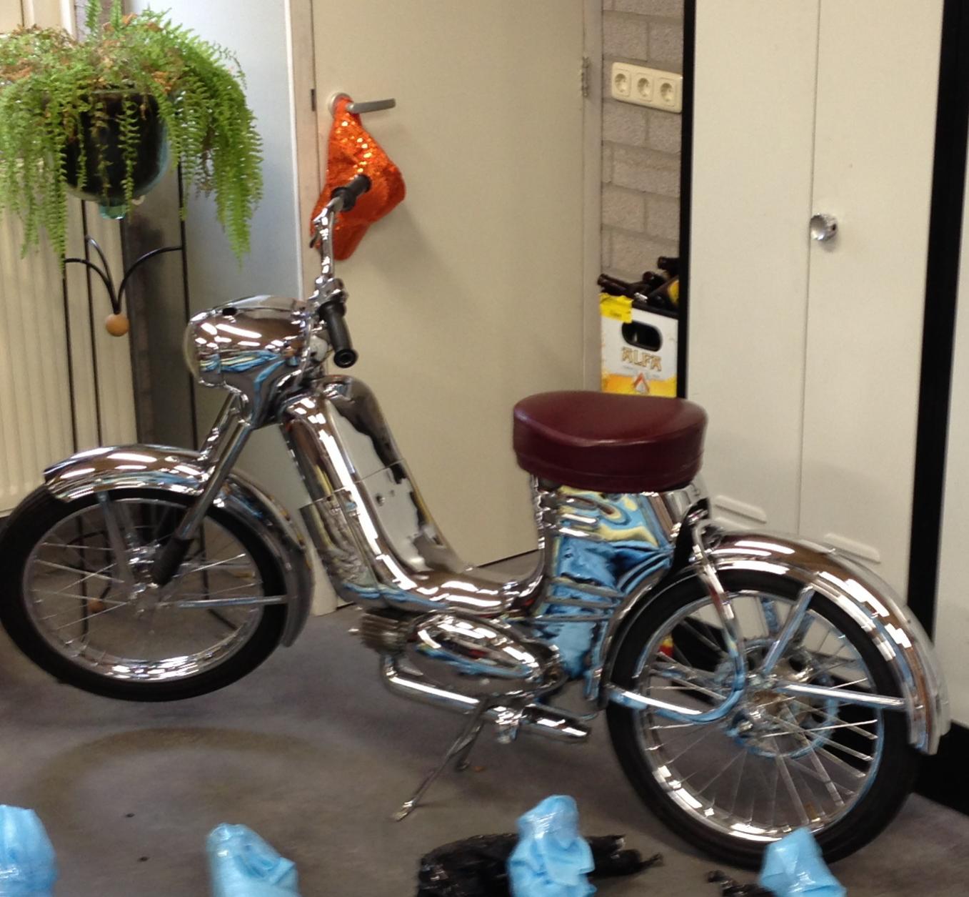

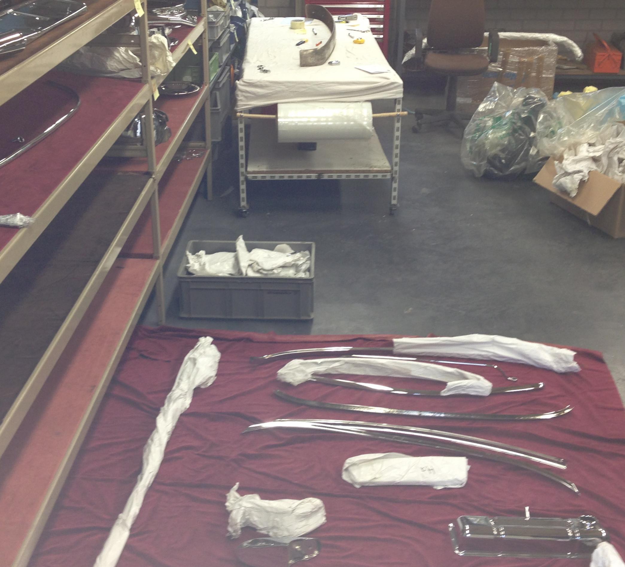

    Just dropped off my parts at the chroming guy. It's going to take about 8 weeks before I get it all back, but he ***ured me it will be perfect! You can see my bumper on the table in the background. He also had this cool moped which he'd fully chromed.

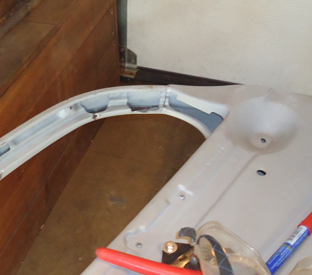

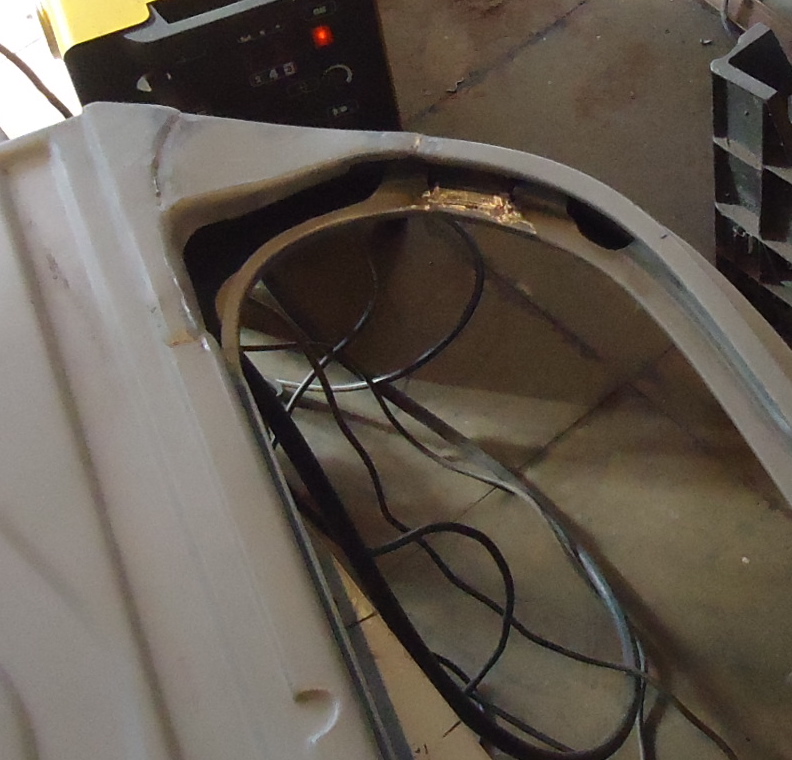

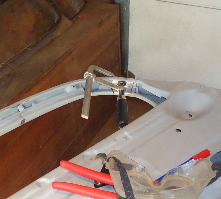

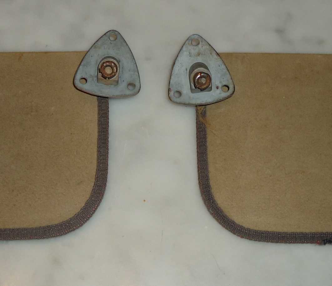

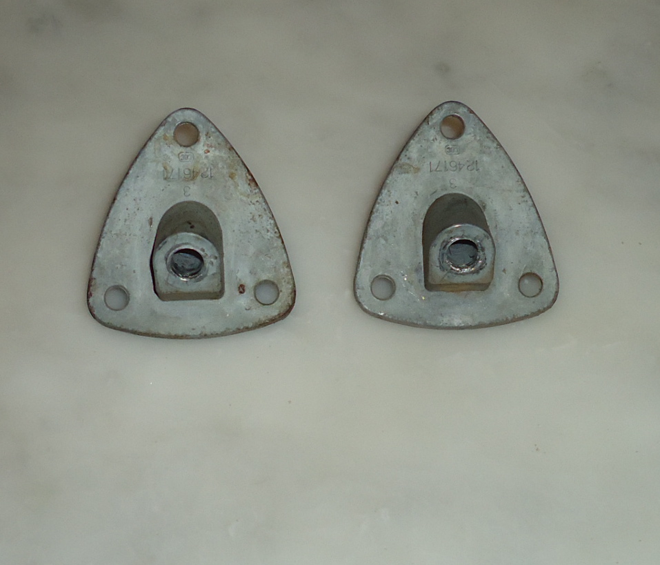

    I realized that I'd forgotten to send the mounting brackets to the chroming guy. Doh! Quickly took them apart and mailed them off to him.

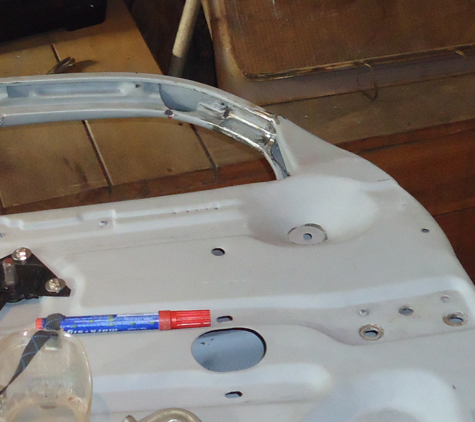

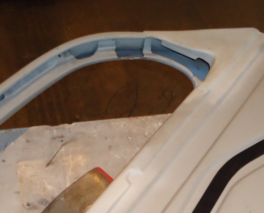

    Then fabricated an inner piece for the door gutter. The area would be visible, even with the weather stripping in place, so it was time to weld. Hope to finally finish the p***enger door completely next monday.

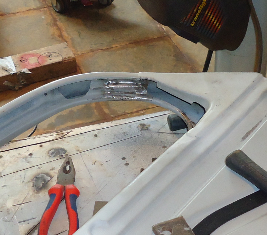

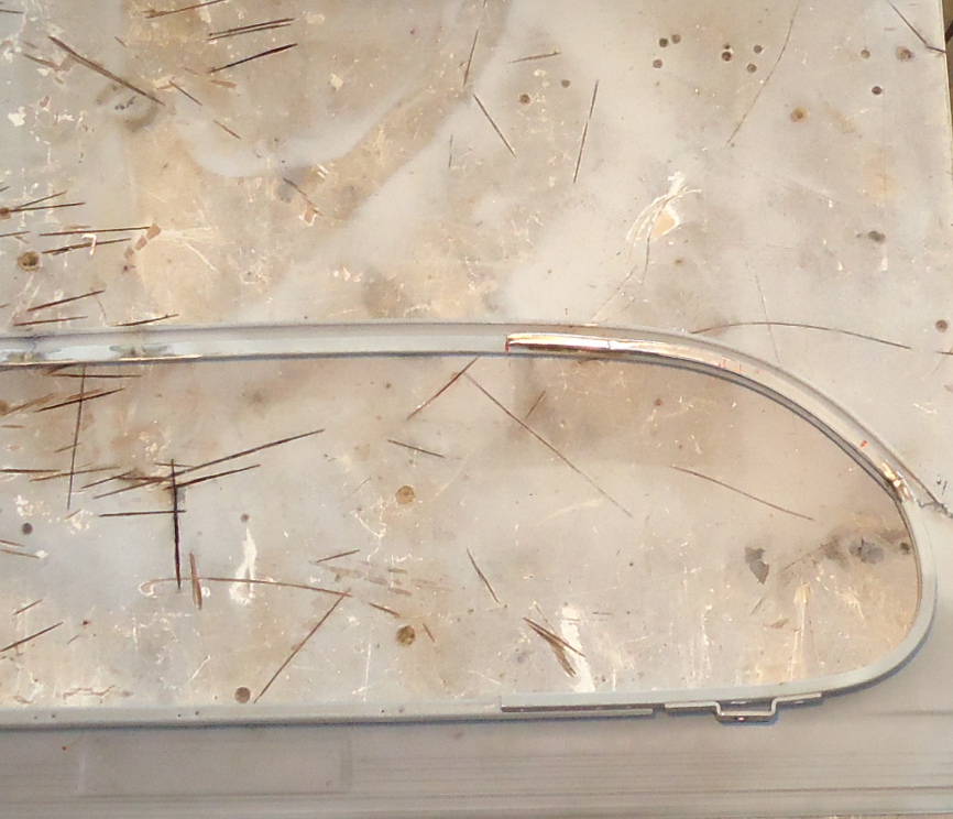

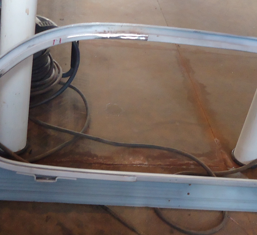

    Made good progress today! Started by cutting the small gutters off the old garnish moldings and welded them on the modified ones. I needed to extend them both by about 2 inches.
    Then moved on to the driver's side door and filled in two gaps with newly fabricated pieces. Getting closer!:D:D:D

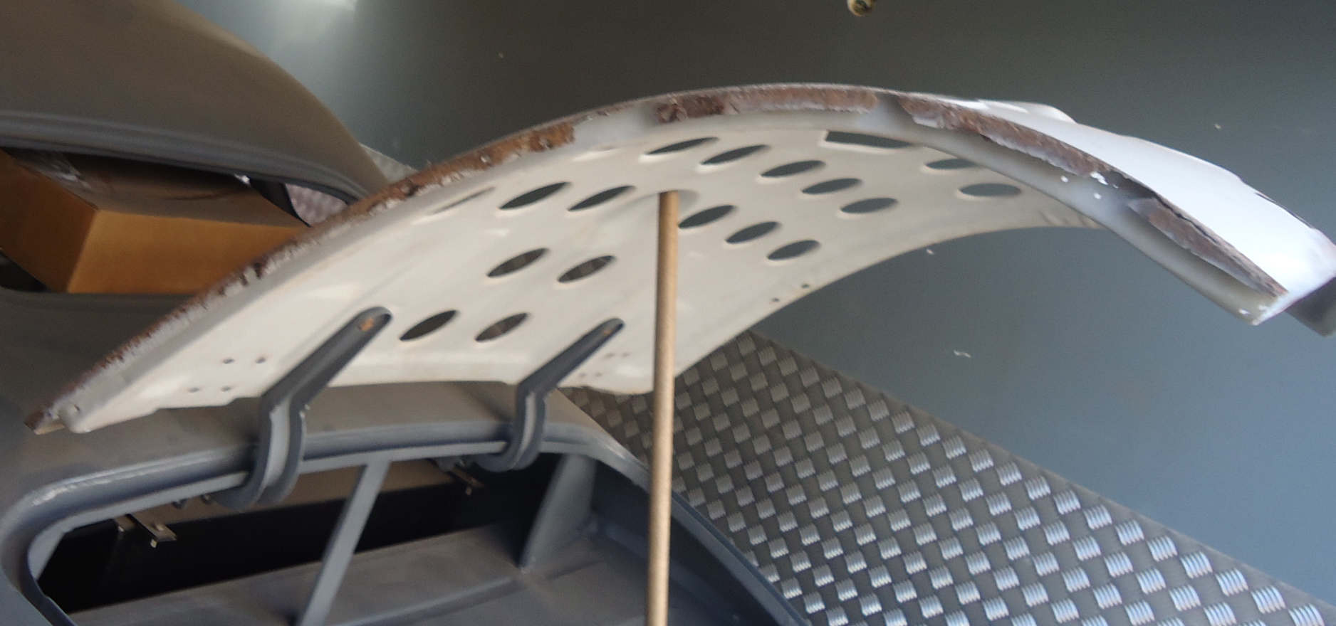

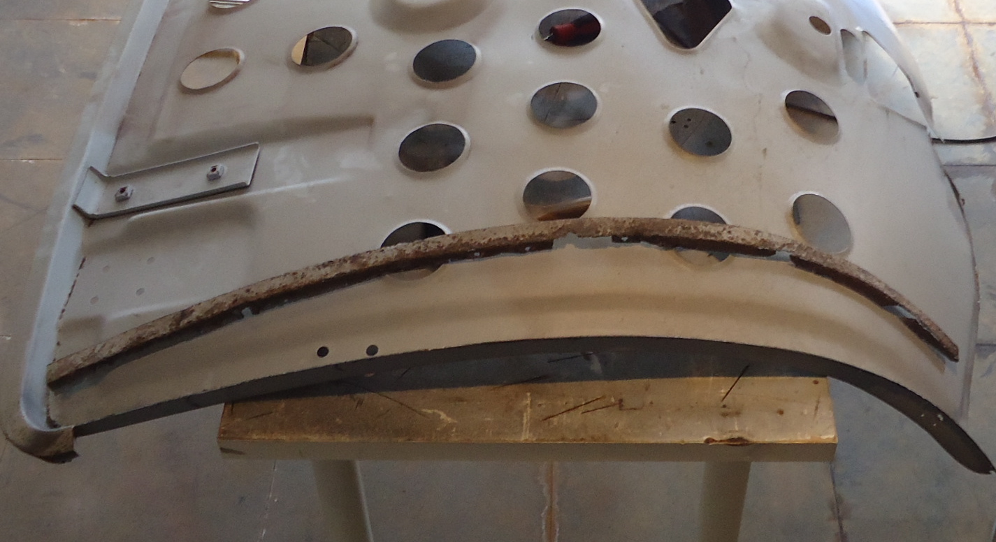

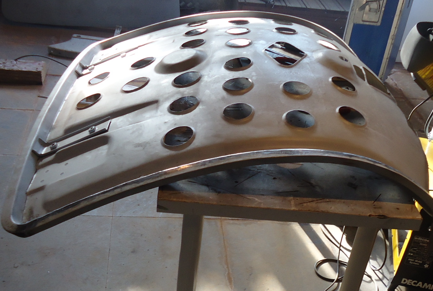

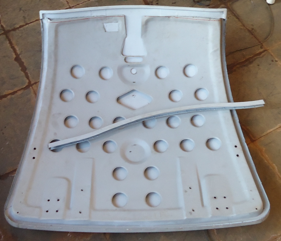

    It's been another very productive day today! Repaired the side lip of the inner trunk. It was so badly rotten, you could see through it. First was to cut the bad piece off and welded on my fabricated piece. Cleaned it up and gave it a coat of primer. Better than new!
    Last pic show the inner deck lid in place. Laying on top is a newly fabricated piece which I'll need to weld in place. (notice red marker lines.)
