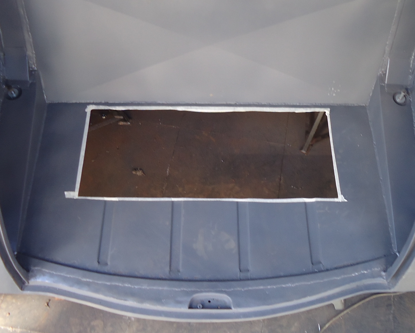

    farmer12

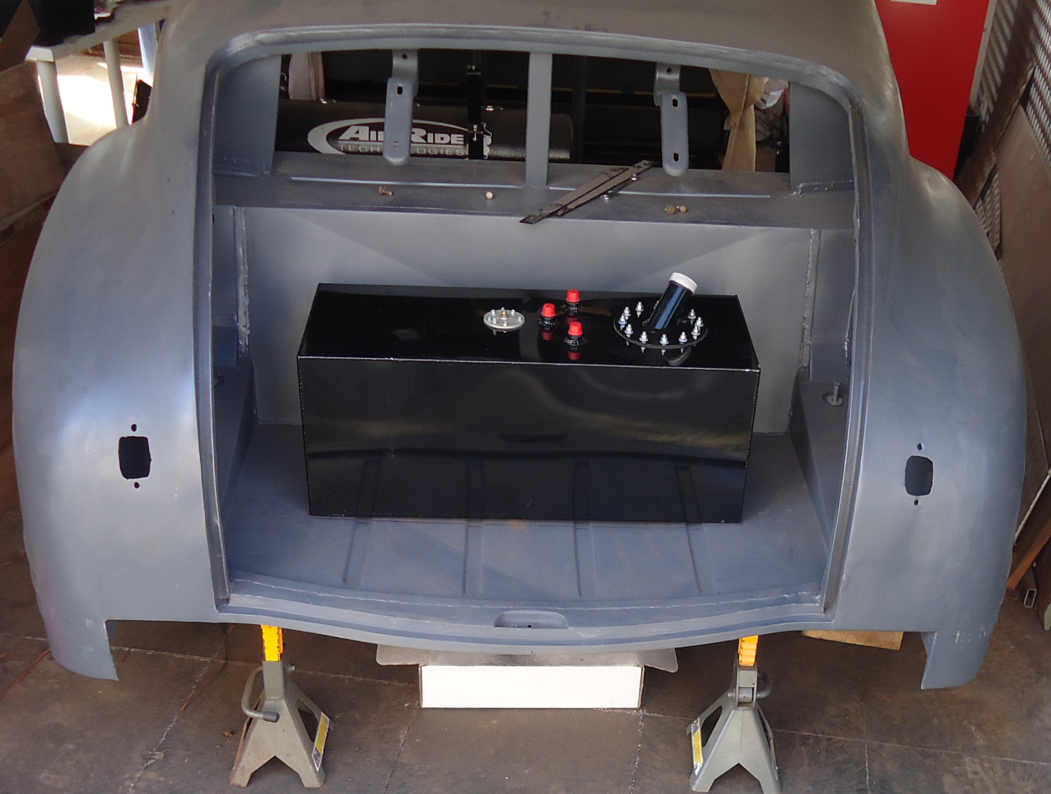

    Thanks Steve. But before I mounted the inner trunk lid, I decided to change the position of the fuel cell. I had made some brackets last year, so the tank could be placed underneath the parcel/hat shelf. But after thinking about the safety aspect more and more, I've decided to place it in the trunk. (and cutting up my trunk floor!!!) Placed some blocks of wood underneath and it's sitting at about the right height now.
    Sorry about the excited rambling Steve, I'll post a few pics of the mounted inner deck lid soon.;)

    Let me clarify the reason behind the decision. (I did think about it.:D)
    You're right, the trunk space has been reduced. On the other hand, the space underneath the hat/parcel shelf has been drastically increased. Obviously the cell is no longer there and I'm now able to remove the frame I built for it. Now considering the cell is halfway lowered in the trunk floor, the overall available space has now effectively been increased. Not to mention that the weight distribution has now improved and last but not least, the safety aspect of not having a fuel cell in the p***enger compartment.
    Sometimes sacrifices need to be made to improve others aspects.

  11. farmer12
    Joined: Aug 28, 2006
    Posts: 7,724
    farmer12
    Trust me, I've been looking on the internet all winter. From where the sheet metal covering the c-notch to the rear cross beam on the ch***is is only 13 inches. This the flat surface I can work with. The only option was a 9 gallon fuel cell that would fit underneath that. Mmmmm.......9 gallons and a 500hp 392 Hemi. Doesn't really work. On the dragstrip yes, cruising, no. I don't want to be searching for a gas station continuously. The cell I'm using now is 19 gallon, which should be sufficient. The down side obviously is that protrudes into the trunk. (about 6 inches). I can live with that. Sacrifices need to made at times.

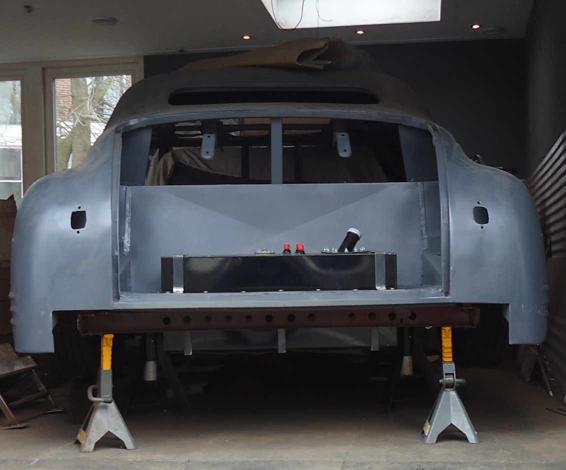

  18. farmer12
    Posts: 7,724
    farmer12
    I'm also glad I've decided to change the position of the fuel cell. Safety is my priority.

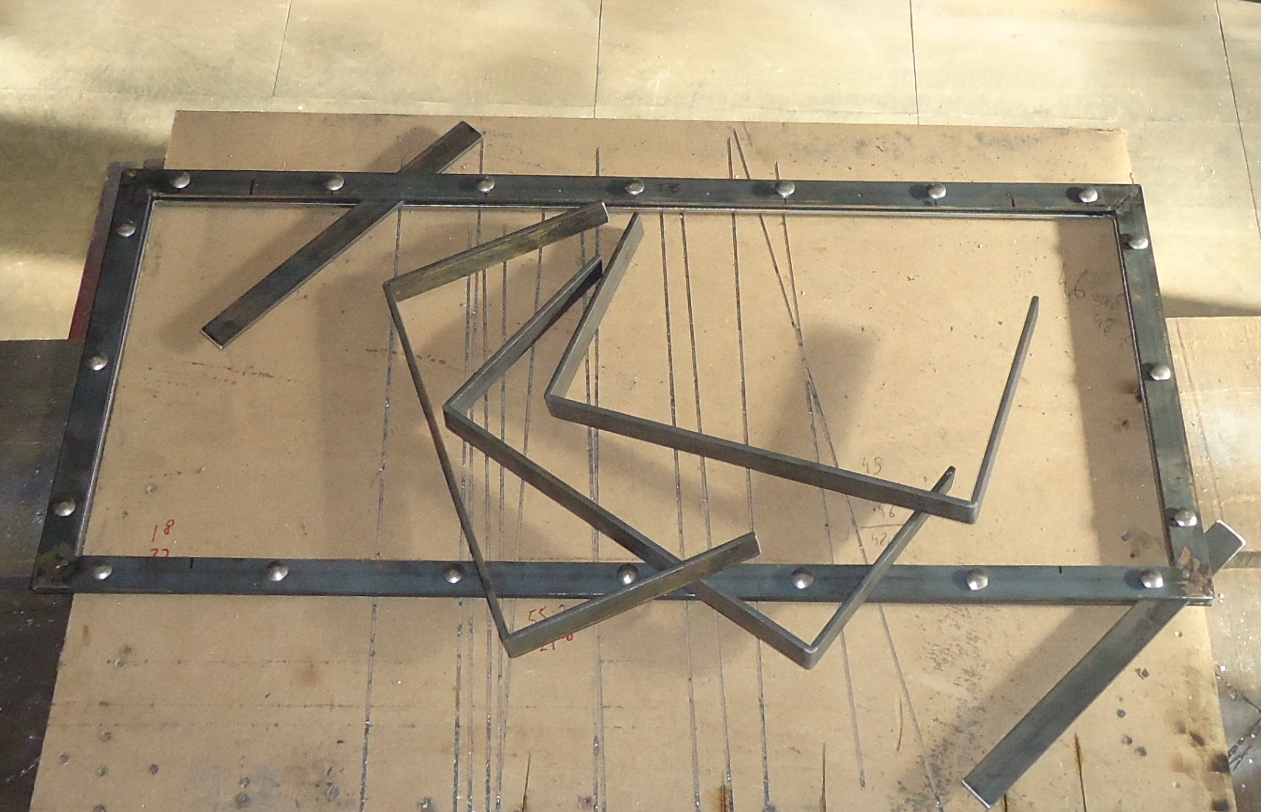

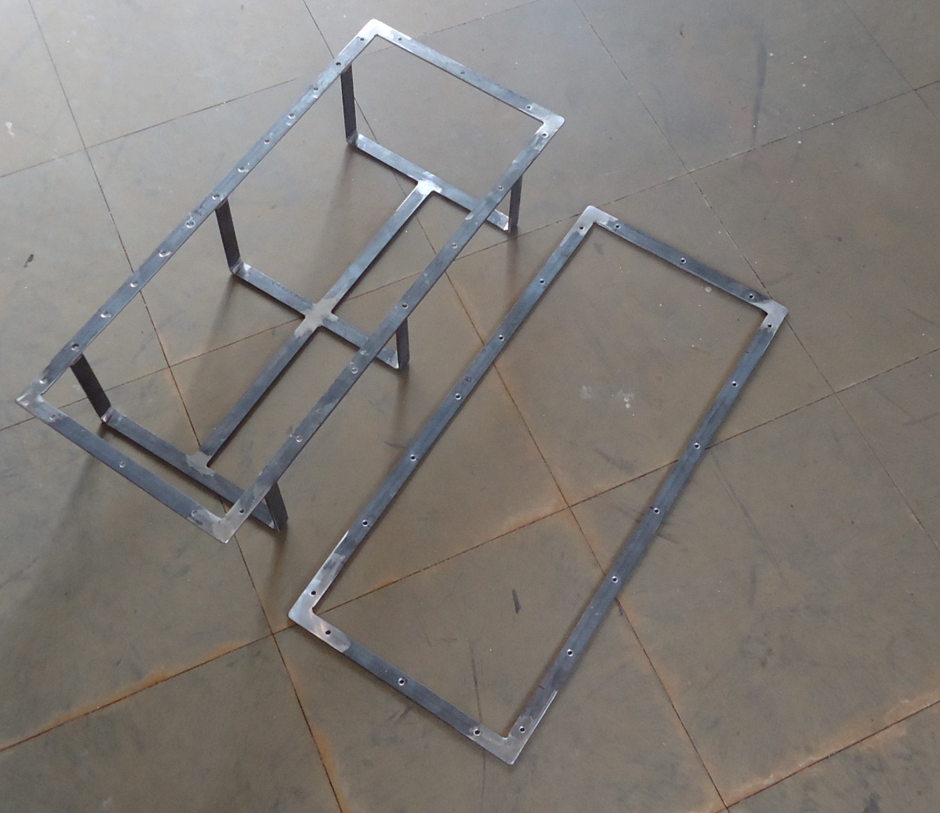

    Started this morning with getting some steel from my buddy Jaap. Six hours later I ended up with this: a whole new support for the fuel cell. I'm going to weld it up tomorrow and test fit it all.(ran out of welding gas....) Happy with the progress today.:D

  22. farmer12
    Posts: 7,724
    farmer12

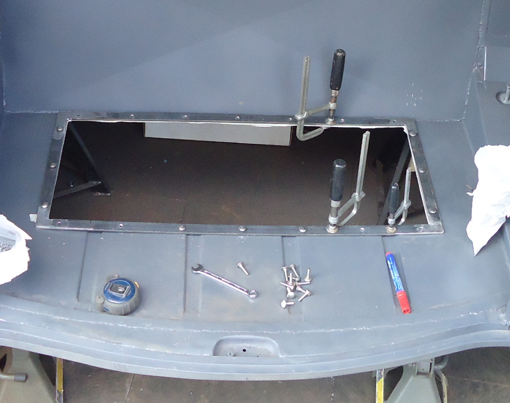

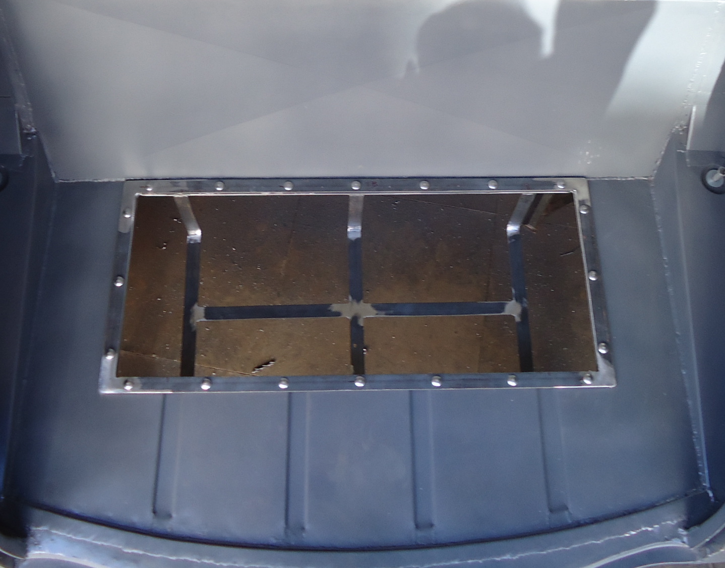

    Got the bracket welded up for the fuel cell and clamped the top part in position. Then drilled holes through the trunk area and bolted it together. Then removed the excess sheet metal inside and took it all apart again. Then connected to lower bracket to the top bracket and bolted it in place. After a few test fits of the fuel cell and a little grinding, I was able to drop the cell in its position. Used the old fuel cell brackets, shortened them and positioned them over the fuel cell. Still need to drill a few holes here and bolt that together. The cell now protrudes through the bottom by 7 inches, at the same level as the bottom of the rear bumper.
    It has surprised me once again the amount of time you need to fabricate something like this. Anyway, as I always say, another job done!:D:D:D

  27. OahuEli
    Joined: Dec 27, 2008
    Posts: 5,243
    OahuEli
    from Hawaii
    Nice work Eric! And you're right, its amazing how much time can be eaten up by doing something that didn't seem would need much work at first. Are you going to use some sort of sealer between the new fuel cell frame and the trunk to keep the road dirt out?
  28. farmer12
    Posts: 7,724
    farmer12
    Thanks OahuEli. The fit of the cell is fairly tight as it is, so I'm planning on just covering the side of the frame with a thin layer of rubber. The tank will then be snug in its position. Depending on the gaps, I'll use some sealant from underneath to keep the dust out. Thanks for your support.

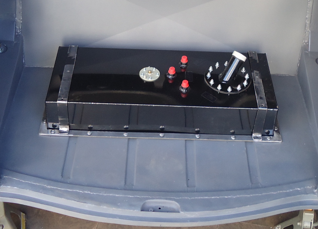

    Just finished re-working the 2 top brackets for the fuel cell. NOW it's done.:D
