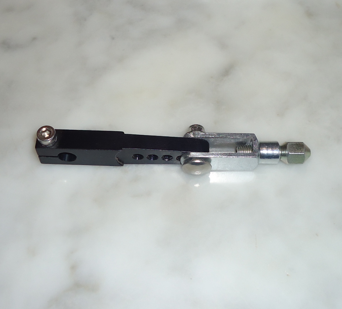

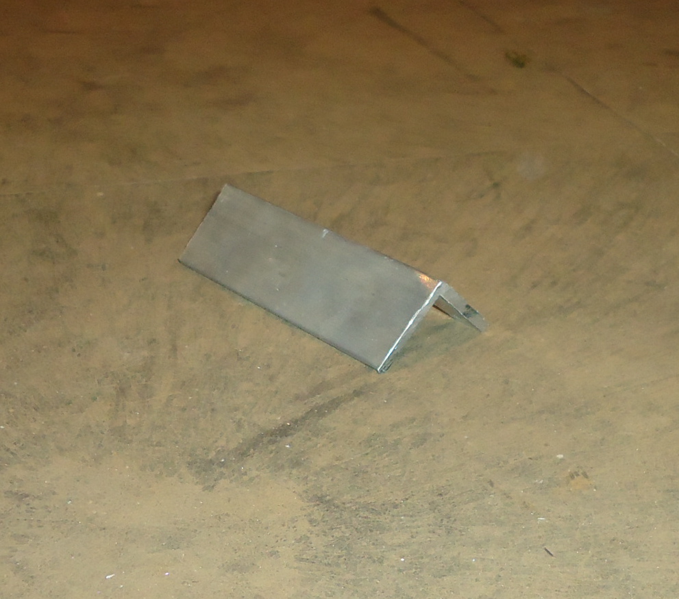

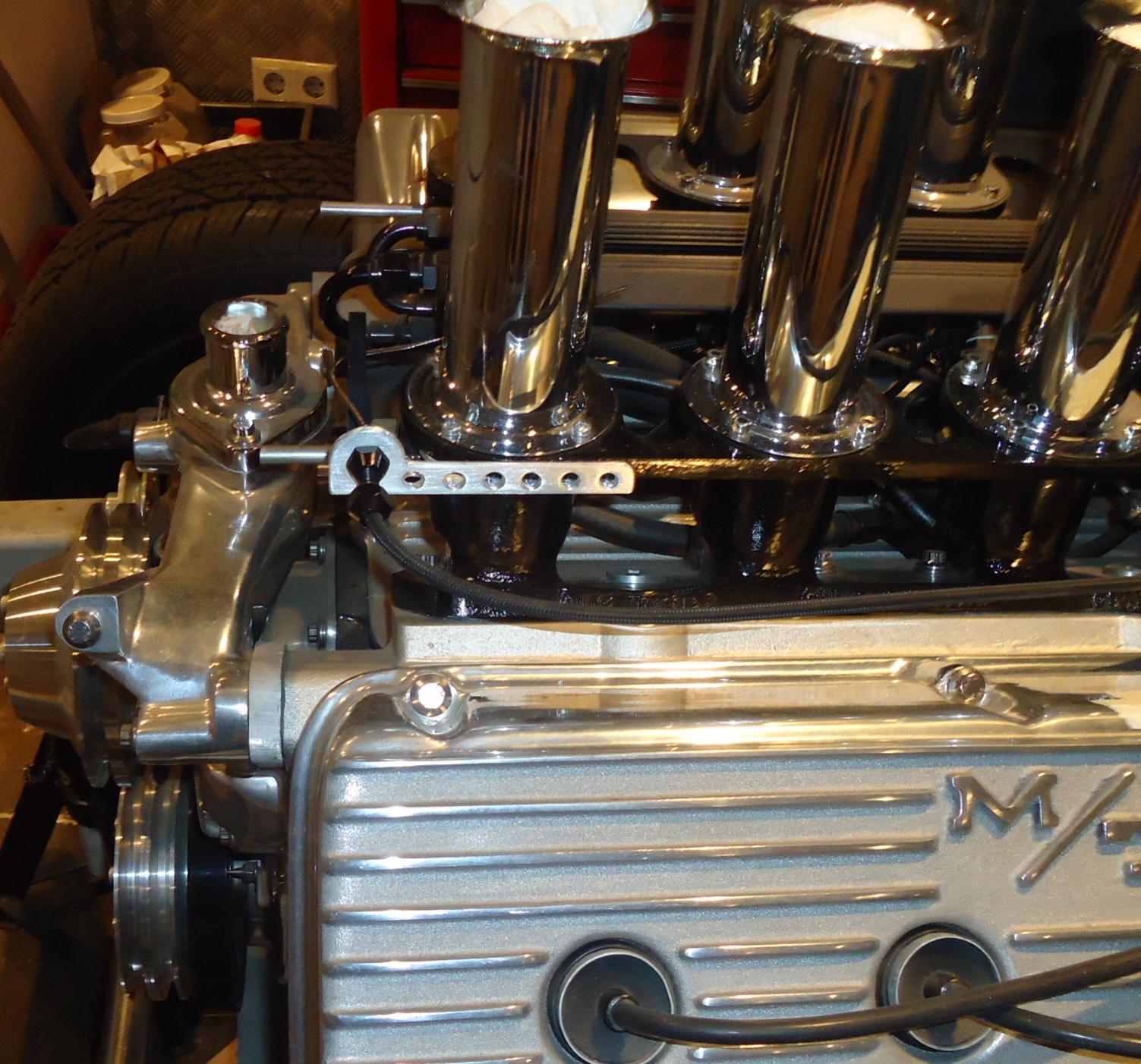

    It was time to work out the throttle linkage today. After mounting the gas pedal in position and drilling a hole through the firewall, I needed somewhere to connect it to. After several trial and error set-ups, I decided to move the drive arm and throttle stop from the p***enger of the Hemi to the driver's side. Next I needed a bracket.........I don't have one and didn't feel like modifying some cheap ****py catalog one, so I decided to make my own.
    Went to the hardware store, bought some 90 degree aluminium and started the long process of thinking, cutting, drilling and fitting. After a few hours, this is the final result. I'm probably going to paint it black. Still need a spring and a wire connector for the drive arm and then I'm done with this job.:D

    Paint it black?:eek: I'm betting that bracket would look real purty all shined up like your valve covers.

    Better then store bought.. Fits like it should and looks good as well.. Perfect fit and finish..

    Black, yes. I'm trying to keep it all as "clean" as possible, no bracket distraction in this case.
    Buying something in a store is something everyone can do. Also, that what is available is either "general" or for a carb setup. I try to make it in such a way that people need to look twice.:D

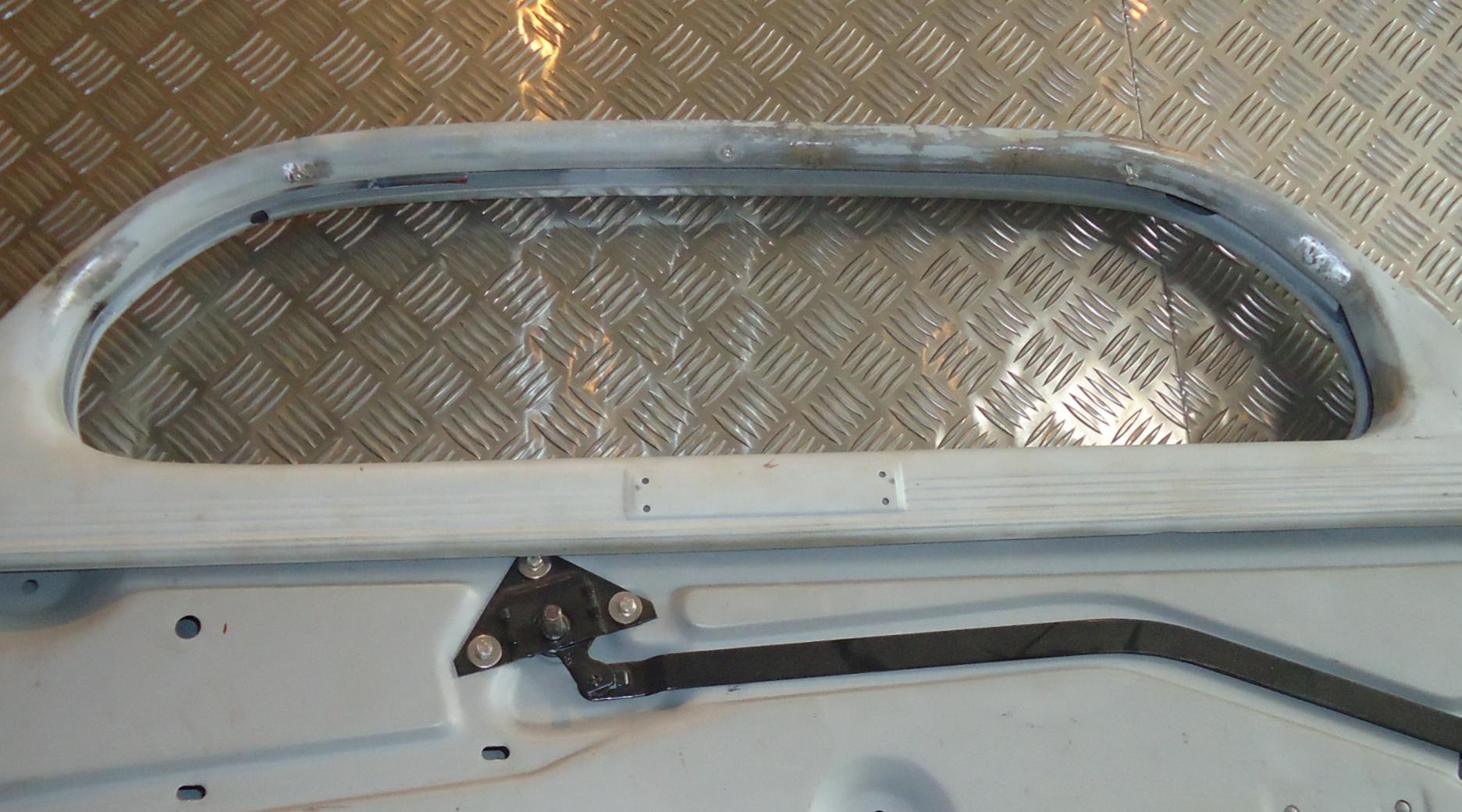

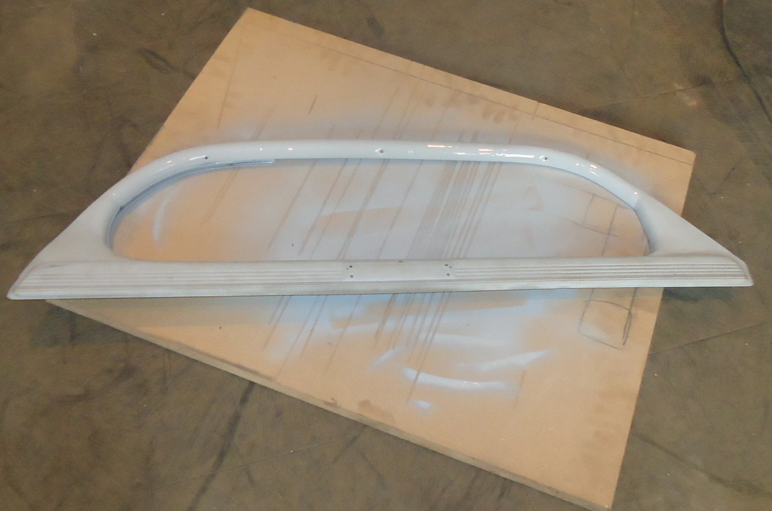

    Had a spare few hours this afternoon, so I finished off the p***enger side garnish moulding. Welded up the old holes, made 3 new ones, test fitted it, cleaned it up and gave it some primer. Perhaps it's not the most exciting thing I've done during this build, but at least the moulding is finished now.

  14. you're right, Eric, not worth the newspaper headline, but to fight them into fit after paint is on 'em is a lot harder! ;) great job! good to see how you take care of details!! i'm very curious to see that car ..

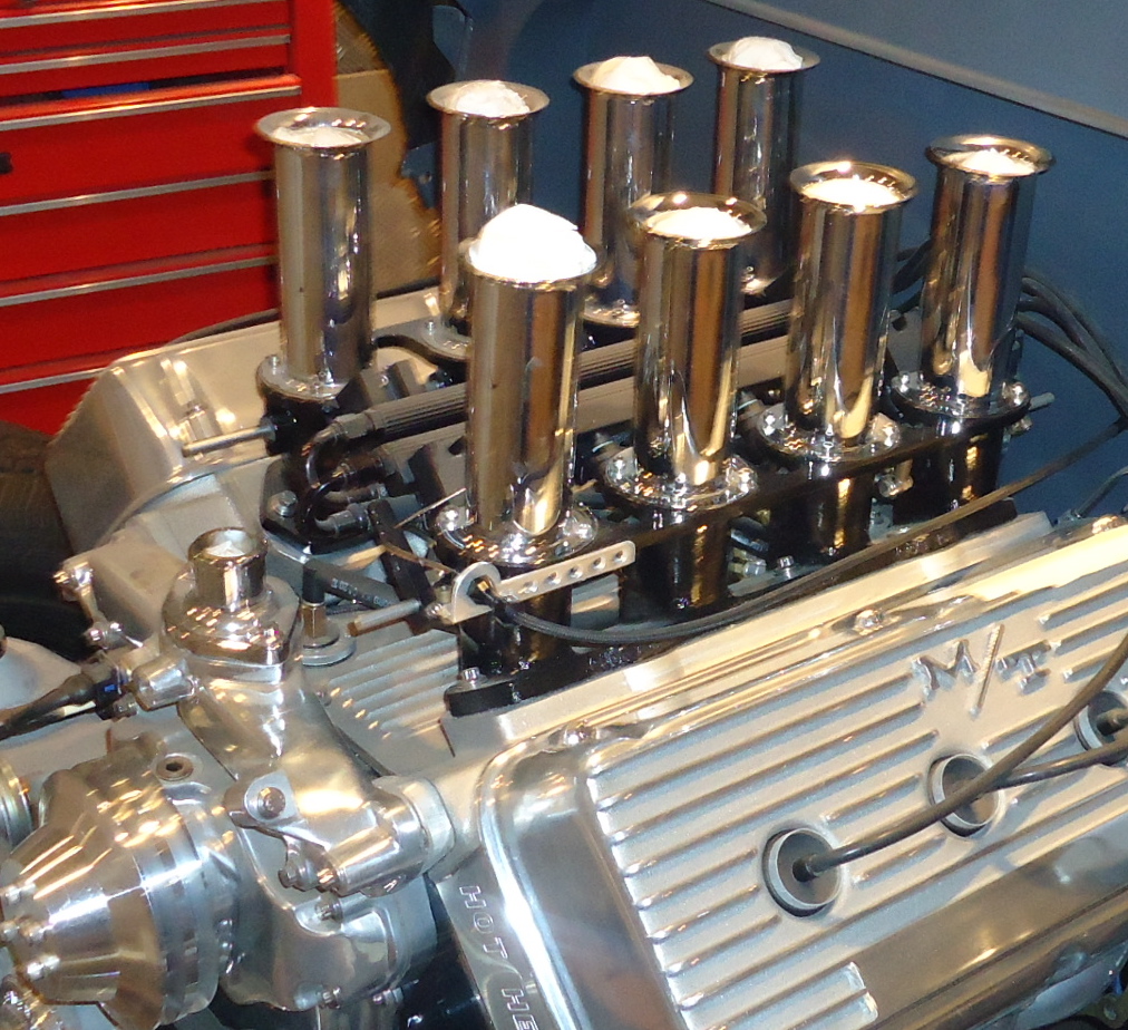

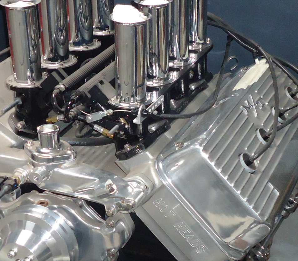

    Nice job on the throttle linkage. But you should consider using an asymmetric linkage, giving small movements on the throttles in the beginning compared to the pedal. A tiny movement on 8 large throttles is equivalent to a whole carburetor :D. I build an asymmetric linkage on my Hilborn injector and it makes the car a whole lot easier to drive.
    Are

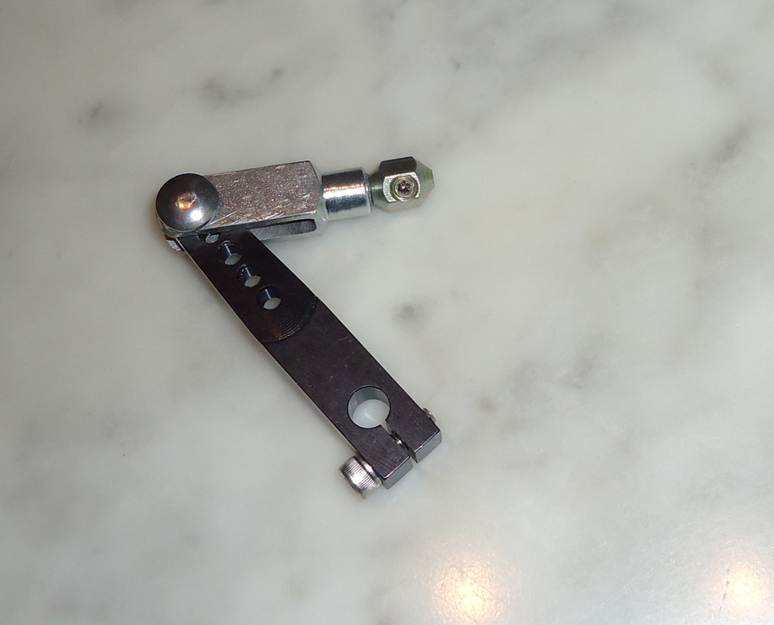

    Thank you Are for thinking along. I did consider that, but I think that by using the top hole in the throttle arm, I'll have enough throttle response without being too twitchy. The full travel of my gas pedal (4 inches), coincides with the 2.5 inches travel I have at the throttle arm. Once I've driven it, I'll let you know the outcome!
    Talking about throttle arms......I ran all over town in order to find a few small parts. I mated the US thread wire holder to a EU u-bracket. This was too narrow for the throttle arm, so removed a little material to make it fit. My tolerance is less than 0.5 mm, giving it free movement without being sloppy. This time I won't say how long it took me to accomplish this seemingly very easy task.:D:D:D

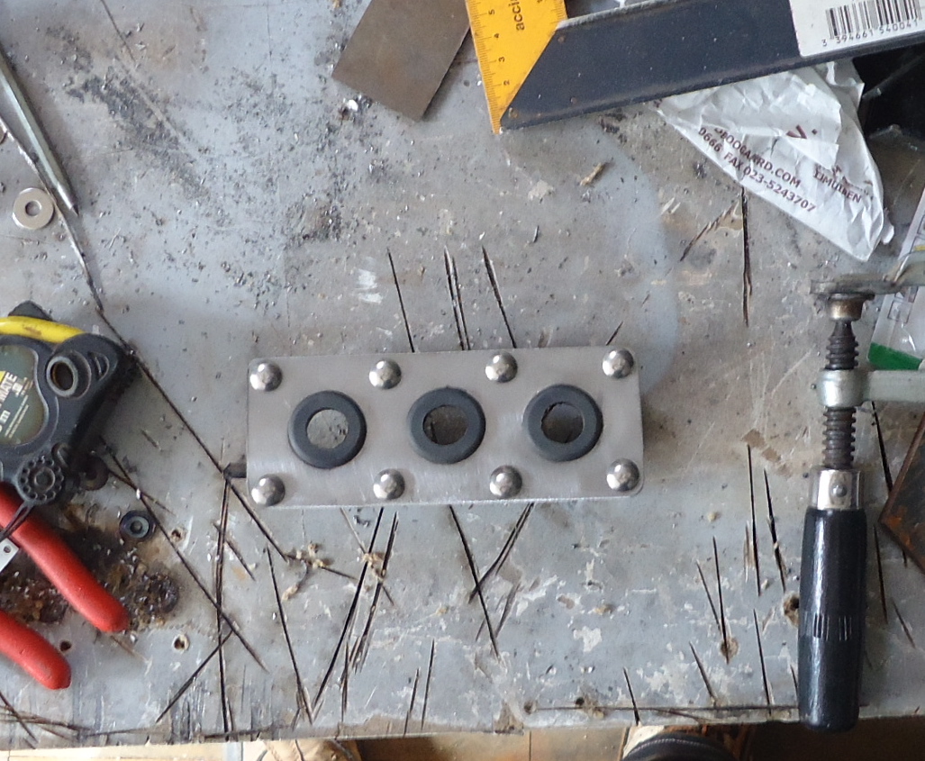

    Thanks 4rod. A lot of little things indeed..........but due to a flight cancellation, I had another spare few hours today. Yes! Instead of just using rubber grommets for my fuel lines and ventilation in the sheet metal, I decided to fabricate something a little better. At least this is not the easy way out. (and just rubber grommets in the carpet would have looked stupid anyway.:D)

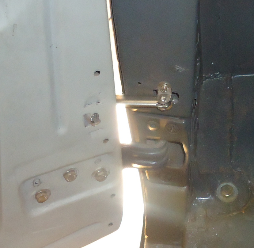

    Removed the old "door stoppers" and installed new hollow ones. These will enable me to run the wires of the electric windows and keep them out of sight. I'm going to weld the hole behind it and drill a small hole for the wire. Even though it was another small job, at least it's done.:D
  30. OahuEli
    Joined: Dec 27, 2008
    Posts: 5,243
    OahuEli
    from Hawaii
    And there you go again! :D Consider that idea stolen! lol
