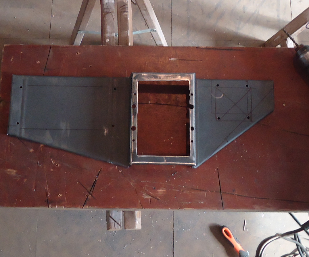

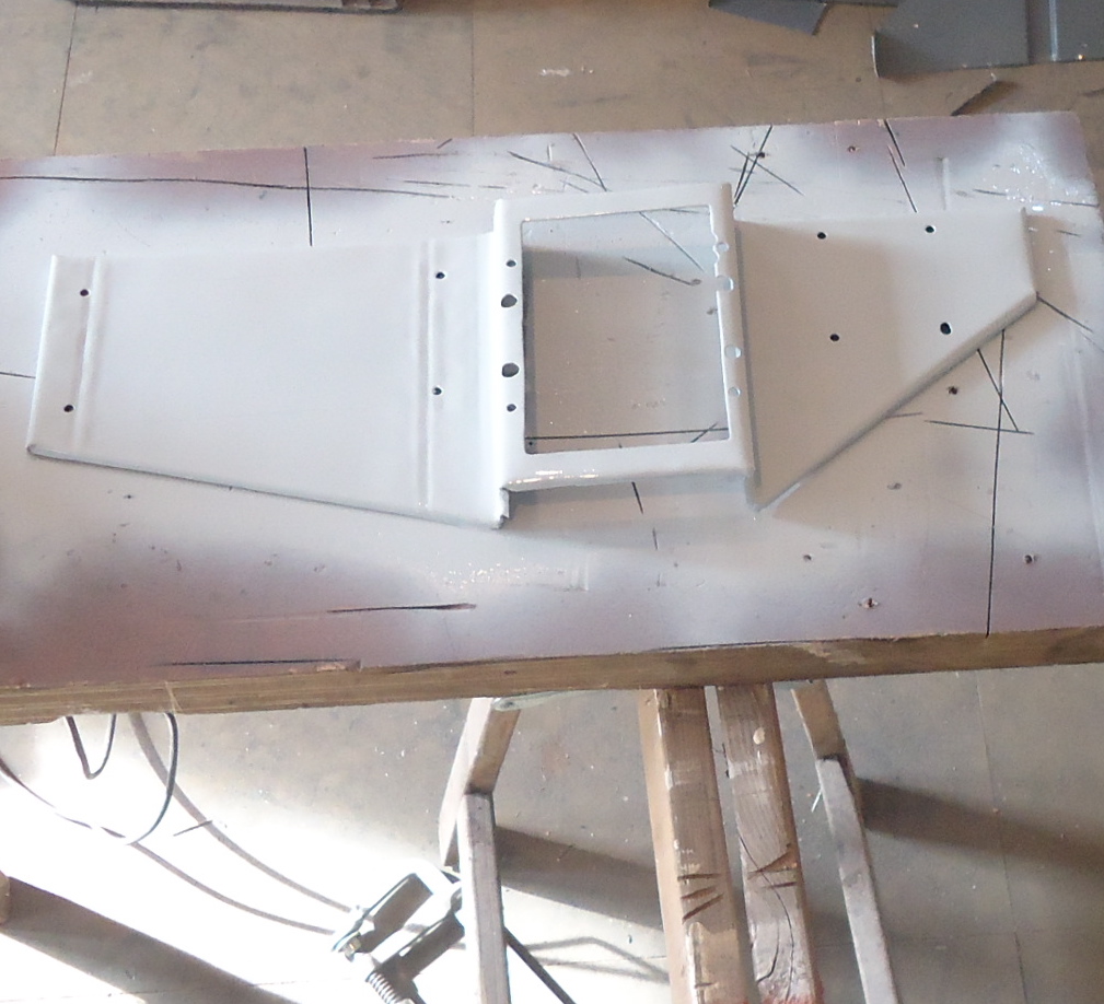

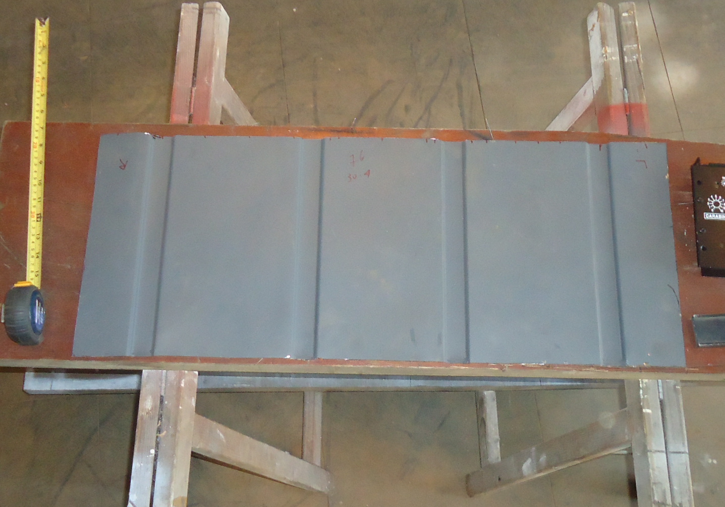

    I needed to create something to keep my engine management electronics together. I'm going to use the space under the dash where the glove box used to be. It's going to fit in there nicely while being out of sight.
    Considering I'm nearing the end of fabrication on this car and didn't have any large pieces of metal laying around, I decided to use the piece I'd cut out of the trunk for the fuel cell. That's recycling for you!
    After some thinking, measuring and hammering, here's the final result. :D

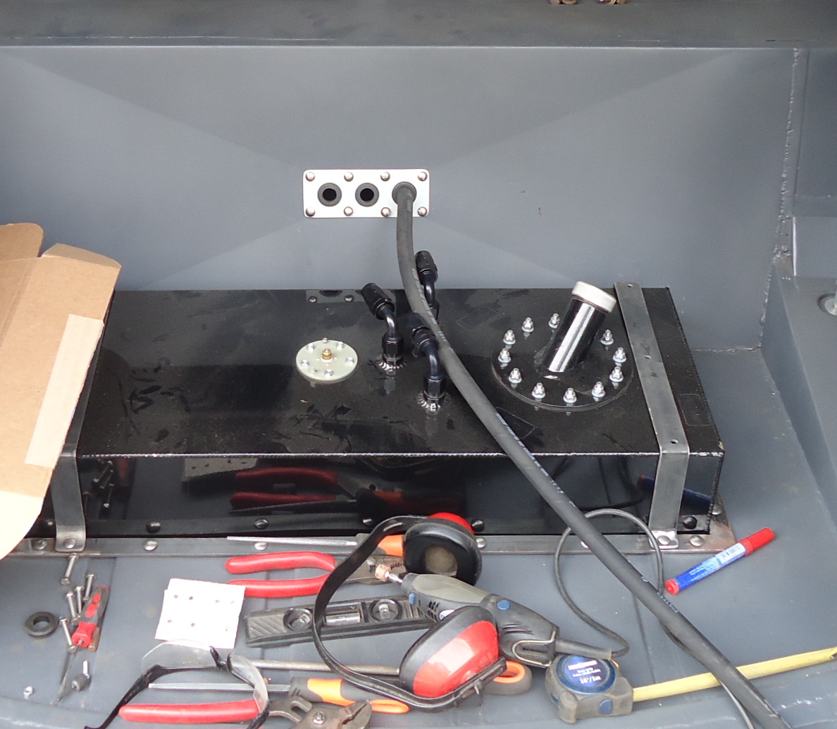

    It certainly has been quiet regarding the build the last two weeks. I've been out working in the garden every spare minute due to the "nicer" weather and the wife thought it was time for me to leave the garage and get some sand under my nails. Good news is that I'm back to work on the car again.:D

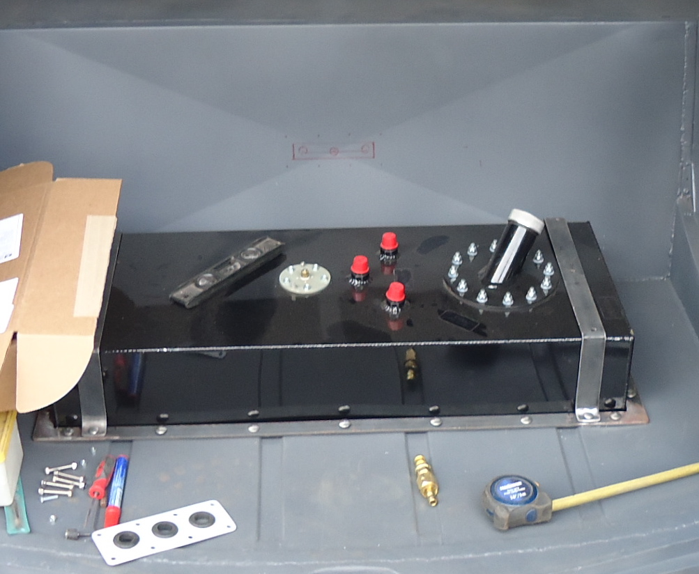

    I've just received my parts from Summit, including all the hardware for my fuel lines. So it was time fit my fabricated part in the trunk. After a bit of measuring, the most logical spot was in the middle. The rear end is jacked up and the lines clear the pumpkin easily. More stuff tomorrow.:D:D:D

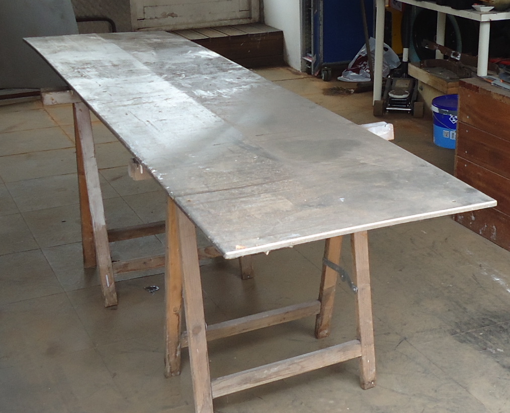

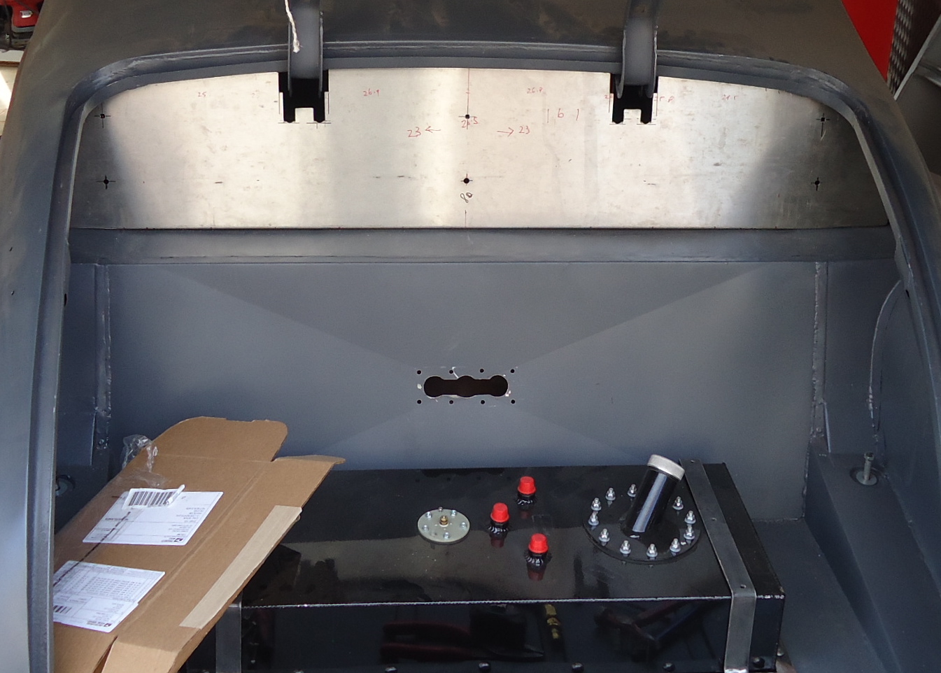

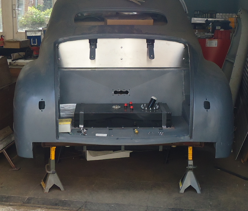

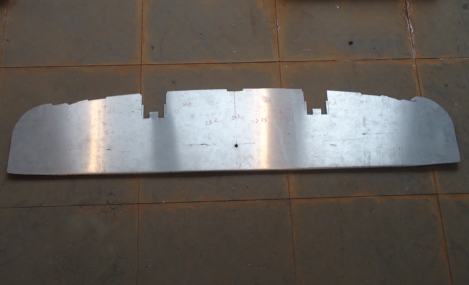

    Next on the list was to make a divider between the trunk and cabin. I still had a (very) large piece of stainless steel laying around and decided to use that. It's 3mm thick, so quite heavy, but then again, a bit of extra weight on the rear wheels won't hurt. And in case of a rear collision, it will give added protection should the fuel cell explode.
    The measuring, cutting and test fitting took up most of the day, believe or not. After I got close to the final shape, I hand filed it until I got it to fit behind the trunk drip rail. Also, instead of just big cuts for the hinges, I made two slots on either side for the upside down u shaped hinge. Final drilling/mounting tomorrow. (even though I did expect to finish it today....)

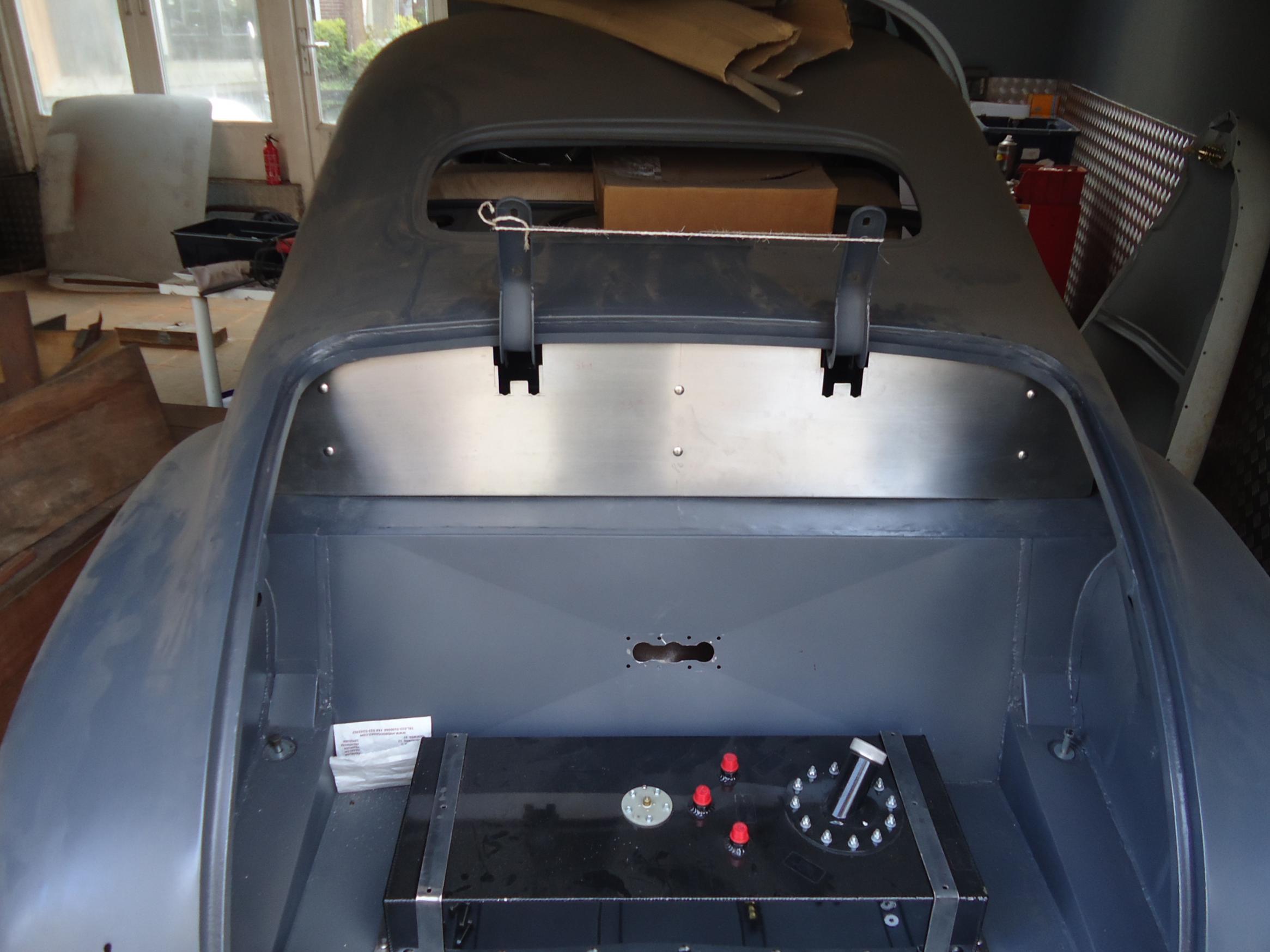

    After a lot of minor adjustments, I got the "trunk firewall" to fit. It came out looking good, even though it took me quite a bit of time. I think I'll paint it black instead of just another cowhide covering it. Happy with the outcome.:D:D:D
