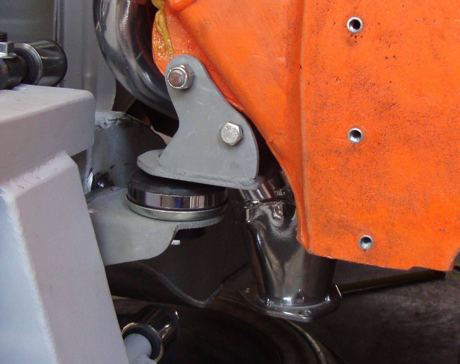

    Got up early to start on the engine mounts this morning. Slanted them back slightly due to the fact that the engine will be slanted at 2.5 degrees down. Had to modify the driver side mount to clear the suspension cross member. Like I suspected, I'll need another joint for the steering arm, as I won't be able to make one straight line past the headers to the steering column. Going to start on the gearbox mount now. More pics soon.

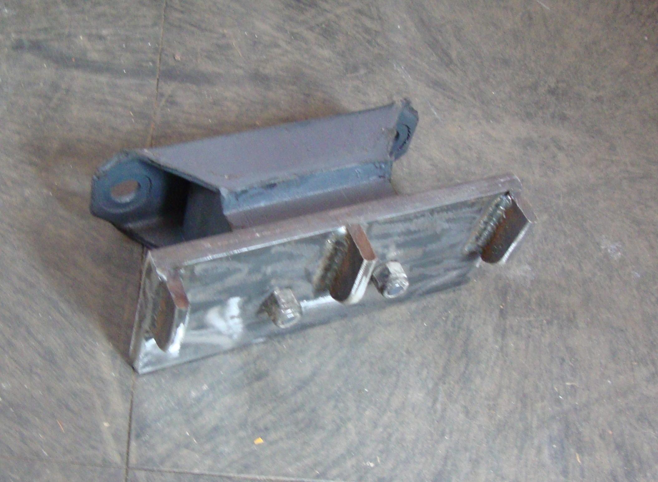

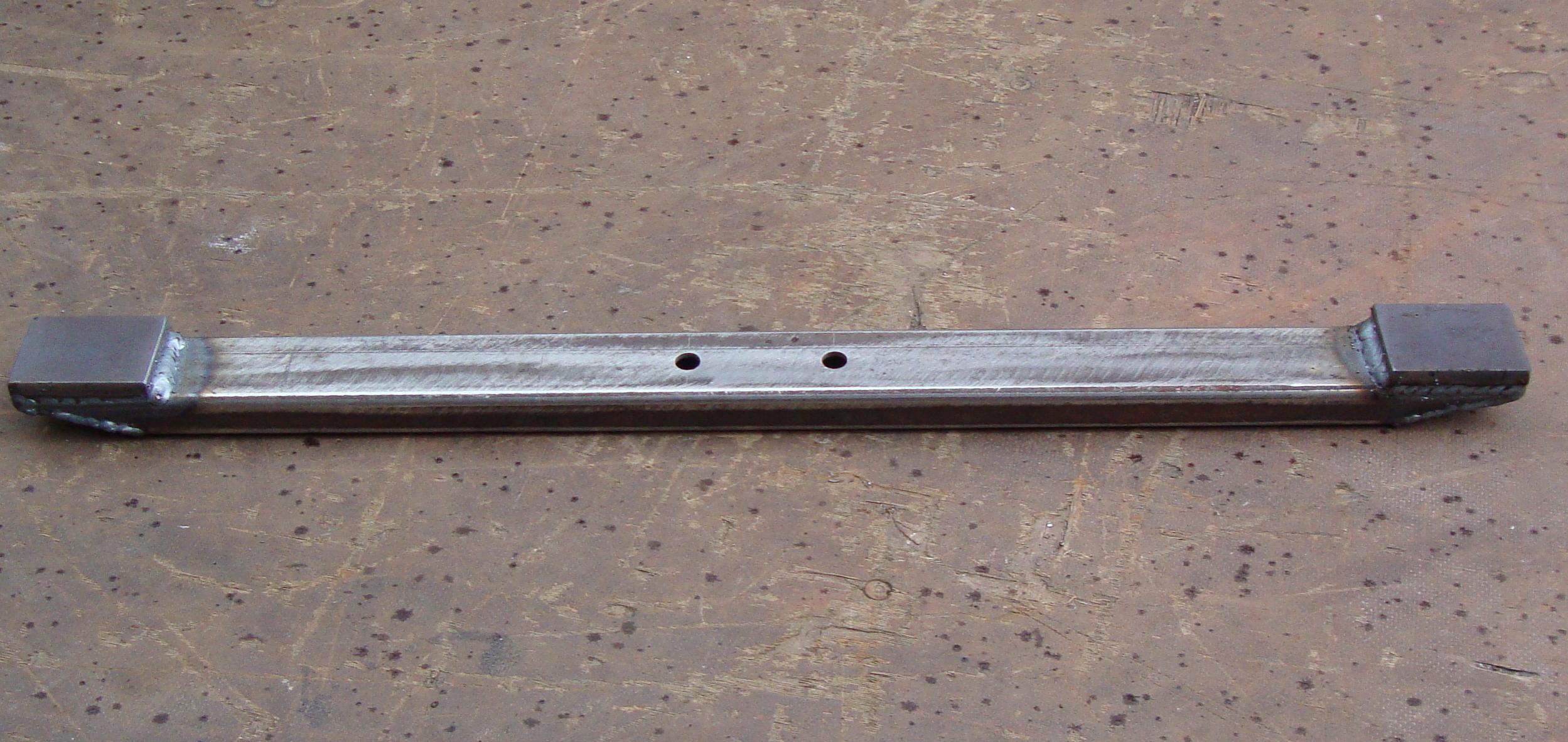

    Fabricated a mount to which the rubber gearbox mount bolts onto. Going to weld this to a ch***is cross member. I've decided to cut this cross member (will be done later when the body is off) , add some end plates with nuts and bolts, so I can remove the gearbox without having to pull the engine, if needed. Happy with the progress today.

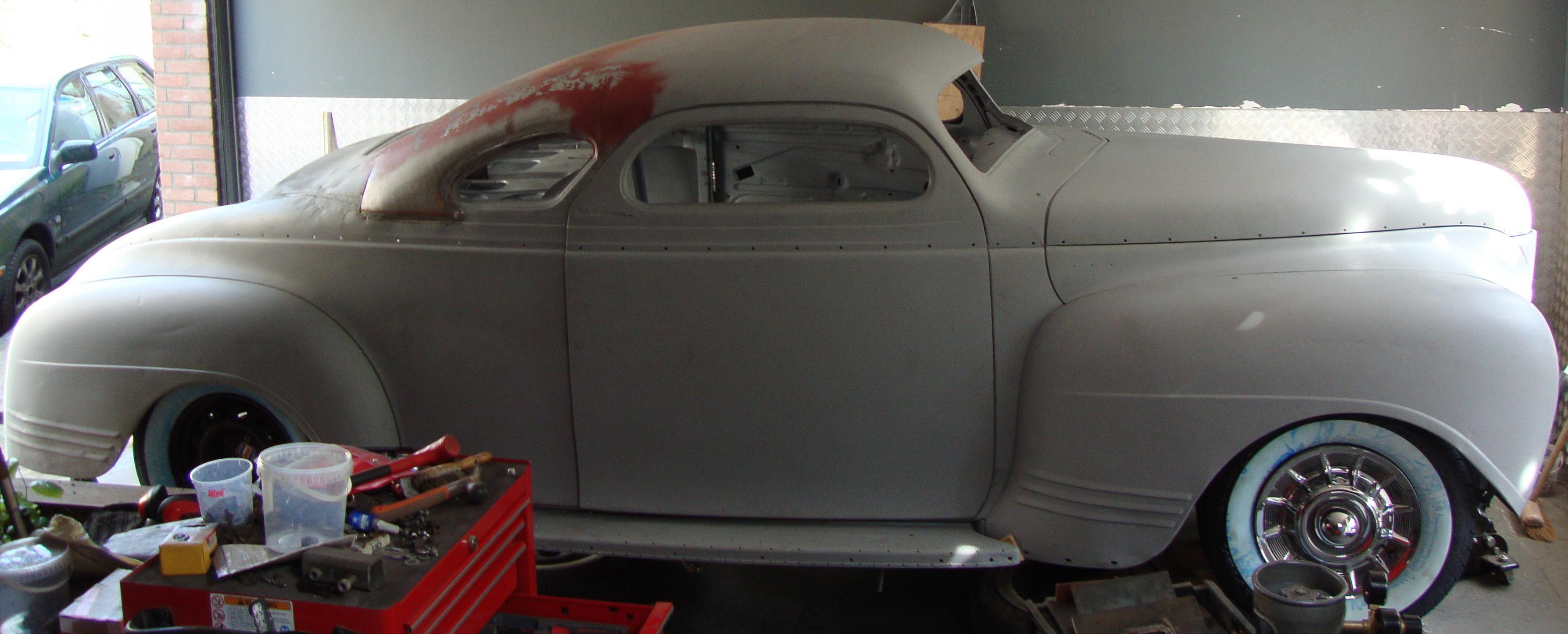

    Just mounted the original radiator support. A new steel bar will be welded underneath the frame to make it all rigid and have somewhere to mount the support. Will do this tomorrow. Mounted all front fenders and hood to ensure the postion of the radiator support is correct. Here's a look at the car for the first time all bolted up in primer. Definitely motivating.

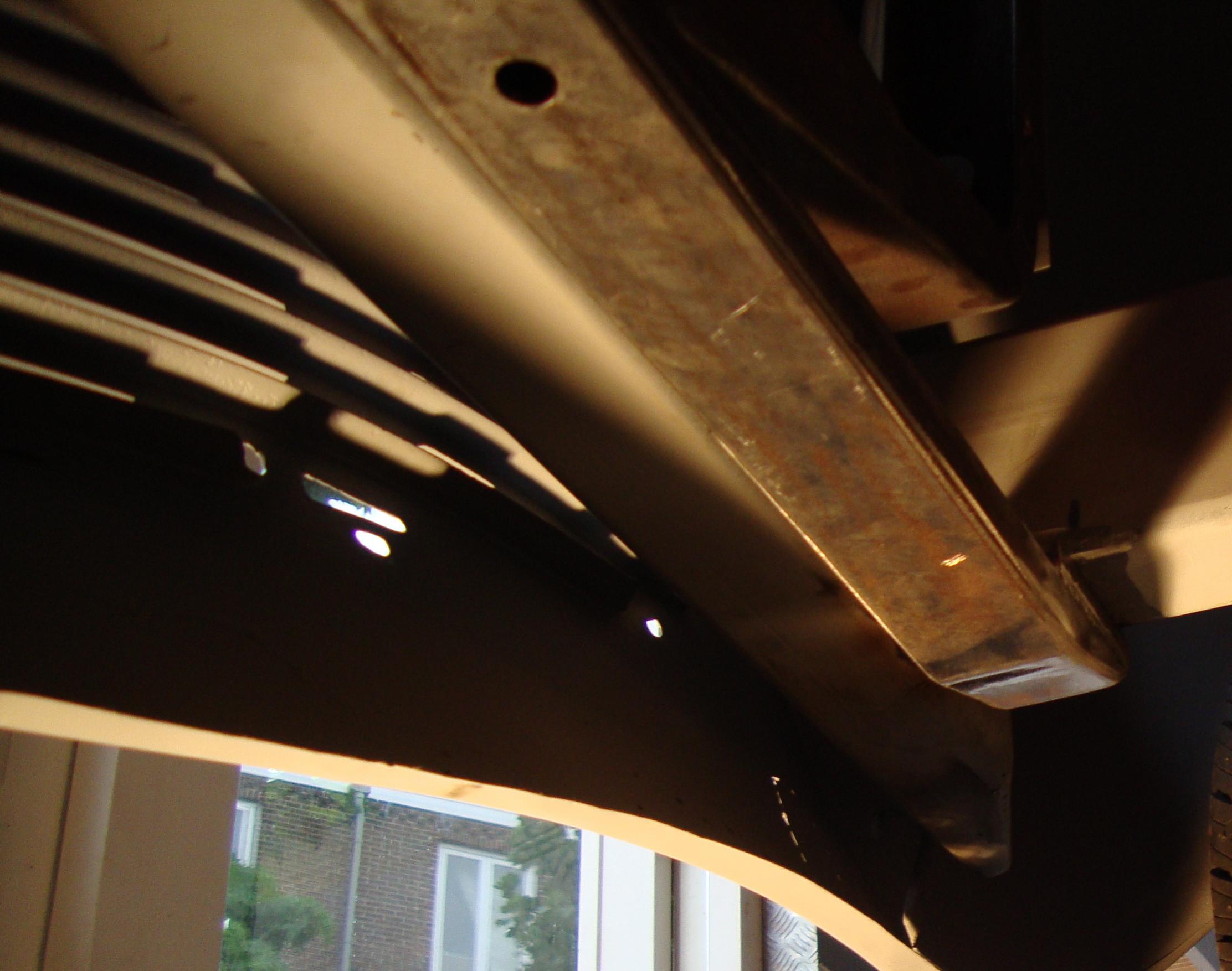

    Started on the radiator support bracket. Using a piece of thick walled steel tube, sliced the ends and welded it up.Drilled a couple of holes so the radiator support can be welded on. Added 1 cm steel on both sides in order to lower it and be able to slide in a piece of rubber against vibration. Spot welded it on the bottom of the frame. Tried to make some pics from underneath, hope its visible that whats been done. Final welding will be done when the body is off.

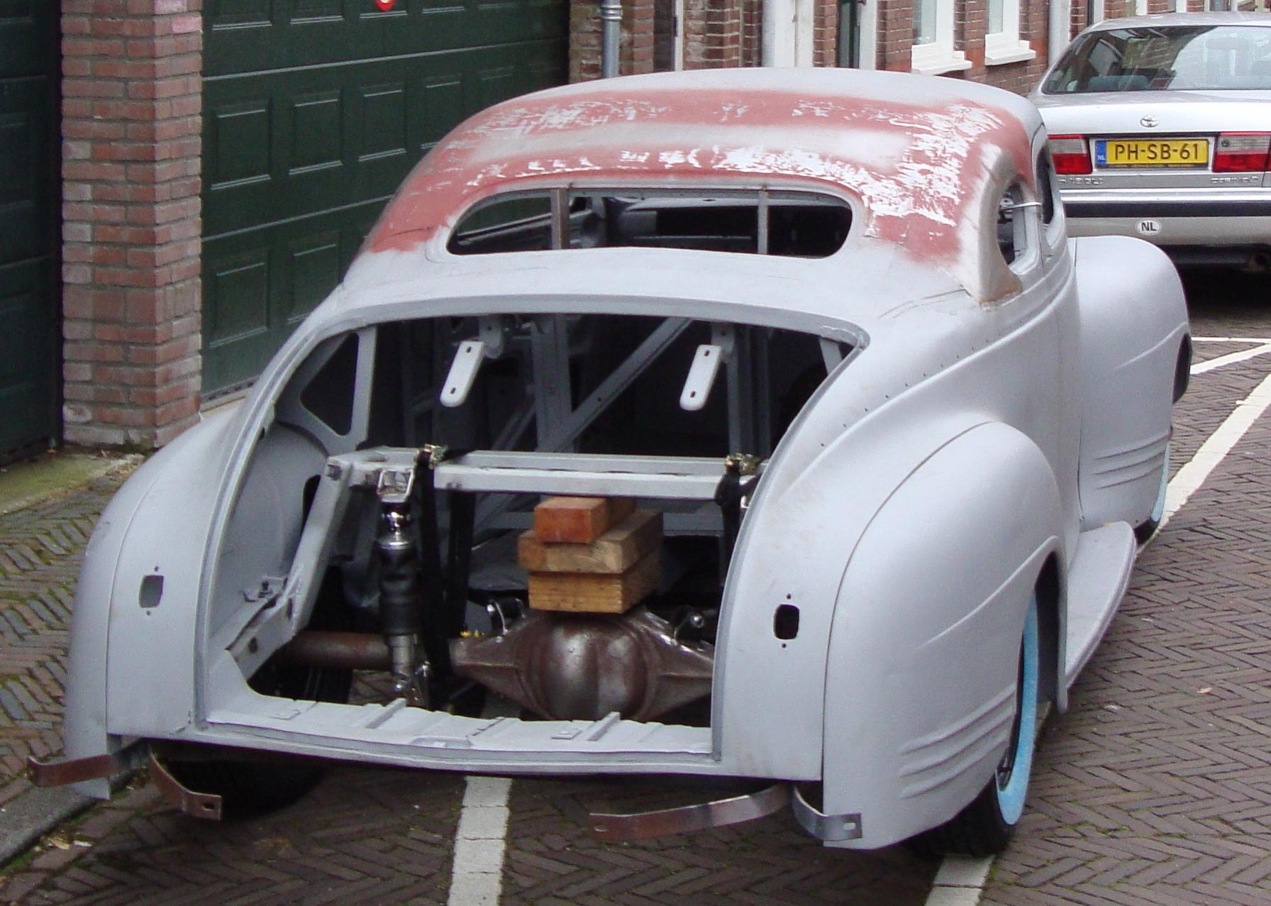

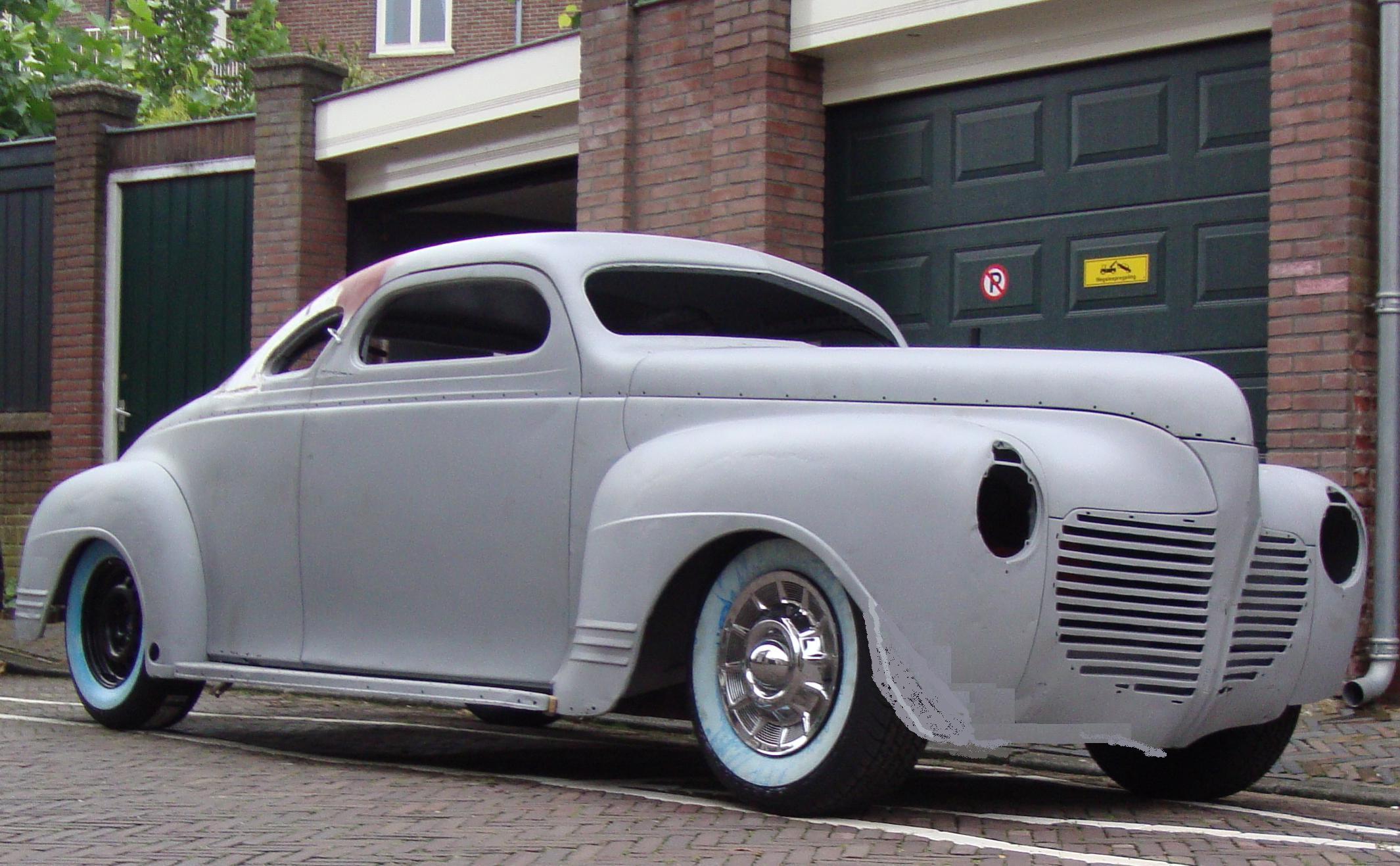

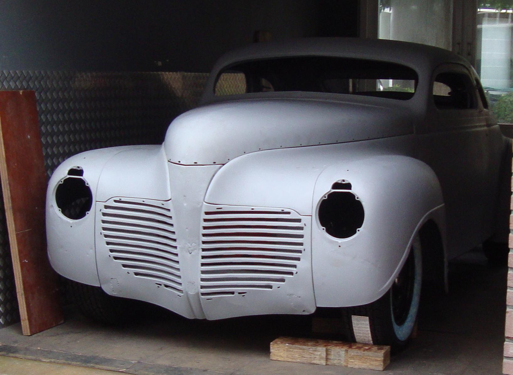

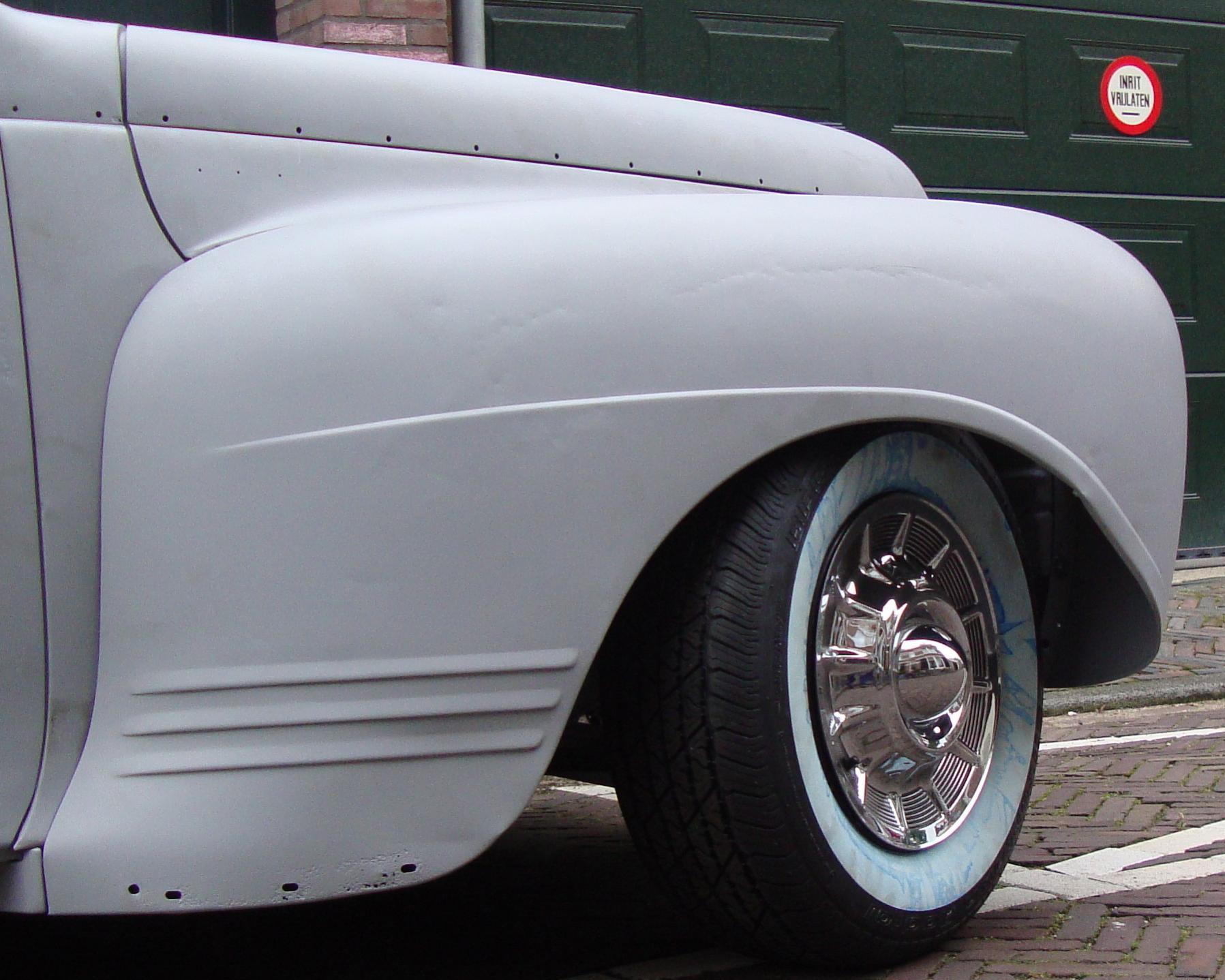

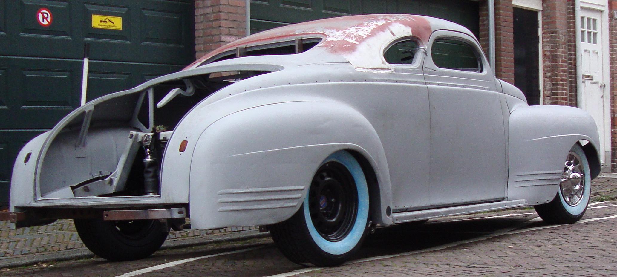

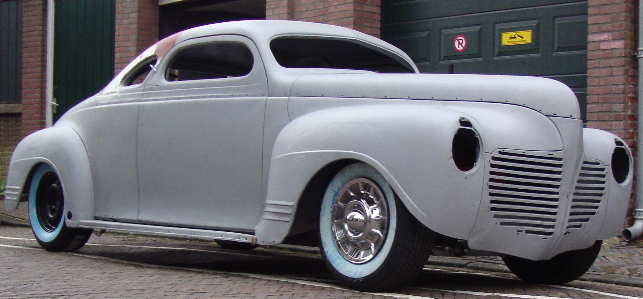

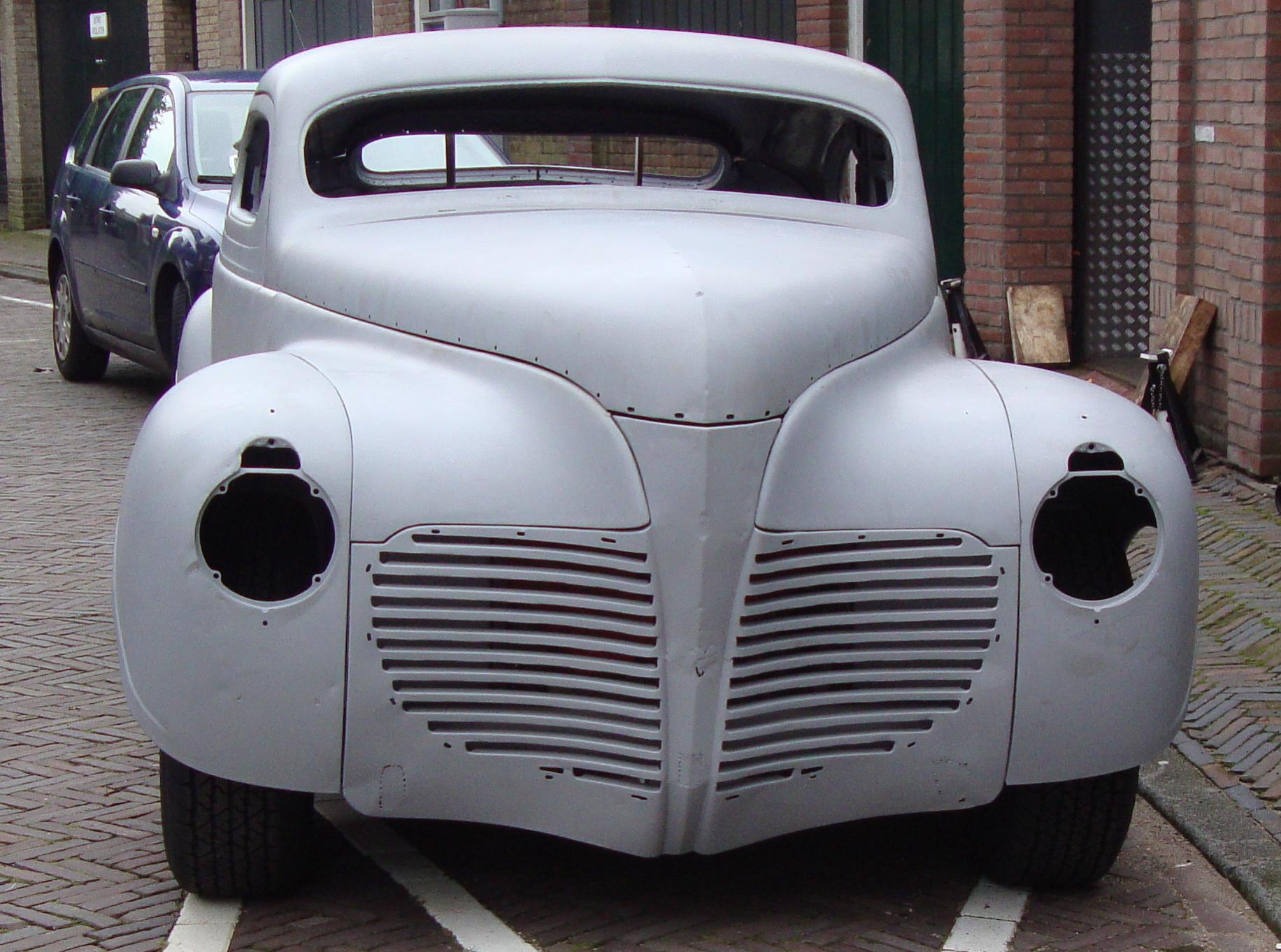

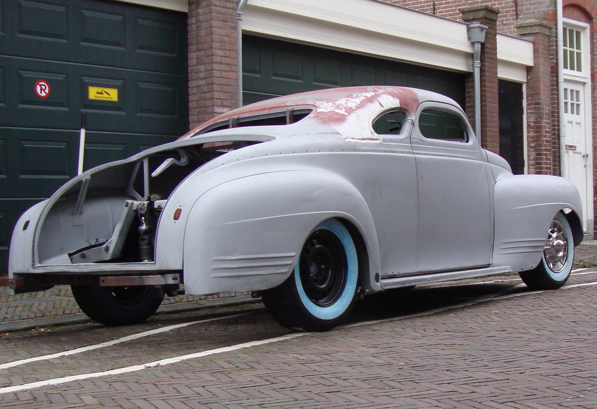

    Got up early this morning to bolt the transmission and radiator support. Placed some big blocks of wood between the c notch and the rear end and tied it down. (otherwise I wouldn't make the incline clearance wise out of the garage) Finally got my baby on her 4 wheels outside! Did come to the conclusion however that I'll need 2 inch drop spindles in the front. The car is at ride height in de pics, with the front completely bottomed out. The rear can come down another 4-5 inches, so thats fine. I think being able to drop the front another 2 inches would finish it off. Took a few steps back and just looked at the car for several minutes. Enjoyment.This certainly makes it all worthwhile!

    Here's a couple more pics...

    Here are the last pics taken today.

    The outer swoosh of the front fender is what makes the 40-1's tough to lower, since the front crossmember and the center of the grille are so much lower.
    Have you considered dropping the fender corners?
    Crude paint of what I've saying...
    I'd shoot for the center of the hubcap aligning with the top strake on the back of the fender front and rear. One of those things that just seems to please the eye....

    I see what you're getting at. I'm planning to at least get a better flow with the front fenders and the grill. All the loose panels will be aligned properly and I'll weld all the seems/gaps for a cleaner look.Then I'll play around with adding metal for a better flow. There are just too many separate panels around the grill area in my opinion, creating a "messy" nose. Thanks for the input Rod!

    Thanks milwscruffy for the toss. At the moment ground clearance is not an issue, not even with the lower part of the grill. The whole nose, when aligned properly, will go up by approximately 1 inch. I need to lower the car in the front, and hope to achieve this with 2 inch drop spindles. Thanks for the input/thoughts. Eric
