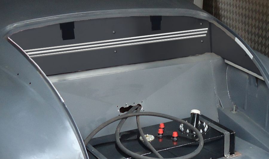

    If you make a design (like the ones in your rear fenders) and break out the bead roller somewhere on the trunk panels before you polish, then paint, it really looks like stainless trim. 3D. Any Photoshop ideas Eli?
  4. farmer12
    Joined: Aug 28, 2006
    Posts: 7,724
    farmer12
    I like the idea of the 3 lines, like in the fenders. Just not sure if a bead roller would work on 3mm thick material though.......I've never tried that.

    I dont know what kind of beadroller you have,but those that people have home can usually take max 1,5mm steel or less when working with stainless.I guess that Pullmax could work with that thick stuff better than beadroller...

    Thanks Antti. That's what I was thinking as well.......the material being too thick. I'd hate to screw up the panels by using excessive force on them. I think I'll leave them smooth.

    Maybe take some 1mm stock and make a panel with louvers on it? You could paint between the louvers and attach it to the main piece after you paint it black.

    If you polish the area of those 3 stripes, mask the stripe with 2-3 layers of tape, you can sandblast the area back to rough to hold paint. Then peel the tape after paint.
    Or bead roll some thin stainless strips and solider or weld on some backing screws and attach.
    Either way I like Eli's 'shop of the pic, the effect should be doable without too much work.

    "Maybe take some 1mm stock and make a panel with louvers on it? You could paint between the louvers and attach it to the main piece after you paint it black."
    Thank you for the photoshop OahuEli! That has certainly got me thinking.

    what i think will look nice is if you would polish the panel, tape off and sand and paint the rest.. maybe add an adhesive between stainless and the paint, cause not everything will stick on it
    you can Always tape of the panel later on, leaving the stripes untaped and maybe airbrush it a little to make it look like it was bead rolled?
    i can change the color of the car if you want to as well, maybe that'll help give a better view of it

    You're quite welcome Eric, I hope it helps. In any event, bending 1 mm with a bead roller has to be easier than 3 mm. Just ran the numbers and I'm not good at converting millimeters to inches but I'm guessing 3 mm is about .130 inches, or a little thicker than 1/8th of an inch. I can see most sheet metal benders thinking rather bad thoughts at bending something that thick. :eek::D

    Thank you Perry, great photoshop! Now I've got even more to think about...

    A little thicker than 1/8th indeed. A bit too much for a normal bead roller.....

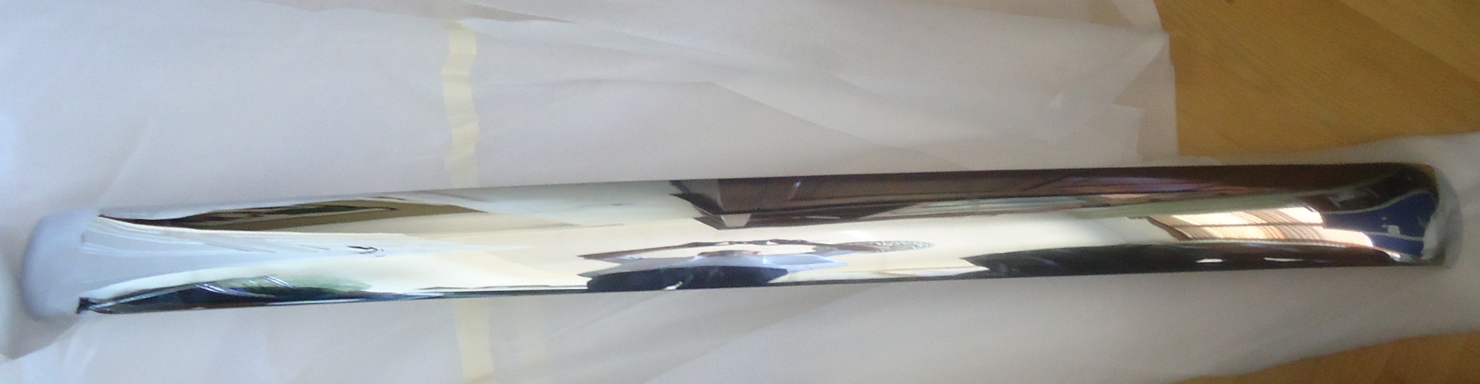

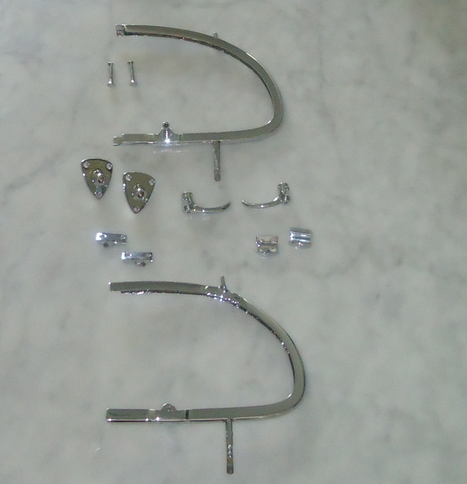

    Not much news to report this week except that the newly chromed parts have arrived! It all came out looking awesome. The bumper is smooth now and all the parts for the vent windows look great as well. It was a little like opening the Christmas presents today.:D:D:D
