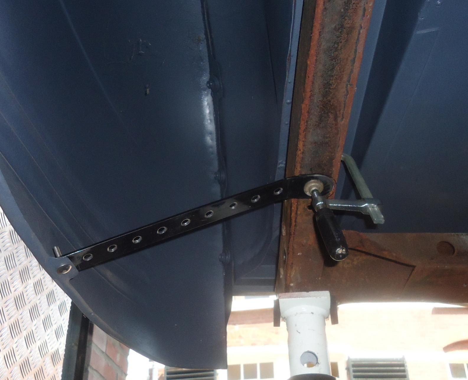

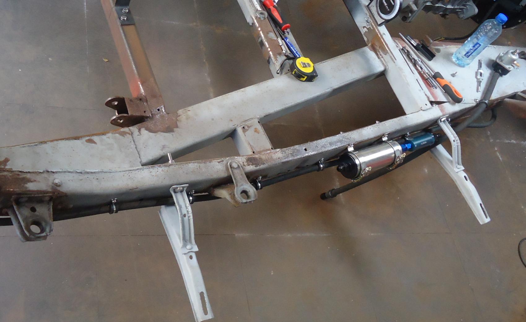

    Today was bracket fabrication day. First on the list were the rear fender support brackets. They stop the fender wobbling when the Hemi is rumbling. :D I drilled some holes in them for good looks, not that many people will ever see them again.

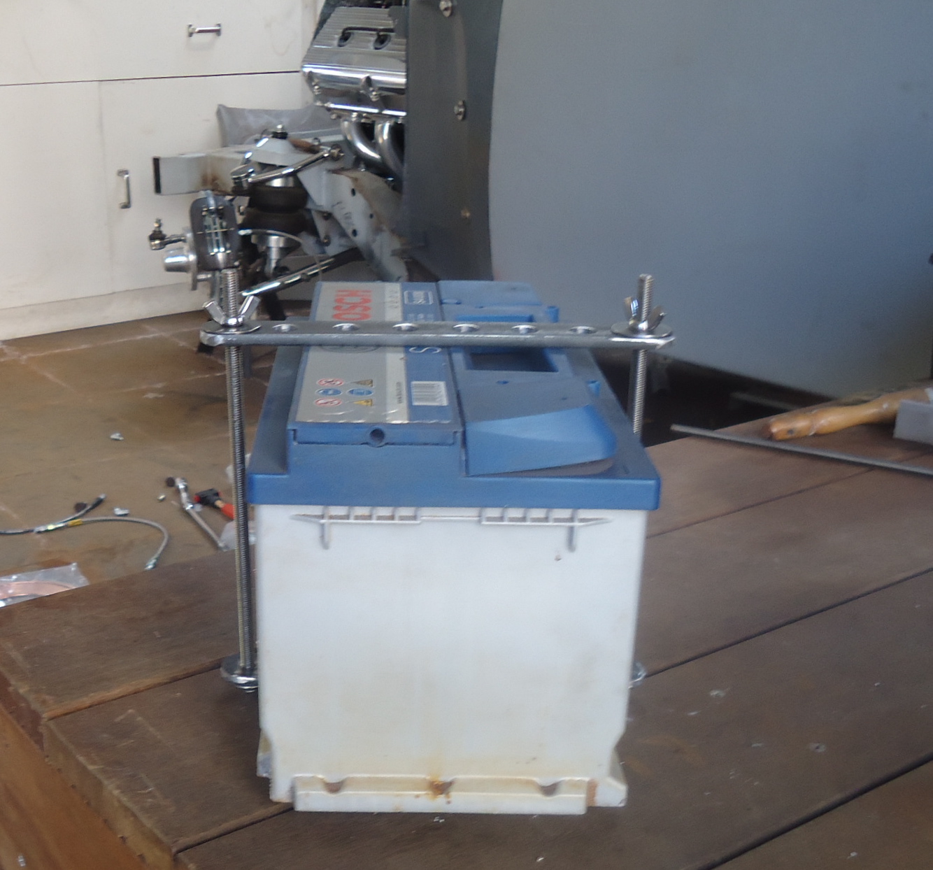

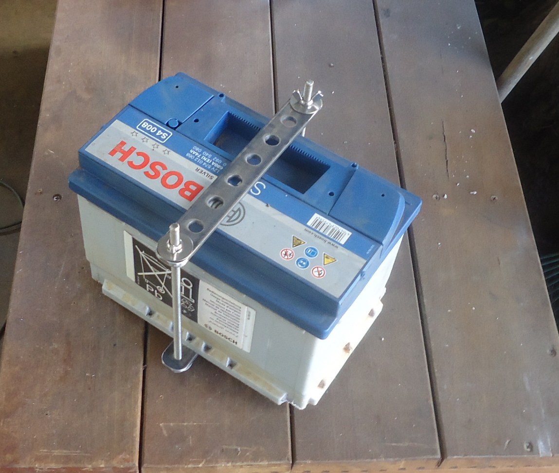

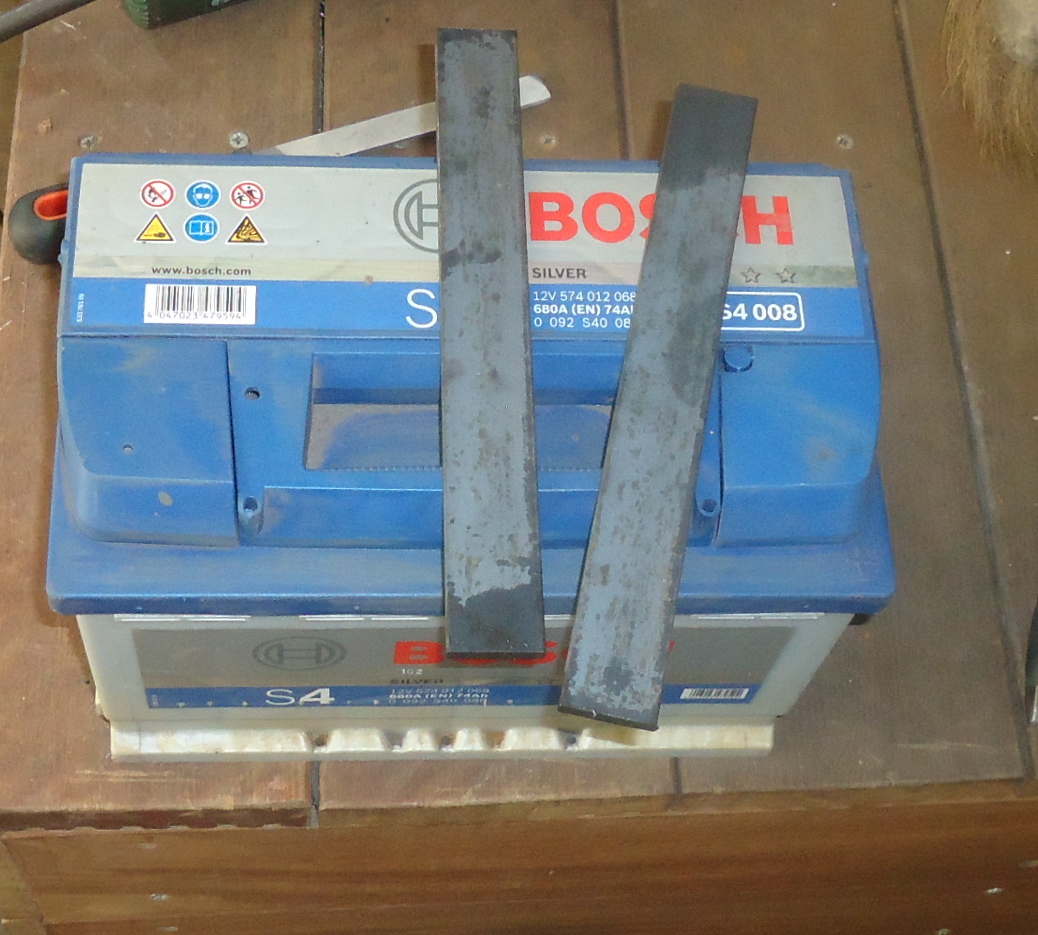

    Next was the battery support bracket. Now I could have called Summit, but that would have been too easy. Got me some thick pieces of metal, cut them to size and drilled some holes in them. Then went to the store for some ss rods, washers and ****erfly nuts and test mounted it on the battery. Came out perfect! Once again, not many people will ever see it, but hey, that's life.:D

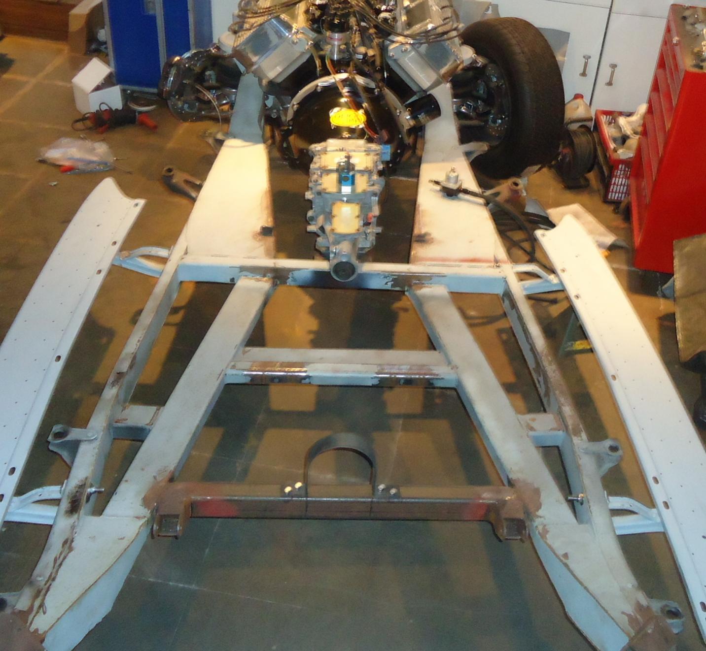

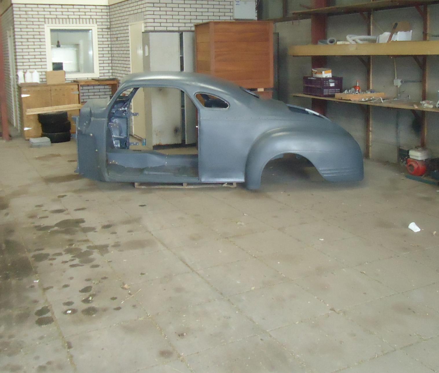

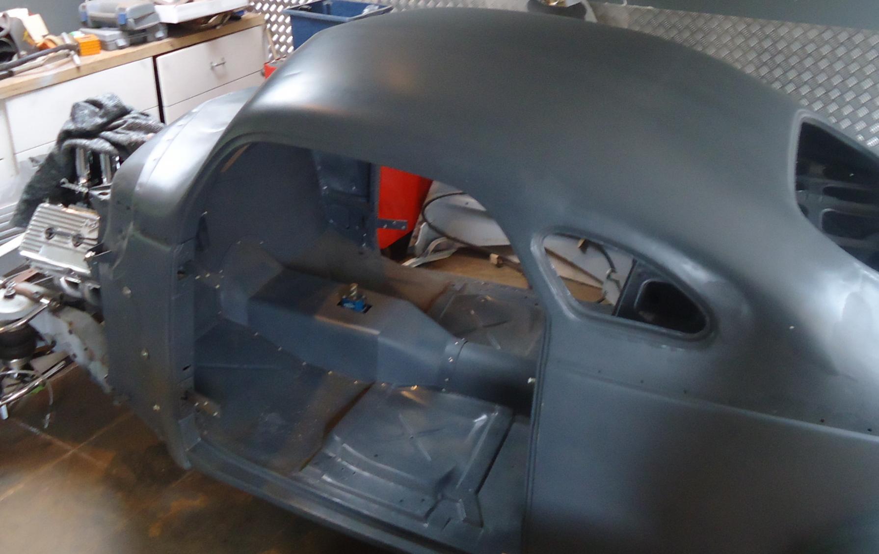

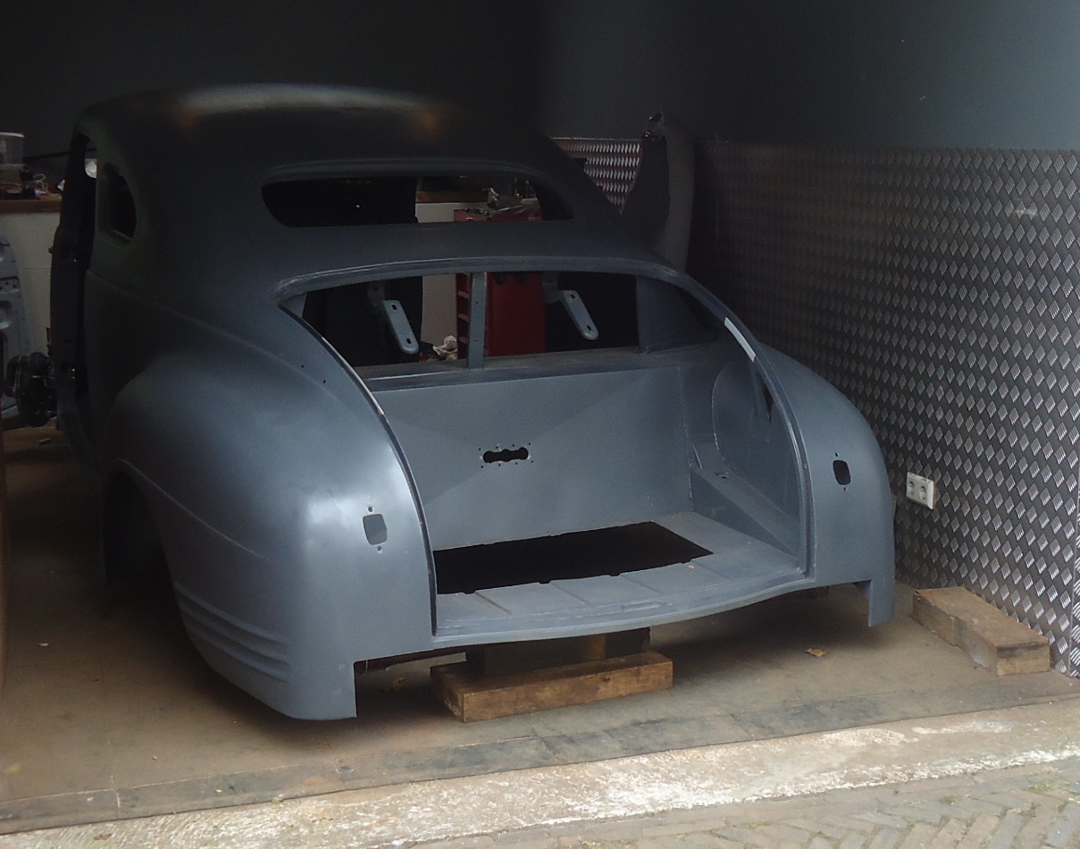

    Thanks Antti! The Porsche is indeed still blocking my spot. So, the plans have changed. Once I've finished the last odds and ends of fabrication and test fittings, I'm going to remove the body and store it at my friend Barts shop. This will take place this coming week. I will then have easier access to the ch***is, where I'll been making a few minor changes and drill the holes for my brake, fuel and air lines.
    Then next month I'll have the ch***is back in my garage after it has been powder coated. I'll then turn it back into a rolling ch***is. When the guys at the body shop have room, they'll do the underside of the body. Once that is done, I'm going to bring them the rolling ch***is and we'll mount the body onto it. From there on, they're going to start their work and the body will not have to be separated from the ch***is again. Makes sense?

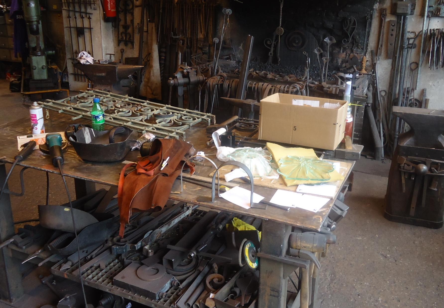

    Got a call from Ron the blacksmith this morning that my driveshaft safety loop was ready. Turned out perfect! Test fitted it and marked it on the ch***is.

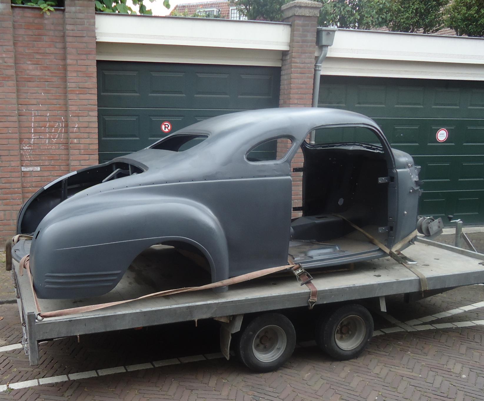

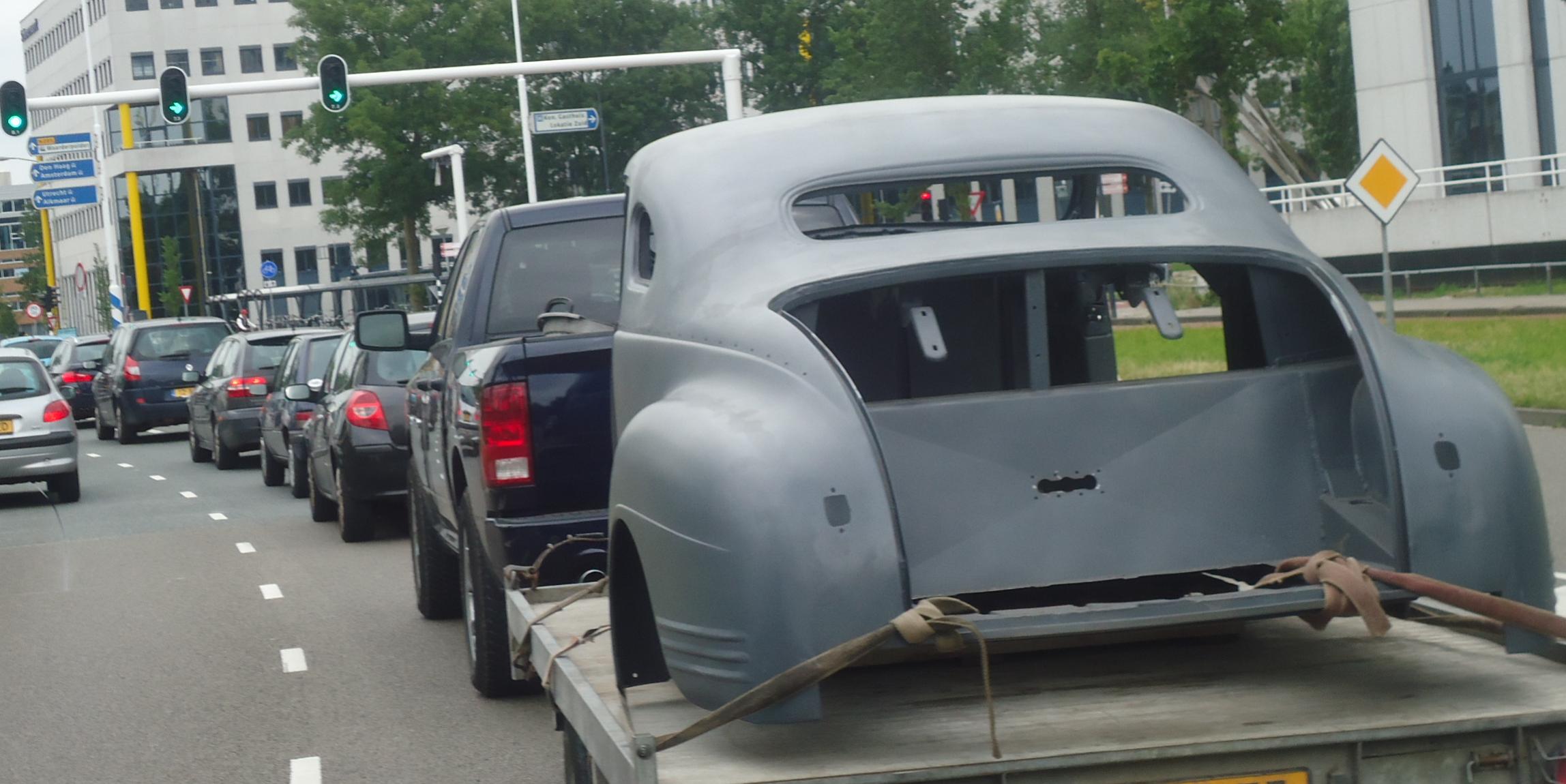

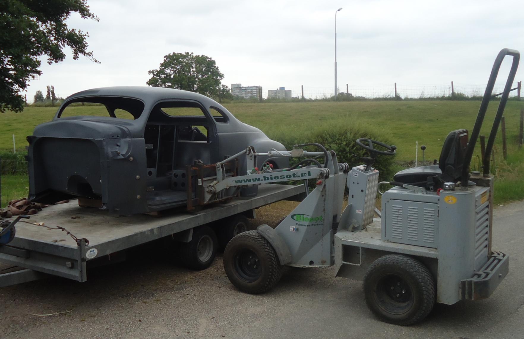

    Well it was finally time to move the body out of the garage. Another milestone. My friend Bart came over with his trailer and with the help of a few friendly neighbours, it was on the trailer within 20 seconds. Tied it down and drove 5 miles to Bart's shop. Took a few scenic pics while I was driving behind him. Lifted the body off the trailer and we placed it in the corner, where it will sit for the next month or two. I'll still do a few minor things to it while it's there, but I'll need to first concentrate on the ch***is next week. More progress on monday!:D:D:D

    Cool shot with the windmill in the background. I also like the little forklift thingie.
    I've been following along and always check on your progress. I'm impressed with your craftsmanship and "no fear" in tackling the challenges that arise.

    Thank you charleyw! It was quite hairy with the forklift though.....the forks of it aren't that long, so I stood in the driver side door opening in order to balance it. My extra weight did cause the rear wheels to come off the ground at times while we drove it the 30 meters. Got it done without scratches though!

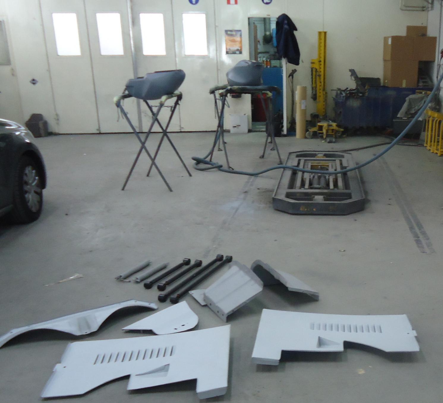

    The first parts have been dropped off at the paint shop. Mark(paint), wants a small amount of parts each time, so he can hang them all in his paint booth and finish them. Once they're done, I'll take them home and bring the next batch. This way parts don't get lost/damaged in the shop while sitting in a corner.

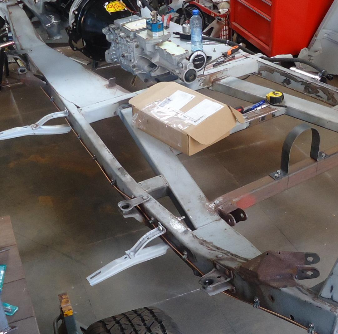

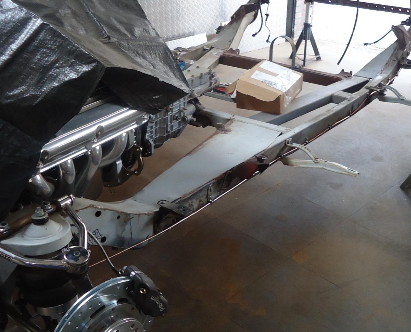

    Started off early this morning trying to find the routing for the brake line, in and around the mounts/obstacles. Drilled a hole every 8 inches and tapped some thread in to them. The driver's side is done now. The p***enger side will be easier as it will only run from the from wheel to just past the cowl, from where it will enter the cabin underneath the dash. The front brakes will split just after booster/canister, each going their own way. The rear brakes run via the driver's side frame to the rear where it will be split.
    Next was the fuel lines. Got the return line done, the main feeder will be done tomorrow. Also on the list are the air lines, vacuum pump and hose and the electric wiring for the airride sensors on each wheel. Plenty of work left to do!:D
    A little side note: I bolted down the brake and fuel line just to make sure it would fit following the intended path. All will be removed again before powder coat.
