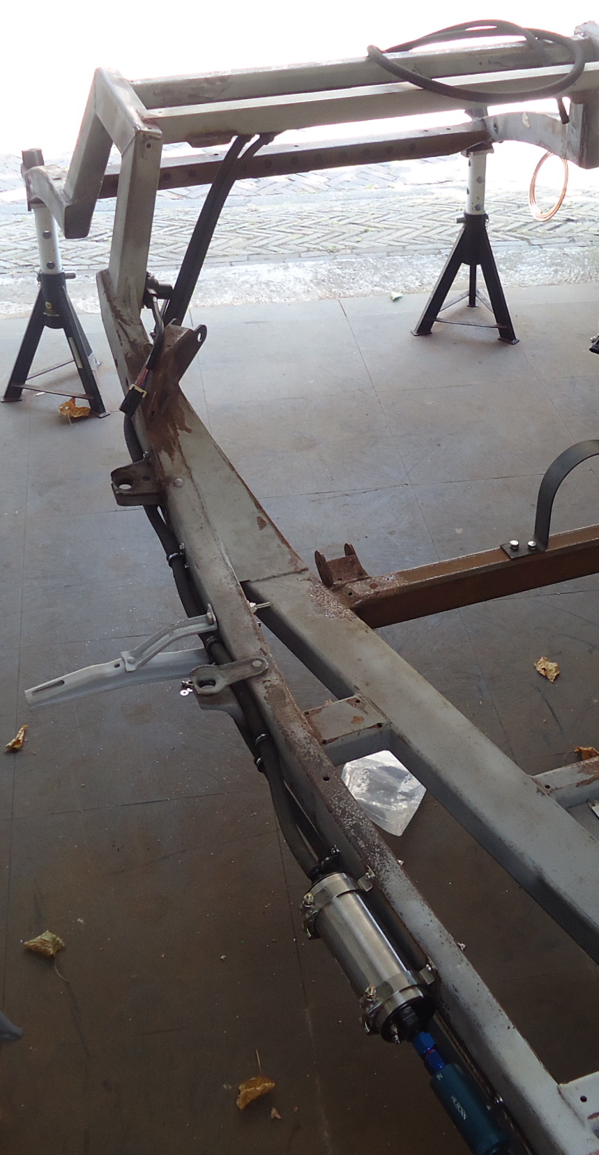

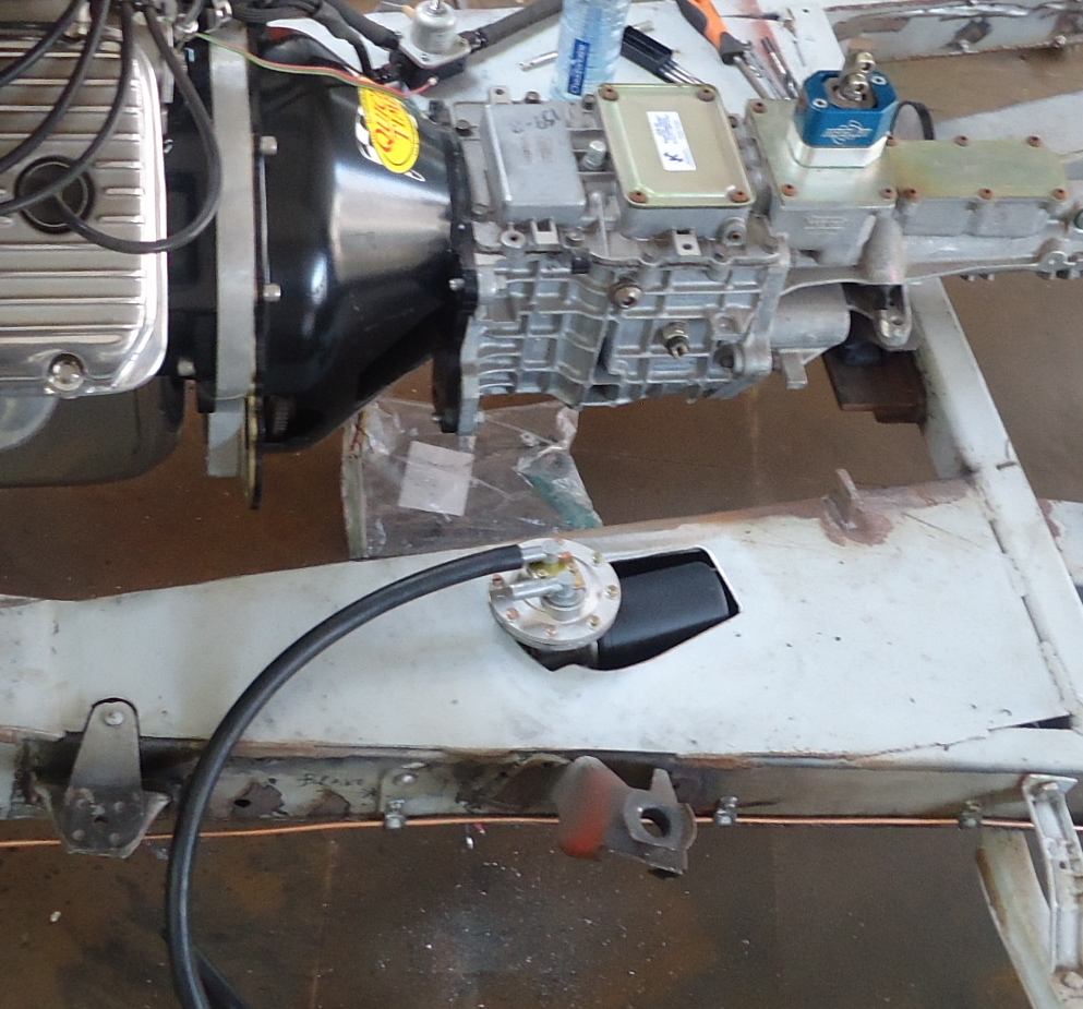

    This is going to be the last progress report before I go on holidays. Fitted the main fuel line from the pump all the way to the top of the c-notch. From there it will connect to the fuel cell located in the trunk.
    Next was to find a location for the vacuum pump. (I won't be using vacuum from the engine for my brake booster.) I found the perfect position between the frame rails, allowing me to run the hose along the body (inside the front fender) to the brake booster located underneath the dash. I know, I know, a lot of work just for aesthetic reasons.;) I got a little arty on the shape, deciding it just looks better this way rather then cutting out a boring square. Drilled the mounting holes through the frame and used rubber pieces to limit the vibrations. Job done!:D:D:D

    Hi ! Eric, is that copper brake line I see?

    Yep, it's copper.

    Is that vacuum pump vacuum operated or is it electrical ? What's it out of ?

    Eric I'm sure you know what your doing but is that copper or kunifer ? Personally I wouldn't use copper, seen it fail a few times

    Steve i'm sure Erik is using kunifer copperbrakelines are illigal and therefor not sold in automotive stores ,peronaly i'de rather use stainless

    The vacuum pump is electrically operated and keeps the vacuum between 18-22 psi if I recall correctly. It shuts off at 22 psi and comes on when the vacuum drops below 18 psi. The pump is from SSBC. Apparently it's fairly noisy but I'm ***uming that the 392 will overcome that problem.:D

    I did use copper brake line I had laying around, but this was just to make sure it would clear all the obstacles. I will be using stainless brake line when the time comes to do the final installation.
