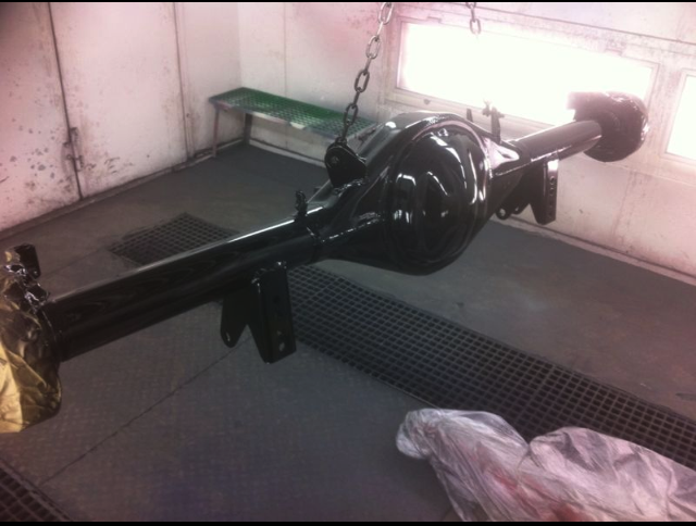

    Here's a better shot.

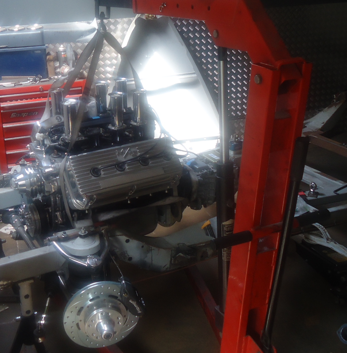

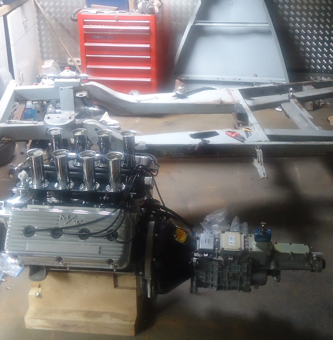

    I had a spare few hours this morning, so it was time to take the engine and gearbox out of the ch***is. With a borrowed little crane, I got it all set up and called my son for a little ***istance. (it was time for him to get up anyway:D) As I increased the tension, it all went smoothly for the first 20 inches until it suddenly dropped 2 inches. After a small heart attack, I realised that one of the ropes had tightened a little further around one of the engine mounts. Luckily no damage whatsoever, just scary. The rest of the operation went smoothly. Re-installed the chrome intakes and gave the engine a quick clean.

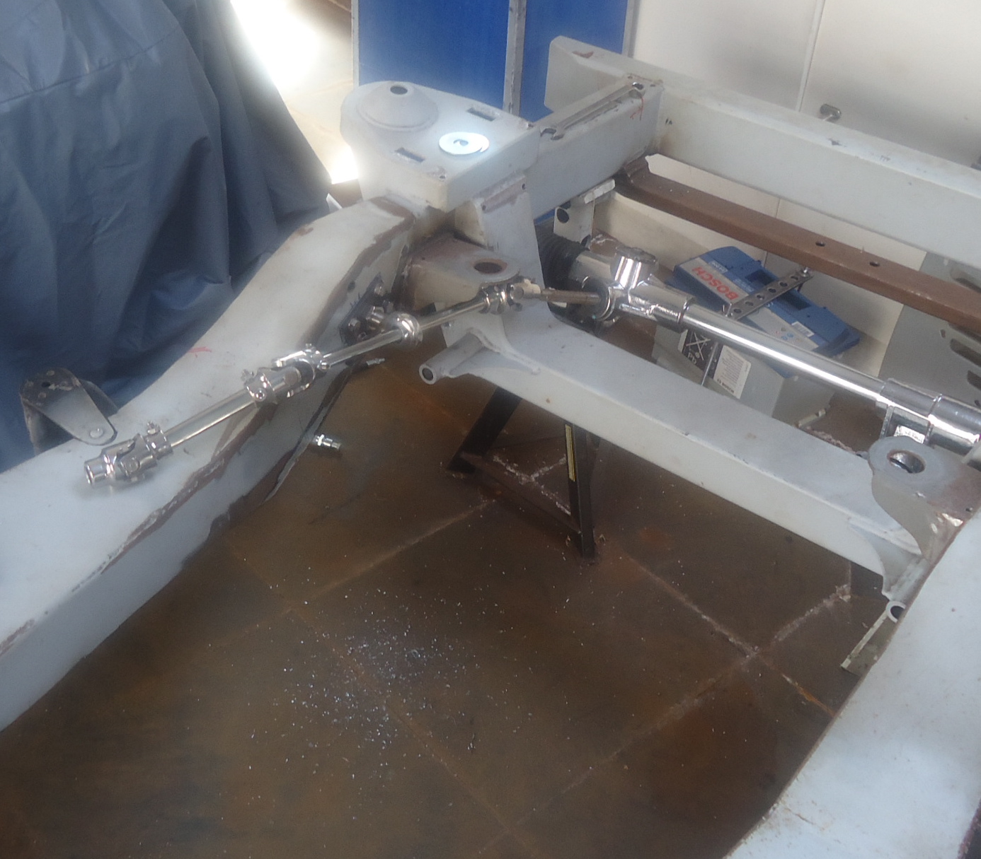

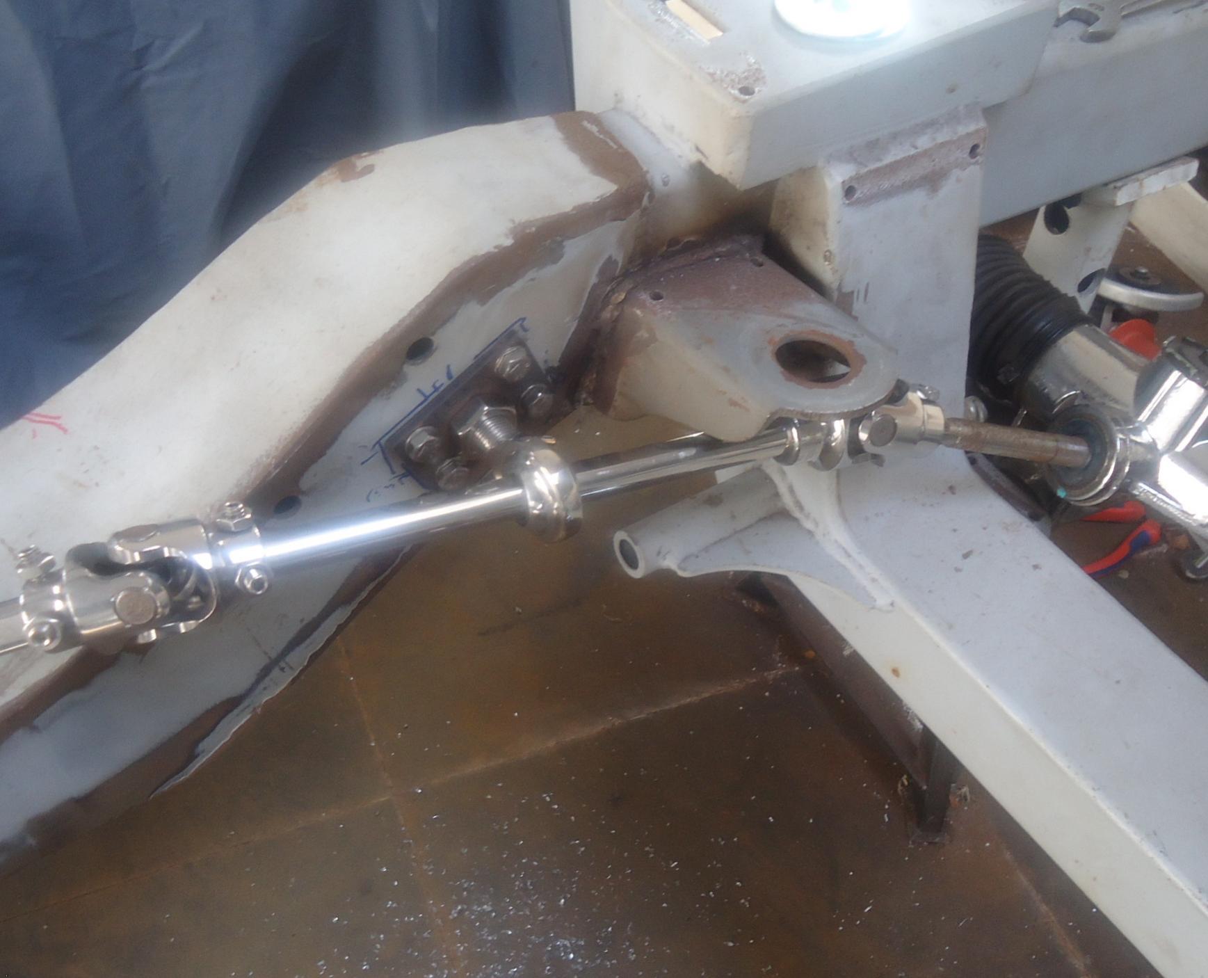

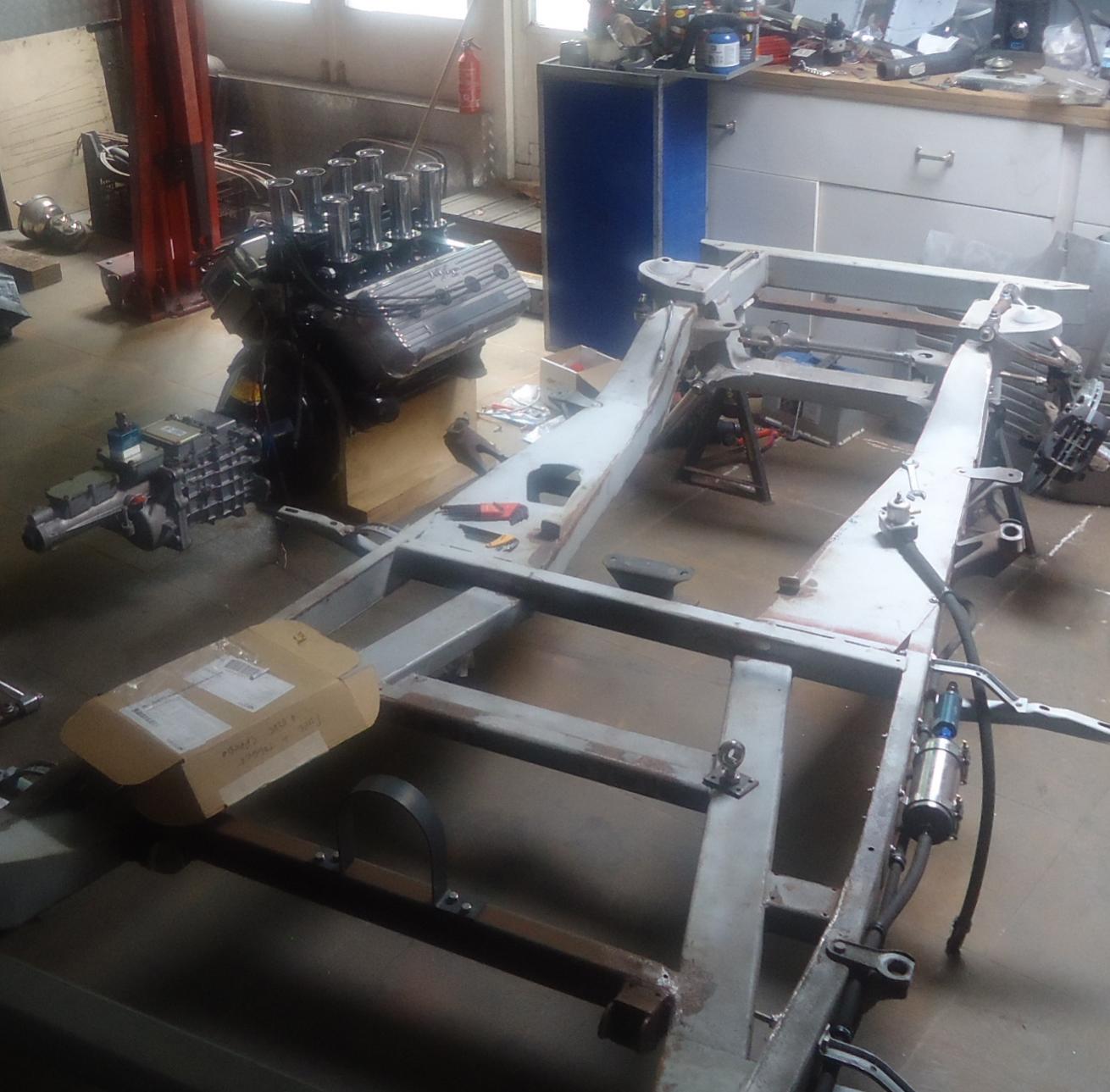

    Dismantled all the stuff on the ch***is and mounted the steering support. Had to lightly grind the bottom of the left engine mount in order to create a little more clearance. Perfect. :D More ch***is work tomorrow.

    I believe you should move the support bearing as close to the center joint as you can. In it's current location the center joint will want to bind under load. Works really good and smooth now but load that bad boy up with the engine and body and it will feel "lumpy" and bind up.

    Thanks for the advise! I did try to move it in closer, but then the angles were all wrong, in combination with the header clearance. For now it behaves fine, and like you said, under pressure it may be different. Should it bind up during the first few test runs, I can add a second one behind the 2nd and 3rd joints. Thank you for thinking along!

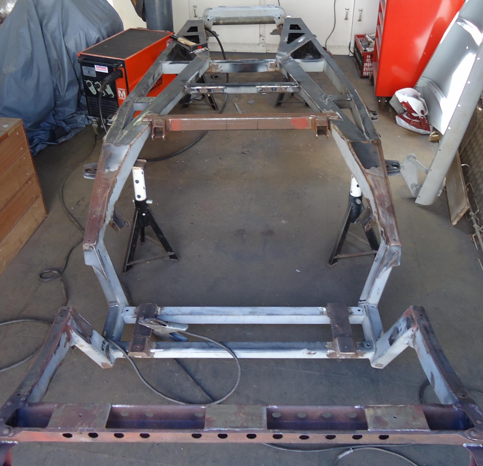

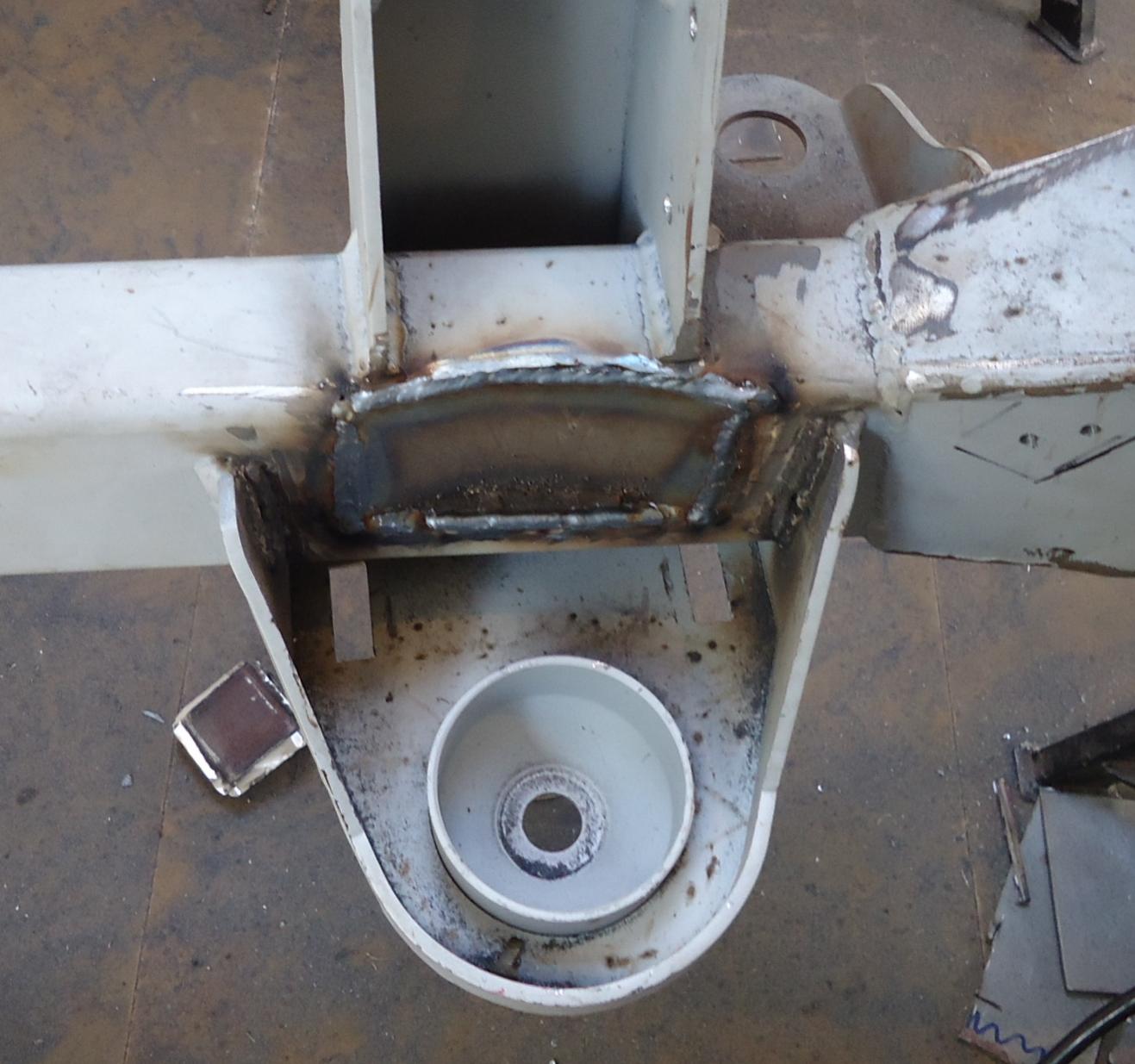

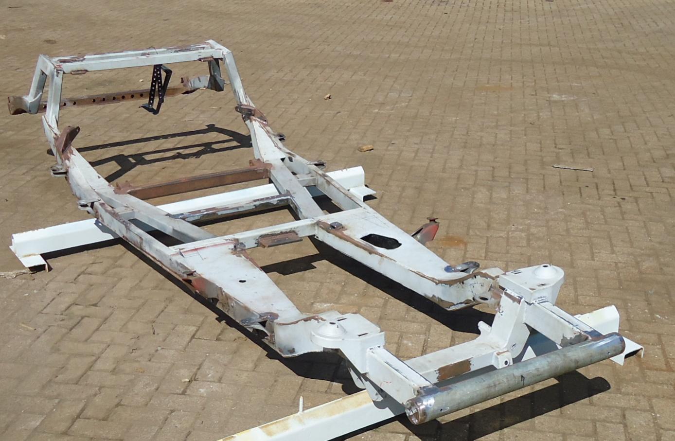

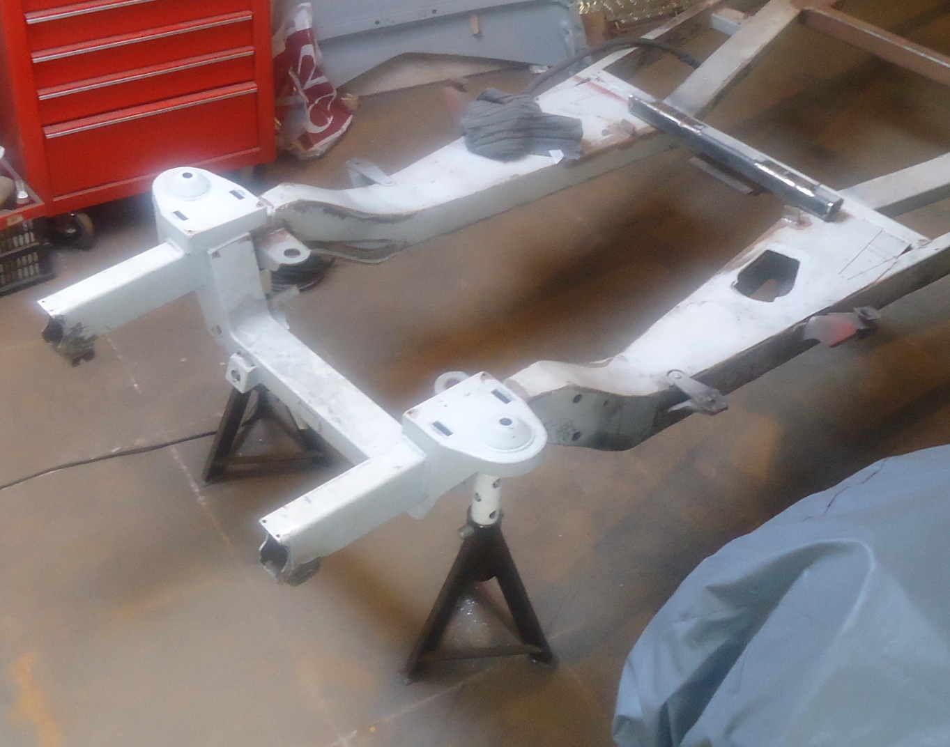

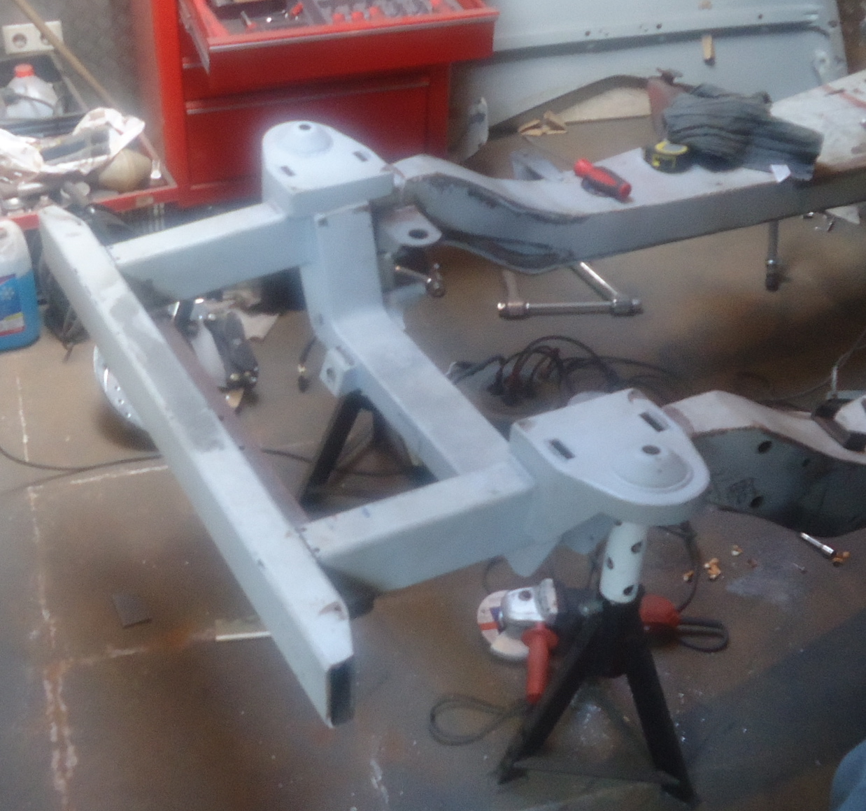

    Been doing a lot of ch***is work the last couple of days. To start, I've cut out one of the cross members as it wasn't square with the rest of the ch***is. Just finished welding it back in place again. Next was the front member. It is just too heavy and didn't give me the required clearance with the lower radiator valance. A round one is now in place, lighter and better looking. Then it was the front airbag clearance. With only one mm before it hit the ch***is, a circular piece is now welded in, giving it 10-12mm of clearance. Much better!
    A big thanks to my buddy Jaap who came over this morning for a helping hand. Final welding and clean up on monday. And then, it's off to the sandblaster! Finally!:D:D:D

    I thought that front crossmember looked pretty heavy, (it might make a good battering ram :rolleyes:). No doubt the round one will be an improvement. Its good to see that you're able to fine tune the frame and ch***is before it goes to paint. I hate having to go back and disturb brand new paint because of something that I overlooked and wasn't just right.

    Thanks OahuEli. The round cross member is about 4-5 kg's lighter, so that's an added bonus as well. Even though you try to think of everything before paint, I'm sure I'll be drilling a hole or two somewhere afterwards. It's perhaps inevitable, but I think the trick is to try and keep it down to a minimum.

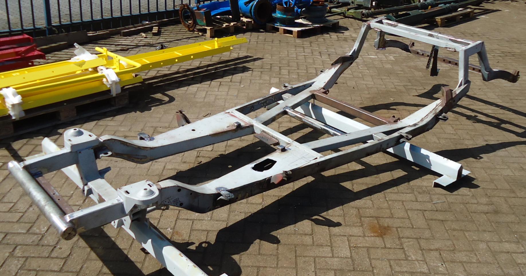

    After another morning of welding and grinding, the ch***is is finished! Loaded it on the back of Jaap's truck and dropped it off at the sandblaster. Yes.:D
