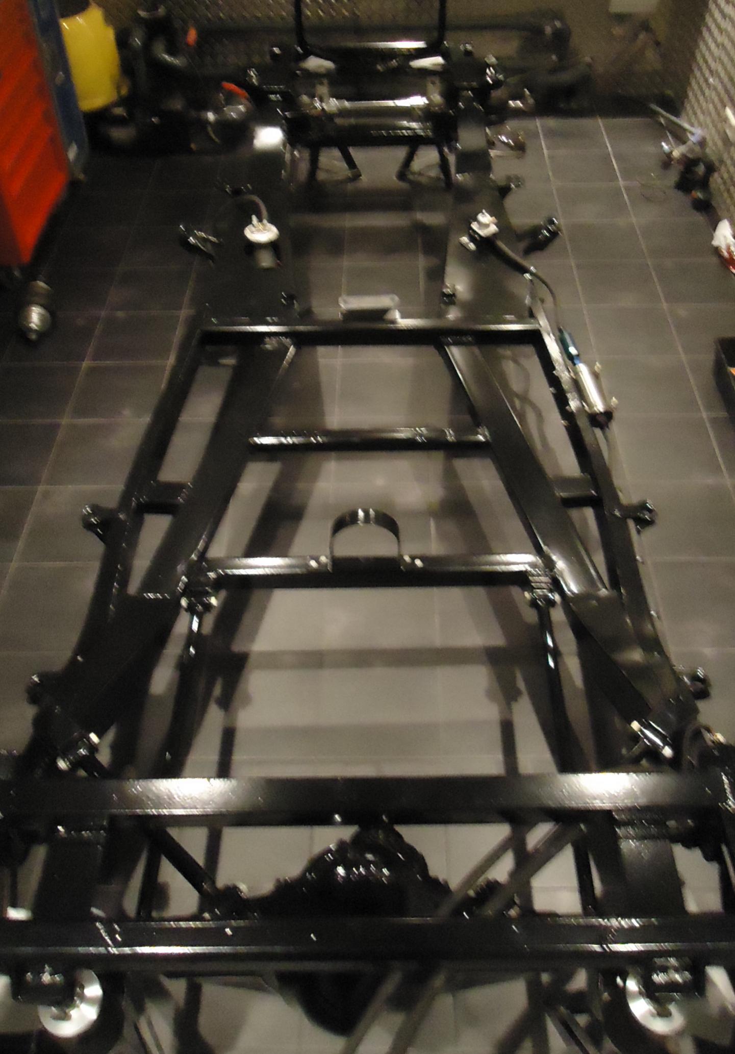

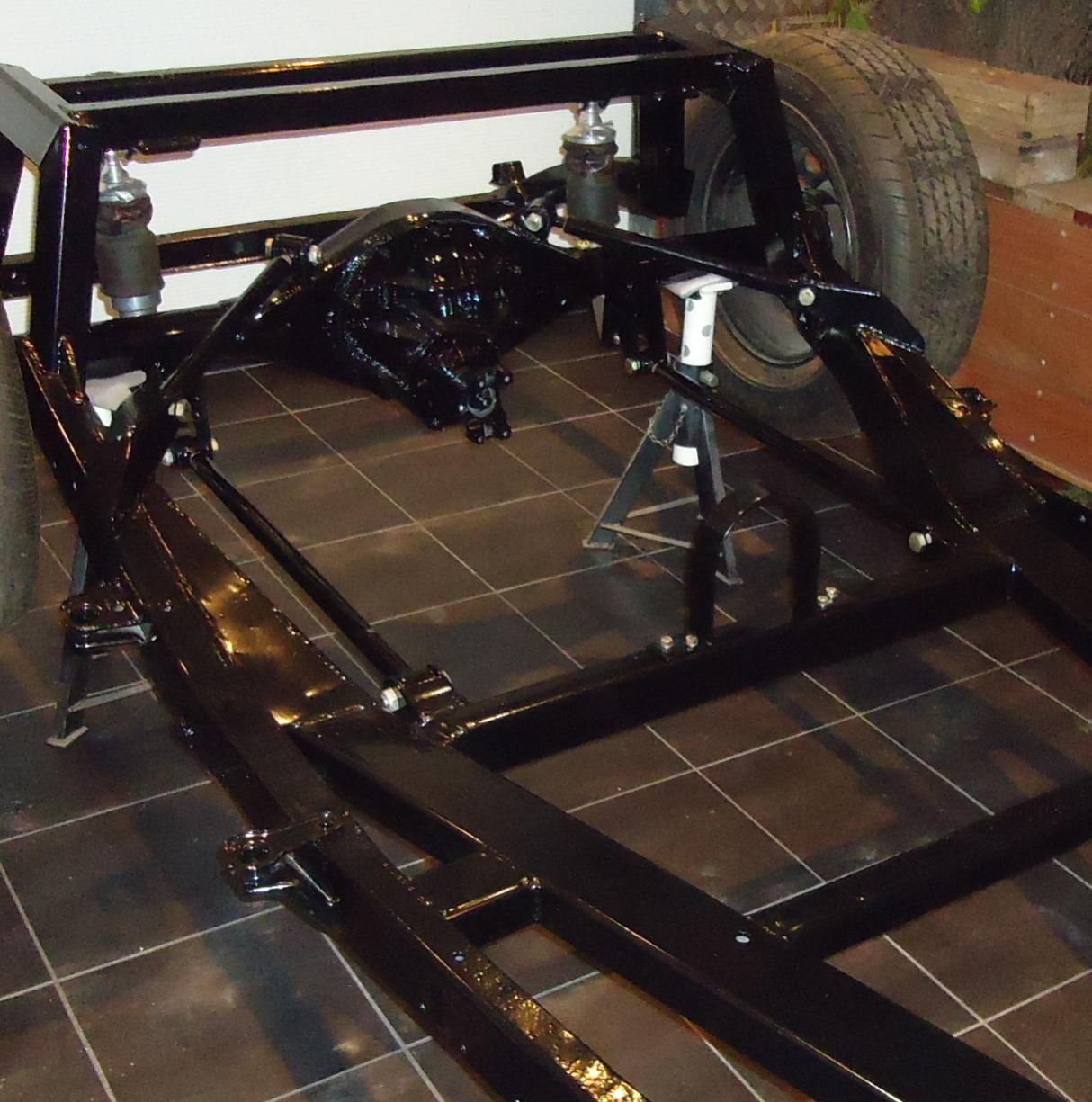

    The frame looks great. It also looks like you did an outstanding job on the garage. I can't help but ask what you used on the walls. It almost looks like machine turned aluminum in the pics. Very nice!

    Looks like that the powdercoater knew what he was doing,that looks great!
    Believe me,i've seen pretty ****py powdercoating too.

    Awesome progress!! Powder coating looks great and the garage looks great too! Kudos my friend!

    Thank you Tanktank49! On the walls I used 7mm diamond plates with an aluminium carpet strip glued on top. Gives a clean and nearly sterile look.
    Thank you Antti! The powdercoating came out looking great, especially due to the fact that I had it double coated. Perhaps not quite as smooth as a painted ch***is, but it will certainly prevent any rust from appearing in the next 100 years!:D

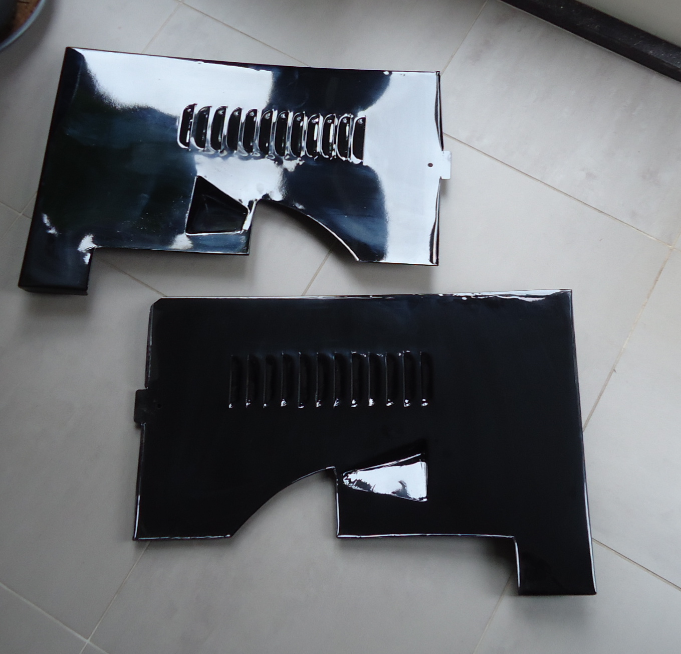

    Thank you Rich! Also just picked up a few painted parts from my painter, including my inner fenders. The photo doesn't do them any justice, they are perfect!

    That is one great looking frame. I like the way you thoroughly attack every aspect of this build. Perhaps that's why it has become one of the best builds here on the Hamb. Kudos to you.

    Frame looks great as does you're garage reno. Looking forward to seeing it go back together. :cool:

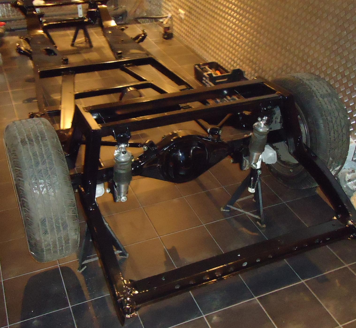

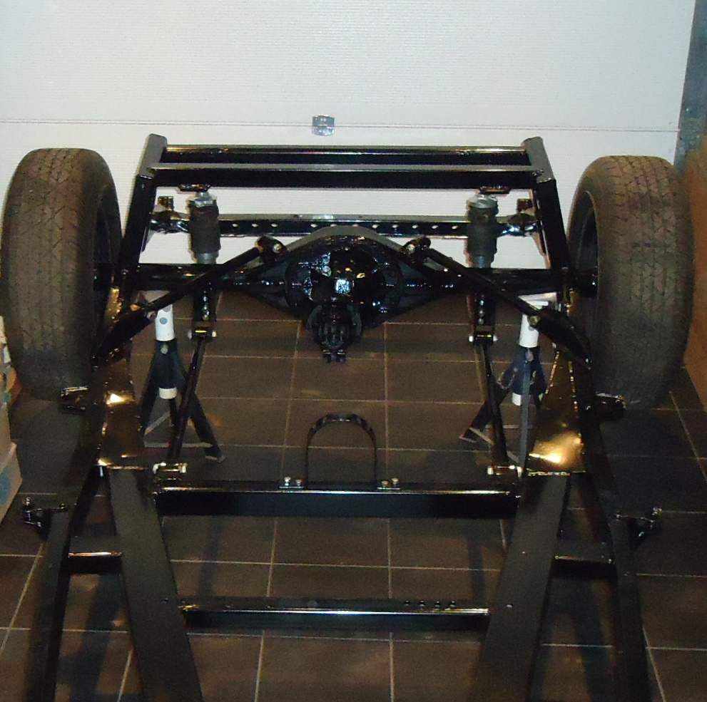

    Thanks for the kudos guys! Well, I finally found out how tough that powder coating really is........I've just spent quite a few hours ***embling the rear end and 4 link. Every hole had to be drilled and filed before I got any bolt to fit. Getting through 2 layers of powdercoat and a layer of zinc was time consuming, but I'm happy with the end result!:D

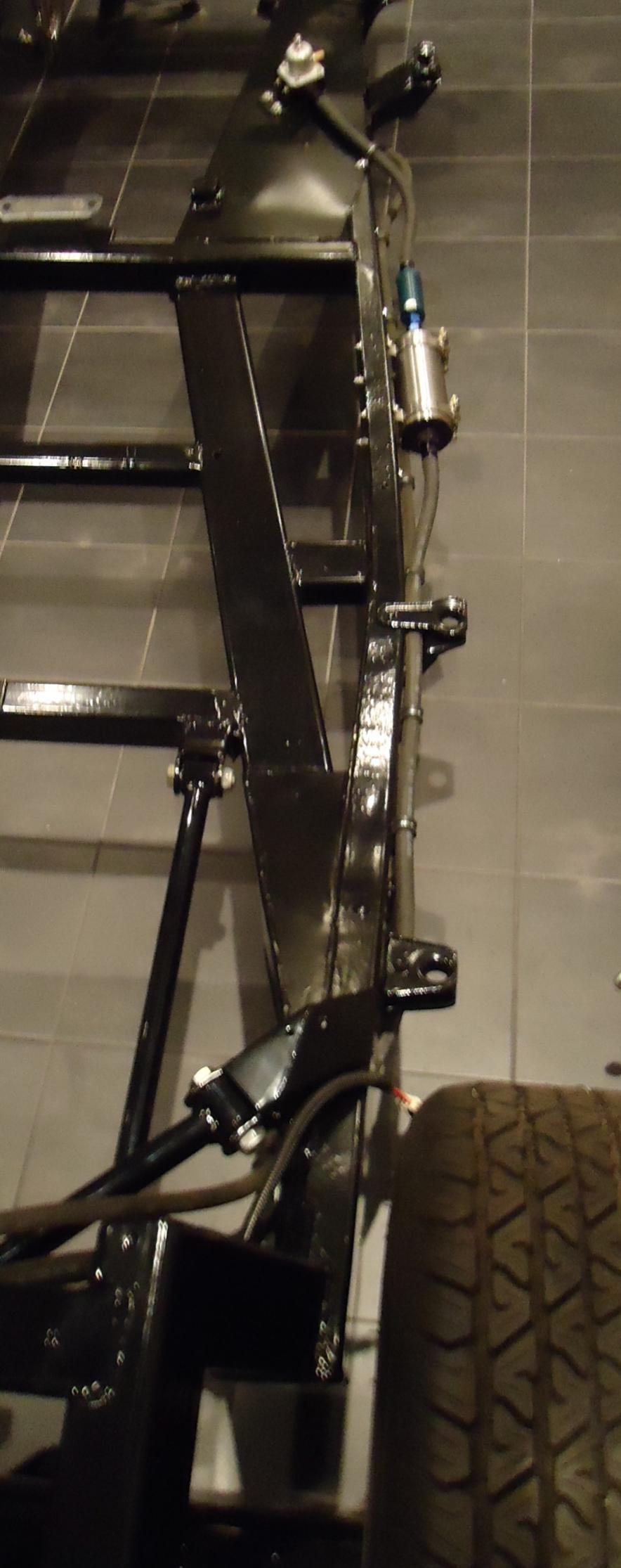

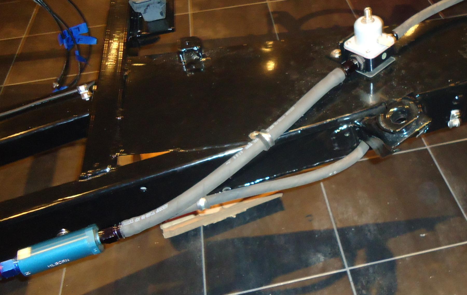

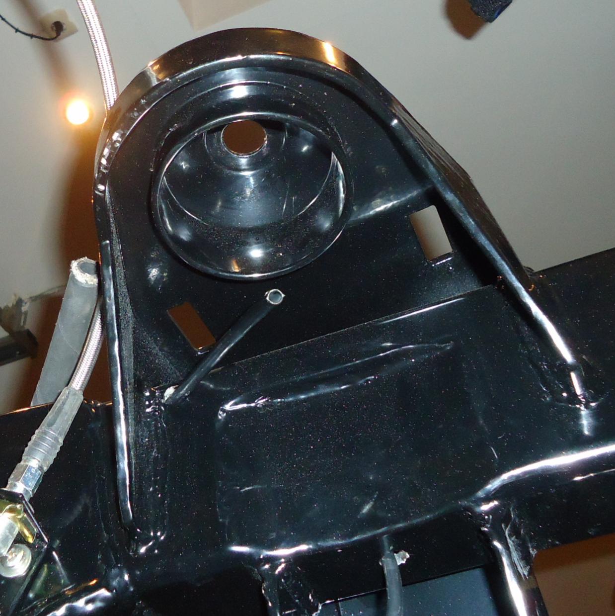

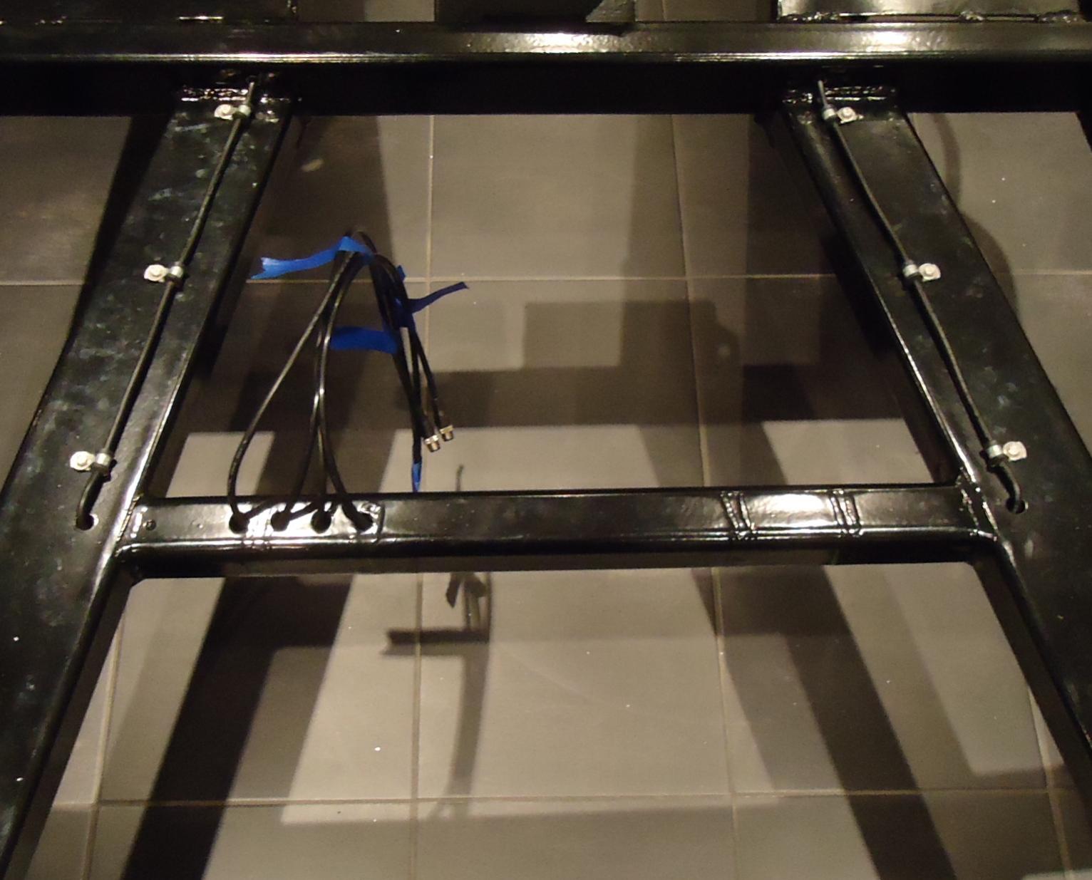

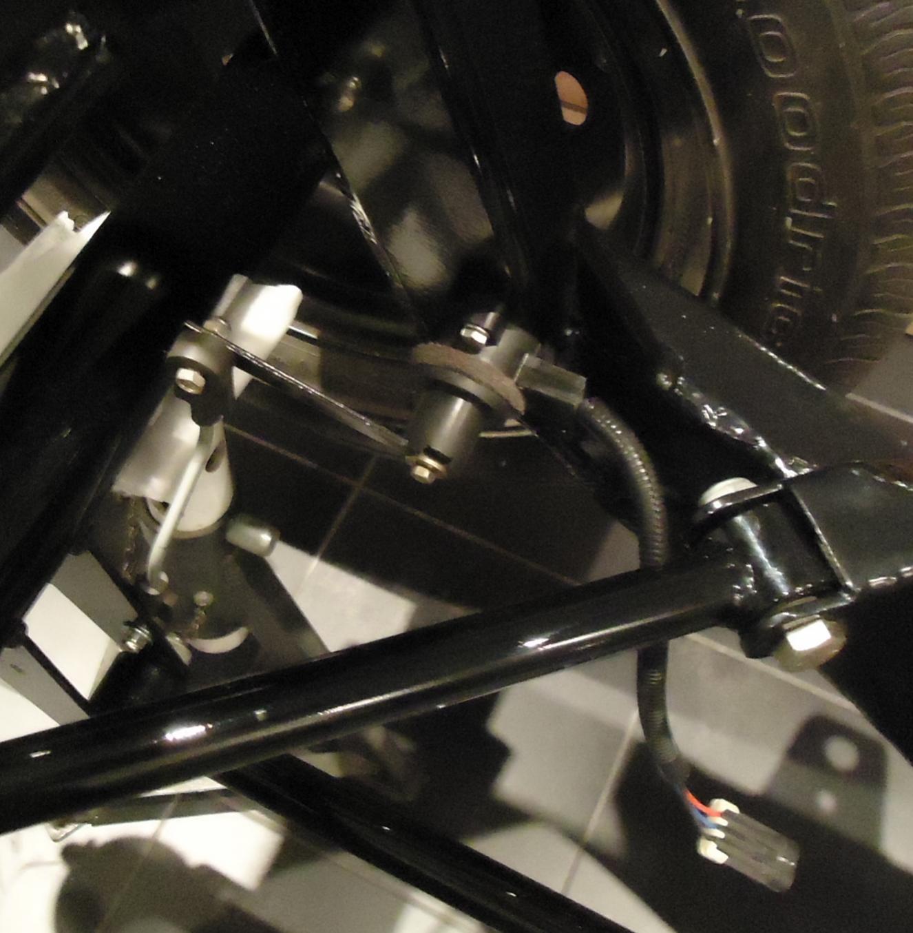

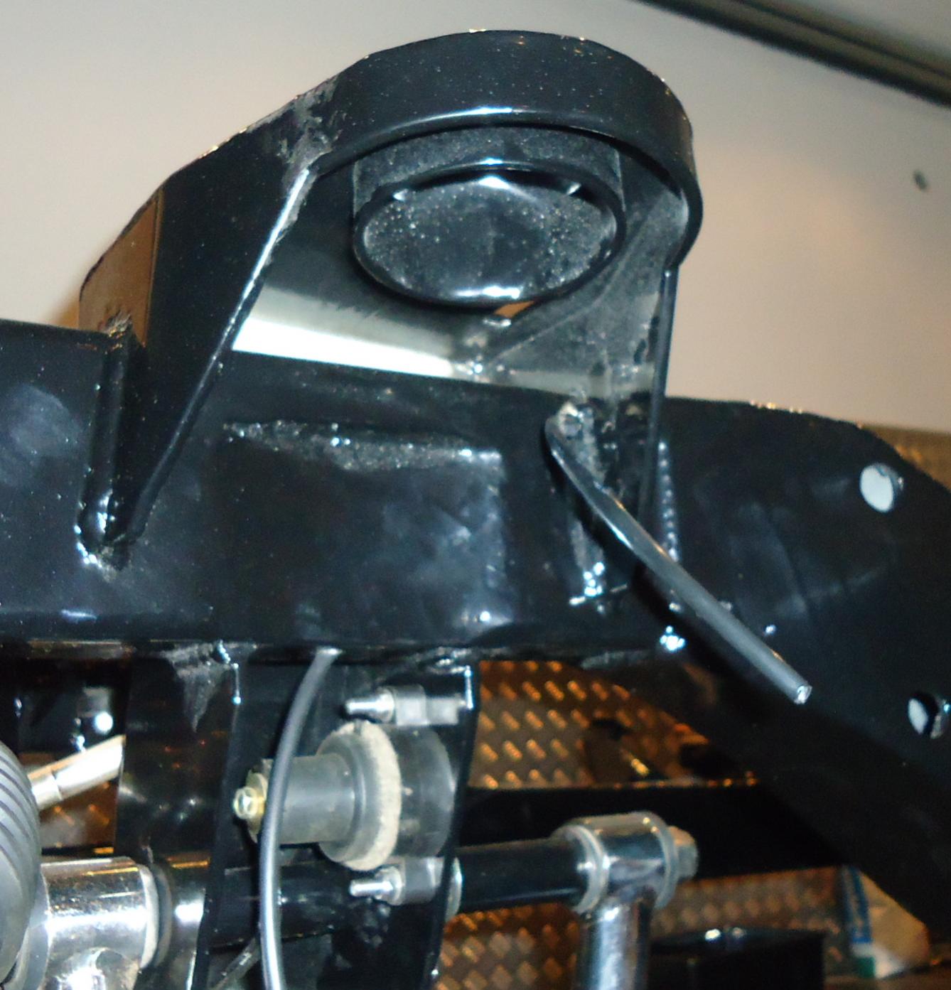

    I've been running air lines and electrical wires for the air ride today. These are just for the front end. The rear lines and wires will be done from inside the car towards the c-notch.
    The first pic shows the lines exiting the frame. I had to run the sensor wires along a small portion on top of the frame, as the holes inside the frame had been clogged by the zinc coating and I didn't want to risk drilling new holes so close to the air line, risking damaging them.
    The second pic shows the air line exiting just underneath the top hat and the sensor wire through the bottom of the frame, right next to the sensor itself.

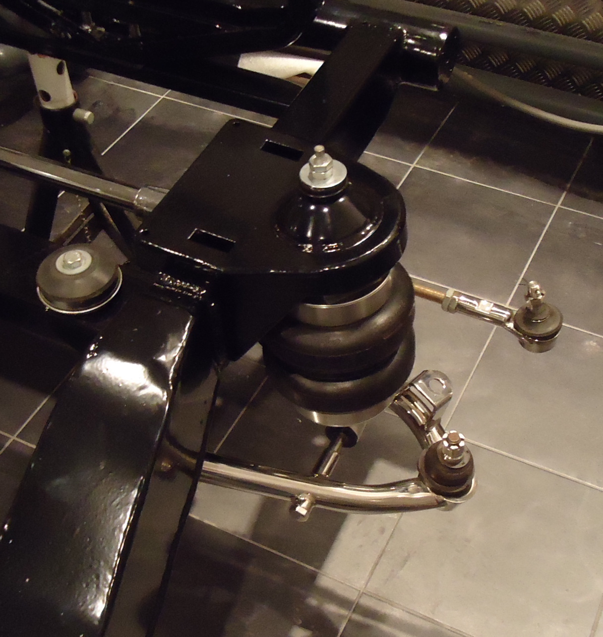

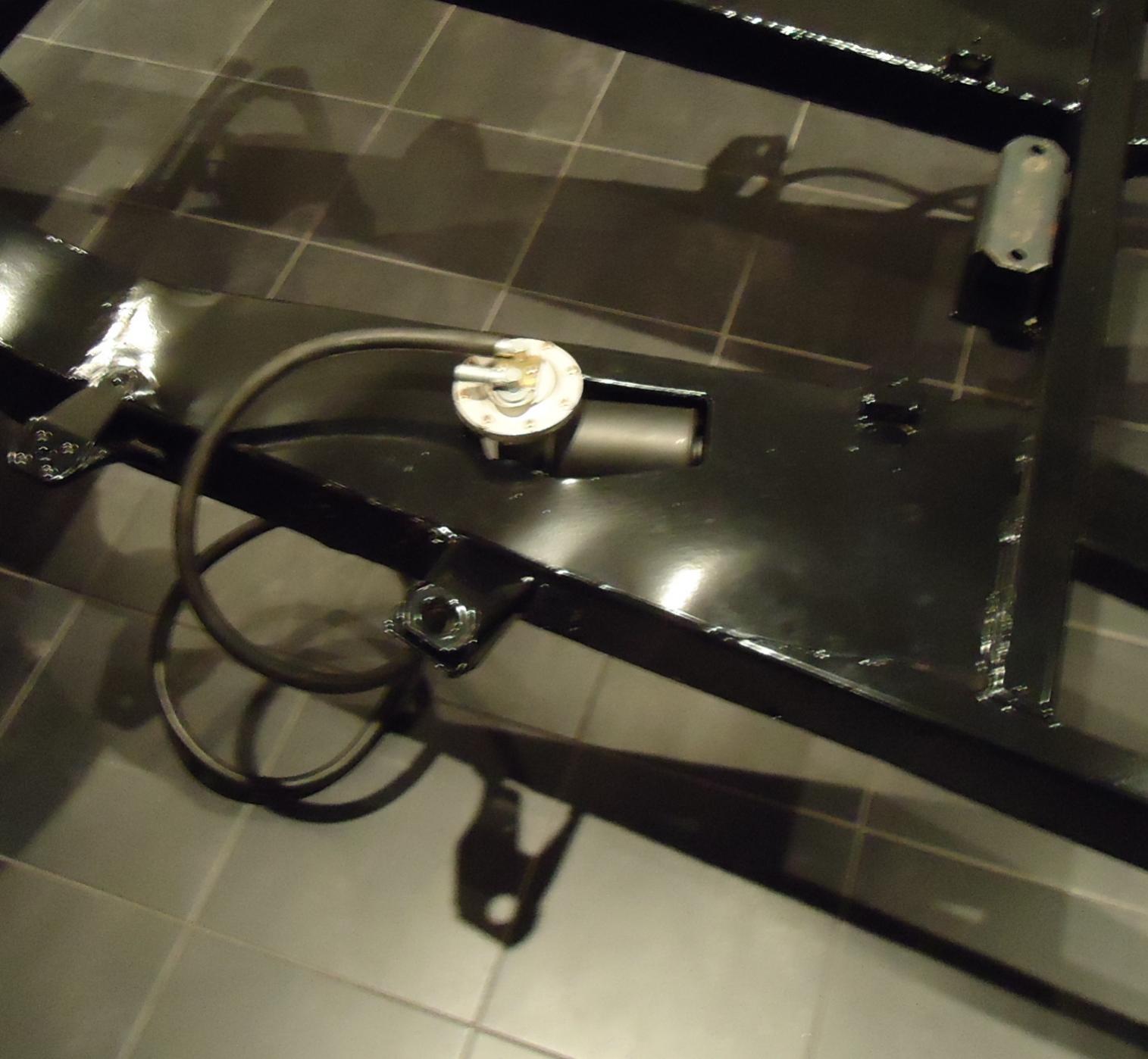

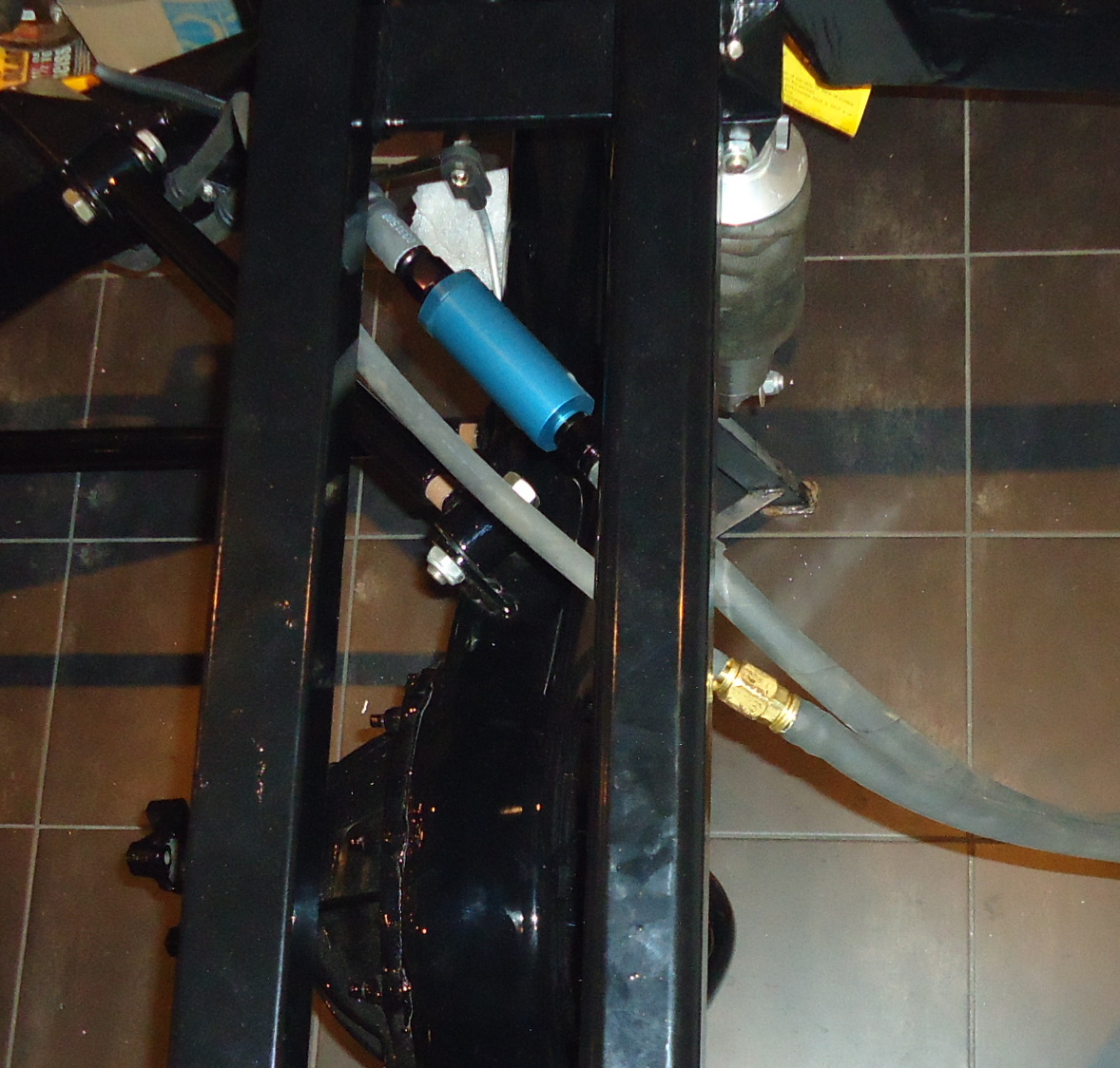

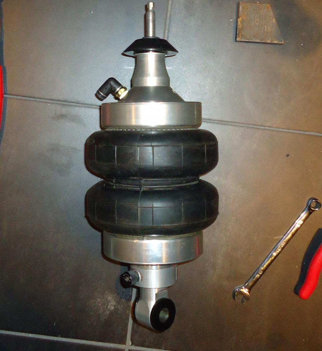

    Finally got the part I required from Summit, a 90 degree AN6 fitting for the return fuel line under the pressure regulator. Got that installed in combination with the fuel filter on the c-notch and the br*** fitting. This br*** fitting allows me to go from the small return line to a bigger diameter hose, as the fitting on the fuel cell is large as well.
    After fine tuning the airride sensor on the p***enger side, I threaded in the elbow fitting for the shockwave and found out that it doesn't clear the inside of the "top hat" of the m2 set up. After a talk to RideTech, they said that the only solution was to cut a piece out of "hat". Damn. This was meant to be a thought out product to coincide with Heidts. And I thought that doing the ch***is work was going to be the easy part of the build.....looks like I'll be cutting and grinding tomorrow.
