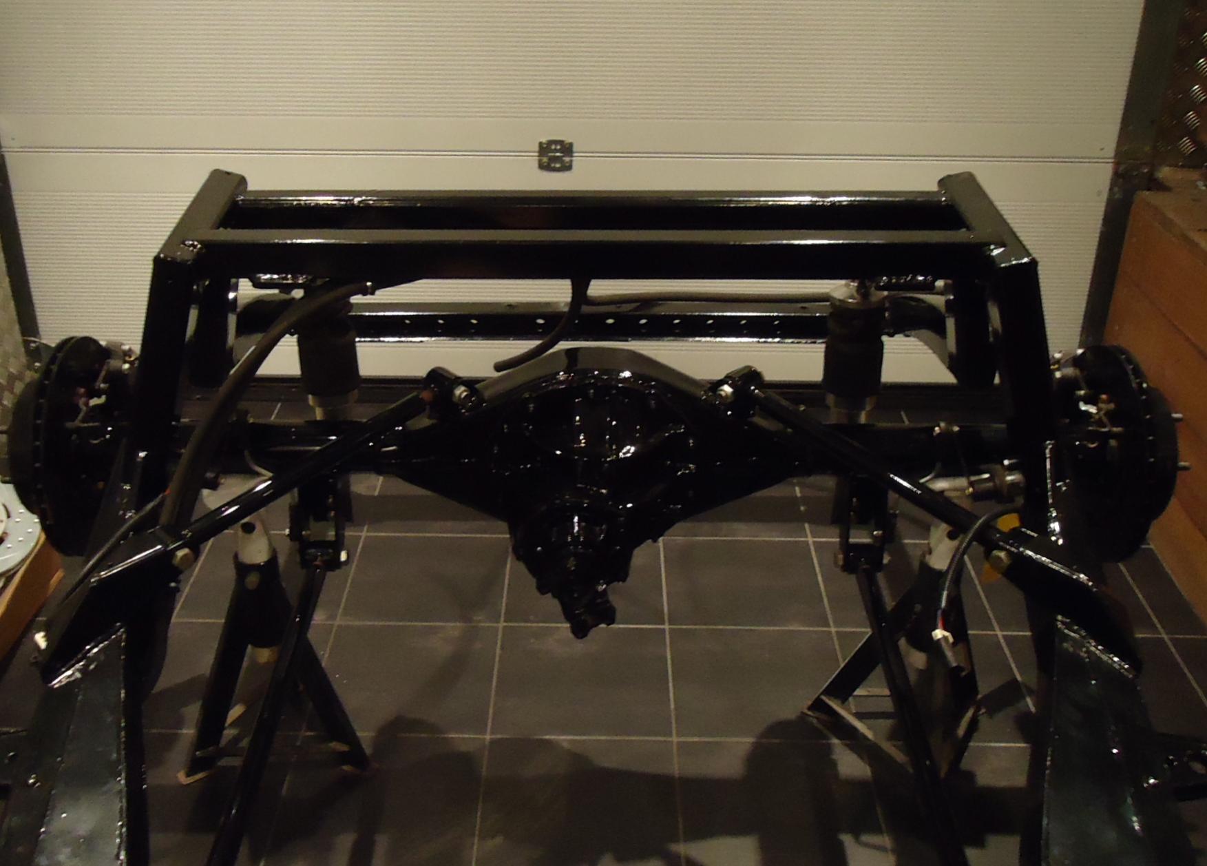

    After a few hours of grinding and tediously maneuvering the dremel around, I gained sufficient clearance for the air valves. I certainly didn't enjoy cutting into the fresh powder coat, but got the job done. I ended up taking out about 3/4 of an inch of metal. The exposed metal is now painted with a plastic cup of black rustoleum and a small brush I "borrowed" from one of my kids.;)
    Both sensors are now operating freely, without hitting anything and I even found some time to install the rear brakes.

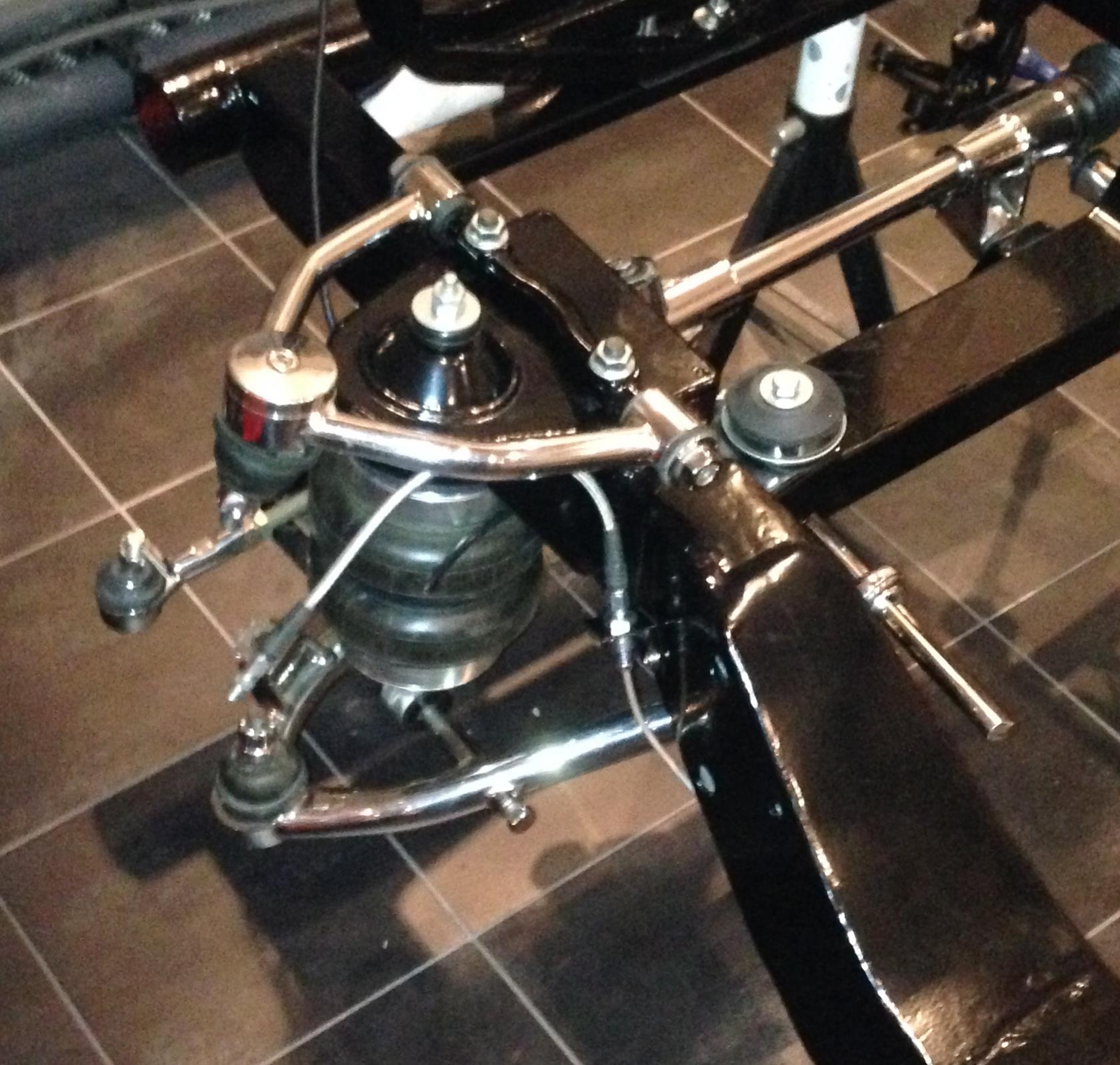

    Just got my painted upper arms and the steering rod guide back. Installed them and took a few pics. Next: Brake lines!

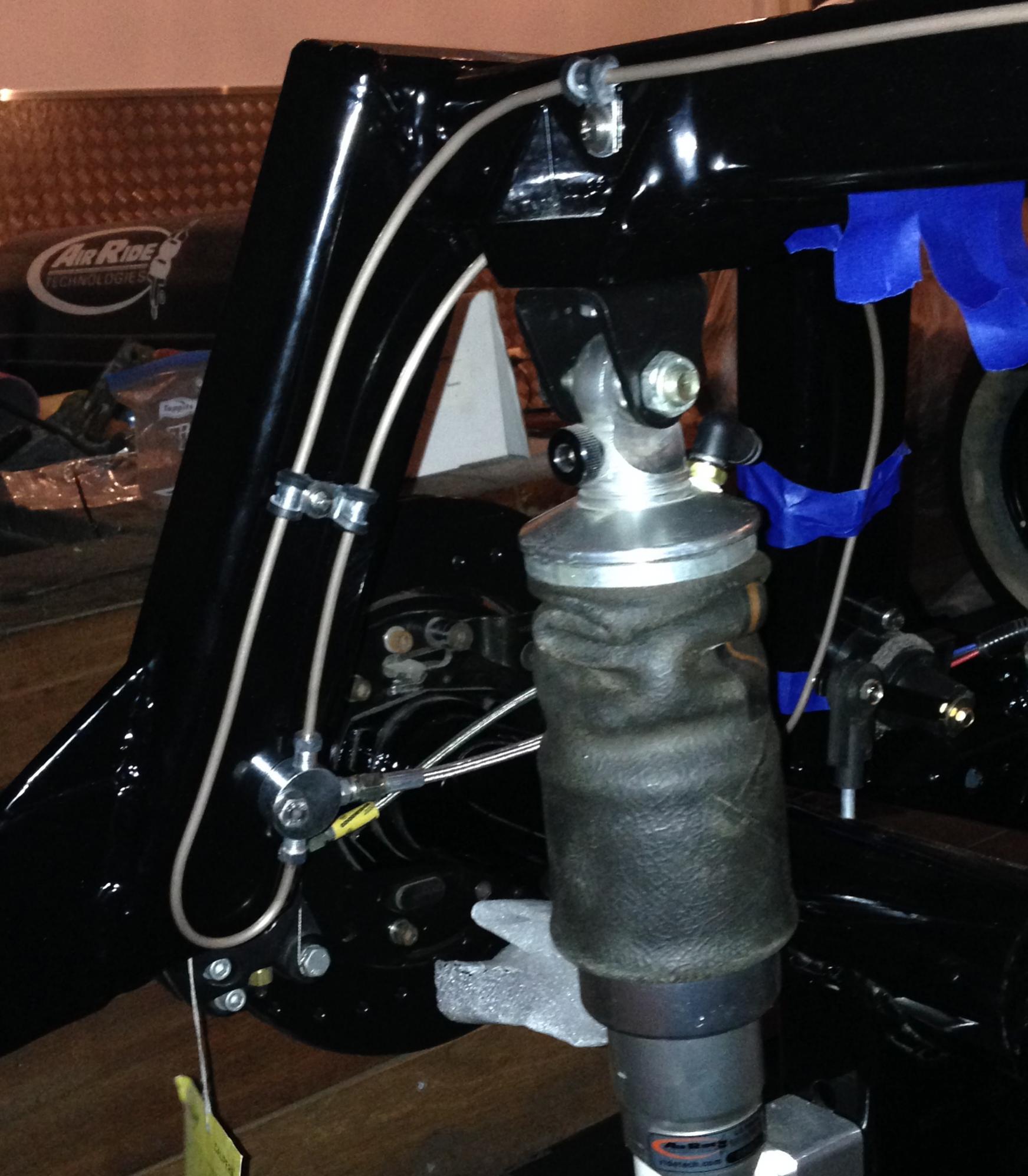

    Decided to go with Kunifer instead of copper. It's a combination of copper and nickel. Made 4 pieces with the necessary flares and double flares. As you can see on the left side in pic 2, I've made them such that they can be joined to the brake lines inside. This way the body can be lifted off (if needed to in the future) by just undoing 3 couplers. (someone will thank me one day.:D)
    I've made the brake line run along the c-notch, instead of along the rear axle, for a cleaner look. I just need to drill a few more holes (ran out of sharp drill bits) and then the brake lines are done. Jacked up the rear of the frame to ensure proper movement of the flexible rear lines.

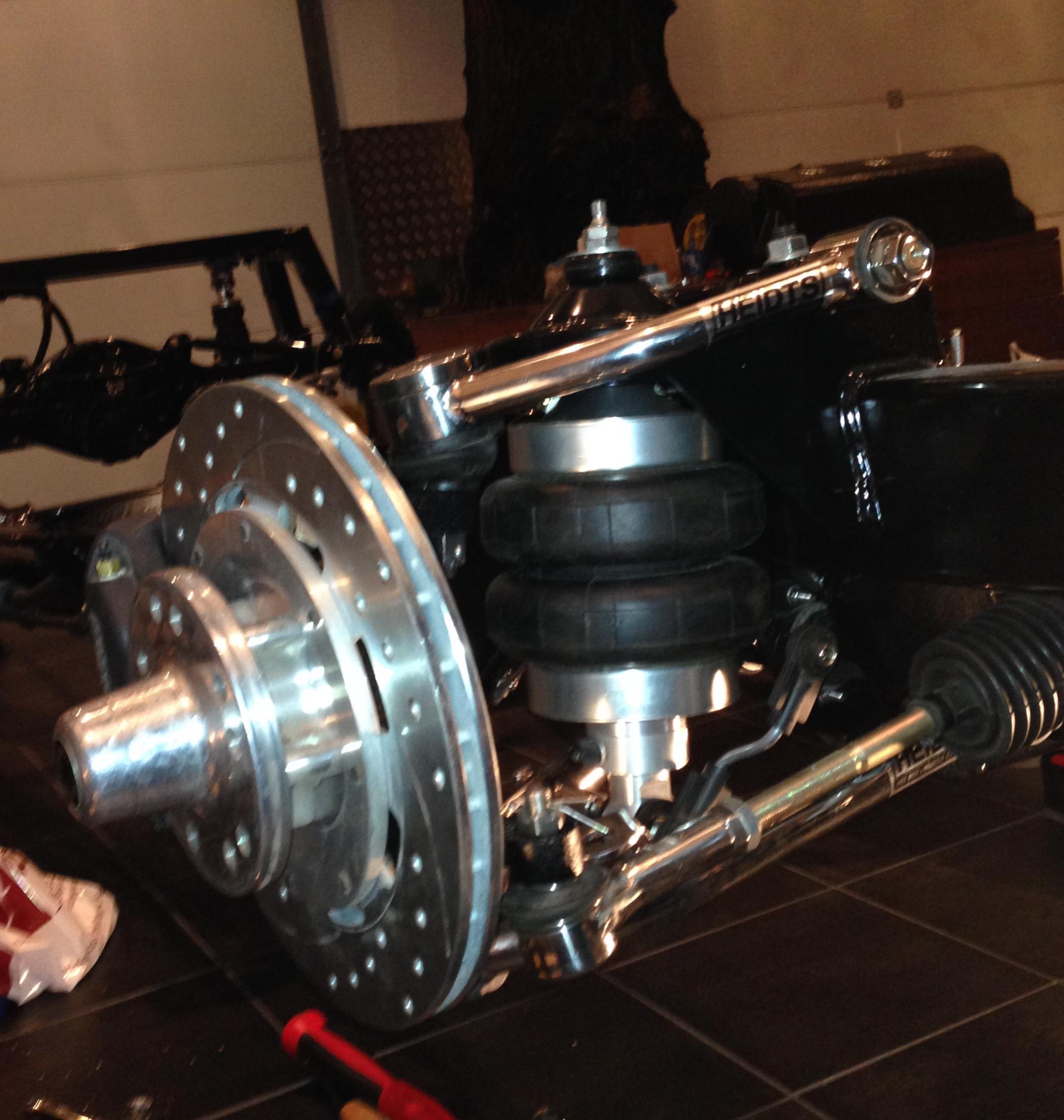

    More progress. Removed the tunnel from the body. Going to increase the diameter of the holes for rivet like ss bolts and cut out some surplus metal along the blue tape. Finished up the wiring for two front airride sensors and installed the passenger side drop spindle. It will give me another 2 inch drop in the front, which should be enough for an even cooler look.:D

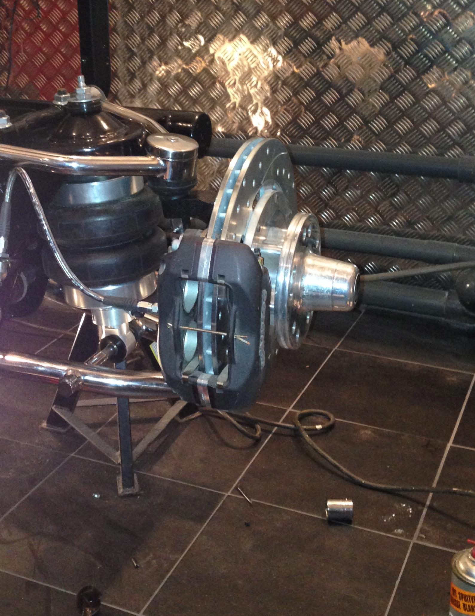

    Eric are you going to insulate those electrical connections in picture #2? Kinda scary to me.

    That's probably why he posted picture #3..........cleaned up and insulated. :)

    Hogman is correct. You didn't think I was going to leave the wiring exposed?:D Of course not. At least you're very observant. Thank you for noticing anyway.

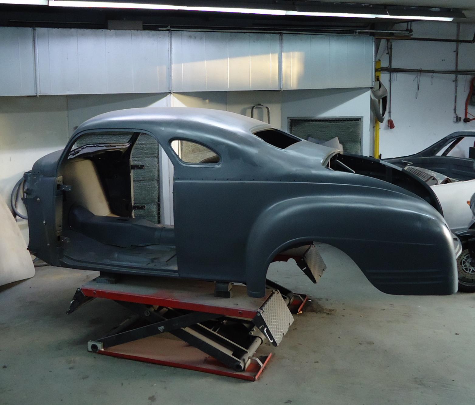

    It's been a few days but I have been working on a few things. The body is now ready to go to the body shop and once again, plans have changed slightly. They'll now do the underside and just the front of the body. In the mean time, I'll get the hydraulic clutch sorted out and mount the engine and transmission on the chassis. Once the body shop have performed their duties, I'll show up with a rolling chassis and we'll mount the body for the last time. From there we'll take the next step.
    Here are a couple of pics of the journey to the body shop and it's new home for at least the next few months.:D
