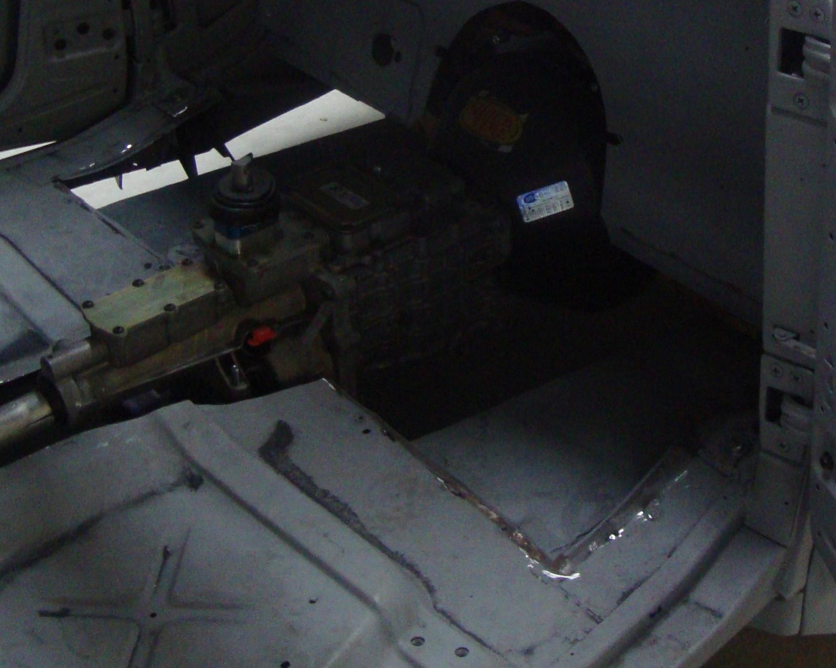

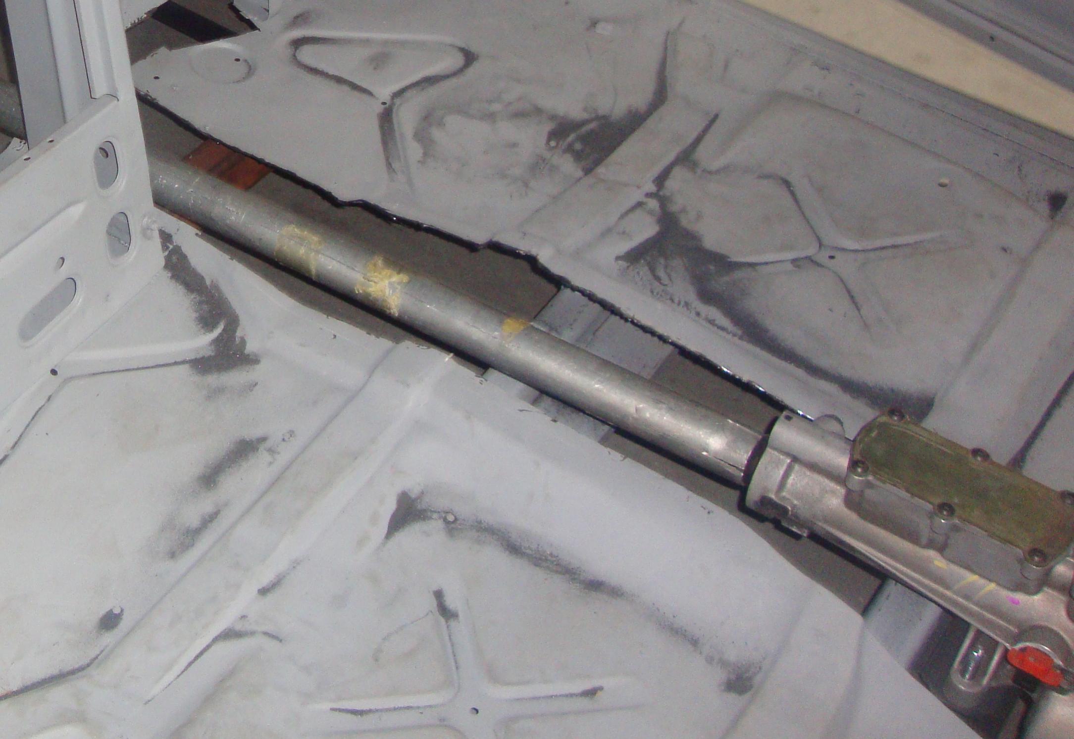

    Had the car transported to Martin this morning for the last sheet metal work. The initial plan was to replace the whole floor, but the metal below the seats was still in such a good shape, the decision has been made to leave that. I cut the foot well metal out as it was overlapping the old and its just a matter of time before we get rust there.What you se through the hole is the top of the ch***is to which I'd welded some sheet metal.
    I cut out the old tunnel, damn this thing was welded full length, took me more than an hour to cut it out nicely. A new tunnel will be fabricated, slightly offset towards the rear considering the 9 inch diff pinion isn't centered either. Placed a steel tube between the trans and diff to get a look how its going to sit. I realise the actual driveshaft will be larger in diameter, but it will do for now.Plans are to mount a fuel cell between the benchseat and the diff. There's a lot of room there, also the place to mount the airride compressor, battery and all electrics. This way I still have maximum room in the trunk, also cleaner looking. Filler neck will be on the driver side next to the trunk hinge. Therefore the trunk will need to be opened everytime I fill her up.
    A small price to pay for a "clean" looking exterior, right?

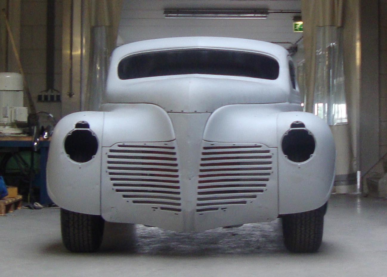

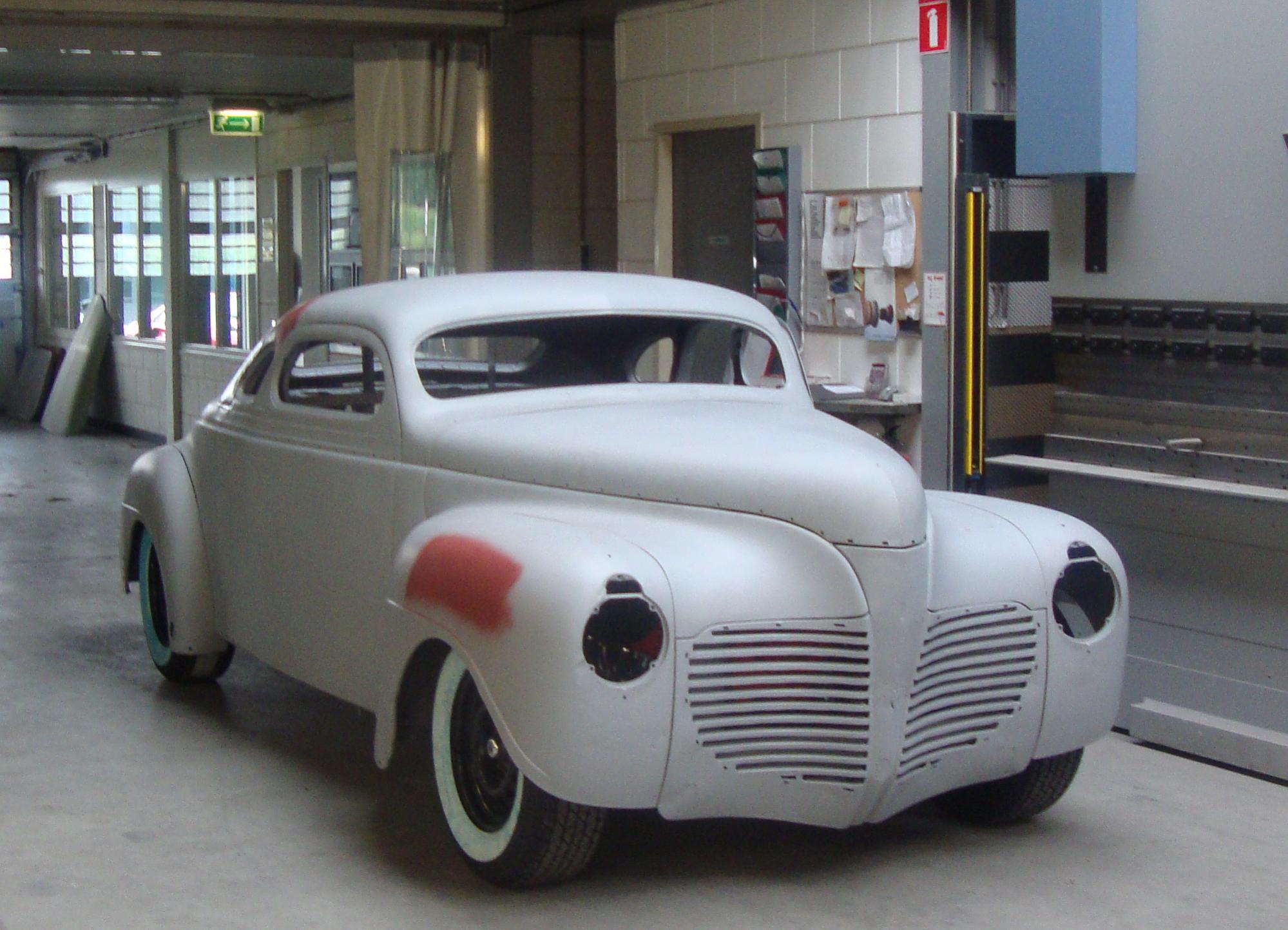

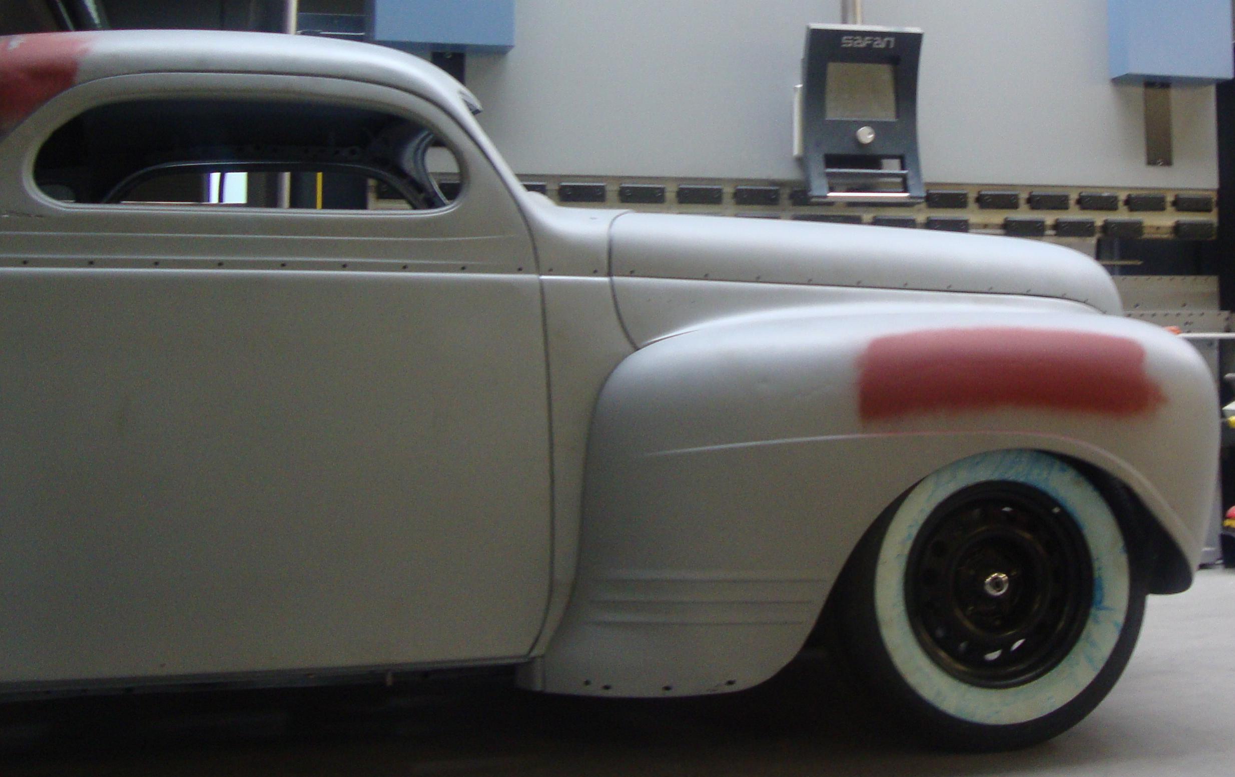

    Attempted my first panel beating job!(under guidance of Martin). Worked on the right hand front fender, taking my time, but came out fairly smooth. This is a dying art which I'd like to learn. Will try and do some more panels, but leaving the final work/smoothing out to the professionals.
