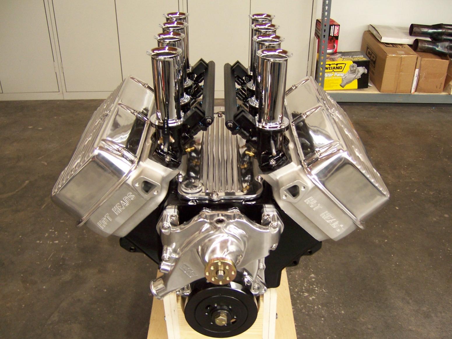

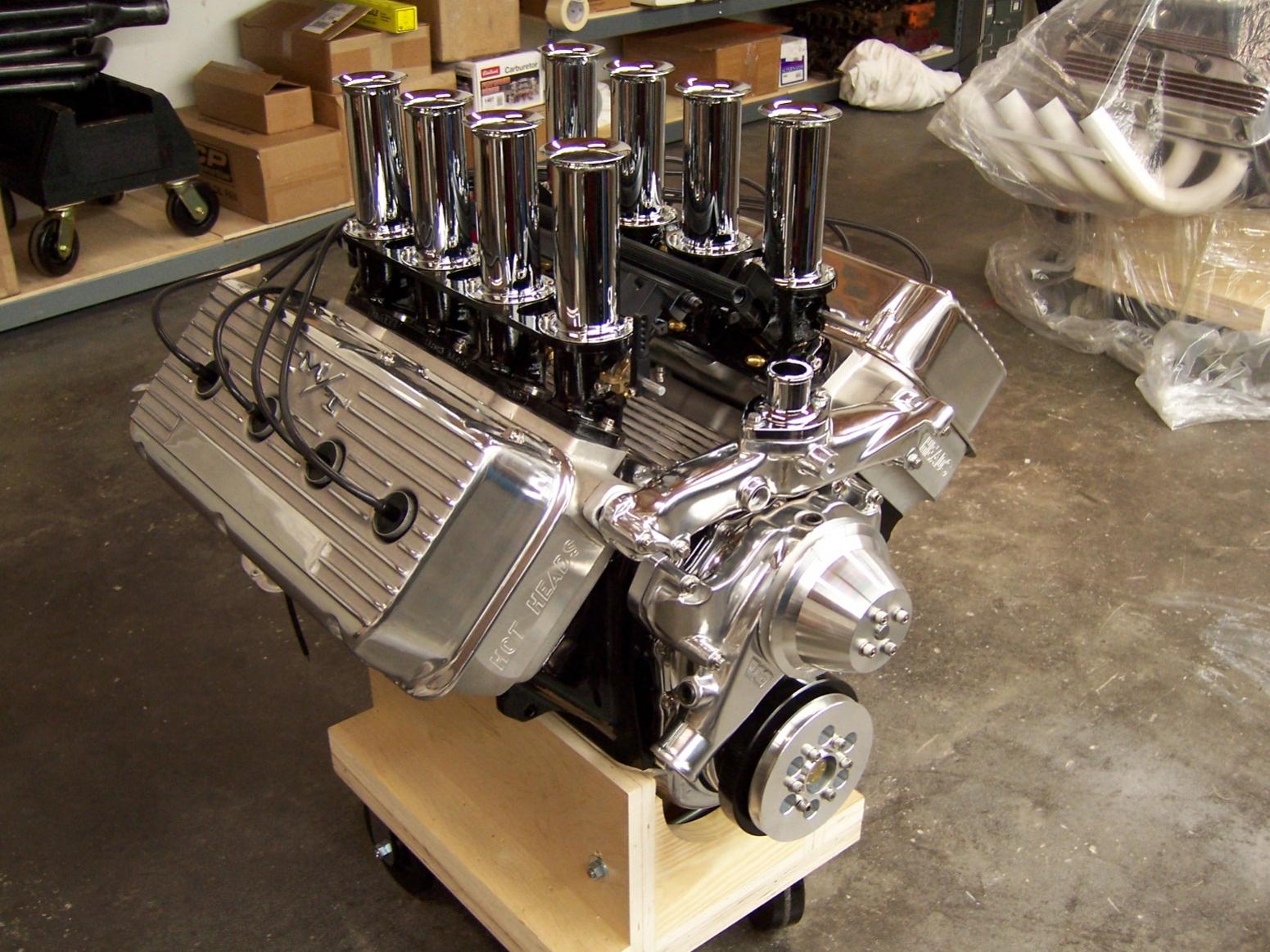

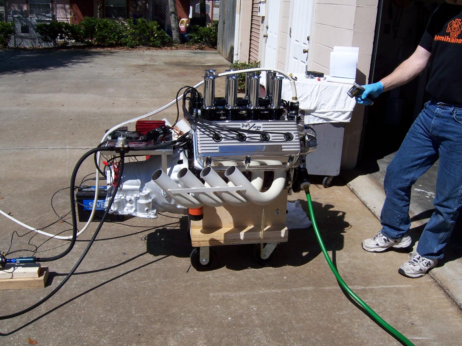

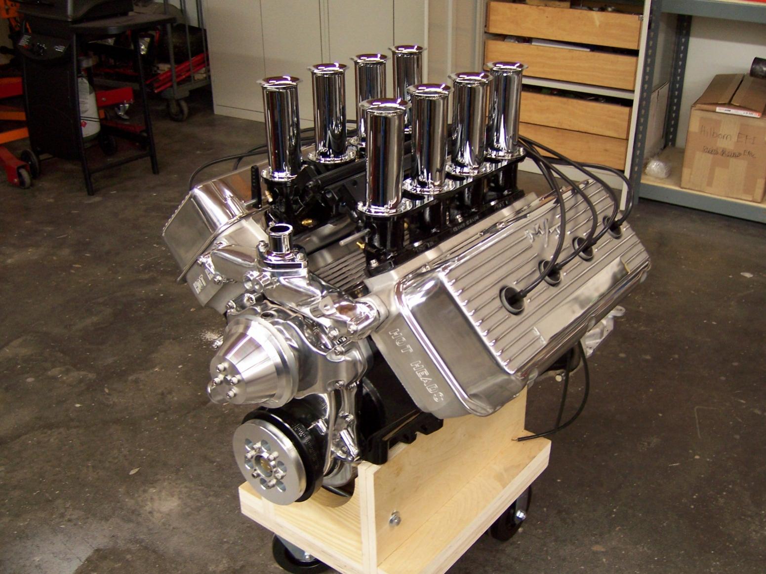

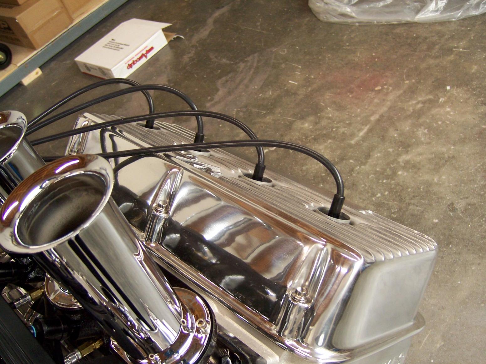

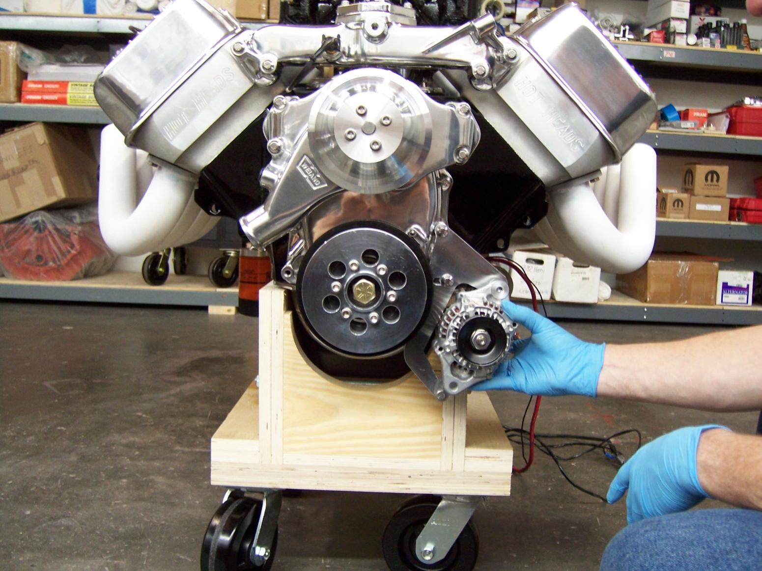

    I may just buy some more tires....would't be a bad idea. Here's another look at my other baby. Sorry, couldn't resist.(engine builder is Eddie Haines of HemiHaines btw)

    a truly beautiful engine

    Thanks! Its standing in my garage at the moment, waiting to be installed. To be honest, every now and then I take the blanket off, stand back and just look and enjoy. Hope I'm not too weird.....:rolleyes:

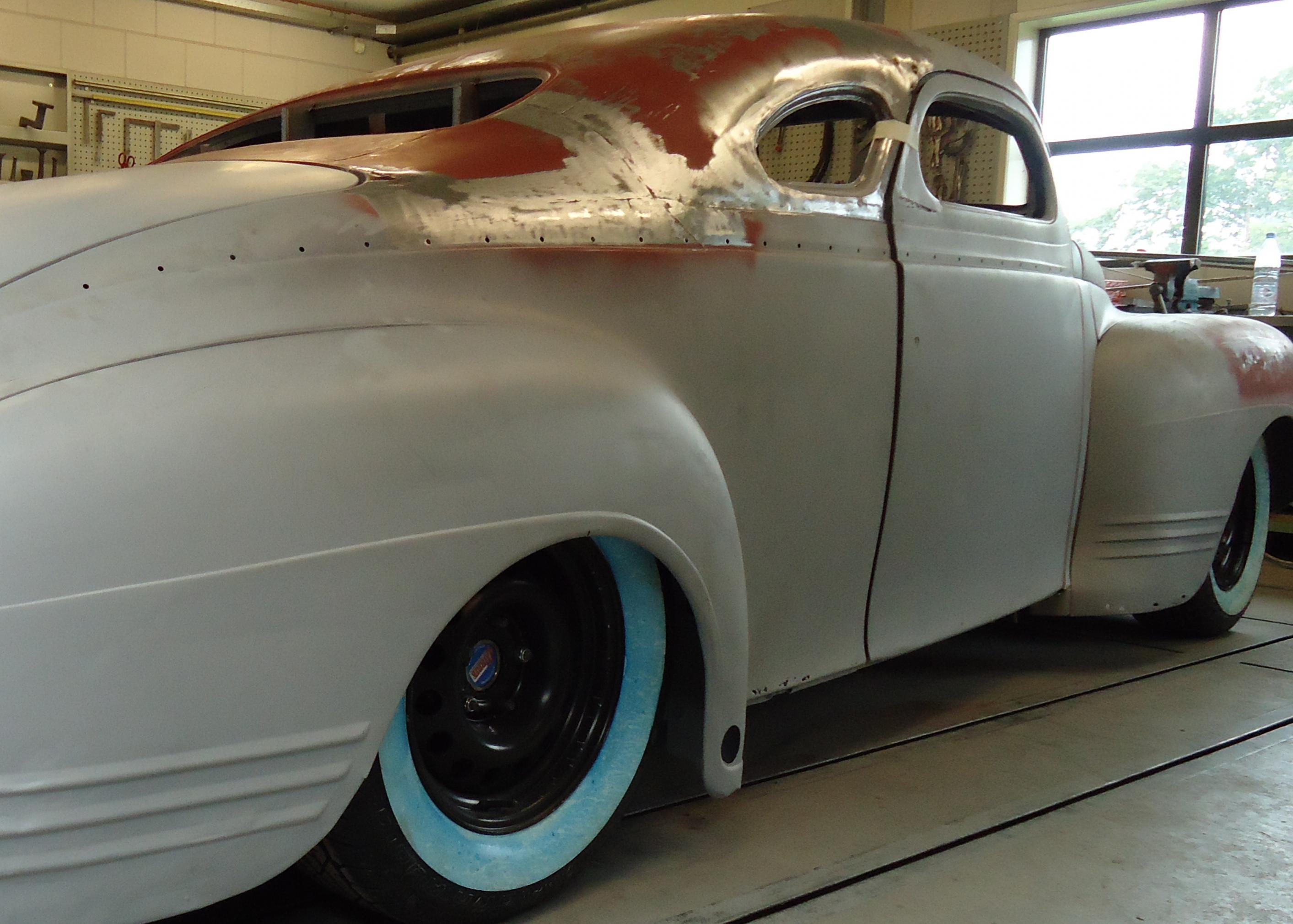

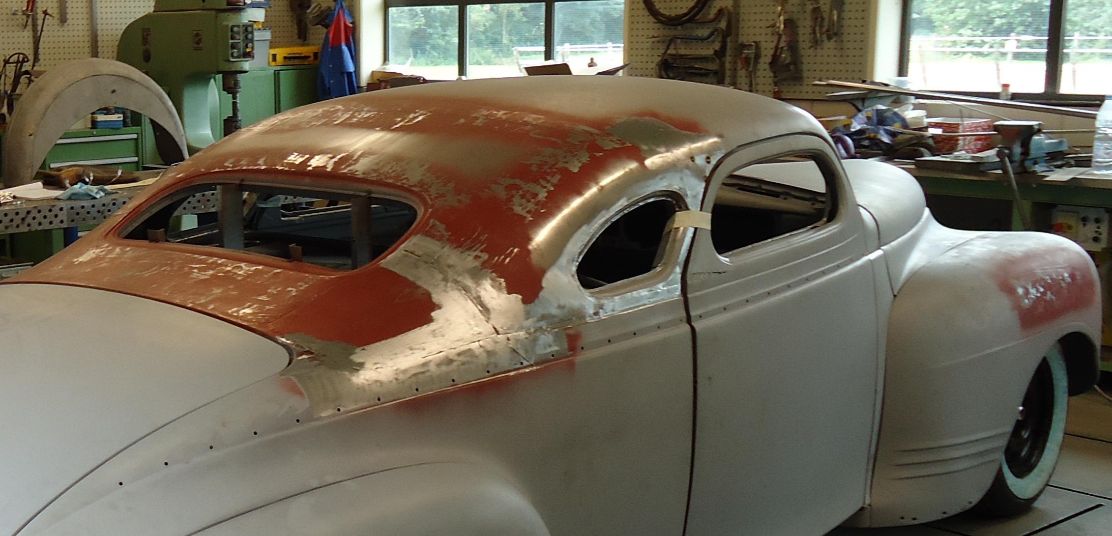

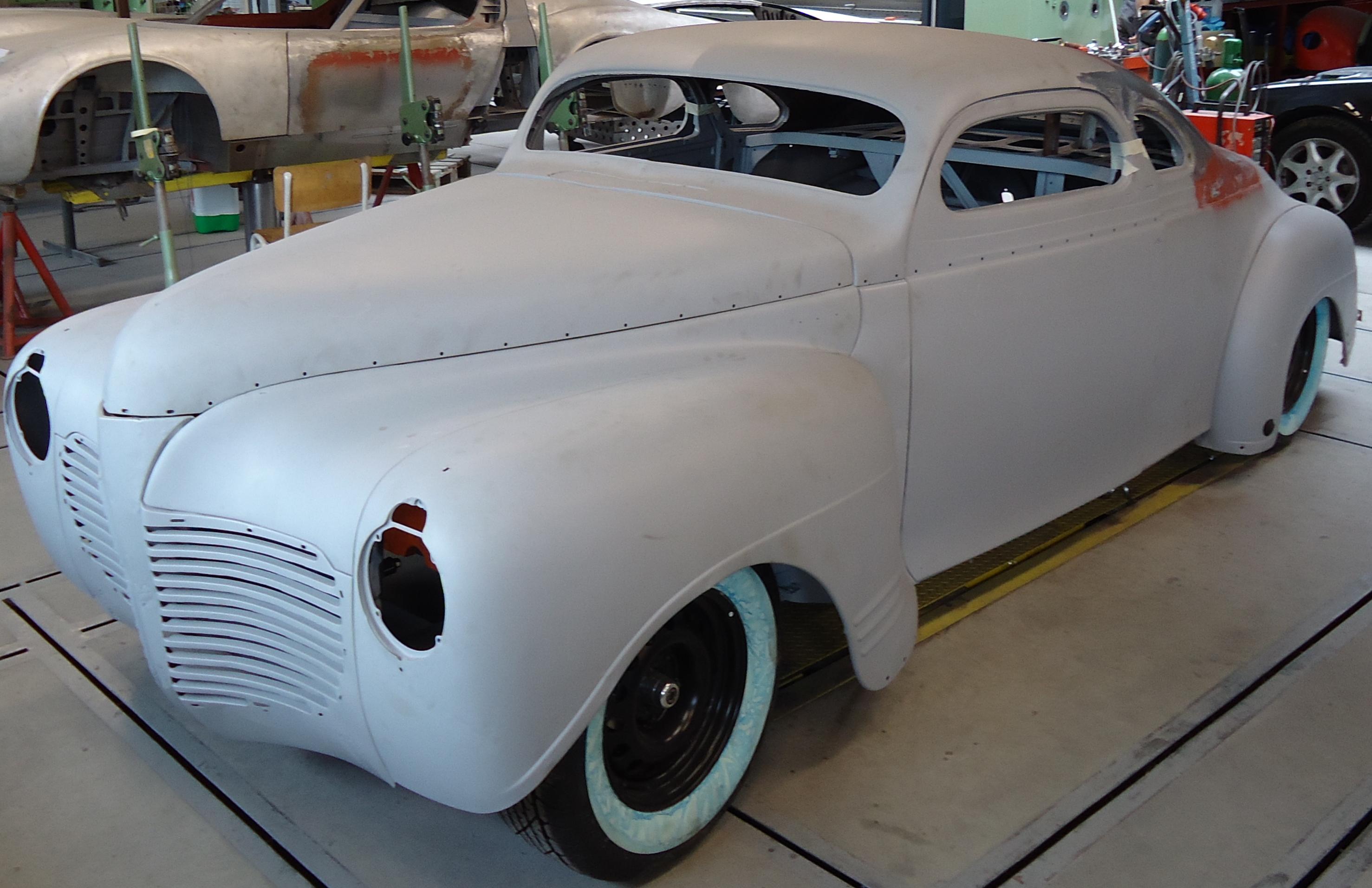

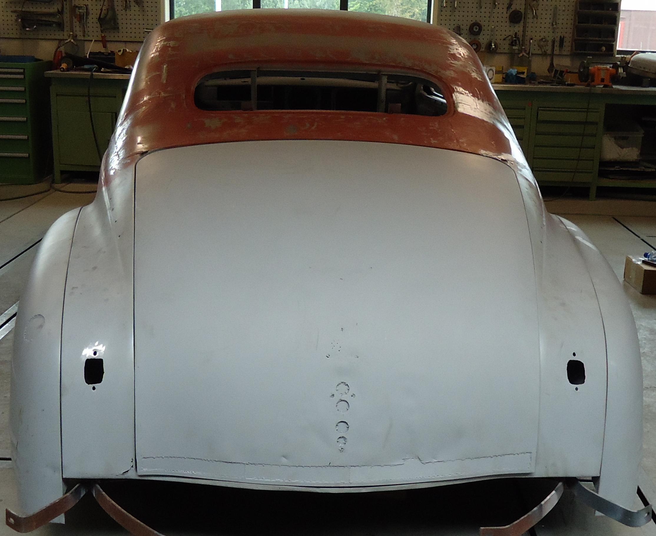

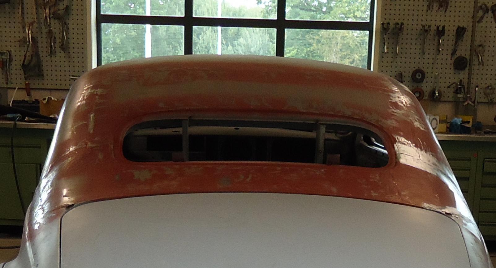

    Went to work on the car again today together with Martin. During the weekend he's finished the lower part of the sheet metal around the bottom part of the rear window. This is looking great, with only minor lead work to be done.
    We're focusing on the interior now and will start to build the tunnel and foot wells. I've lowered the car in the rear, this will be the final position when the car lowered to the max. The front end will receive dropped spindles, lowering it a further 2 inches.

    Here's a couple more pic's. The front body work needs to be raised about one inch,(to get the trim line lined up) but with the dropped spindles, this should effectively lower the front one more inch. Should work out just fine.

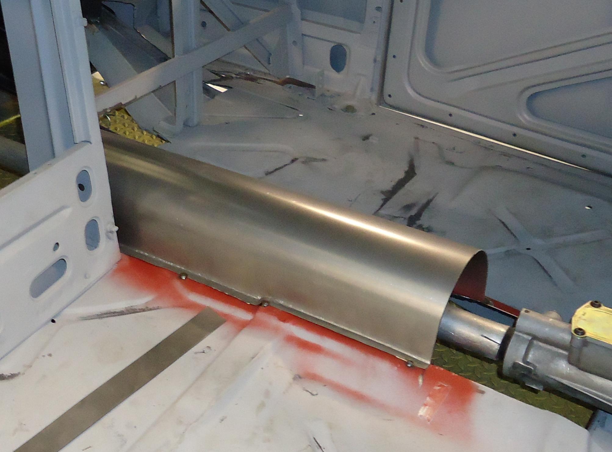

    Started fabrication on the tunnel. I used a mock up driveshaft of 2 inches in diameter, to get a look at how it will run with the offset 9 inch rear and the car in its lowest and highest position. Final driveshaft diameter will be 3.5 inches.
    Going to start fabricating the tunnel around the gearbox which will be one big removable piece for easy access to the bell housing and gearbox. But first I need to make the foot well area and create sturdy mounting points for this tunnel piece.

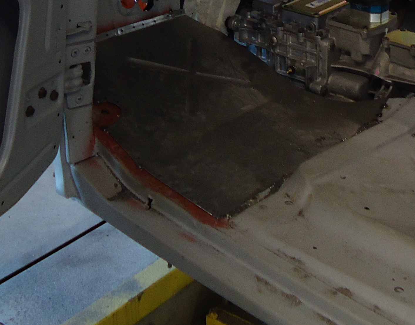

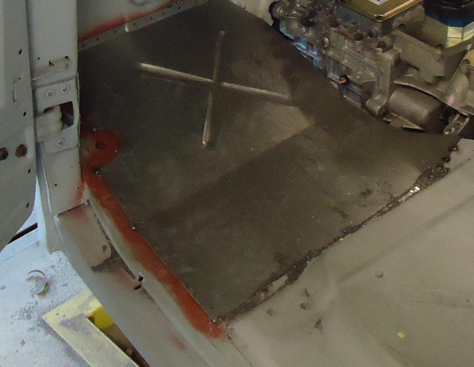

    Got started on the driver side floor pan. Made a cross in the middle for some extra rigidity and to keep in line with the rest of the floor and tacked it into place. Some extra metal work has been done, replacing a lower part of the body below the floor pan(left hand side) which was slightly rotten.
    Going to find the correct position for the pedal ***embly and steering wheel now.

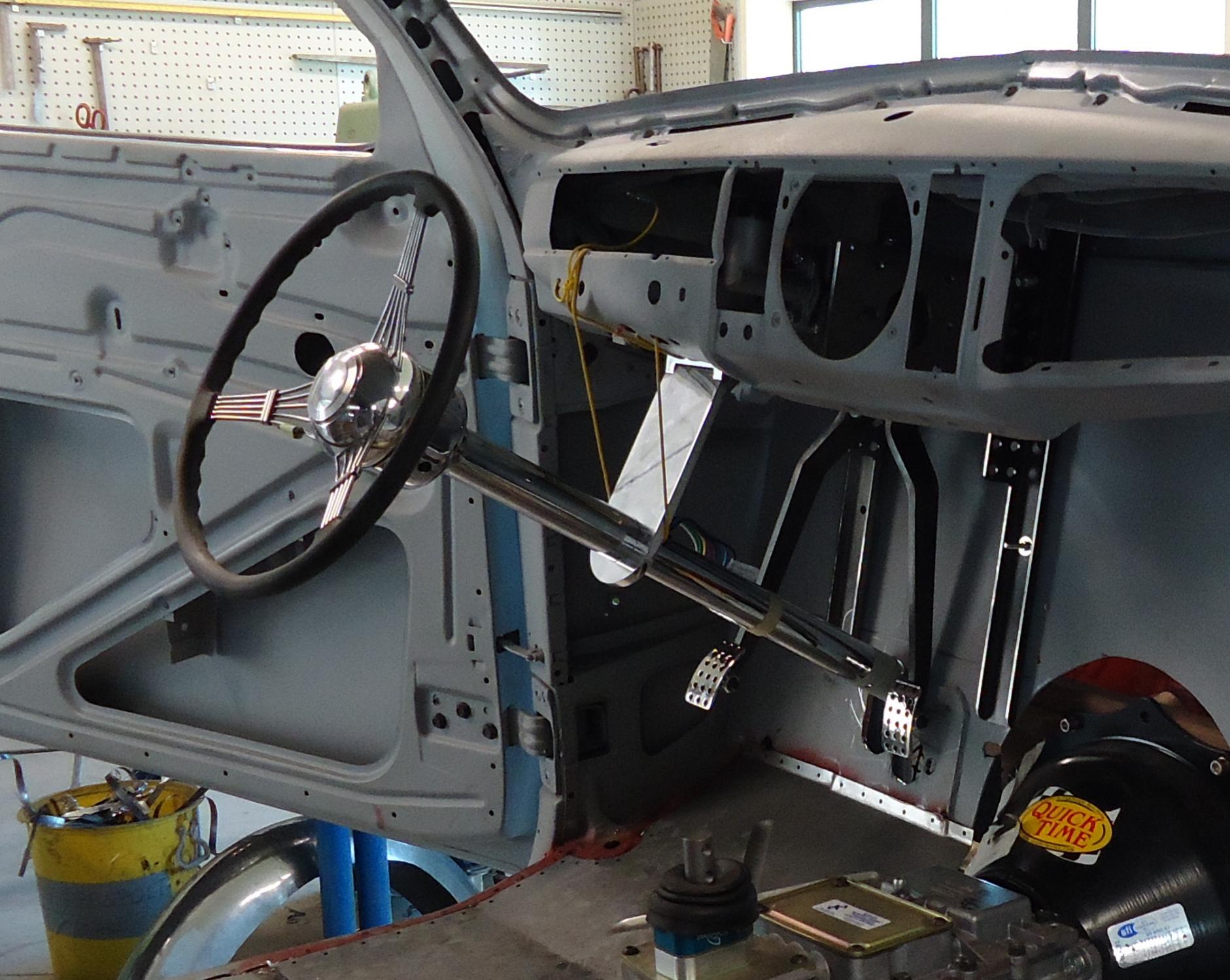

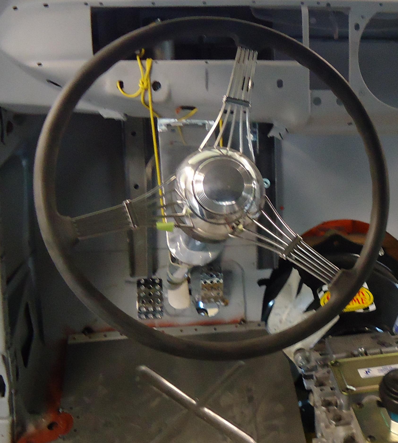

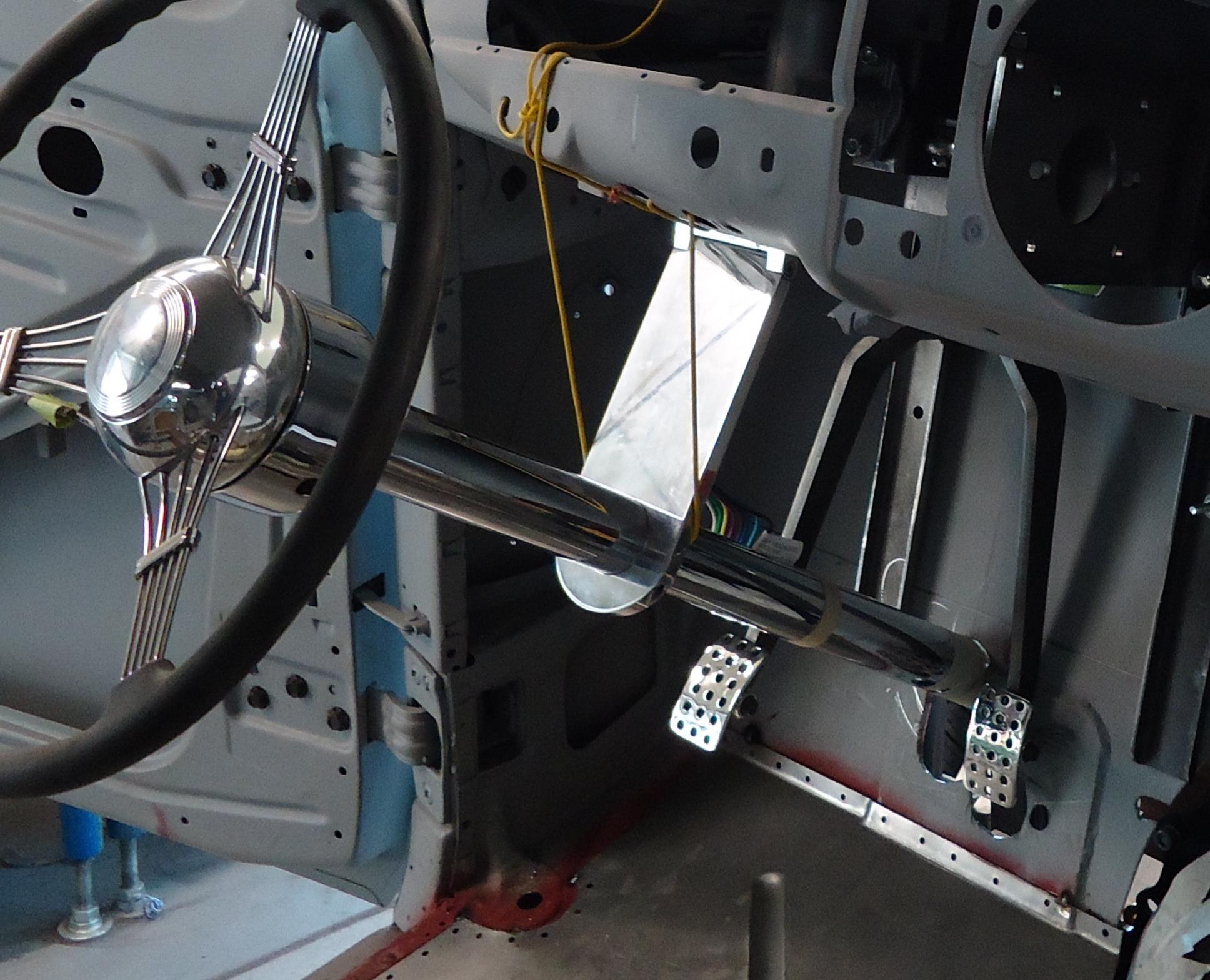

    Started mounting the pedal ***embly and the steering wheel. I was concerned that the gauges would hit the brake actuator, but after mock up I still have two inches of room.(gauges will be mounted in the center of the dash and the brake actuator at 90 degrees to the pedal ***embly). The pedal ***embly will come down 1 inch and the steering wheel will be positioned up one inch. The pics show a rough mock up.
    Next problem is the steering linkage. Considering the hole through the firewall will now be higher, I need an extra coupling mounted to the frame to compensate this. I'll also need to notch the engine mount slightly for clearance purposes. Nothing major, just another thing on my "to do" list.
